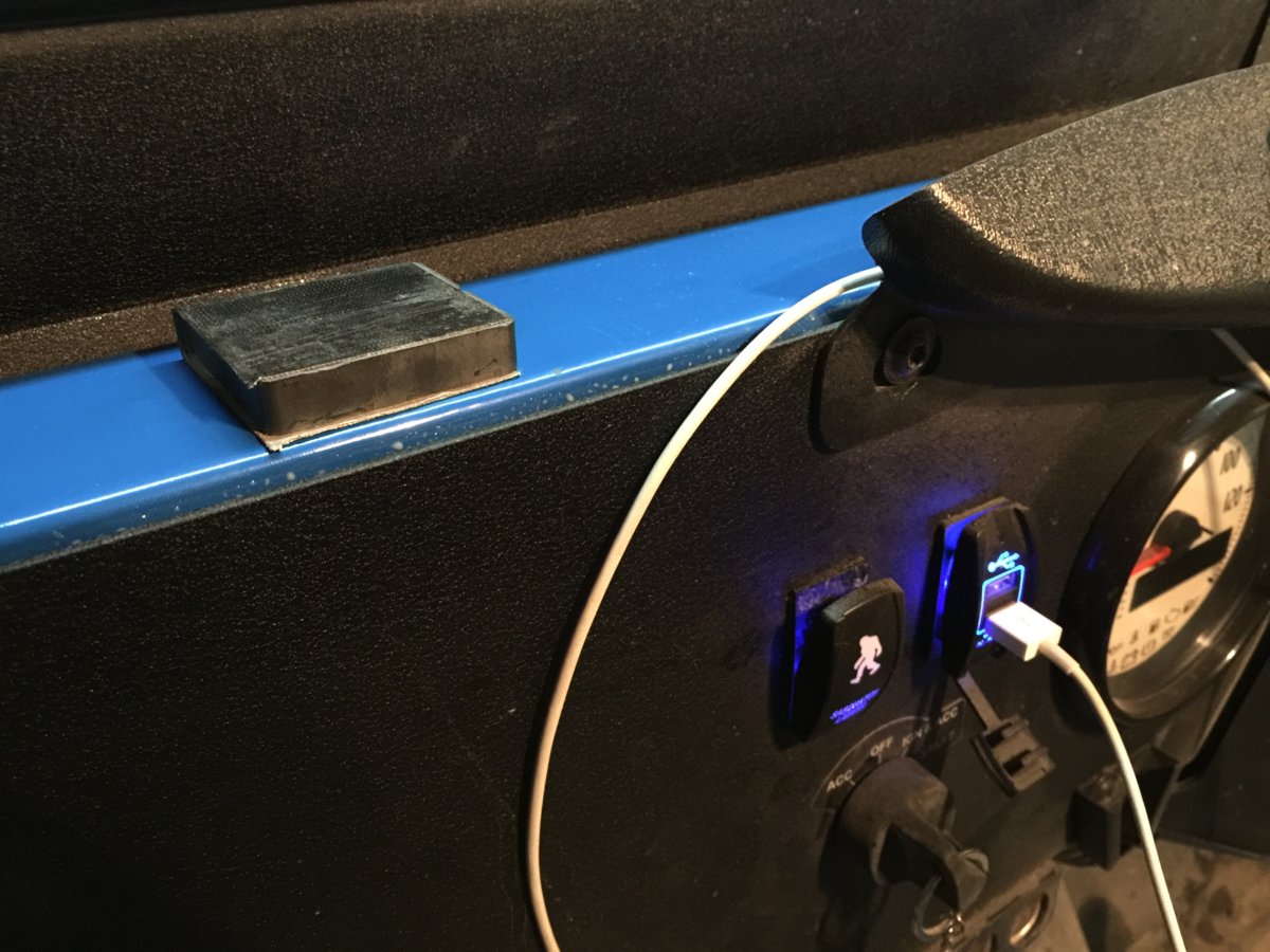

I ordered a dual USB charger outlet from Amazon to replace the cigarette lighter output and it was nearly a drop in replacement.
I only had to file a little bit off the sides of the cutout and replace one of the stock spade connectors with a full-sized 1/4" spade connector.
The one I ordered was the USMEI Dual QC3.0 USB Charger socket.

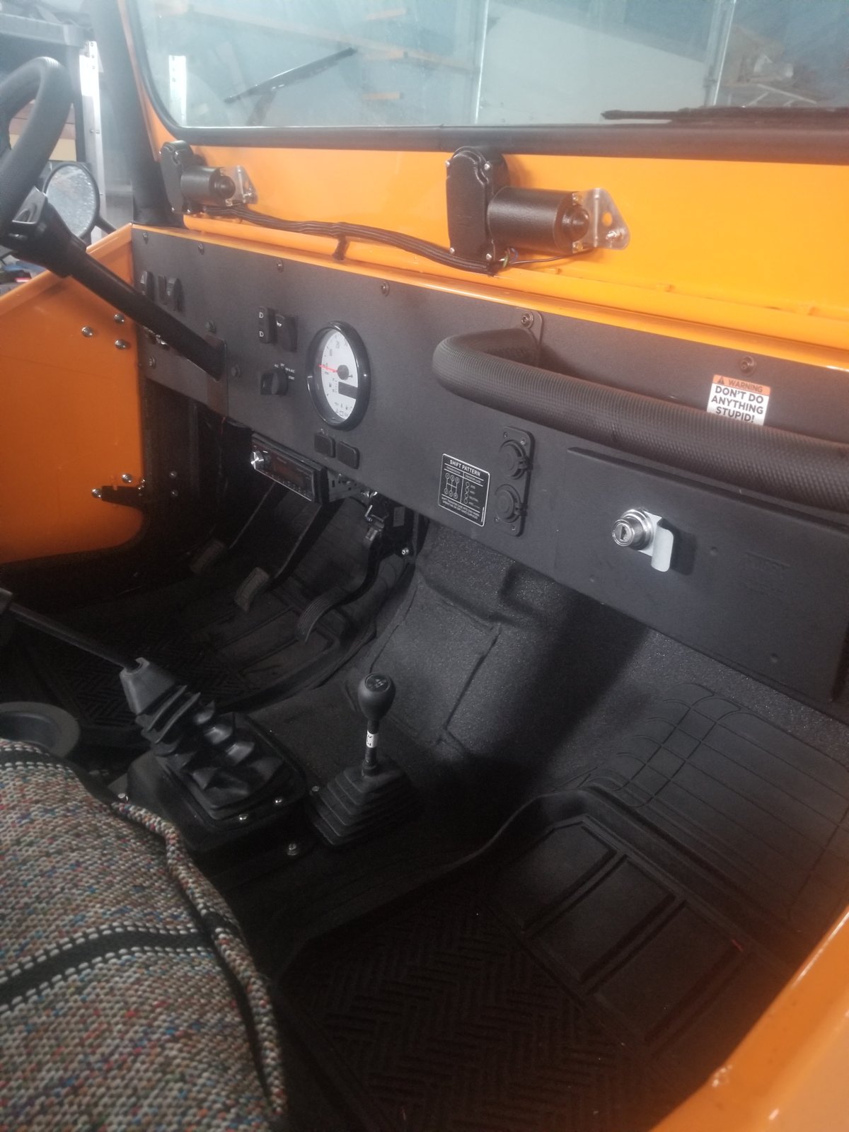

I mounted a 12v/USB duel port. Working great.

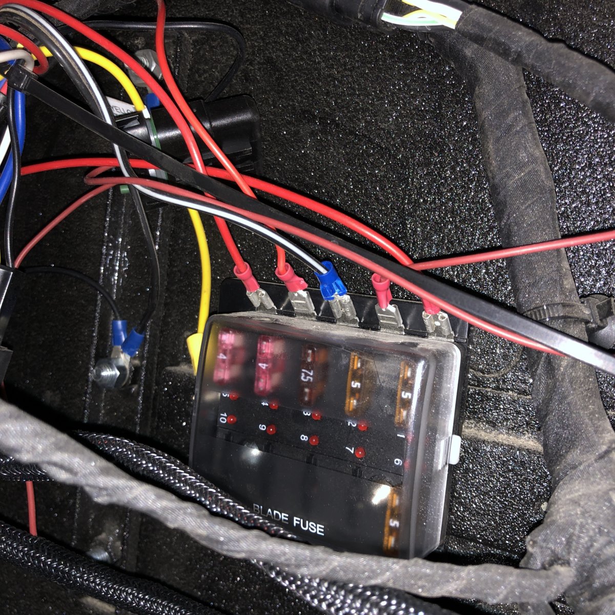

I added in a USB port also and an extra fuse block, tied to the key to add little stuff easily, like interior light and foot well lights. I have to tidy up my wiring yet, but the "old dog" seat is in the way. There are priorities you know. lol

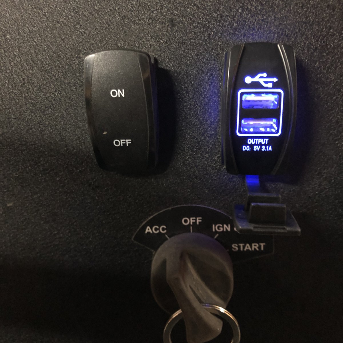

I ordered a carling type usb dual charger off amazon for about 11 bucks. Grounded it out and ran the power lead to the cigarette lighter wiring so it turns off with the ignition.

I had to hand file all my dash holes a bit for any of my aftermarket switches and USB port to fit.
