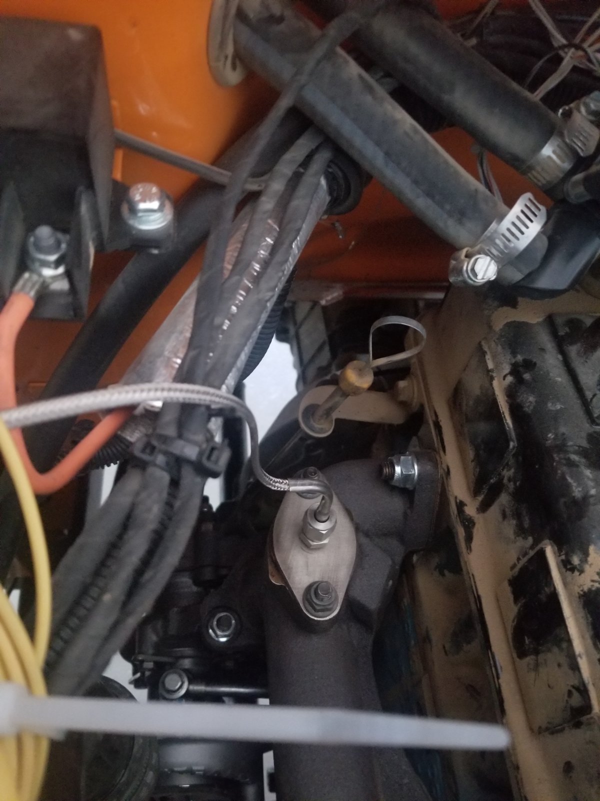

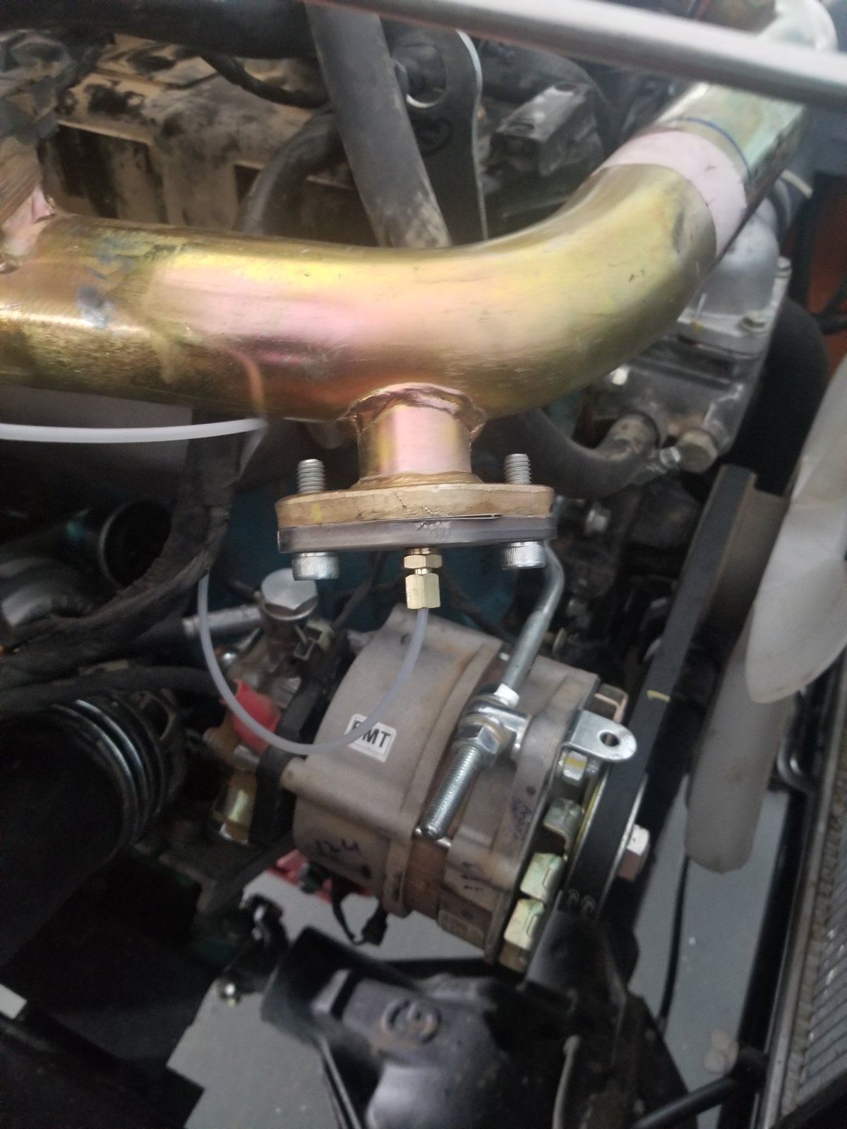

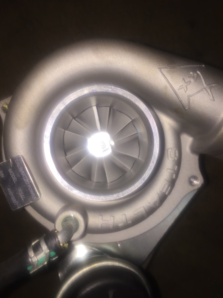

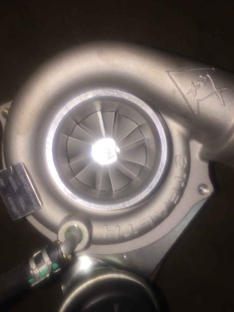

Changed out stock turbo to the new stealth aftermarket turbo. Stock turbo turned out about 8-10 boost with the wastegate limiting valve installed. I am getting about 18-20 max under heavy load with the new turbo. I also added pyro & boost gauge to monitor temps and boost.

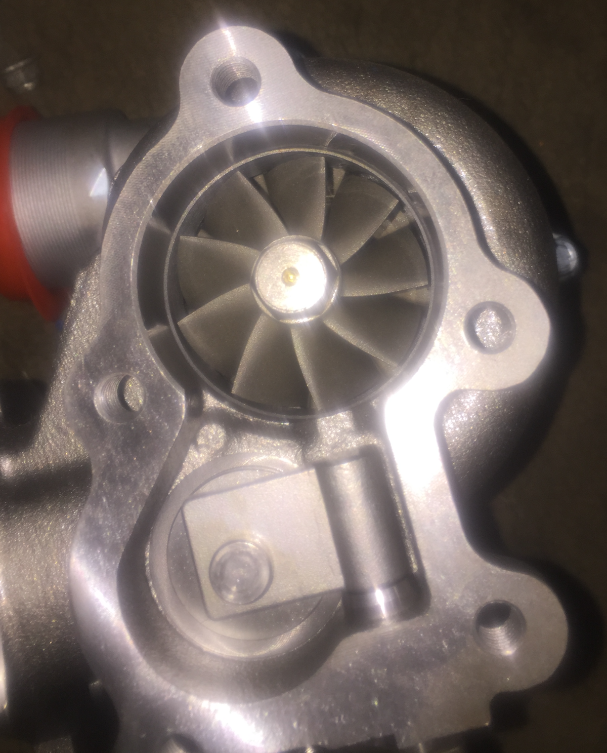

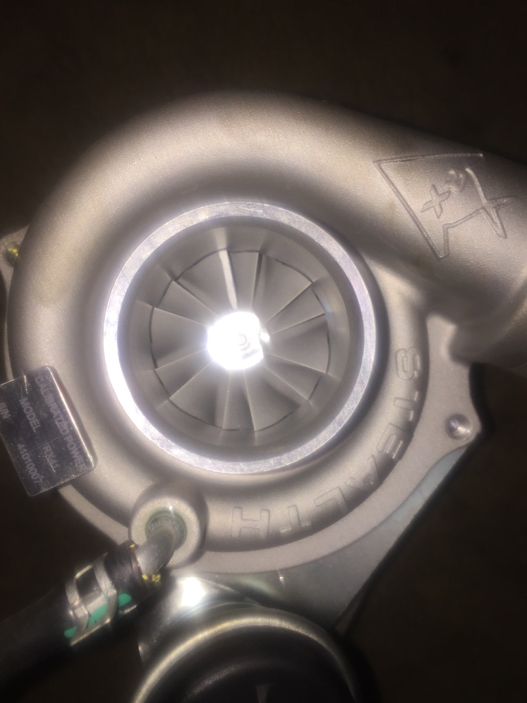

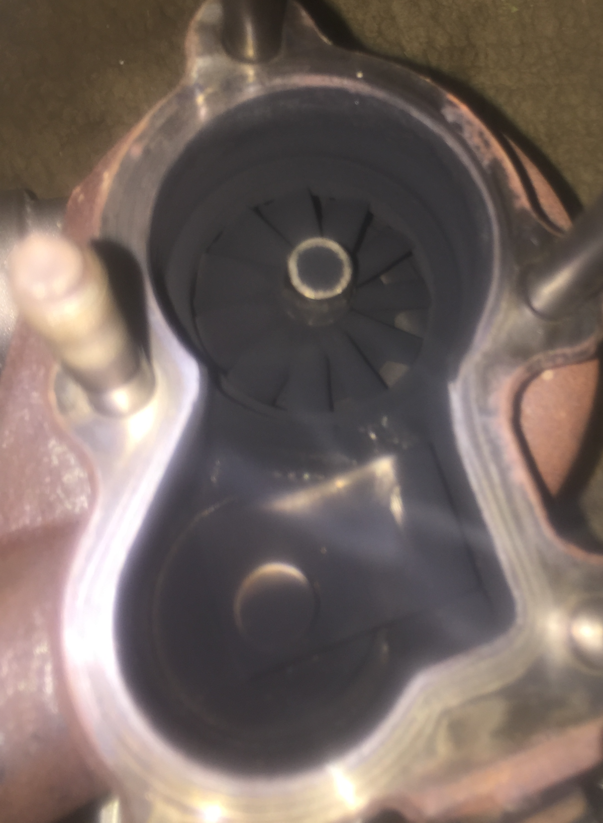

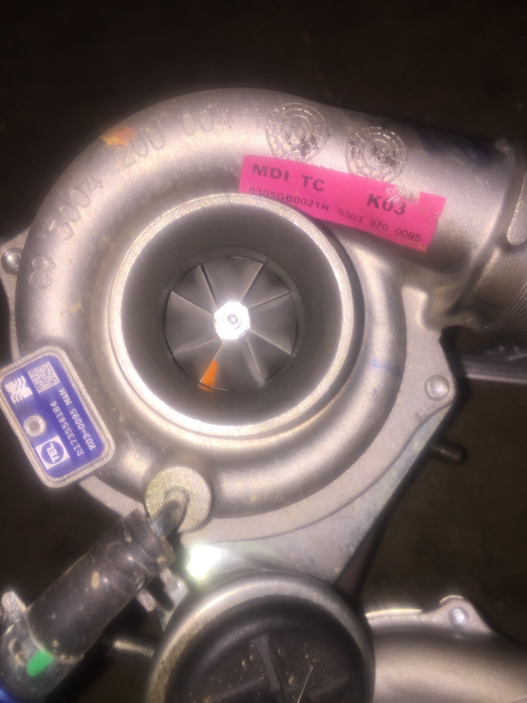

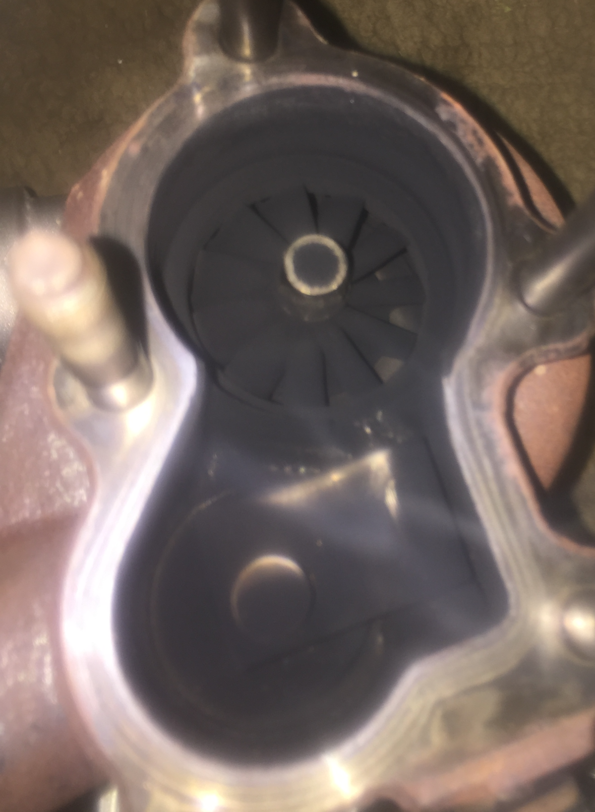

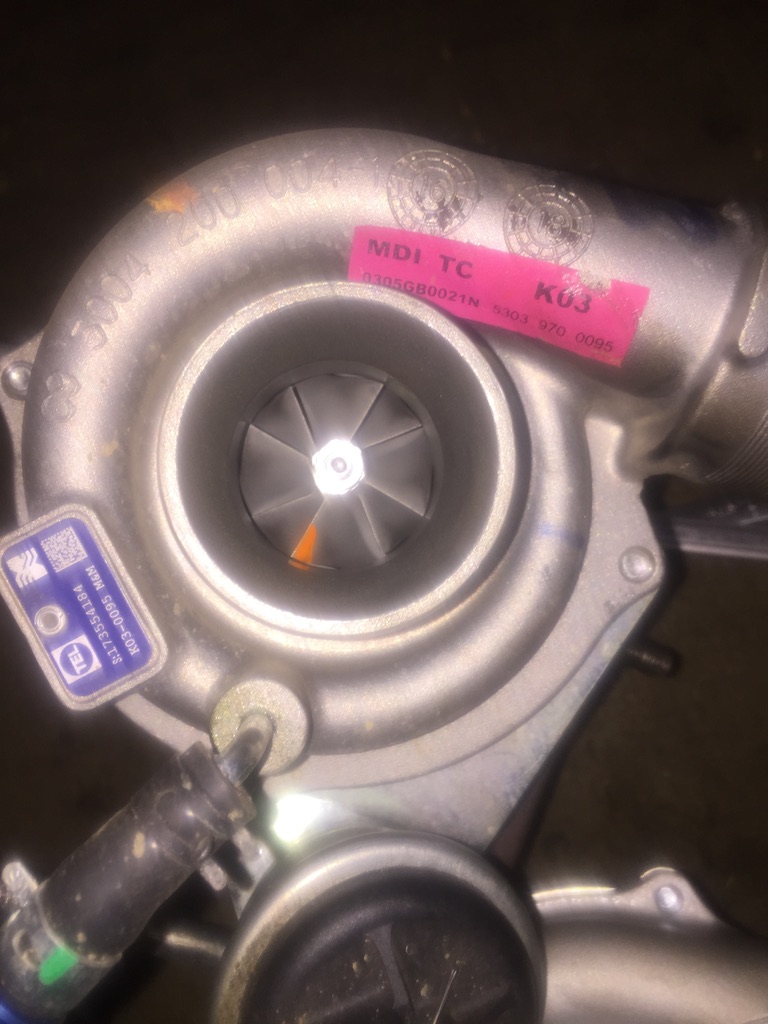

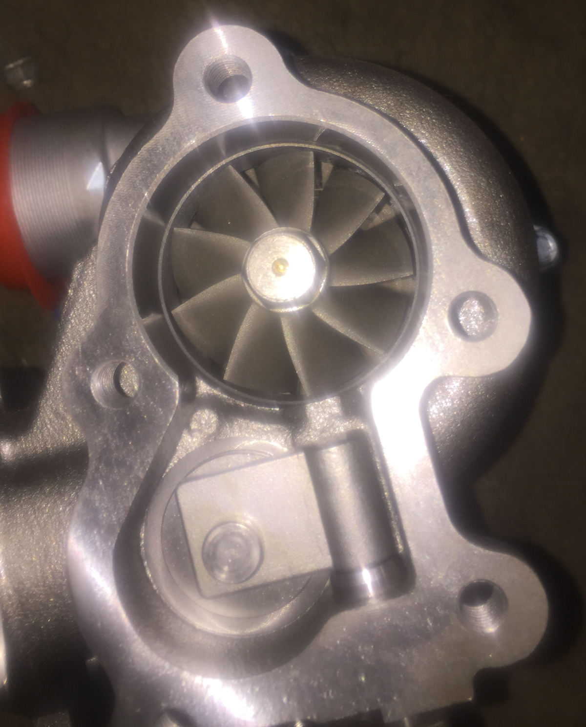

turbos have an "efficiency" range so if you have a tune and added the boost increase restrictor you are pushing the OEM turbo out of its "efficiency" range. once you do that the boosted air is very hot, that increases EGT,s.. I to have the upgrade turbo, installed Thanks giving day its a great up grade. reduced EGT's less black smoke witch means i now have a better combustion burn making more power. For anyone with a "stage 2' or more performance the turbo is a good thing.
New turbo, turbine.
Old turbo, turbine.
New turbo, compressor
Old turbo, compressor

Got all that. His thread suggested he just installed a bigger turbo and doubled his boost? Never mentioned a tuner or anything else. If in fact just the turbo alone did double the boost (it would not) codes and defueling would ensue without a chip or programming.
New turbo, turbine.
Old turbo, turbine.
View attachment 6162 View attachment 6163 View attachment 6166 View attachment 6167 View attachment 6168
Haerterich, you made my point and thanks for posting the pics. I just made a quick post, didn't think everyone would jump all over it. I guess I should have posted more pics and more data like you did. For the record: yes I have a stage 2 tune, upgraded air box, installing ceramic clutch this week, and plan on adding intercooler as well. So far I haven't had excessive EGT's but will add cooler anyway, I installed gauges to monitor boost & temps. LOL ---that's what the pics are showing.
