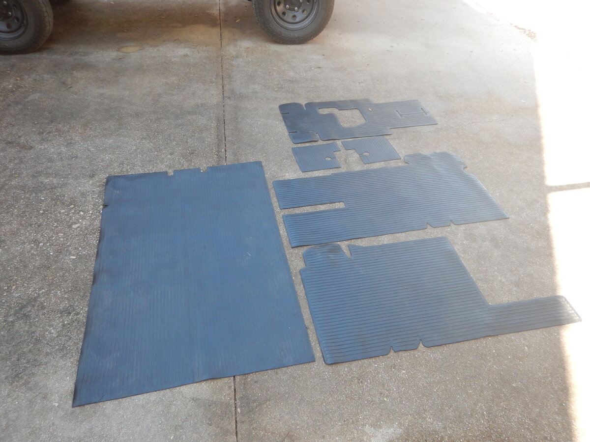

Opened the box and they were original Mahindra mats.

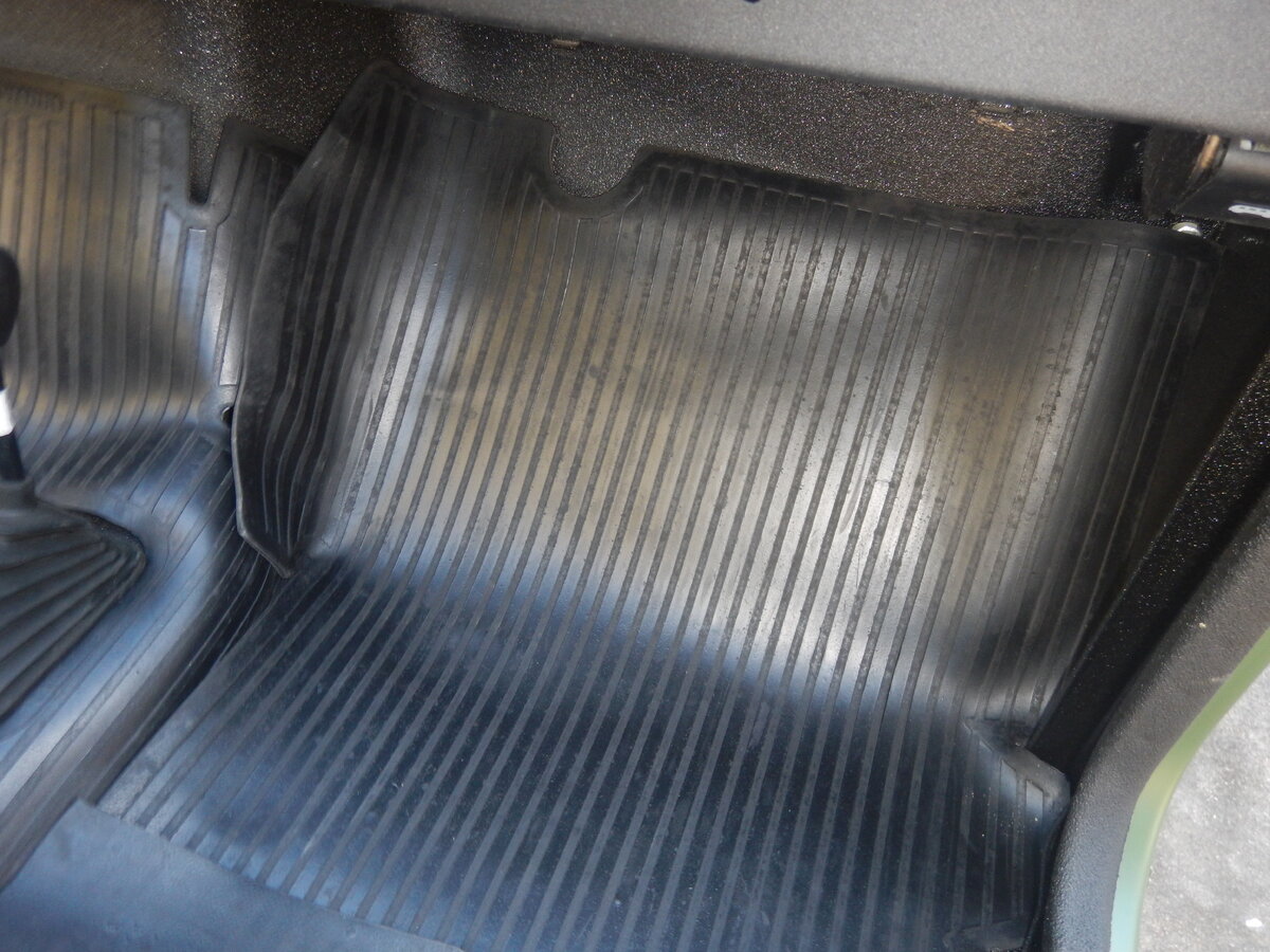

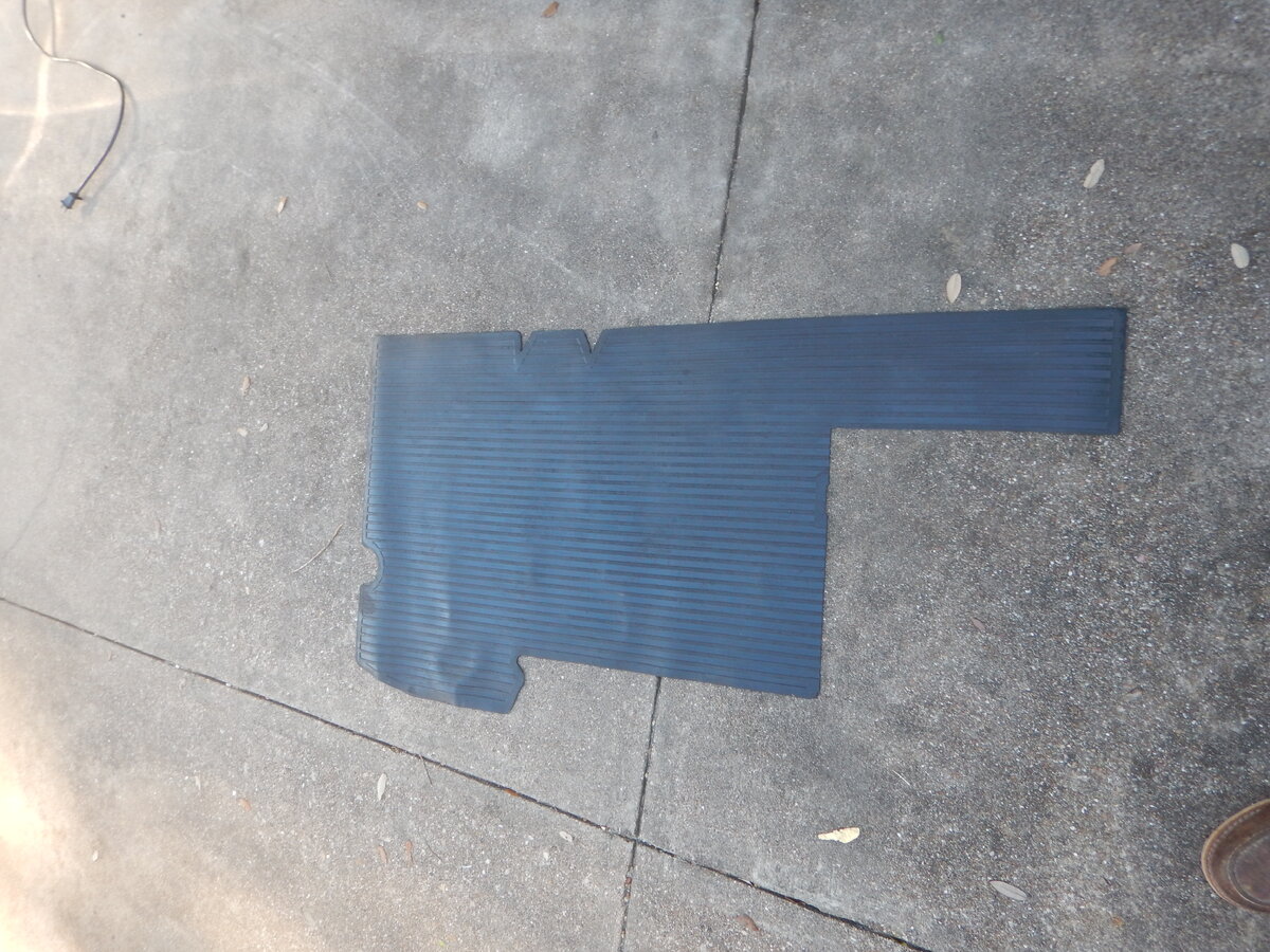

This is what they look like when unrolled from packaging and laid out.

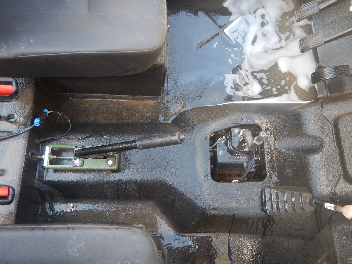

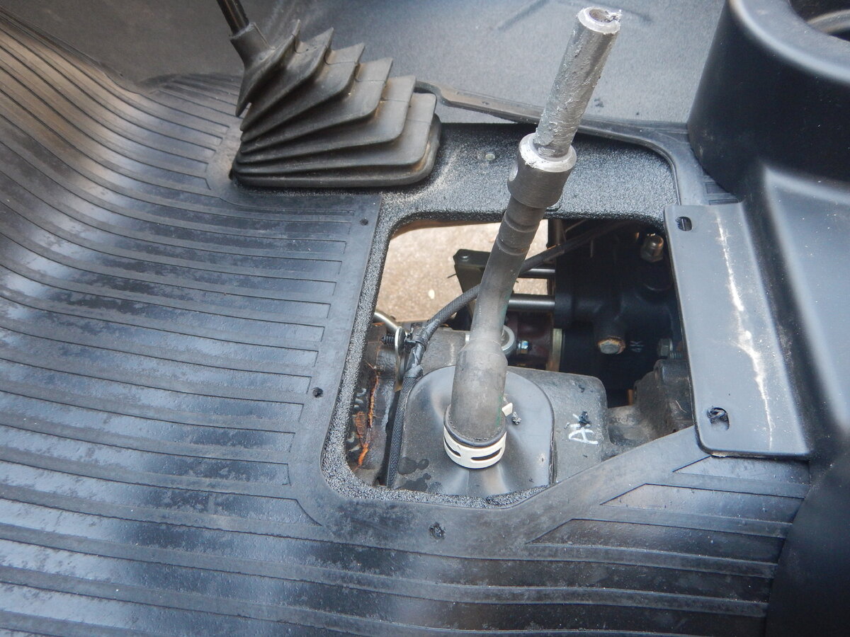

Removed the shifter boot and center console cover as well as cleaned out dirt and dust from floor.

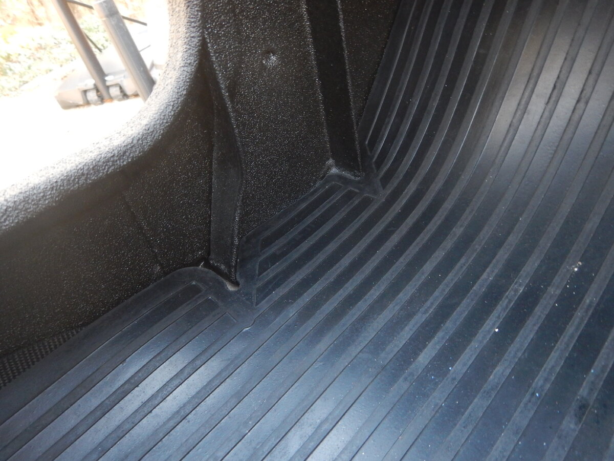

Had to do some cutting for the mat covering cargo area. Before

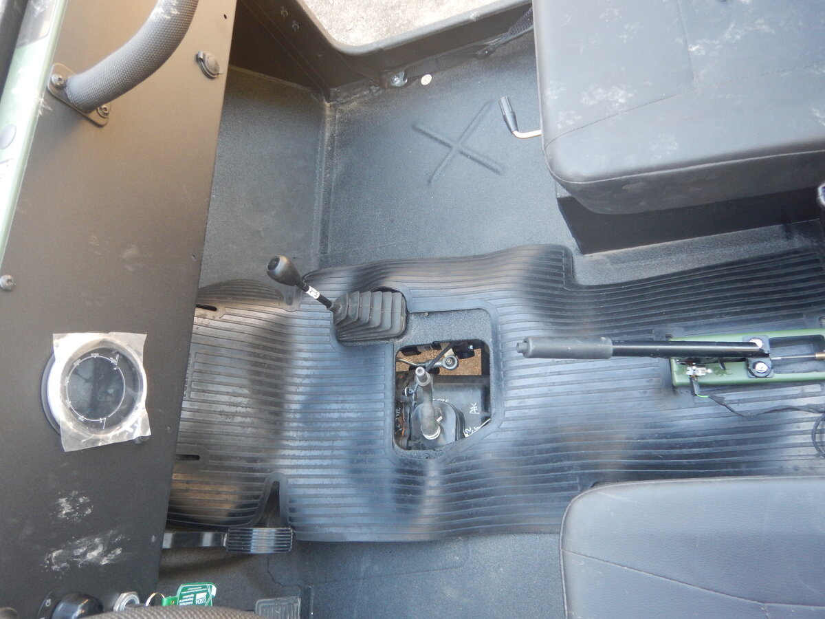

Rear mat after

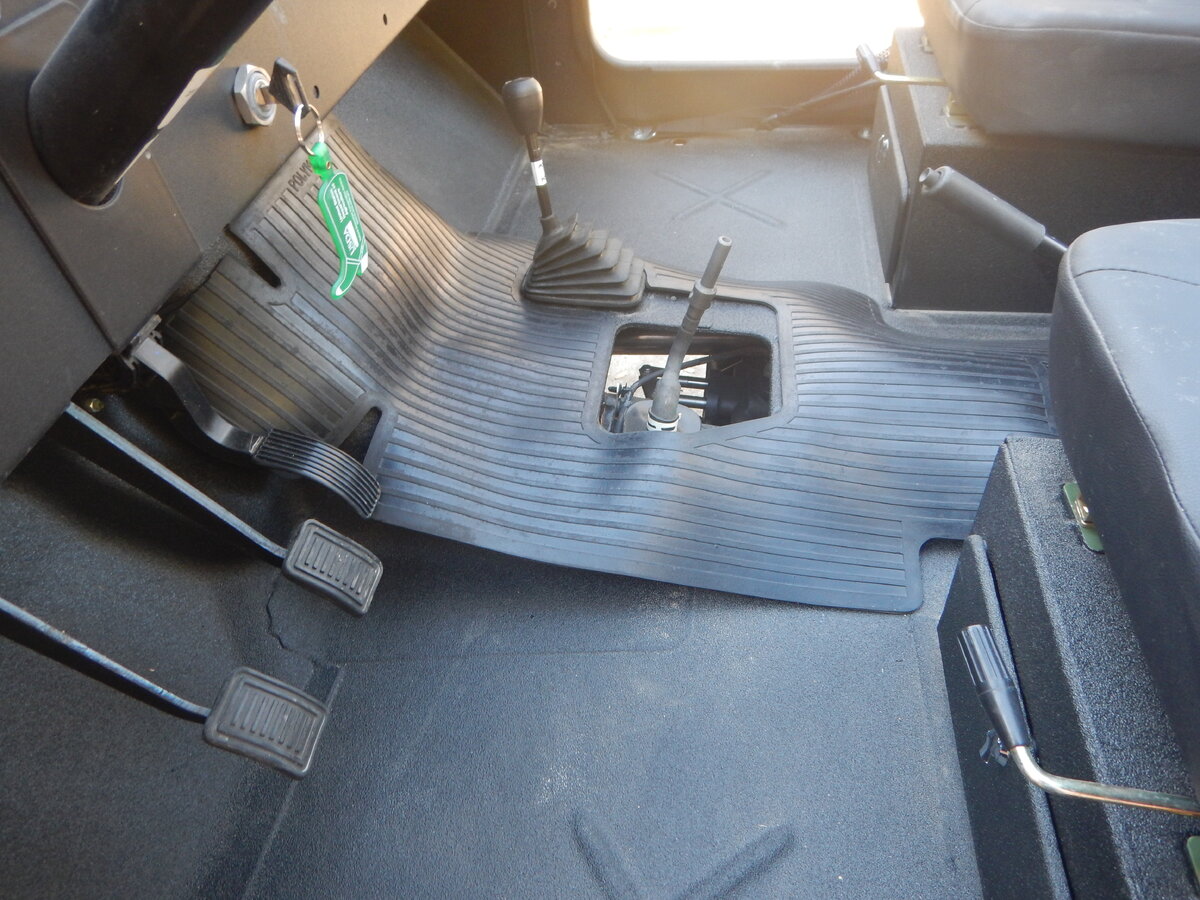

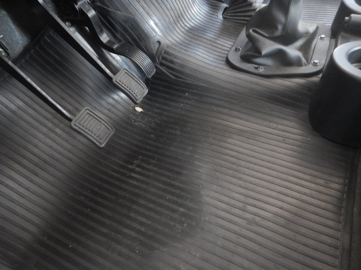

Put in the center mat. Yes. speedometer still has protective film and cats find the Roxor a comfy place to hang out.

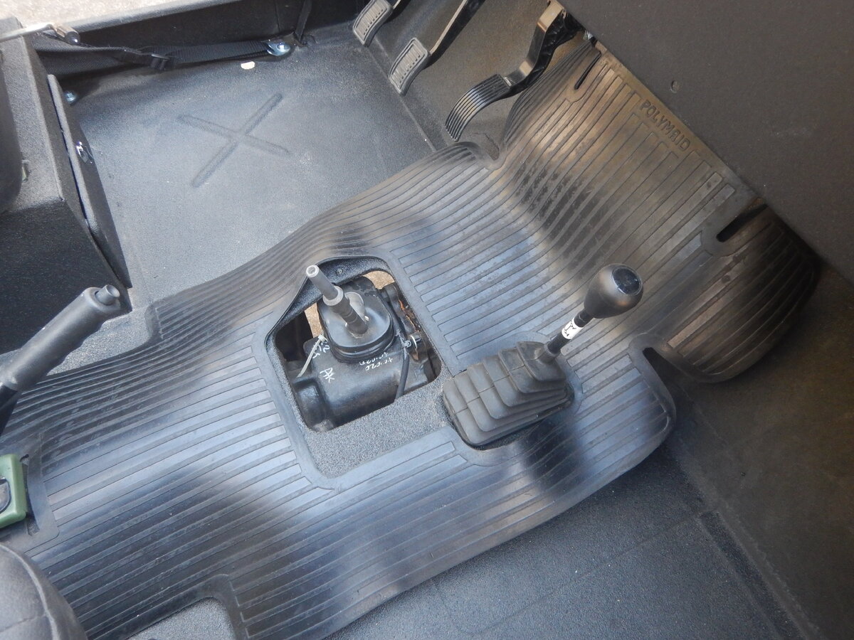

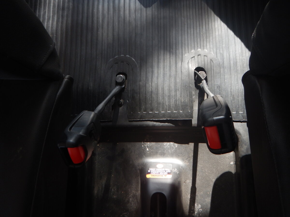

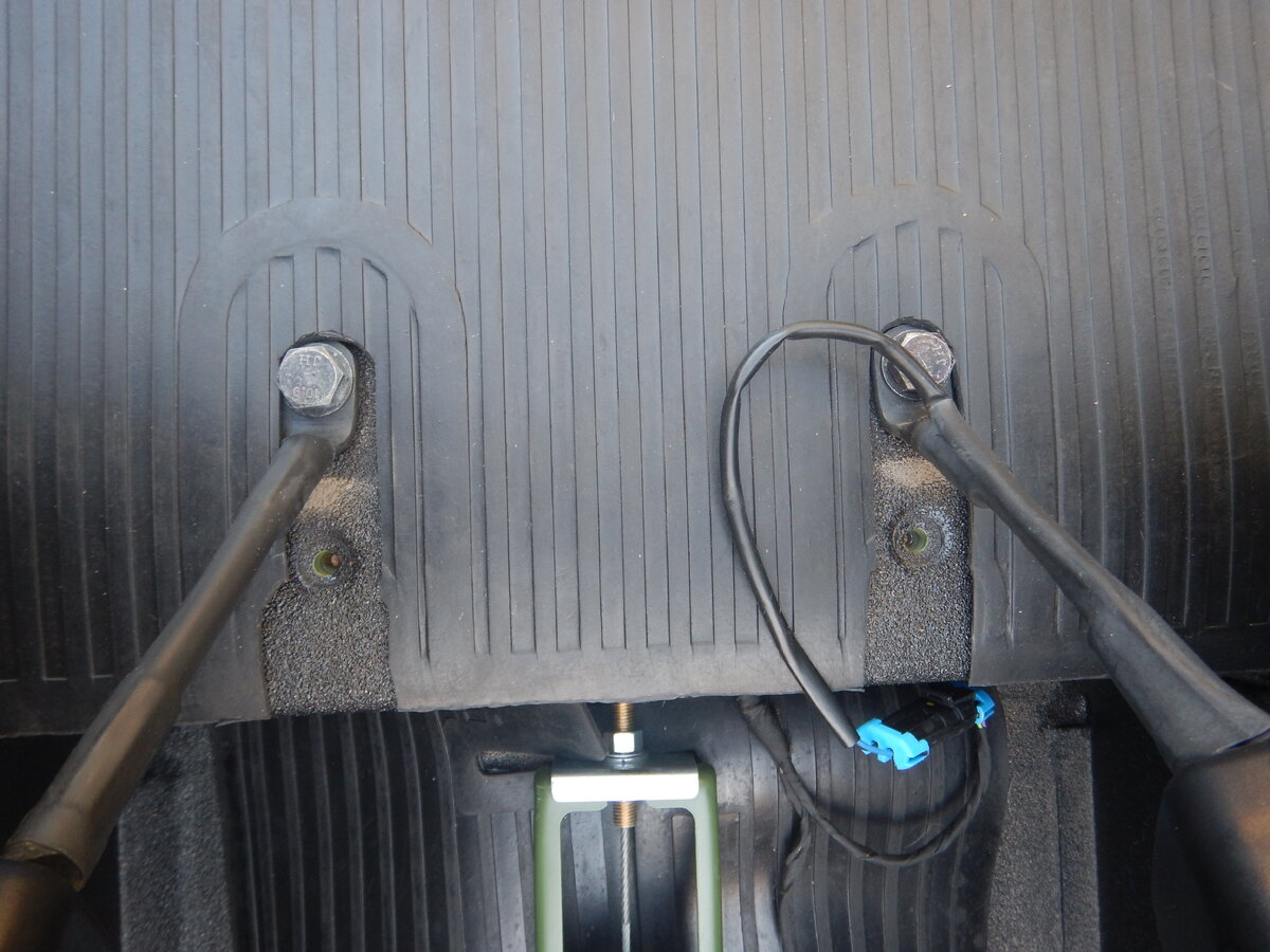

I marked the shifter boot holes and drilled through the mat. Also added some anti-seize to the shift tower so shifter doesn't rust to shift tower.

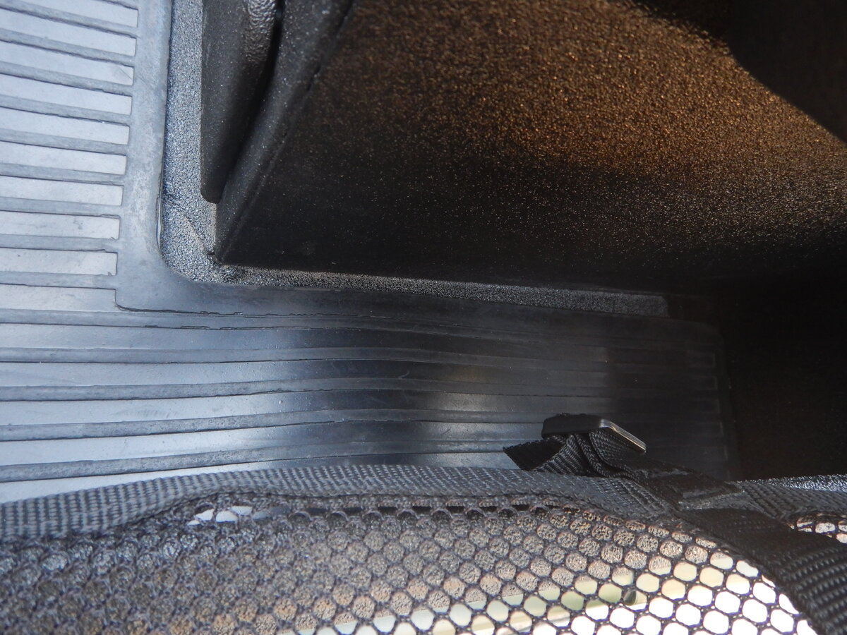

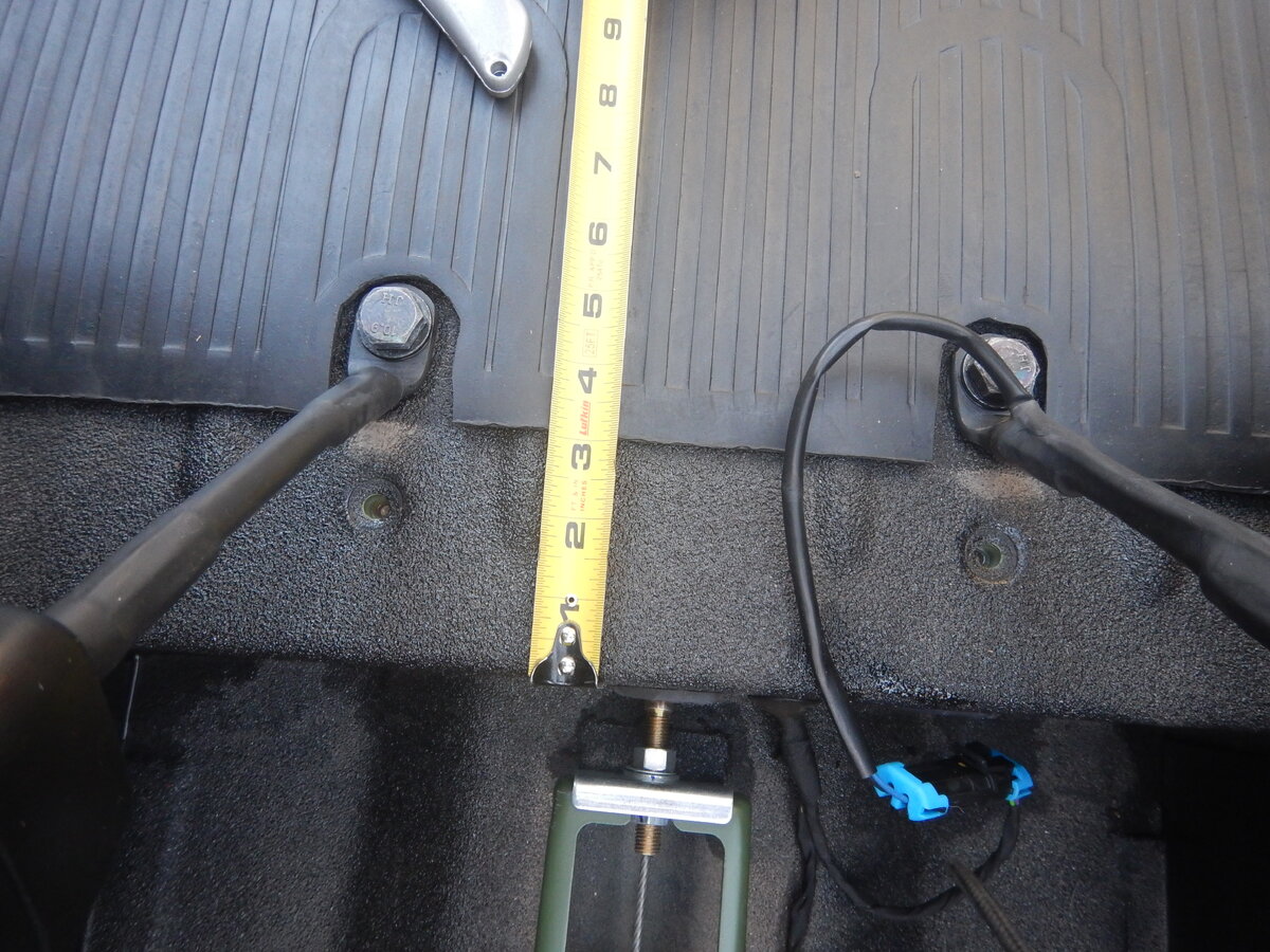

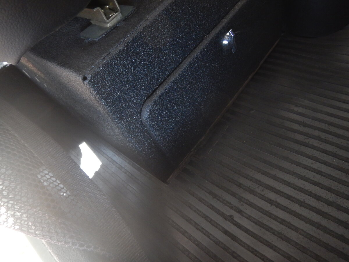

Drivers side laid in. I thought about cutting holes for the mesh fabric side curtain brackets, but decided against it. Mat laid down fine w/o holes.

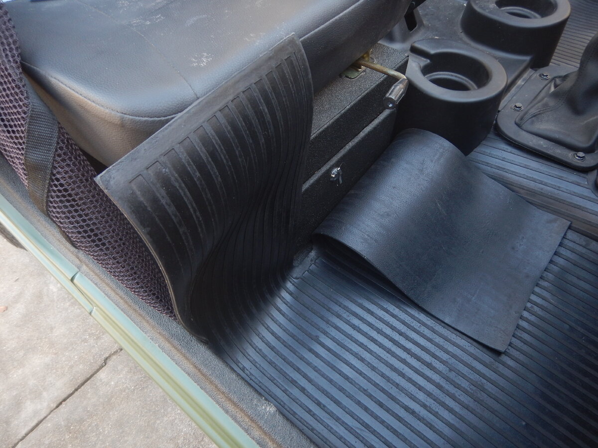

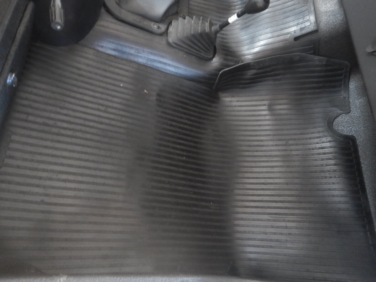

Laid in passenger side. This piece needs trimming.
Jason S
Feb 14, 2025

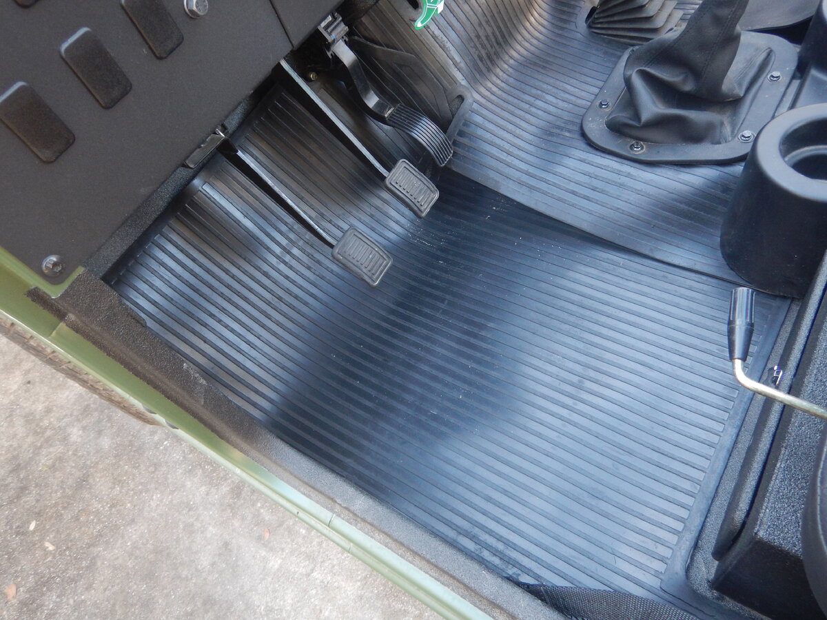

Trimmed passenger side mat
Passenger side as installed.
Driver side as installed.

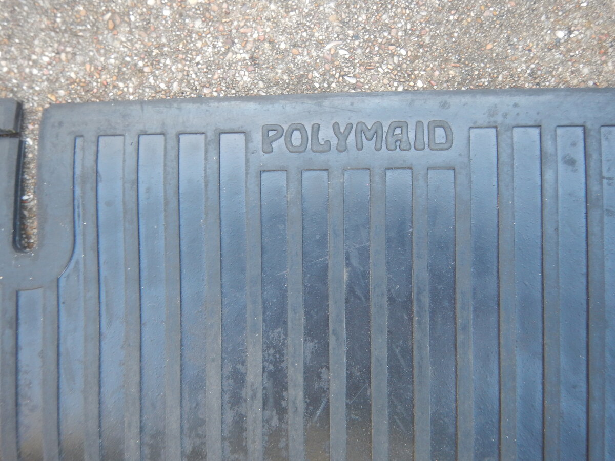

Also, this is apparently who makes the mats for Mahindra

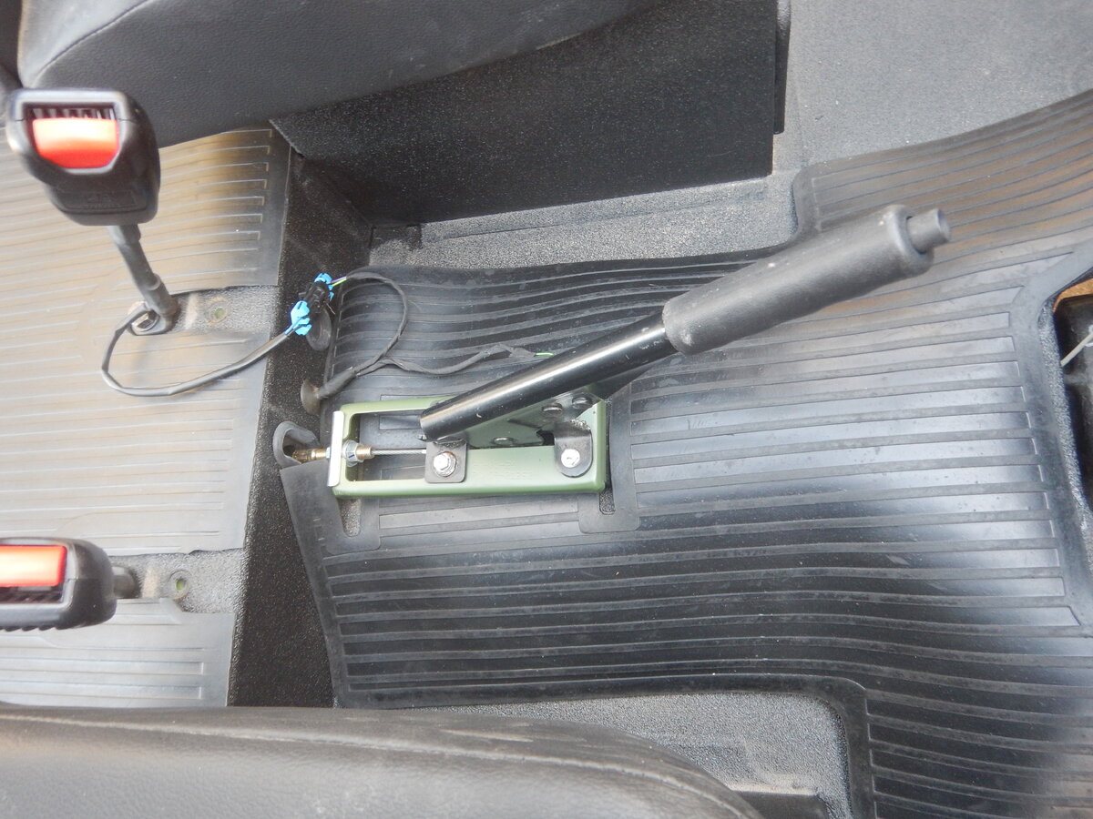

For the rear mat, if you want to install under the center console, you will need longer bolts. I just bolted console down and laid mat over the plastic console.
Overall, I think I like these. I believe they'll lay in better with warm weather.

Jason, Do you think a heat gun would help on the center shifter area?
Jason S
Feb 14, 2025
Possibly. Heat gun ought to let it relax where it should sit.
We had a nice day yesterday into the 70s and things were mostly laying down. Got cold and getting colder today.
The mats came rolled up and apparently had been that way for over a year. Unrolled the mats and I let it set in the house for a few days to get flat.
I reckon with warmer temps and now being in place, it ought to settle in where it should be. As is, it sits pretty good.
