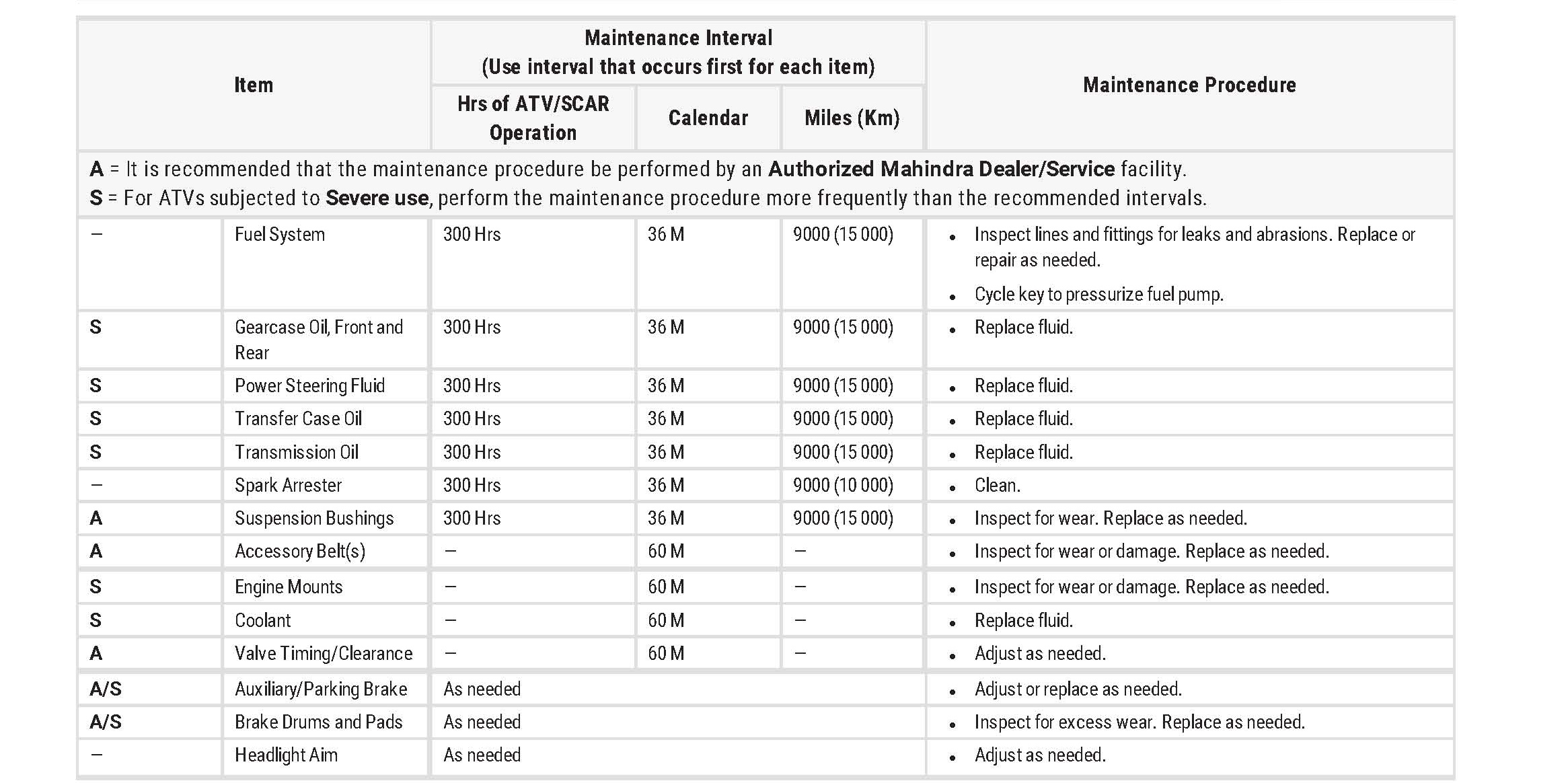

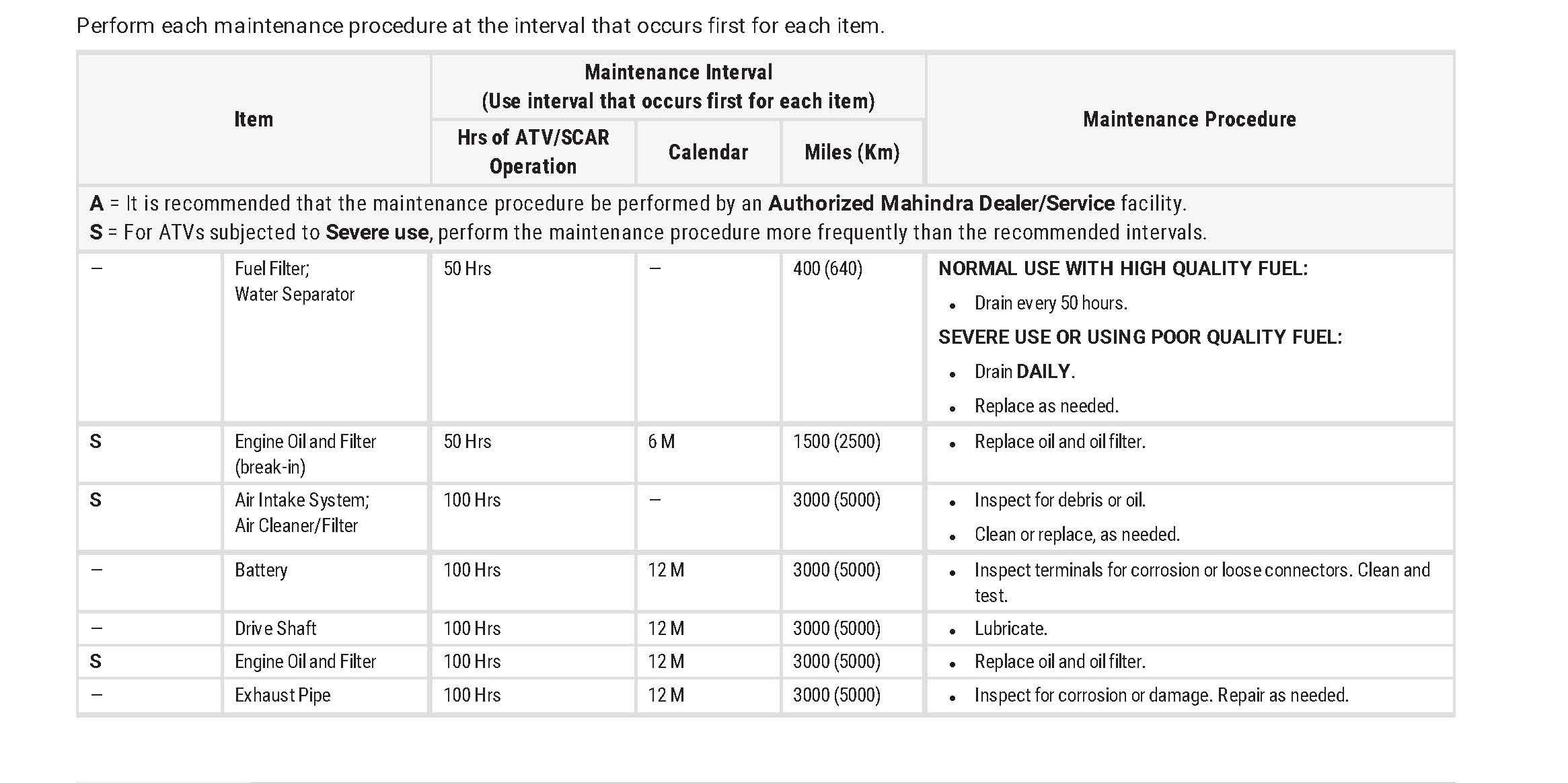

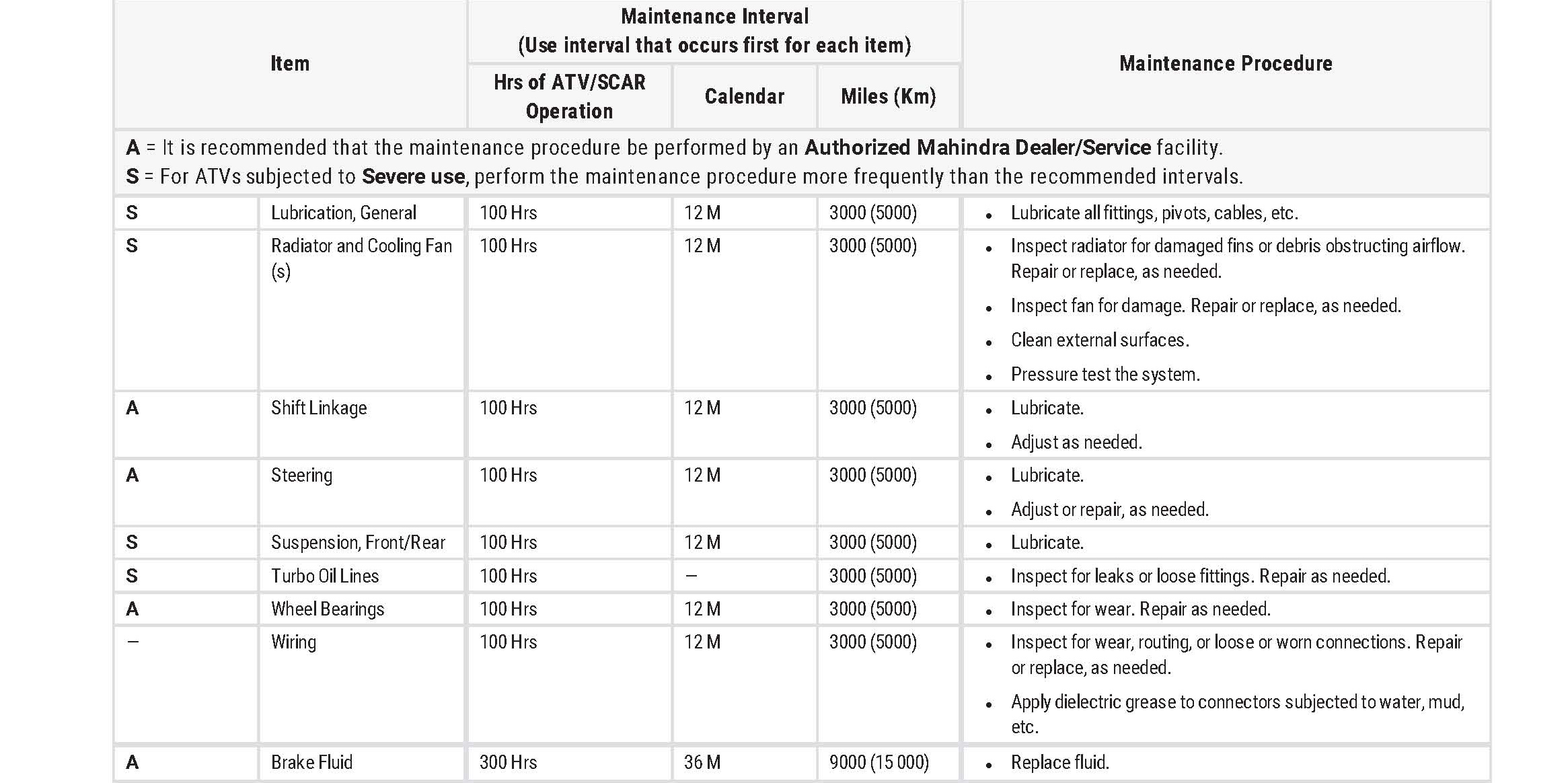

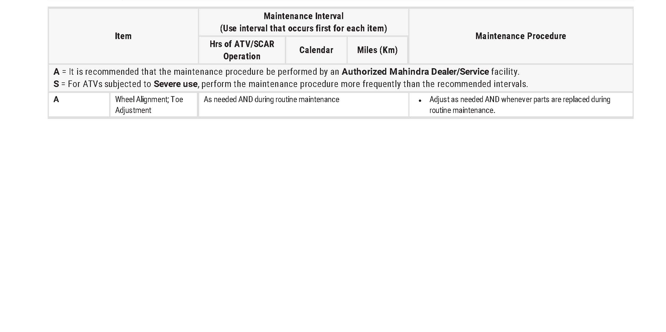

Attached is the Maintenance schedule for the Mahindra Roxor ATV
Please note the following A/S marks.
A = It is recommended that the maintenance procedure be performed by an Authorized Mahindra Dealer/Service facility.
S = For ATVs subjected to Severe use, perform the maintenance procedure more frequently than the recommended intervals.
