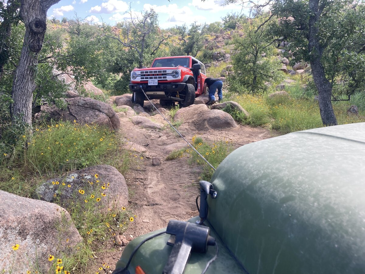

I feel Deflated Tx, Seeing a Bronco pulled out of rocks. Not that I care for the new broncos but I am a fan of the older ones.
I will think of this photo if I need to pull a Tesla out with my Roxor!
1,252
To be fair that’s an essentially a bone stock bronco cept for lots of skid plates. He only had it about 6 weeks and this was its maiden run. unfortunately his rocker armor didn’t come in in time for this trip so we had to be extra careful. We were both new to this park and came across this creek crossing with huge boulders. He about freaked when he saw me rock bouncing my way thru. I knew he was gonna struggle due to lack of ground clearance. And I was right. He hung up on a rear control arm mount. I think he could have made it with more attempts but the risk of body damage was huge. Thus I winched him up and over. We had to stack rocks several times to gain enough clearance. I had to snap the pic. It’s not often you see a Roxor recovering a bronco.

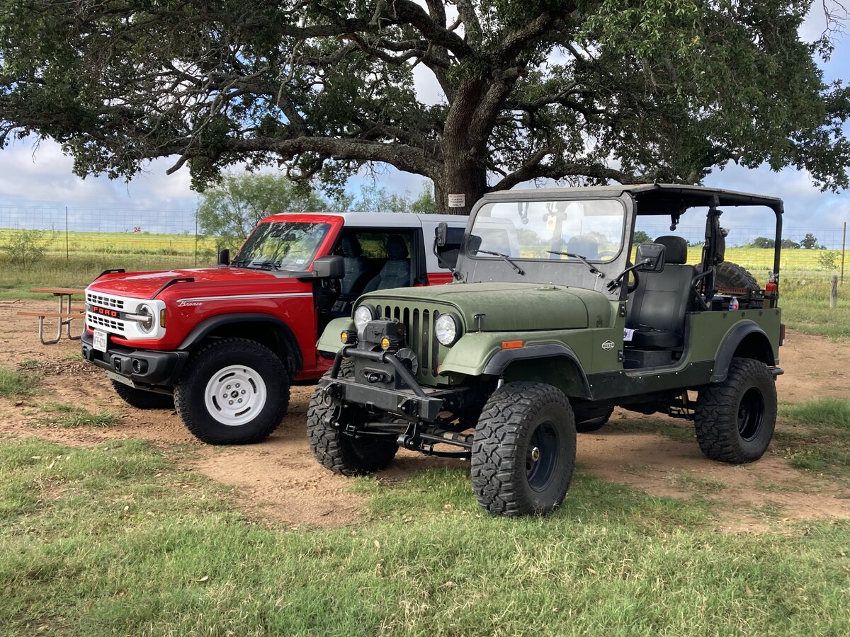

txroadkill your Roxor looks very capable. My 2024 is the same color, and is equipped pretty much the same as yours. My Hi-Lift Jack is on the Hood. I would rather have your body style than mine. Is your winch a Warn? A friend has one like that on a RAM Charger I believe it is called. Dodge or Plymouth version of a full size Blazer. The Bronco owner probably needs to stay on an improved road :)

Looks like you have a 42" Stubby Bumper on the front. Do you have the Cecco Farm Bumper on the Back?
Where did you get the Rock Rails? They look pretty good in the picture.
I really like the Grill also.

I have the cecco tire carrier and bumper that is no longer available. The rockers are also cecco. and the 8274 can hold 150‘ of line. in regards to winches and lines don’t just settle for cheap. Remember it could very well be possible that your rig and life are dangling from a cliff, do you want cheap or quality? I’m all for saving a buck but I won’t do so at the expense of quality. Spend once cry once.
