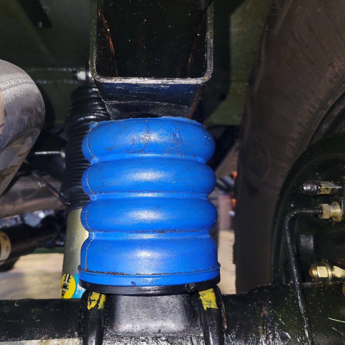

I installed a set on my Roxor. Without them with two guys in the back it was always bottoming out. I used the universal model and cut 1 donut off. There are shackles on mine to level it out with new front springs. The size you need will depend on the distance between axle and frame. I attached mine to the axle.
