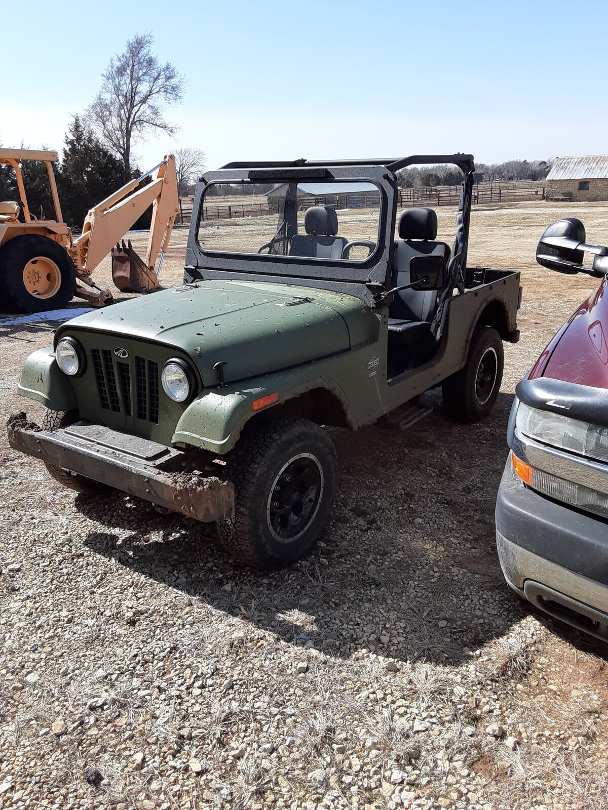

2019 Roxor getting a lot of use on the farm. Backup lights stay on if I park it in Reverse. Anyone else experience such a thing?
