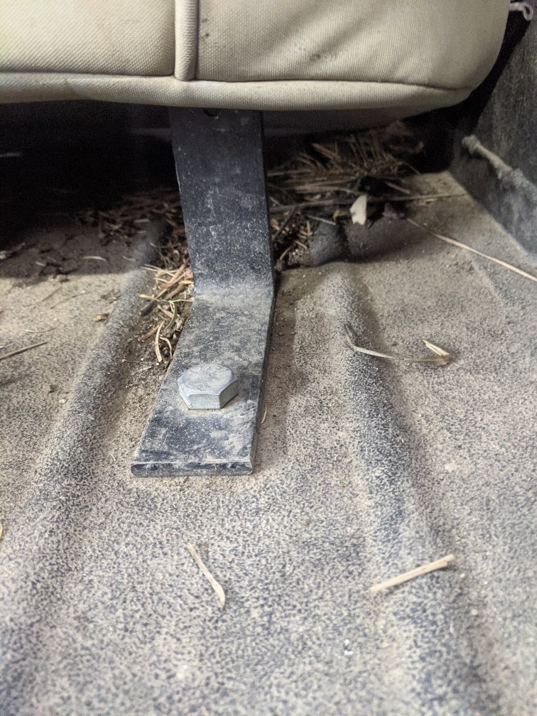

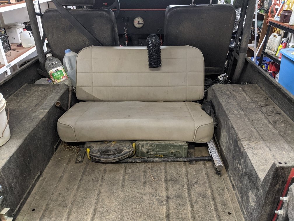

This is a smitty built for cj5. Bolted directly to floor with some washers on back side.

Is that a heater vent I see draped over the seat?
