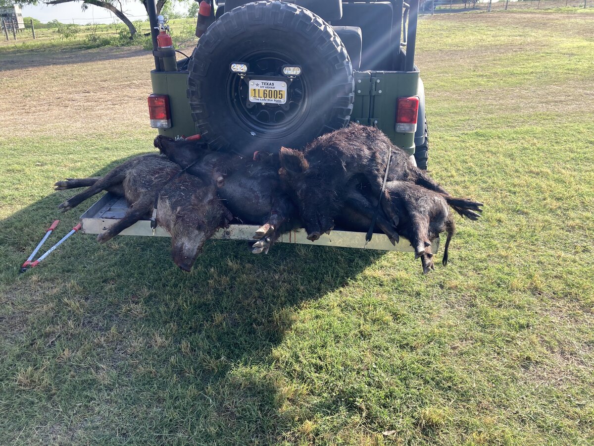

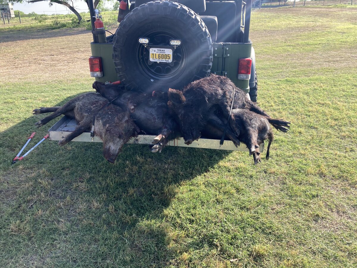

not exactly what your looking for but it was my solution. A pair of small leds from TSC work great. only thing I’d do different is get a work light. These are more spot vs a flood light. They attach to the license plate bracket made for Jeeps.
