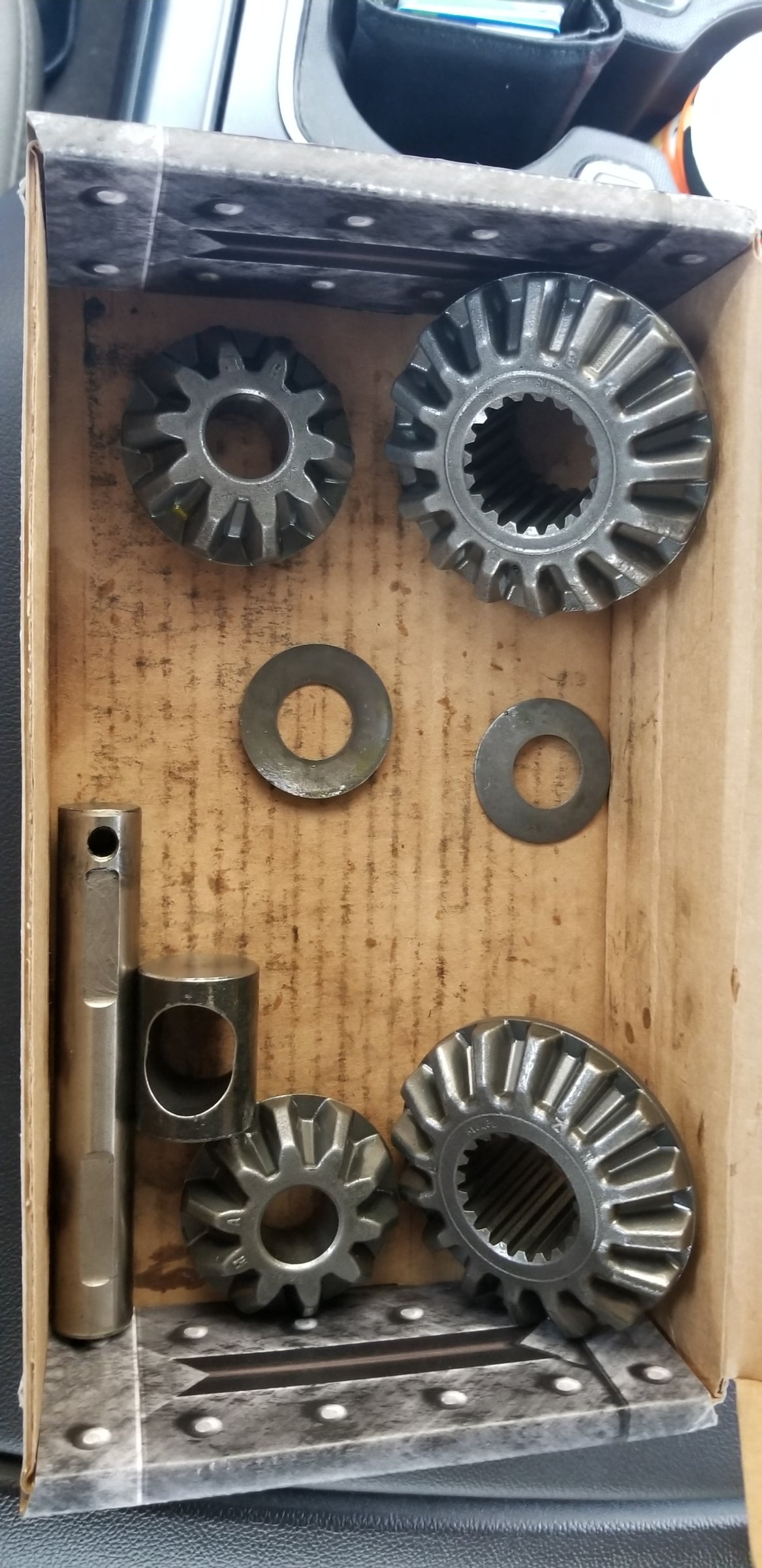

Hey, my brother just bought a roxor on repo from a bank, only 45 miles on it. I think maybe previous owner might had installed Spartan lockers not sure. The machine is still burning off exhaust paint so we know mileage is correct. rear end is making a noise. jacked up back end wheel makes a clicking noise while turning backwards. right rear hub is a little loose.... what you all think? maybe for got to put a spacer back in? Thanks

That sounds like spartan type locker, I didn’t like mine at first but 3800 miles and it is not as loud or jerky as it was when I installed it.
2,287
I had this problem, they forgot to put a spacer in from the org. parts they took out. I believe it is the short barrel one with the Oval hole.
Clicking is normal when jacked up or on pavement.
Here is a video to check if they are working correctly.
If you are not sure if the spacer is in there or you have doubts, it is probably worth your while to pull the cover and check. There are spartan locker installation instruction on the Roxor website. Here's the link: Accessory Installation Instructions|ROXOR Offroad
