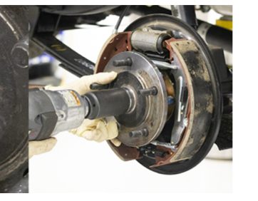

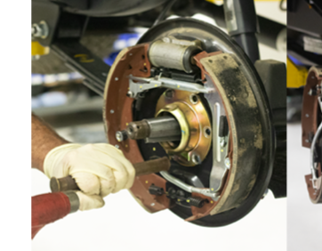

Here is a picture of the rear brake from the Rear Locker installation instructions. Hope this helps.
Here's the link to where I got the pictures:
https://s3.us-east-2.amazonaws.com/...structions/Spartan+Lunchbox+Locker+-+Rear.pdf
I'm guessing that is the left rear, but I have been wrong before.

Thanks for the link. The pic that displays the muffler shot gives a decent view to the lining and it is indeed like mine. Really goes against conventional wisdom as to how typical brake shoe installation was always done? Must be a reason?

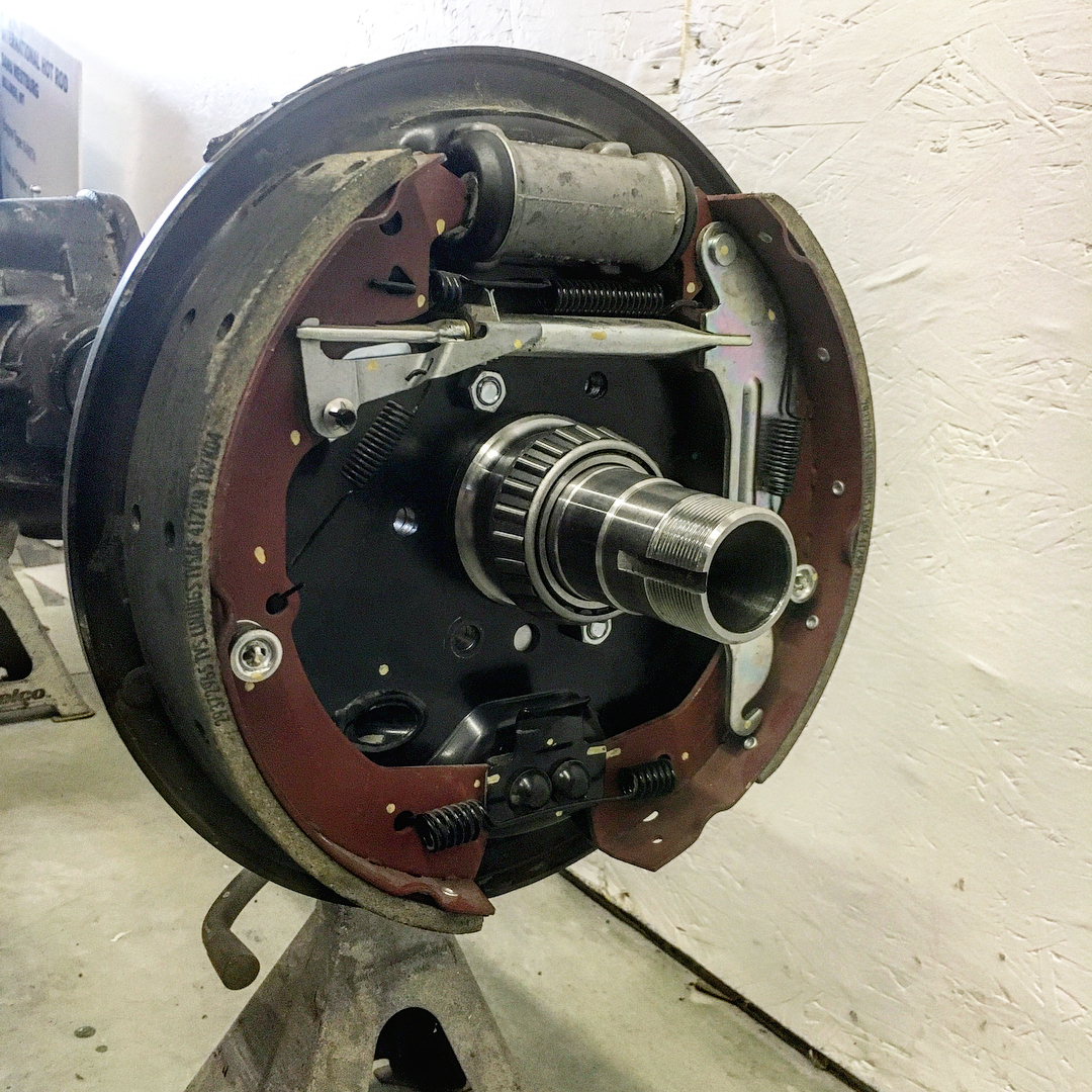

Here is a good picture of the rear brakes. One can clearly see the shoes appear to be installed backwards? Typically the shorter (primary shoe) is installed in the forward position while the longer (secondary shoe) goes aft. I noticed this on mine when I pulled the drums.
