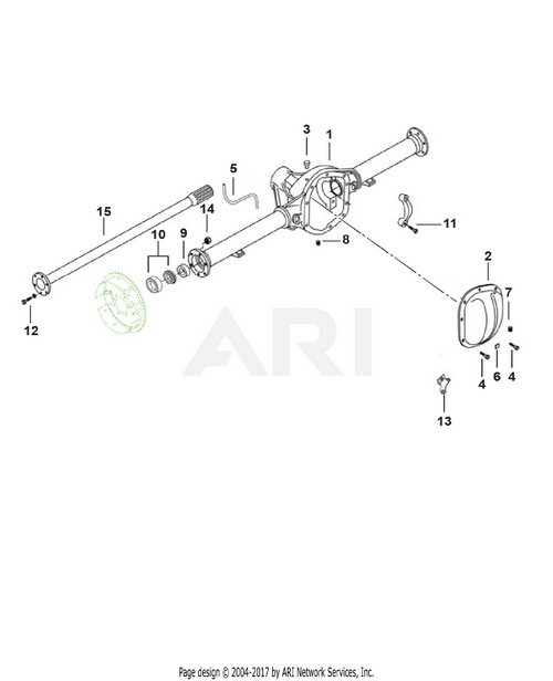

They are 1 piece!

Just to clarify your question, the rear axles are 1 piece but the flange is not integral to the shaft, it is a tapered, keyed fit, retained with nut. There is an additional exploded view in the Roxor Off-road parts book, page #U4A140005.

The above photo appear to be one piece....wrong photo possible??.....the older CJ's were the tapered design...pitiful
