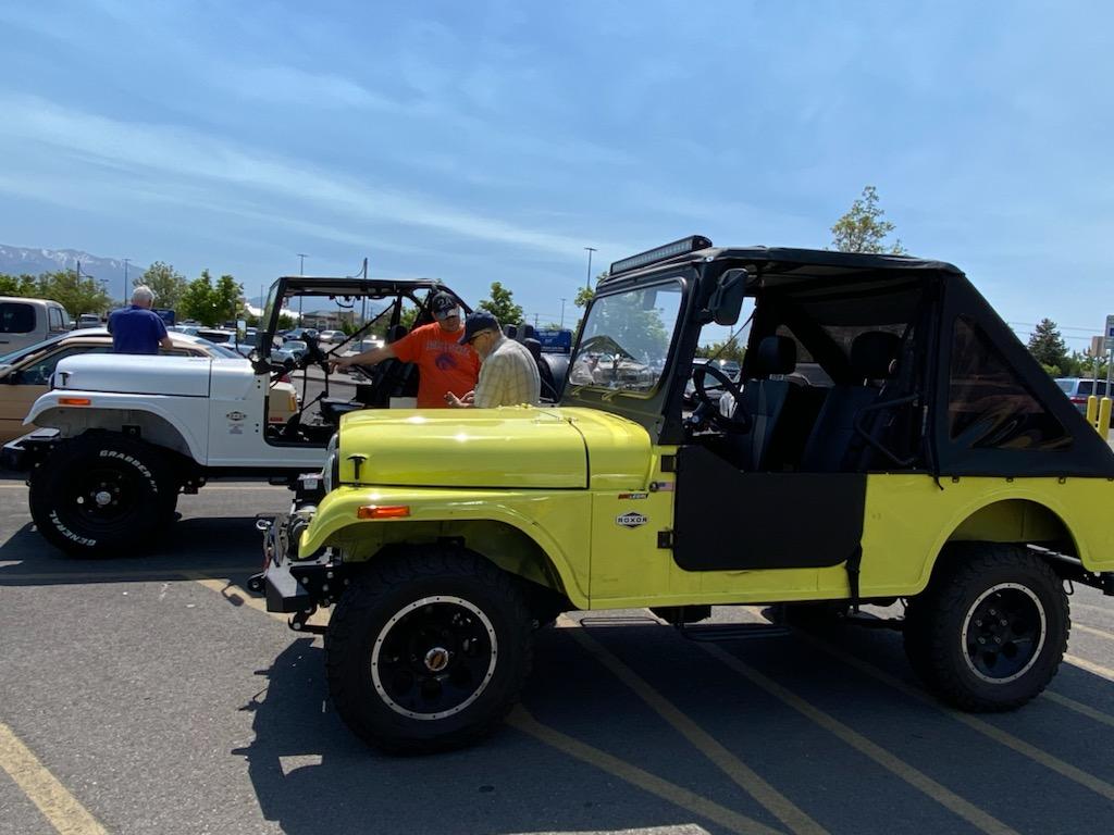

There are three of us from here headed up to Francis peak in Farmington on Sunday. My last ride before I get my foot worked on. We would like to get our own get together of Rox owners here. I know of two that aren't on here that I've meet that live around Davis County

I've tried my friend who helped me redo my rollcage. He doesn't seem interested, and a yellow one out of Syracuse. Retired guy
