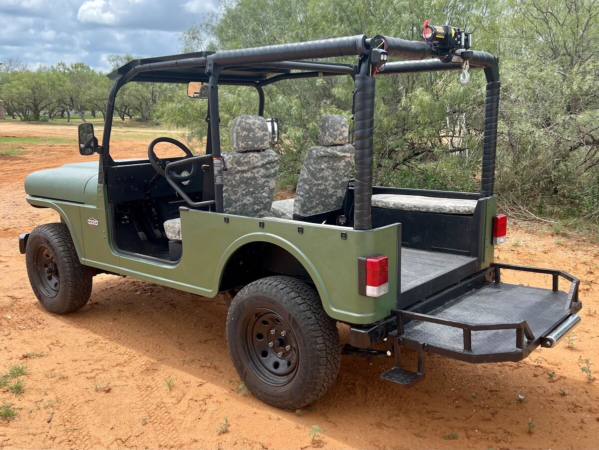

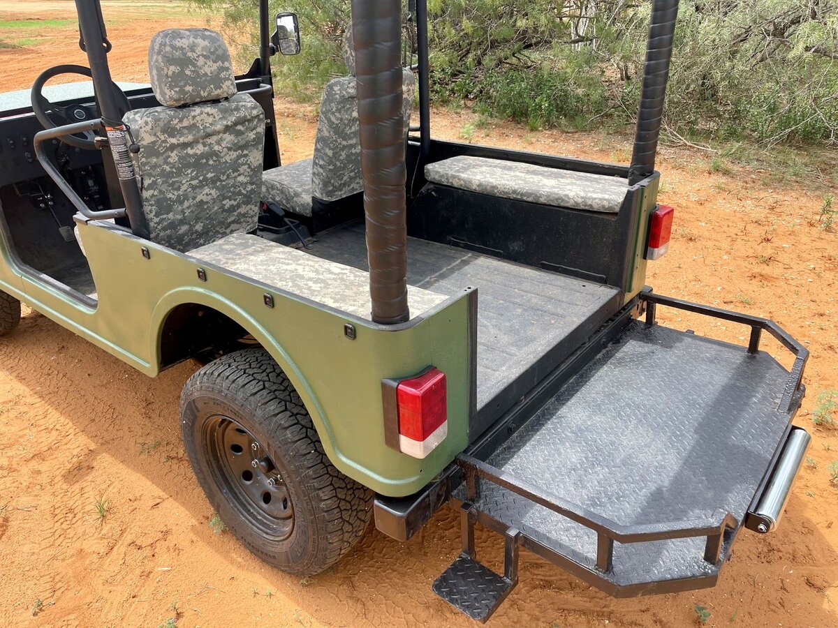

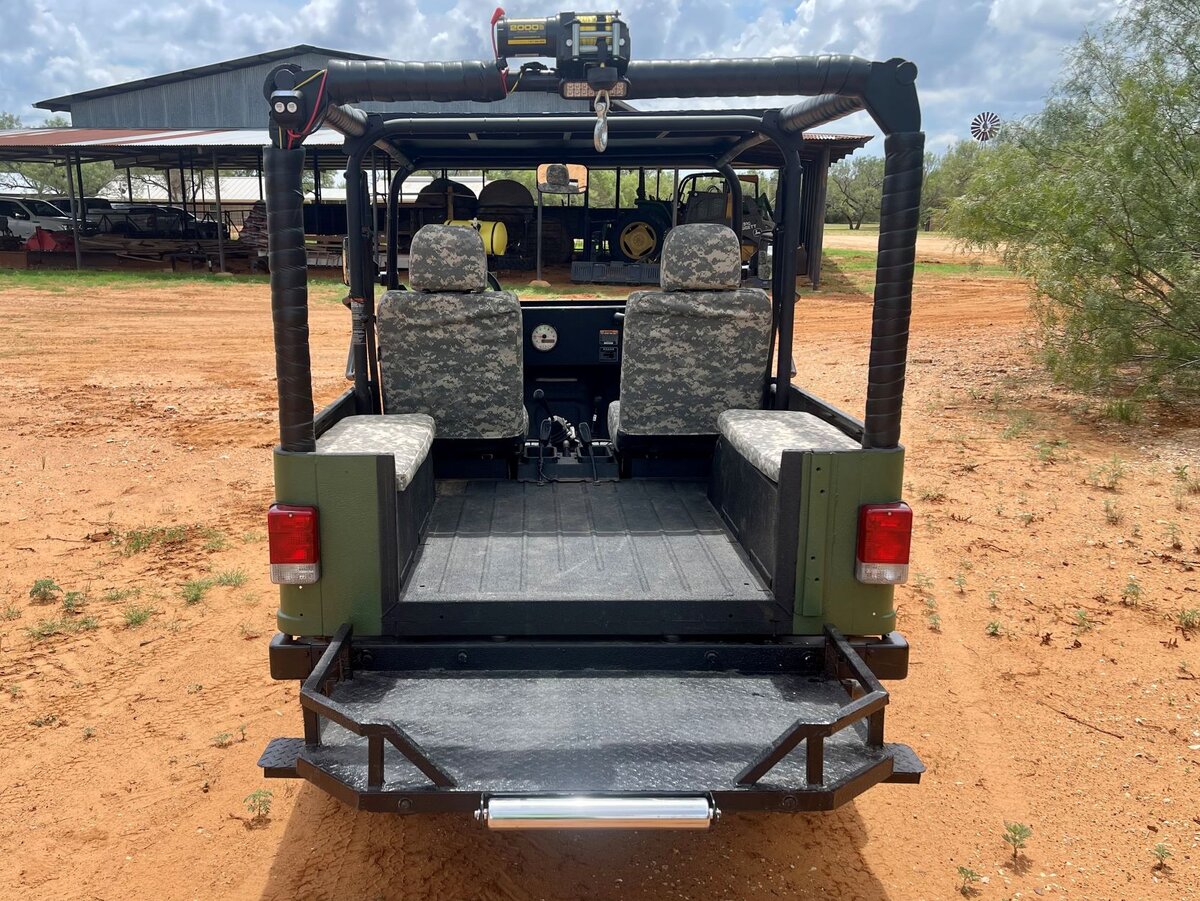

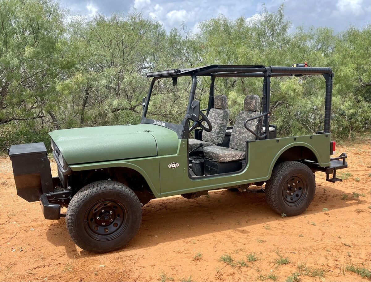

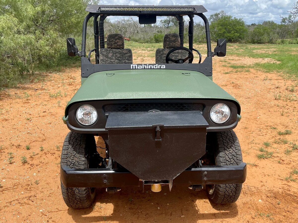

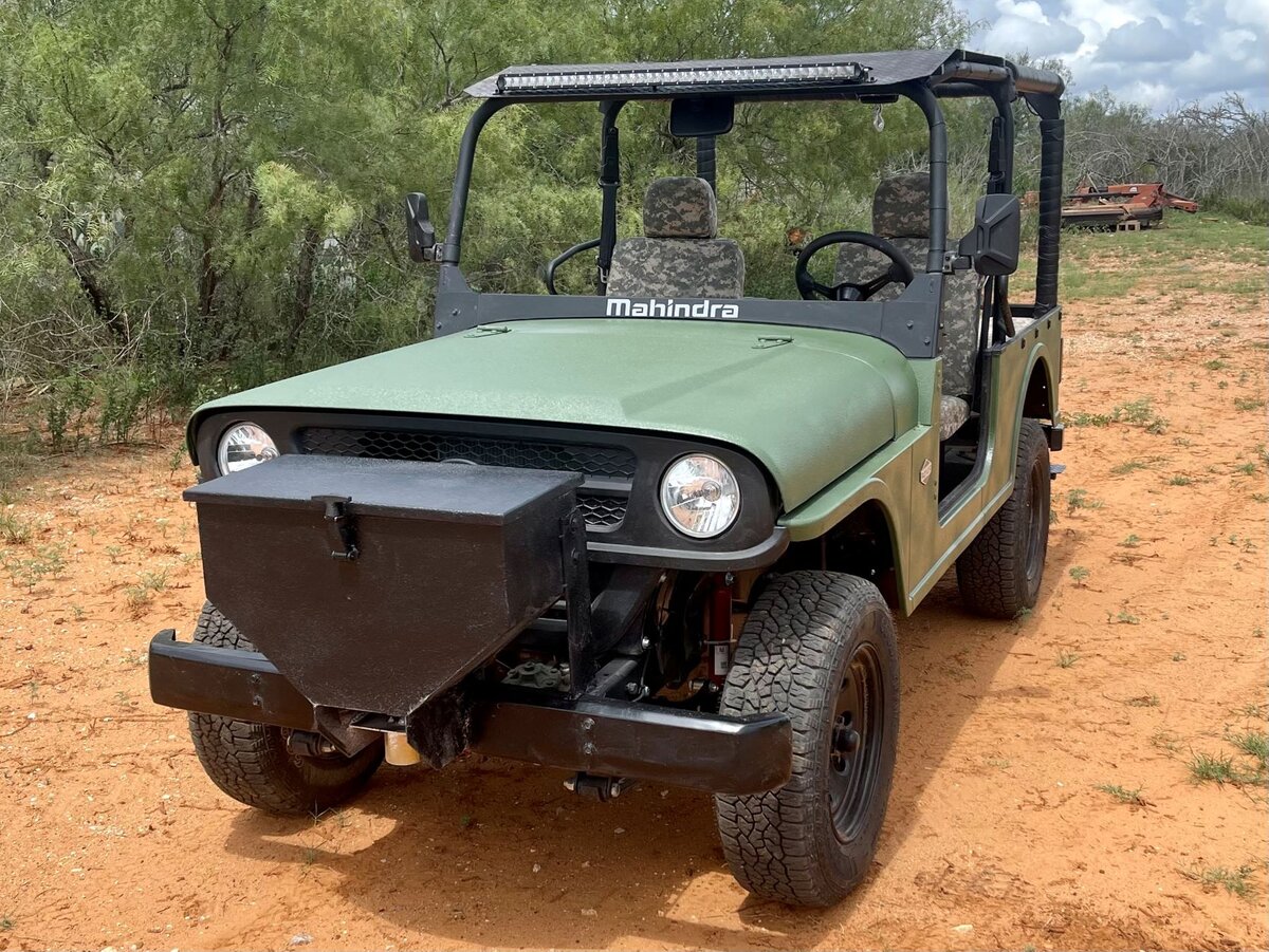

I have a new 2022 Roxor for the Ranch which I bought to replace an old 2007 Jeep Wrangler JK. I wanted to customize it for hunting and general utility work. These are the custom upgrades/improvements I did:
1. Bed Liner Paint Job on Exterior (Army Green and Black Combo).
2. 100 lb. Corn Feeder on Front.
3. Rear Cargo Platform for Hauling and Deer with Side Steps.
4. Roller on Rear Platform to Accommodate Winching Deer.
5. Additional Extended ROPS Wrapped in Pipe Wrap.
6. Winch on Extended ROPS for Deer.
7. Welded Top Roof Made of Diamond Flooring Plate.
8. Light Bar on Roof.
9. Interior Lights in Cab.
10. Exterior Rear Light Near Winch.
11. Front Seat Covers.
12. Rear Bench Seat Cushions to Match Front Seat Covers.
13. Rear View Mirrors.
I hope this gives people some ideas for their own builds... Good luck...
