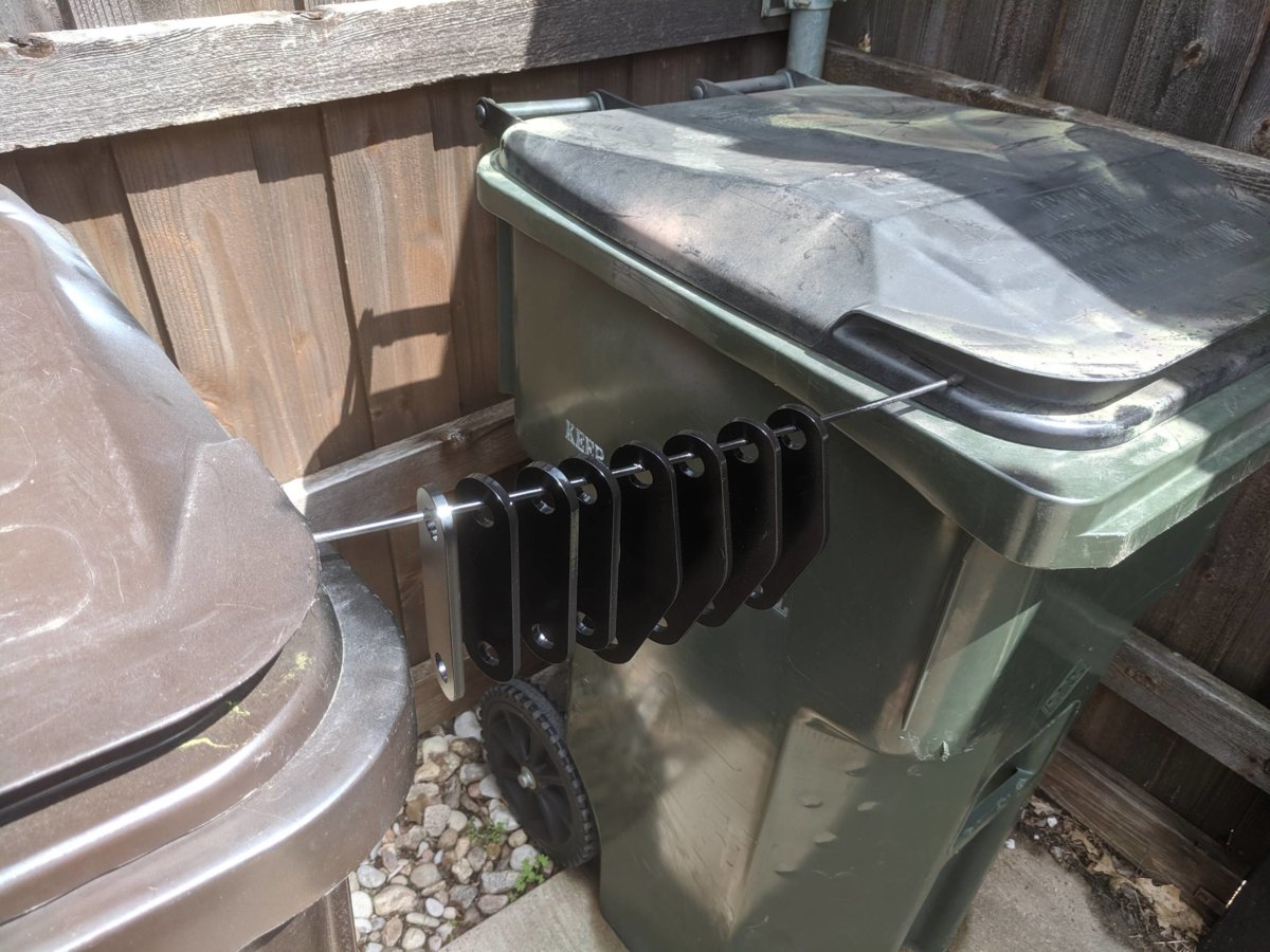

The shackles are raw steel the same thickness as the OEM shackles. The fronts are boomerang shaped and the rears are straight. Why they are shaped this way as opposed to being straight I have no clue but they look good. The rear are straight. Max preformed a fabrication clean up by sanding the sharp edges. I decided to paint them Semi Gloss black to look OEM. So I first hit all the edges with a wire brush in my 90 degree air grinder to remove any remaining slag from Max's Laser cutter and then hit the surfaces just to clean off any slag there. I them wiped them down with Acetone and laid them out on my paint booth, my recycle bins, for some primer and paint.
I shot one side with primer then waited 30 minutes and flipped them and primed the other side. After 30 minutes I shot the first side with black and let them dry for 30 minutes. Well wouldn't you know it, the black Rustolium paint was taking too dam long to dry. Sooooo I found an old AK-47 Cleaning rod there on a shelf and decided that it was the perfect paint rod. So I spaced the tacky half black parts on the AK rod. Hung them between the recycle and trash bins. Shot them black.

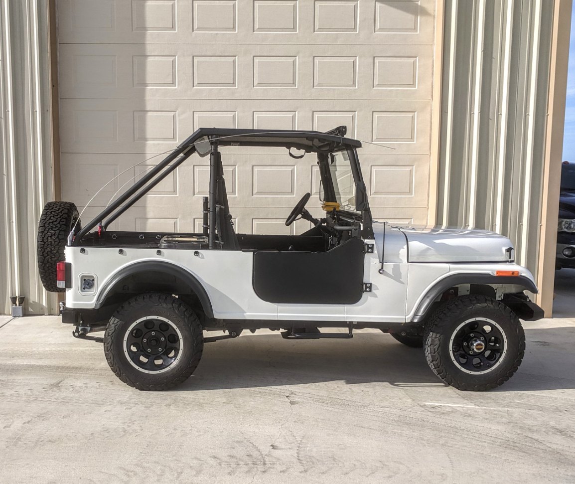

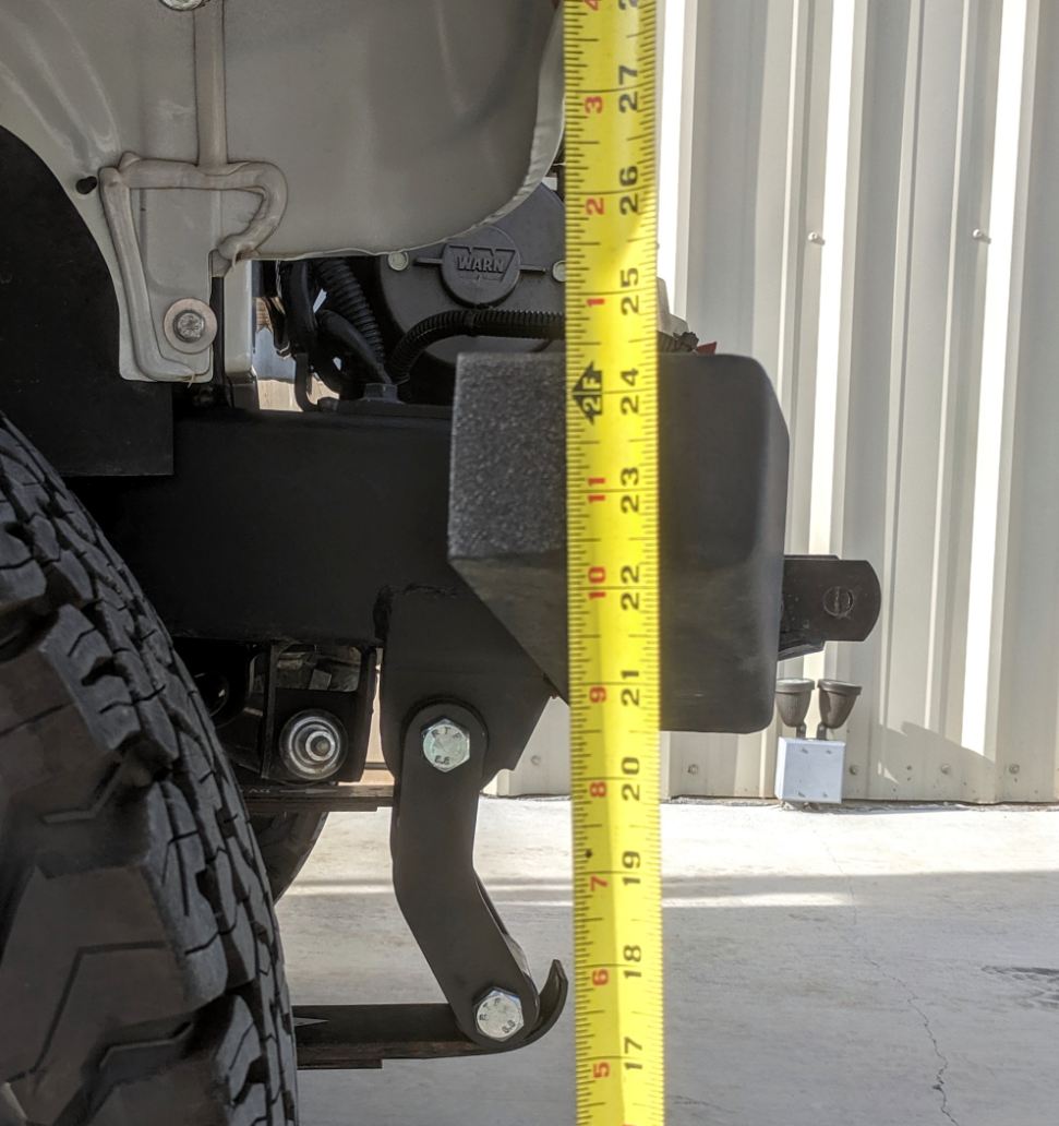

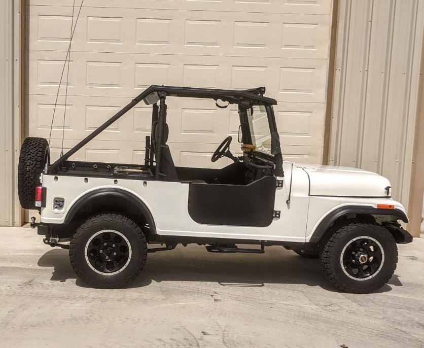

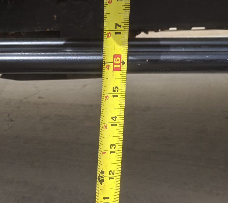

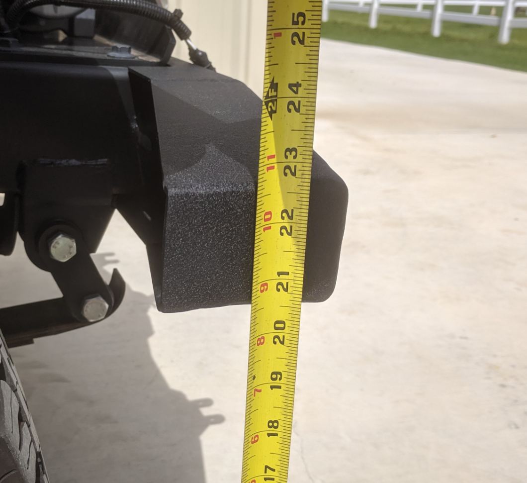

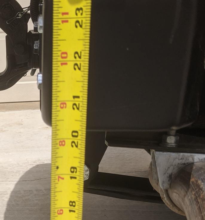

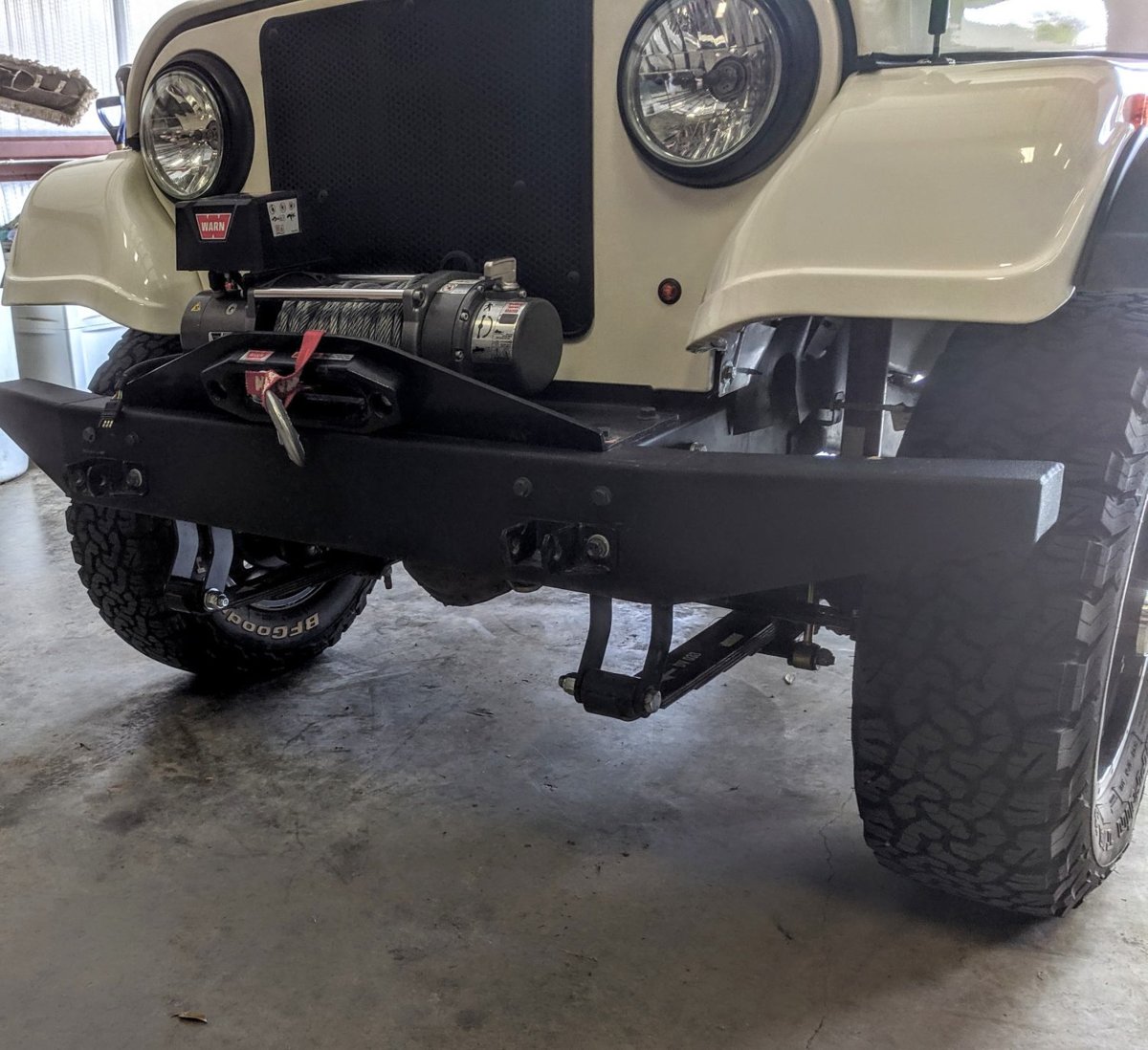

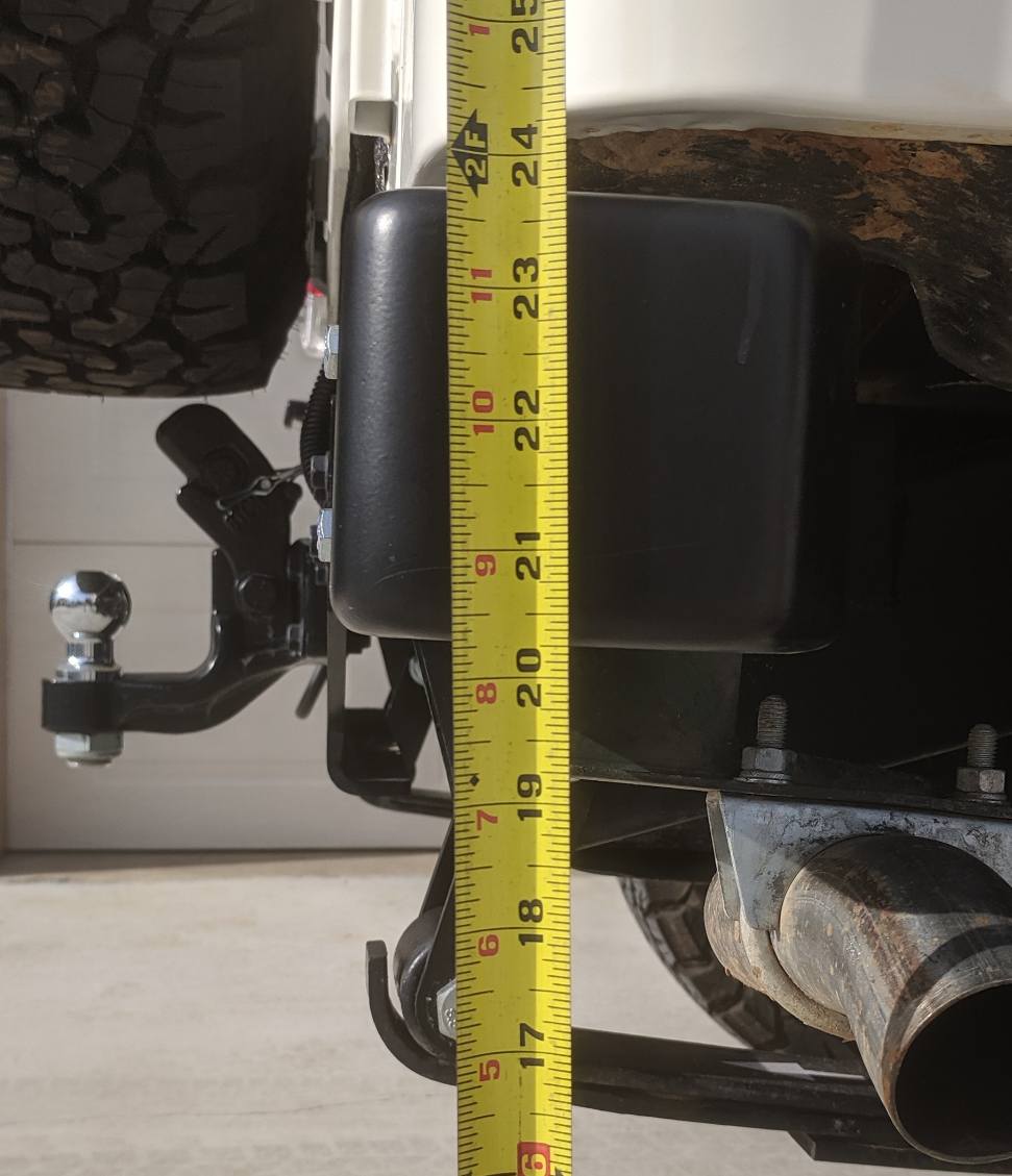

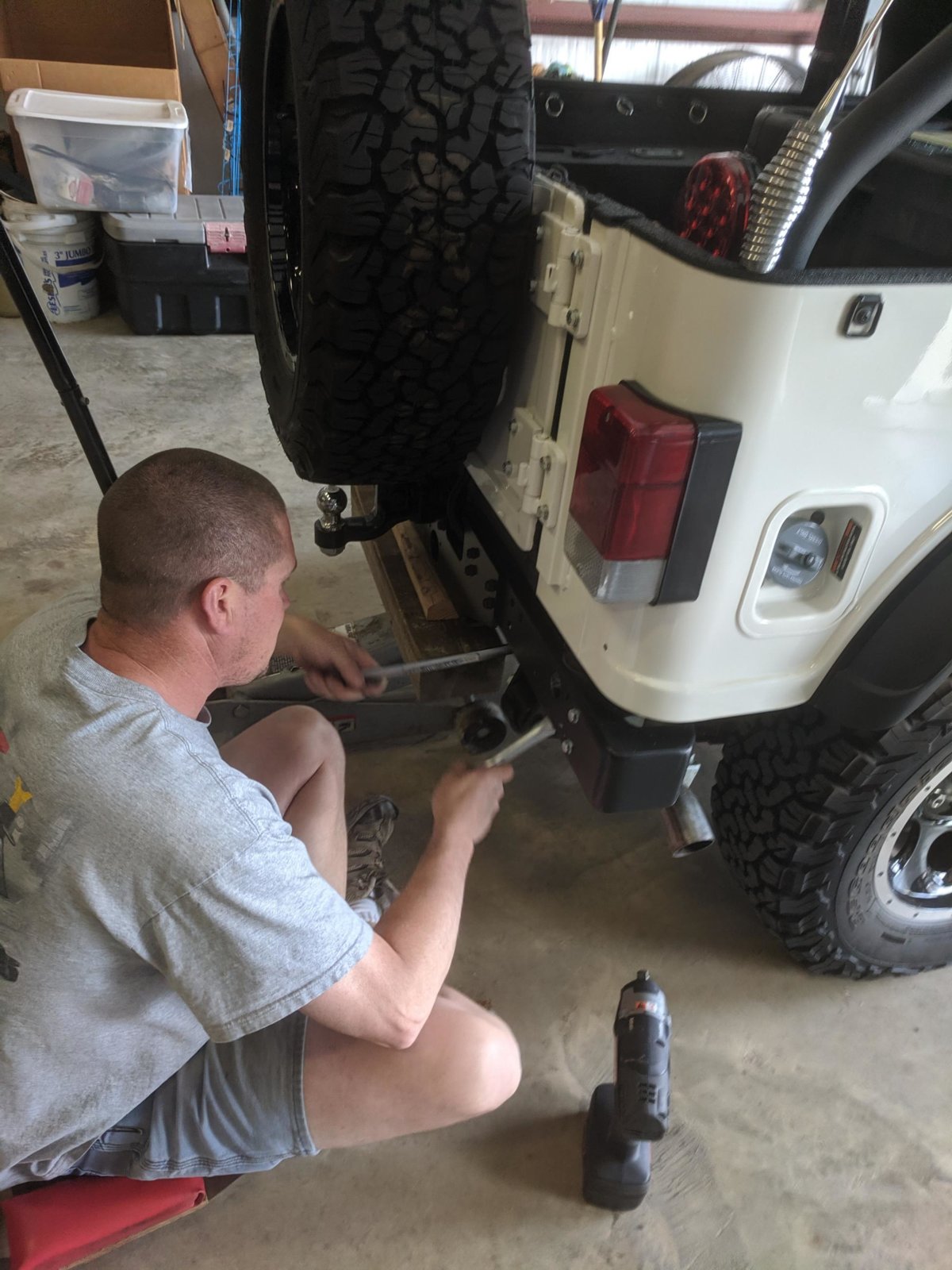

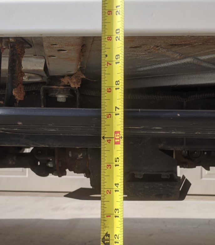

Now the install. Dragged the Roxor over to my buddy Pete's place. He has a big nice shop, every tool you could want and since my right knee blew out a few weeks back, Pete was going to do my install for me. So I have taken before and after pics. I have tape measure pics for a comparison. Its kinda hard to tell but pick out the top edge of the bumper, look for the edge of the top surface for a comparison. I measured at the front bumper, side step and rear bumper. We also measured the tow at the front of tire and at the rear. It has 1/4 inch tow in at front. 60-7/8" at the front, 61-1/8" at the rear. This is a wag, a guess for reference.

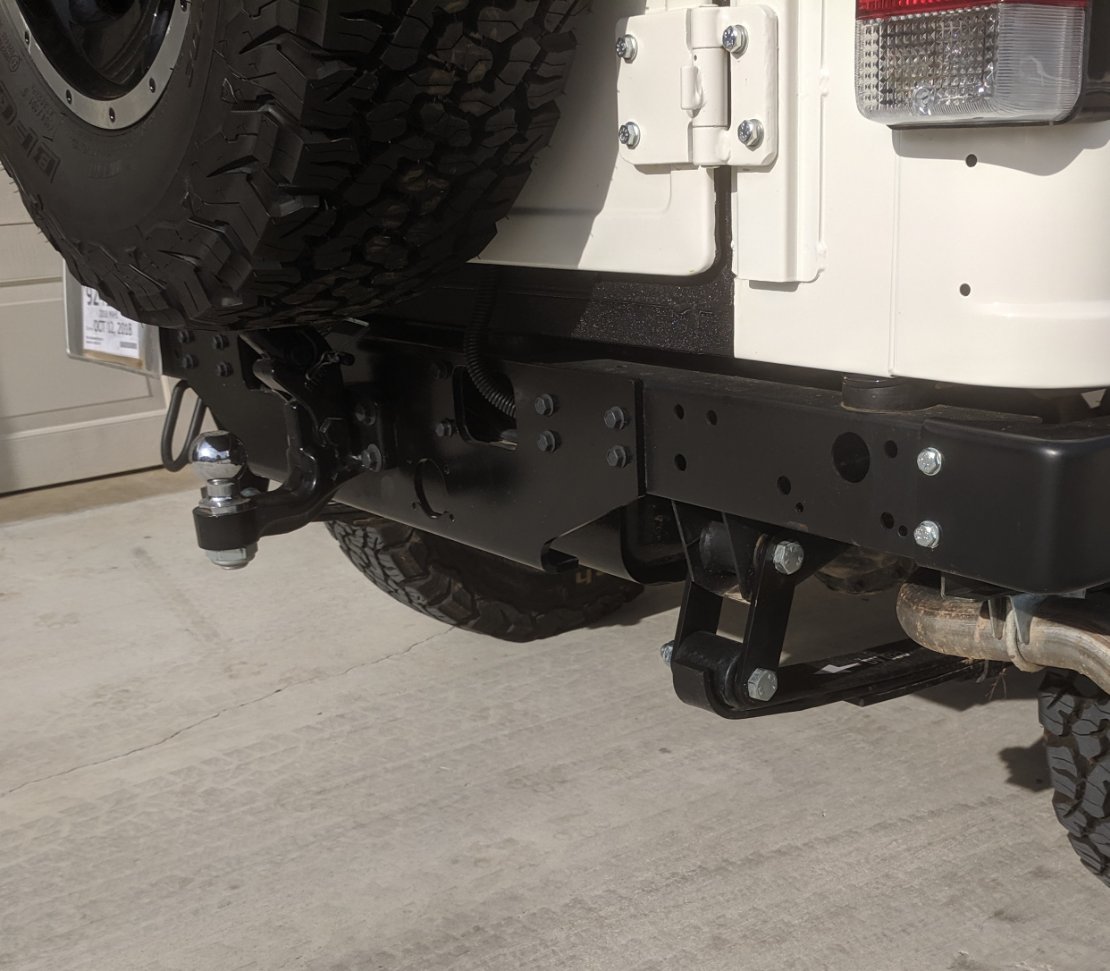

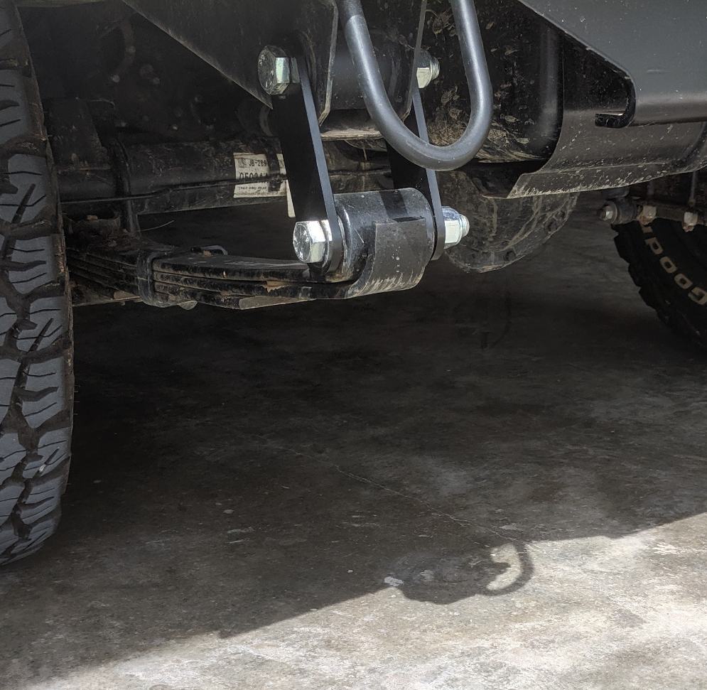

The install requires a floor jack and a few blocks of wood as a spacer, a few 15/16 wrenches or impact or whatever you have and desire to use but just 2 wrenches will do it. I just used the front bumper below the winch to lift the roxor. I first loosened the nuts and then jacked it up till the bolts came free. I then removed the OEM shackles. I then installed the new shackles with the top bolt and jacked the Roxor up until I could install the lower bolts. Once all the bolts were back in and tight I lowered the Roxor down. BADABING, it took all of 12 minutes. We measured the tow and it had changed by 1/8 inch. It was now 60-7/8 at the front, 61in the rear. So it is now 1/8 tow in. So I backed out of Pete's shop and spun around and backed in. We did the same process on the rear. Took less than 10 minutes. So all in all we had about 30 minutes in it. Front brake lines look like there are no issues, they are plenty long and the shocks look fine as well.
So off for a test drive. We did about 5 miles around his urban area. Steering was fine and so was the ride. It did seem like if you hauled ass around a tight turn that there was a tad more body roll but I never plan on removing the sway bar so no big deal to me. So we came back. We discussed the tow in and decided to dick with it. So we loosened up the tie rod, rod ends and rotated the rod about 1/2 turn and got the tow back to the 1/4" it was. We then went for a 30 minute romp on the back roads. DON'T TELL THE SHERIFF! LOL, They are FM roads after all and it is a tree farm implement. Now the fact that it's just 150 miles from the farm, Wellllll! Lol! All went well. No adverse effects from the lift. No rattles or noises were created. The ride seemed the same to me. No stiffer or looser, just a tad bit more body roll, I mean a tad. I don't know if the tow in is a big deal. My buddy Pete says 1/8" to 1/4" is always a good to go number for the non alignment rack, quick fix rule.
I say a GREAT PRODUCT and a QUICK MOD. MAX A did a super job on the hole diameters and the shackles were well made. Max did what he said, made them and shipped them when he said he would. That's a big deal for an old school fat ass like me! **** I AM A 100% SATISFIED CUSTOMER! ****

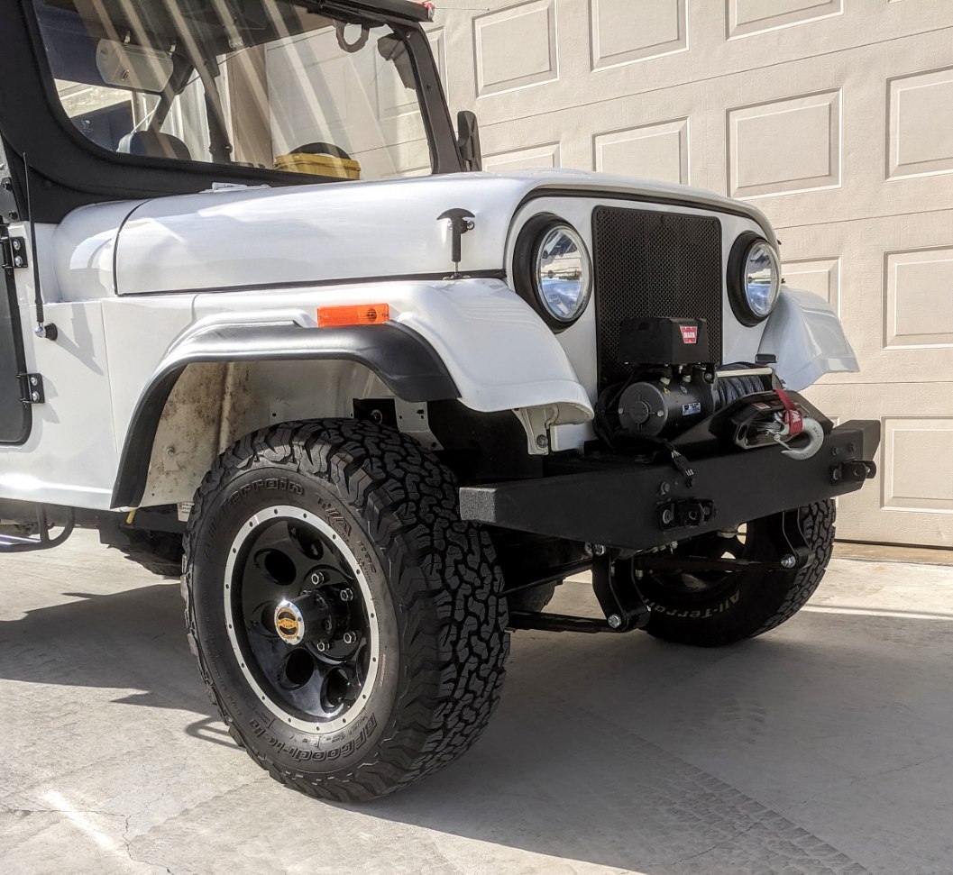

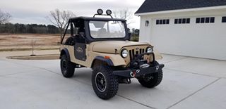

So here are a bunch of before and after pics.
