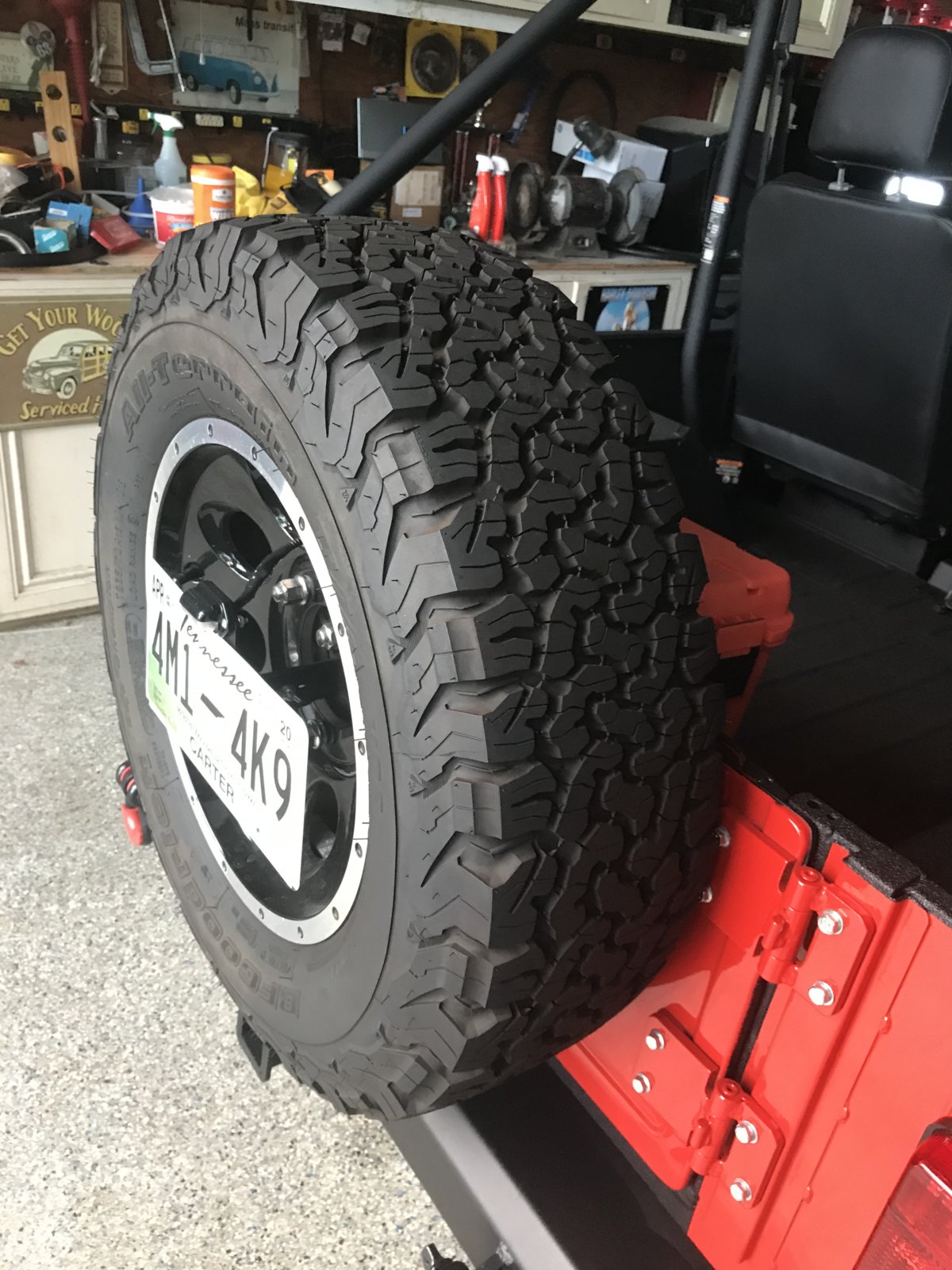

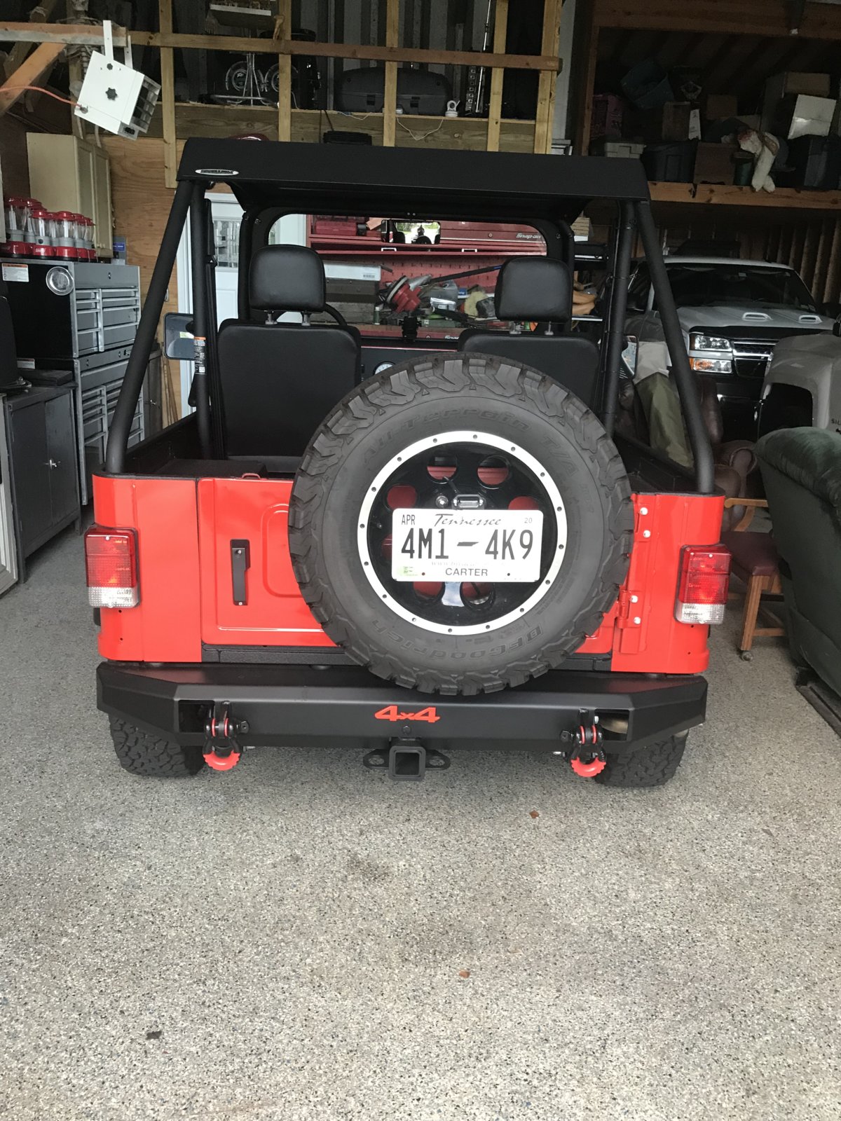

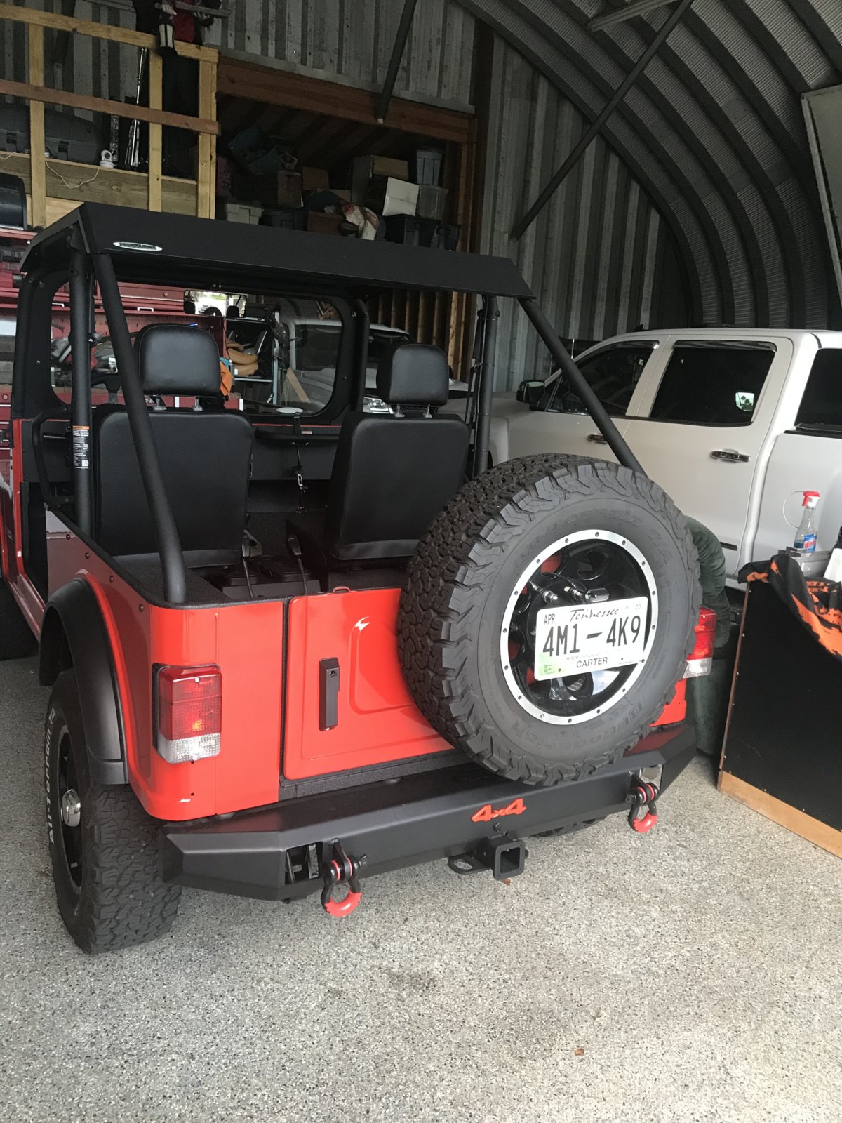

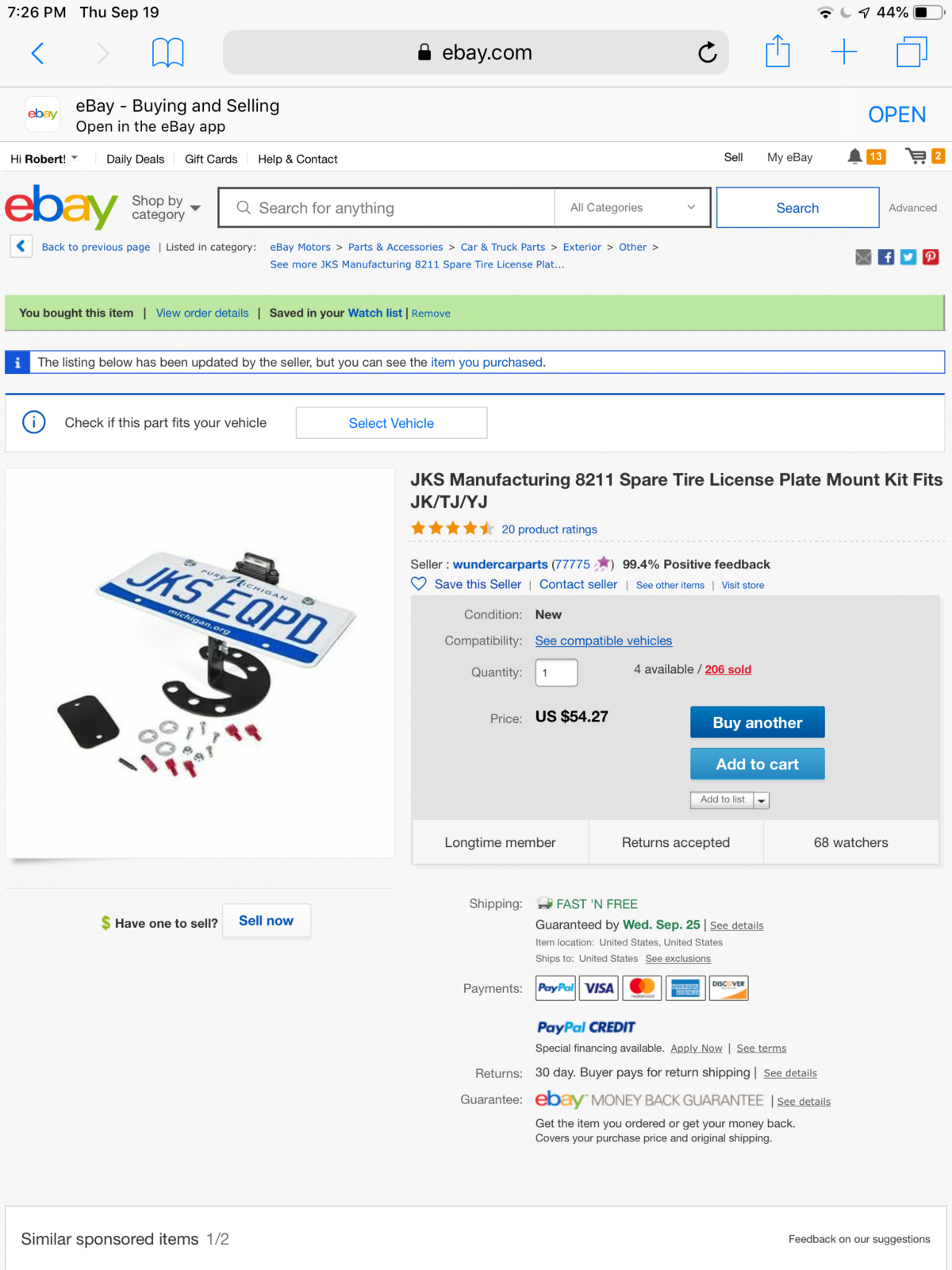

I couldn’t find a full size tag bracket I liked , then I saw a Jeep with the plate bracket mounted in the spare on the back so I got spare and bought spare tire tag bracket on e bay I’ll post pictures tommorow
I'm thinking about that route too. Standing by for pics.
C694C153-A797-4639-BAEE-3063FFAFD2F5.jpeg 4FF02287-25E6-40CE-BEEF-6AE939E48474.jpeg BC768E0A-D720-4710-B971-C310B810193F.jpeg

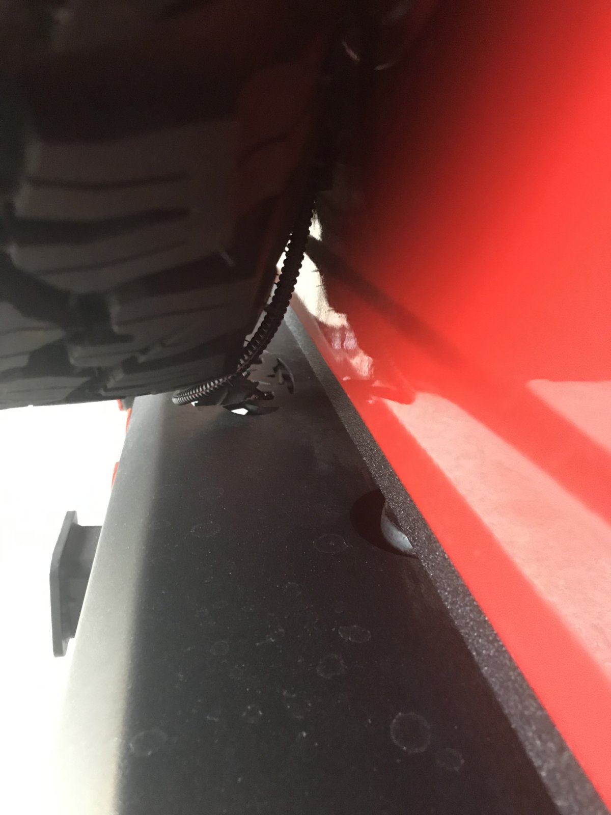

Note wiring comes up from bumper under tire I used a two pin deutse connector (advance auto parts) make sure to cut lock tab off Incase someone opens tail gate it will just come undone rather then tear wires out
Could you send the link to the spare tire bracket. This is exactly what I need.
