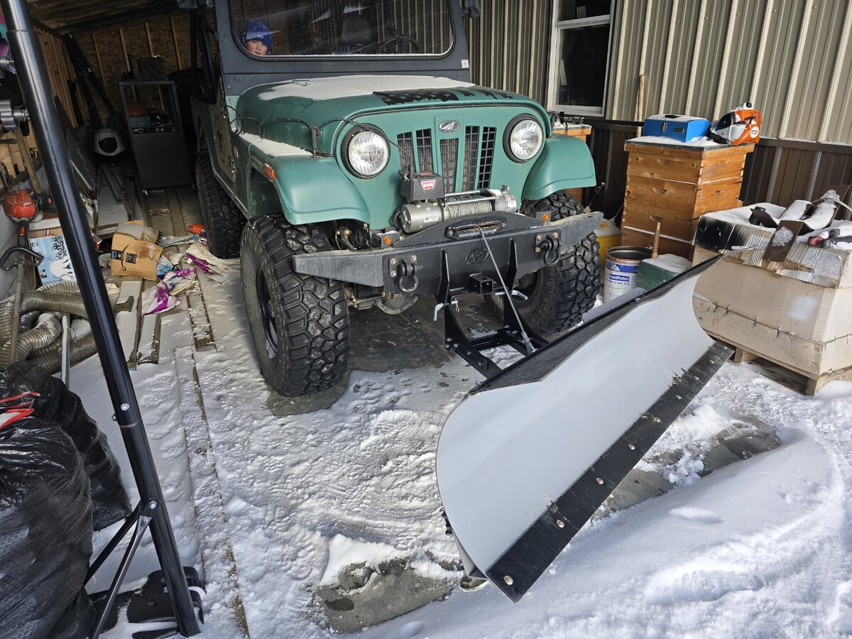

I ordered the KFI 62" plow for my Roxor, but after mounting it, I realized the lift kit was affecting the plow’s angle of approach. The issue was especially bad when angling the plow—one side would be nearly 10 inches off the ground while the other touched down. This happened because the Roxor’s pivot point was higher than what the plow was designed for.

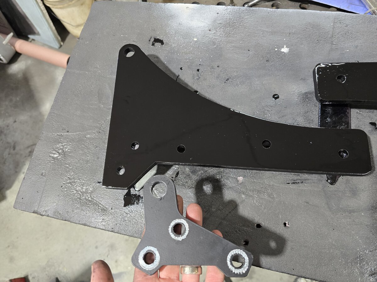

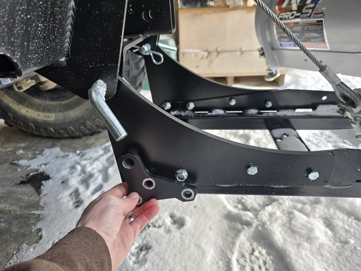

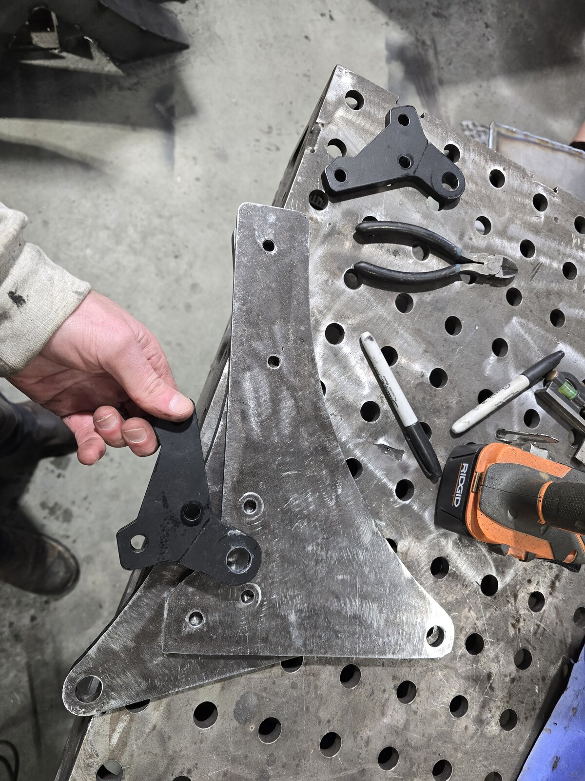

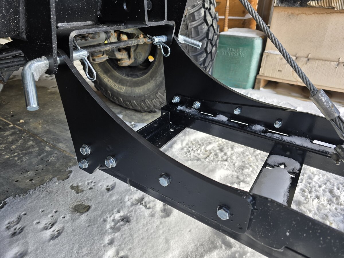

To fix it, I cut new 3/8" brackets on the plasma table and lowered the mount by 6 inches. No modifications were needed to the original KFI components—just remove the factory ears and install the new ones!
This KFI is a great plow, by the way. I especially like the 2" receiver they added to the mount plat on the roxor. It will be great for a Clevis Shackle for use with a snatch block
