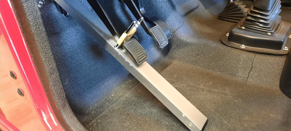

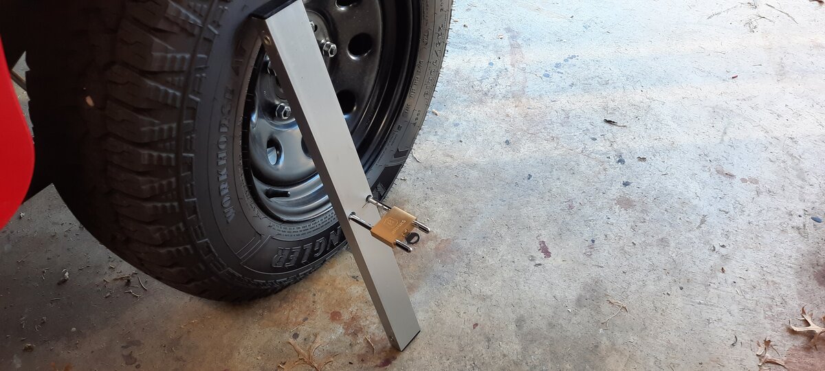

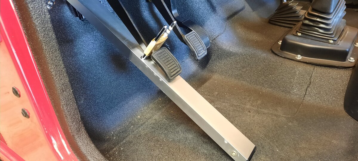

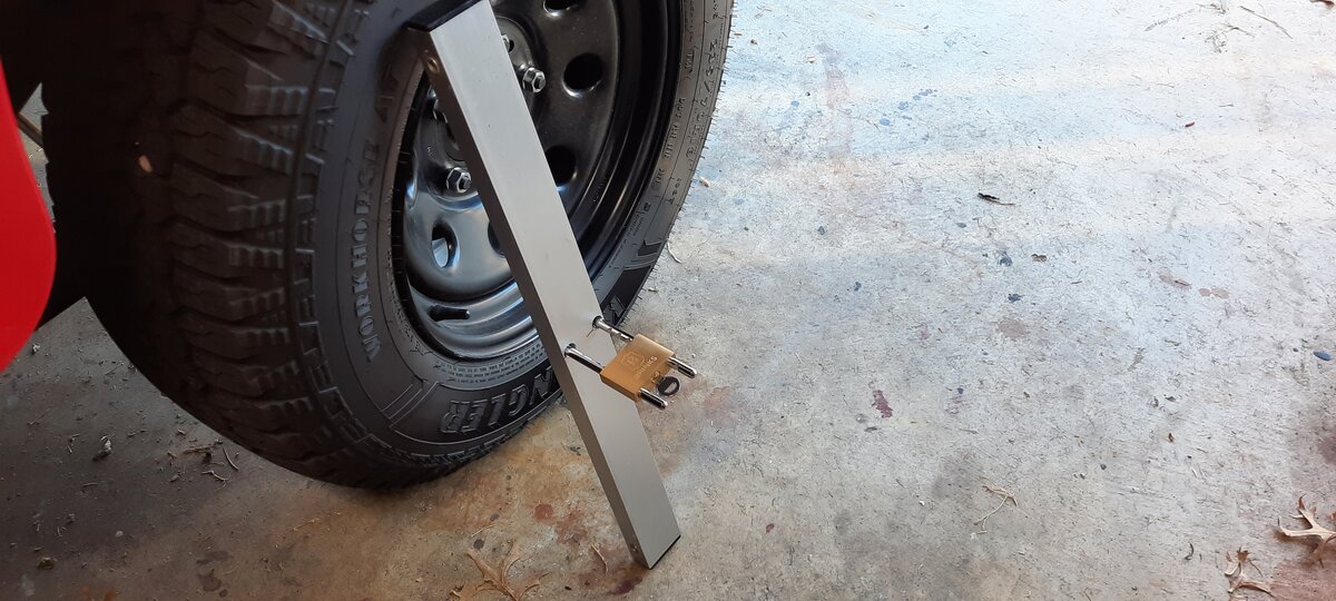

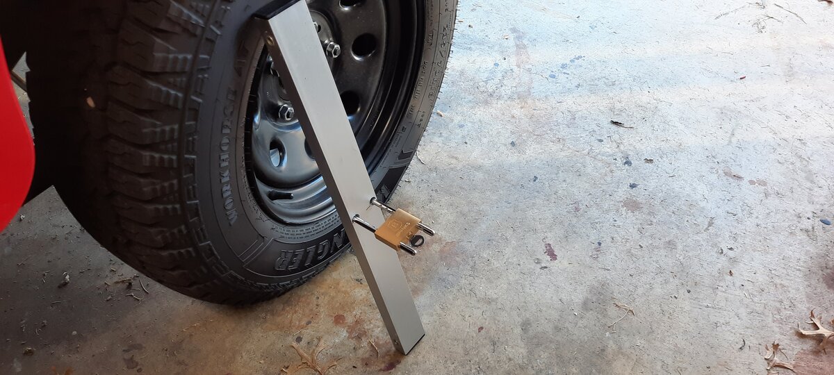

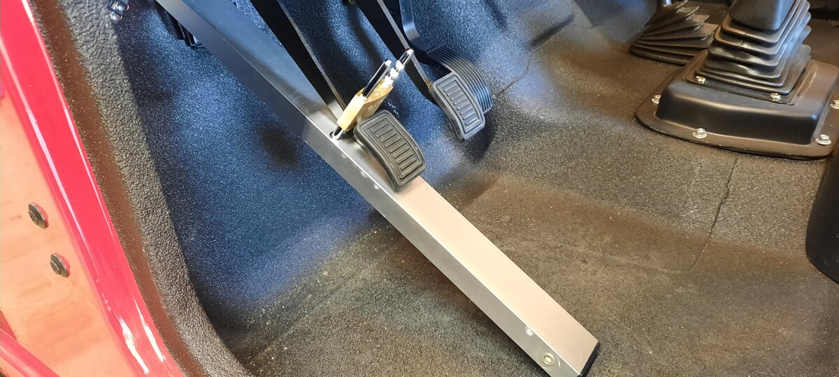

Hi All,
I just got a 2022 a couple of weeks ago and was afraid to take it to the store or church because I was afraid it could be hot wired. I know some people put in kill switches but I don't enough about diesels to start cutting wires so I came up with this idea... A heavy Aluminum bar with a pad lock to keep the clutch from being press down, I saw some of the same idea on amazon but couldn't not find any that would fit the way I would like....It actually works, no matter which way you turn the bar it will not allow the clutch to be pressed, I know they could cut the lock but still gives me some piece of mind..... Just thought I would share....This Roxor is so awesome...

I think they could force it into neutral. The Wedge under the handbrake sounds like a good idea...
Thanks for the feedback, I am really enjoying my roxor and don't want to lose it......
1,203
Unplug the clutch switch and use a piece of wire or paper clip and you’ll be able to start the engine right up. Then just float the gears and your gone. Granted the young crowd probably has no idea how to shift a manual much less float gears so there’s that. In my case I have a mini fuse in the plug socket so I can start mine without pressing the clutch. Useful if you wheel it and it stalls on an incline. If I were you I’d look for a better solution.

Thanks for the feedback... I only wanted to make it a little harder to steal if I take it to wal-mart... I am not worried about storage at home....

View attachment 11634View attachment 11635
Awesomely simple and still effective.
814
Another thing you could do it put the transfer case into neutral. Simple but effective. My CJ I had a club that went from the clutch pedal to the steering wheel
