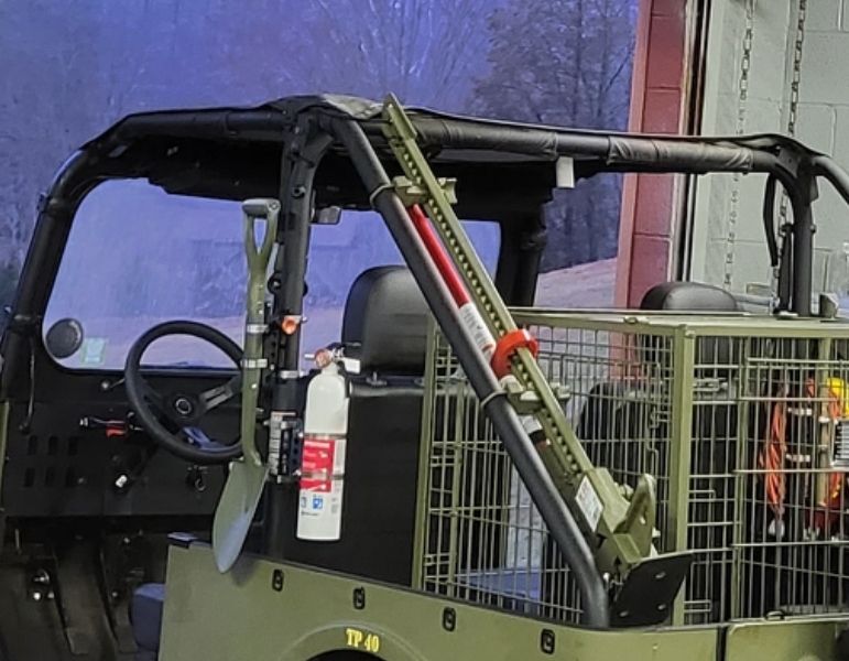

I have a high lift and I mounted mine on the ROPS on the driver side.

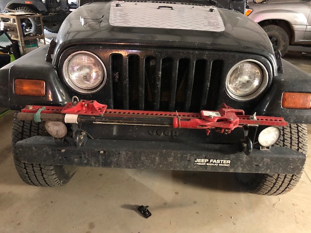

I have carried a high lift jack on jeeps for 40 years best lace is above the front bumper on the brush guard. It is than out of the dirt and easy to get at. In the real world I have used it may be 6 times. A floor jack is much better for small lifts and flat tires.
Dutzroxer
I agree completely. I fabbed up some simple mounts, out of channel iron, on the front of my TJ. IT not only puts the jack in an easy access, out of the way location, but it also lets the jack act as a brush guard protecting the grill and radiator.
I'm planning to do the same thing on my 2018 Roxor. You can see the front of it in the upper left part of the pic.
