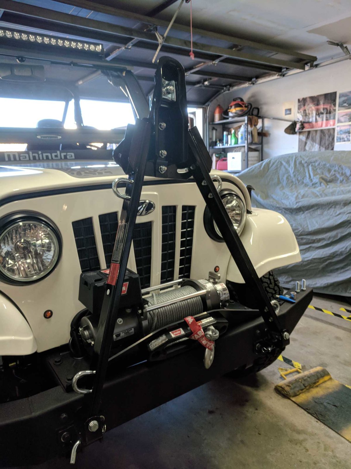

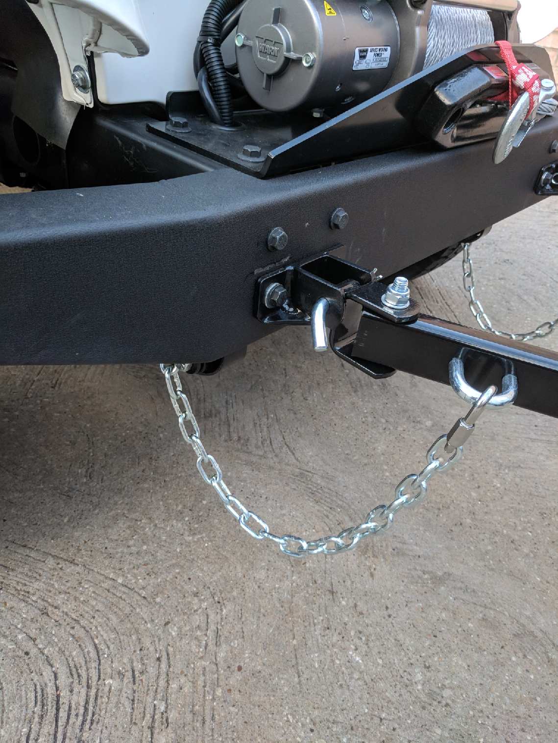

So as many of you know by now, Texas is being a dick about tagging the Roxor for street use. So for now, as my battle continues, I went and bought the $55.00 on sale Harbor Freight Tow bar. Its rated for 5000 lbs. I have the SE model with winch and winch bumper. The supplied attach brackets hole pattern is just about 1/16-1/8 inch to narrow to pick up the existing bumper mount bolts. Easy fix. I filed and ground the holes outside edges to form a slight slot. BADABING! they lined up perfect. Mounted and tightened everything up as specified.

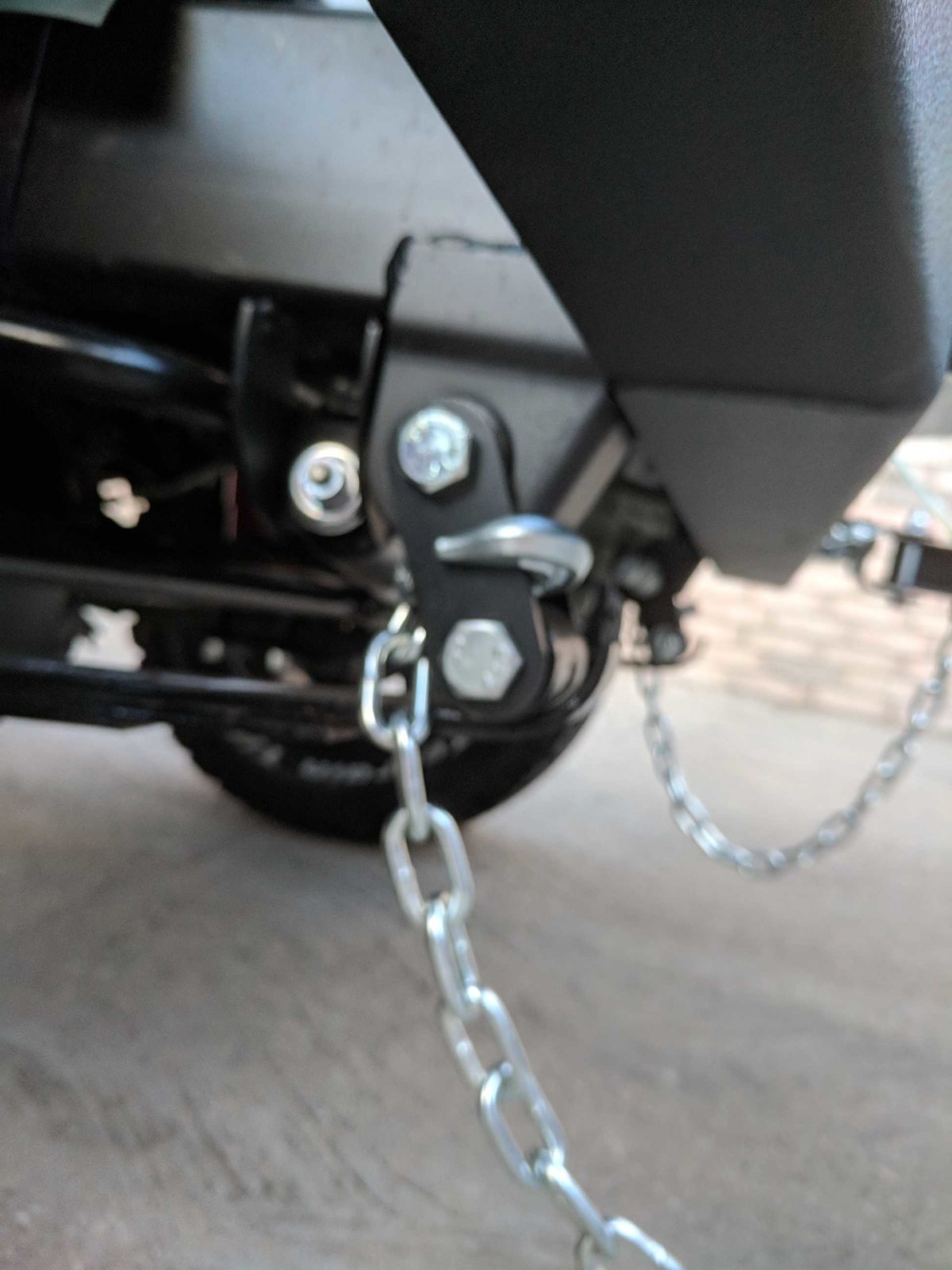

So the next day I bought about 30 feet of chain and 4 hooks and 4 attach rings with the threaded opening area thingies. Cut the chains to the right lengths. Installed the hooks and hooked it up for a test run. All went well. Placed Transfer case in neutral as well as transmission. It pulled fantastic up to 50 mph.
So its good for short hauls to my buddies place where we then load it on his 16 foot trailer. Its a 15 mile drive. Diffs and transfer case were slightly warm. Nothing hot and smoking. LOL. Still waiting on Mahindra to post a thumbs up for the flat tow method of operation. Another member towed 90 miles with no issues. So fingers cross that for short hauls for now I'm good. Well worth the $100 invested with about 2 hours of labor.
Oh and I bought the $18.00 tow lights set. LOL. Works great. Magnetic bases.
View attachment 1783View attachment 1784View attachment 1785View attachment 1786
Just bought the same thing. It actually is well made, 38 years as a fabricator and Welding inspector and I bought it too! There is a recent Sales Bulletin out too in regards to towing your Roxor all four on the ground. SLB-005, just got it from my dealer. It is now approved by Mahindra. MUST HAVE WARN FRONT HUBS, transfer case neutral, trans in 1st gear, 55 mph for any distance. Done and done.

BDRAG, I too just finished mounting the same tow bar on my ROXOR. I too have a Ford F-150. So how has it towed. Also I noticed you used the bolts from the bumper to secure your tow bar brackets, I did the same thing. Has that been good? Mahindra came out with a safety bulletin approving all four down towing, bulletin #005.
Tows great! I bought the magnetic tow lights from HF as well. So you slotted the bracket holes 1/8 inch as well? Factory says use 4 mounting bolts per side. Brackets only have 2 holes. No brainier, used 2. LOL.
I made my own chains. I loop the safety hook from back of shackle sliding the hook above leaf spring from back side and let it hook on shackle. Stays put just just fine. Don,t forget the Warn hubs.

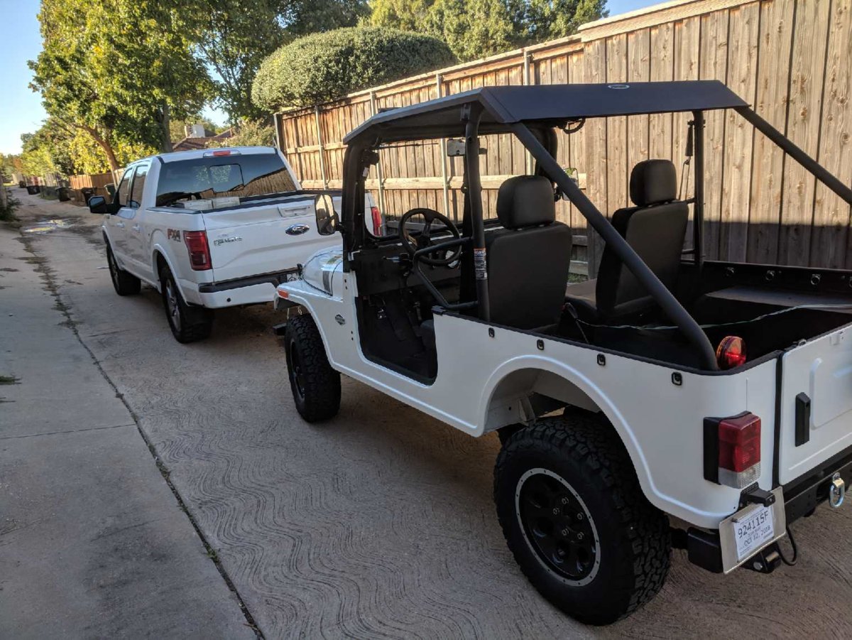

Well I finally got around to setting up my Harbor Freight tow bar. It has worked out very well. I took a different twist with the magnetic lights. I installed a four pin female light plug in the front and rear bumper, routed the wire under the ROXOR along the frame and connected both plugs. Now I just plug in a pig tail from my truck to my ROXOR and put the mag taillights in the bed of the ROXOR as you have done, run the wire with the corresponding male plug out under the tail gate to the rear plug installed in the rear bumper. Works great and I don’t have to string wire like Christmas lights when I want to tow my rig. This will save you paint to as no wires will be flapping in the wind against your paint.

Great news! I towed ours about 200 miles up into the white mountains of Arizona from Phoenix, I have the same tow bar and warn locking hubs in the front. I pulled up to 65 with no problems but I don't think I can say the same once I put 4.56 gears in there. Until I get floating axles and locking hubs in the rear that is, that's the long term goal.

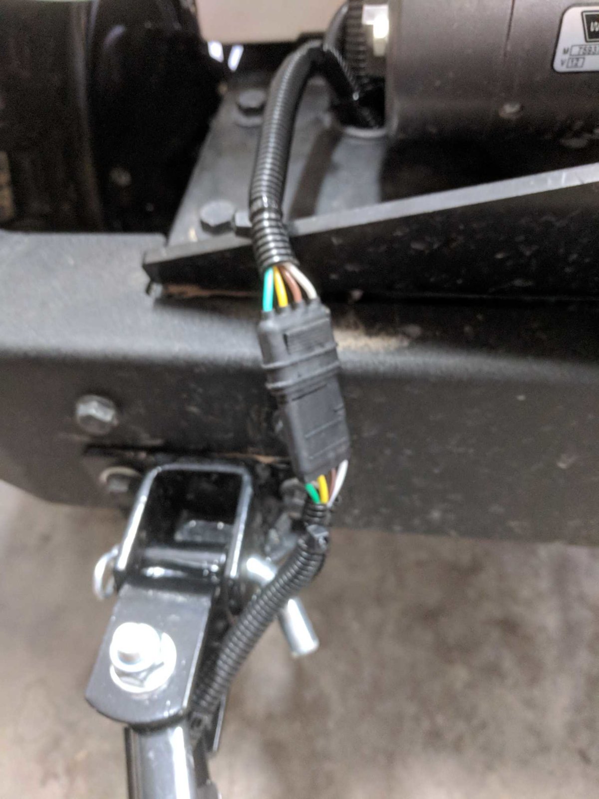

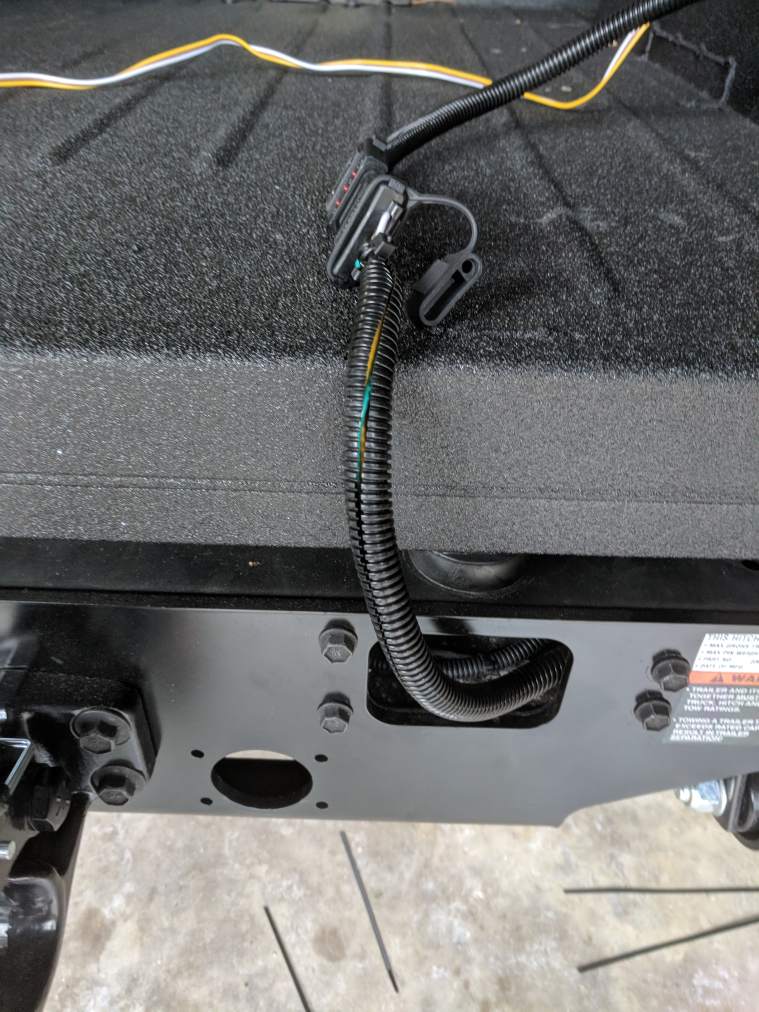

Ok. So you got my fat ass up out of my chair at 9:00 o'clock at night to run to lowes and buy the crap I need to mod my magnetic tow lights tommarra. Damnit Jim! Lol.
I bought a 5 foot cord with plug on both ends. Bought a set of plugs that splice to ends of four wire wire. So I plan on cutting off magnetic lights wire and attach one of the splice plugs to each side of cut. So by adding the 5 foot at tow bar I should have plenty of wire left to come up to rear bumper and then have enough to to reach lights. Sound right?
P Bleskey
Nov 14, 2018
101
UT, USA
Sounds right, works great. I will post a pic of what I did. I will need a day or two to post that as our weather went to crap tonight. I think it will break Monday.
Cool. I'm just gonna have a short dangling plug as opposed to actually mounting a plug to bumpers.

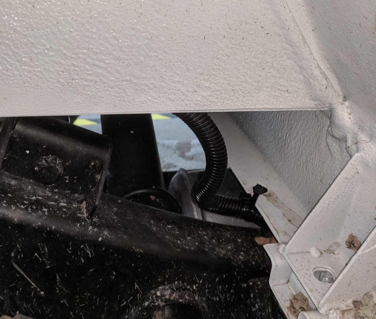

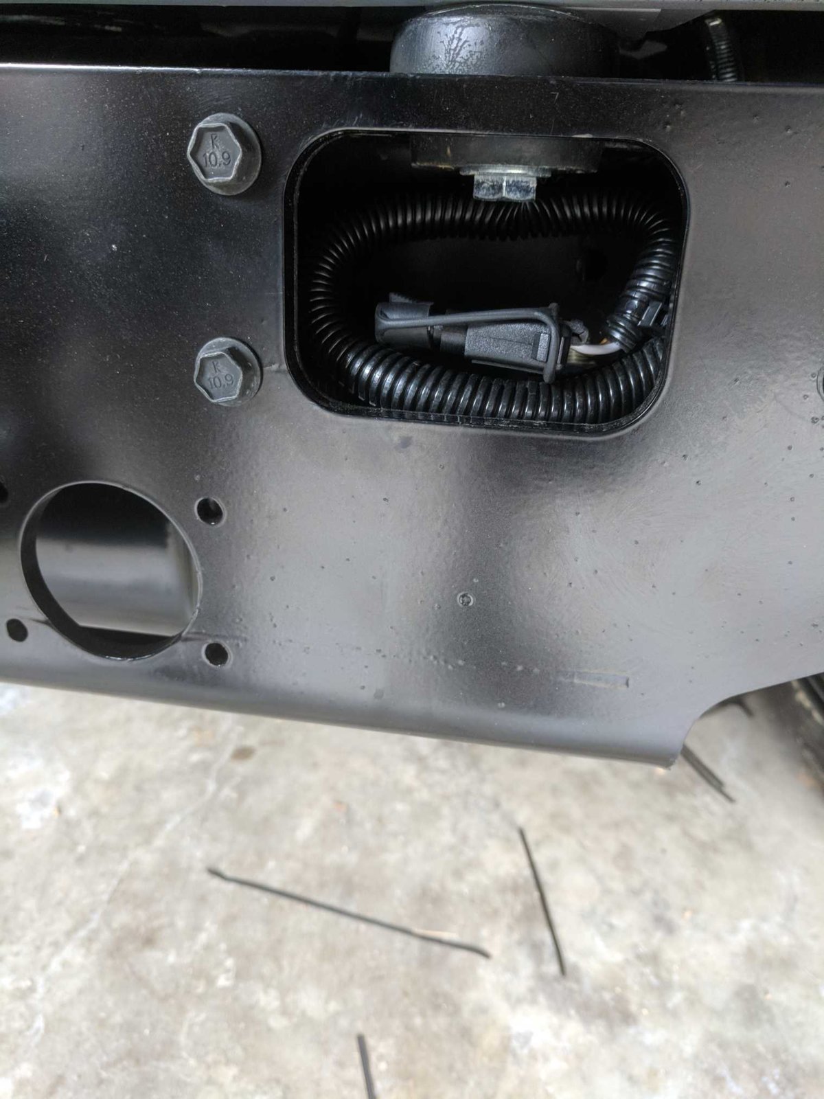

OK. You caused me many hours of screaming, dirt in my eyes, busted knuckles and a few choice words with your damn tow wire harness idea. Its a damn good thing the Roxor is like a Jungle Jim. I was crawling all over and under, up and down, pulling my fat ass up from the floor and under the chassis using drive shafts, wheels, door openings and the roll bars to get this fat old man underneath to tie up the wires.
I ran it all in split tubing. I decided to run down the right frame rail. I thought my existing magnetic tow light wire harness was not long enough to run down the left and then back over to the right side where the lights are correctly positioned with the wire going to the right light first then running over to the left light. I made some Z clips for the tow bar harness to keep it tucked inside the U channel. I then ran the harness down through the winch wiring hole and back along the right frame picking up existing wires, frame holes and so on till I got to the rear bumper. I then ran it out the right side pocket in the bumper where the plug will also roll up nicely and stow when not used.
So I have a disconnect at the tow bar and at the rear so I can remove the tow bar and also I can disconnect the magnetic lights and stow them and the plug.
The POS plugs that splice right to wires were junk and took some re work but now work. All in all I am happy with it. Thank you for doing yours and bringing that great idea forward. Next time though you need to offer to do it too! LOL!
ROXOR TOW HARNESS 5.jpgROXOR TOW HARNESS 4.jpgROXOR TOW HARNESS 2.jpgROXOR TOW HARNESS 7.jpgROXOR TOW HARNESS 6.jpg
