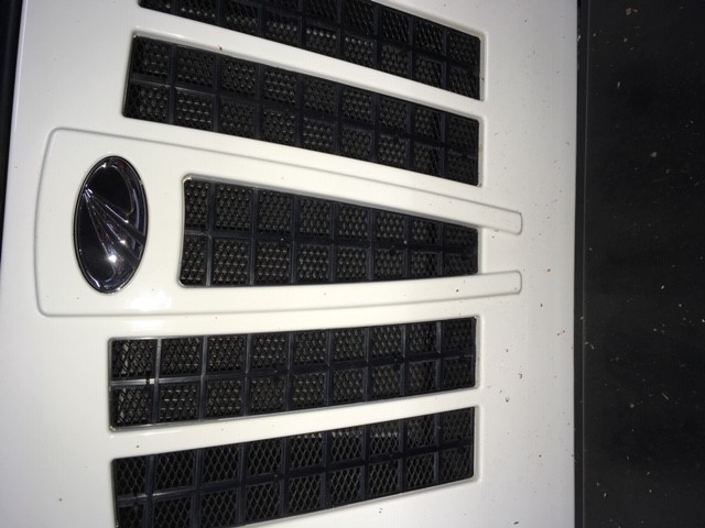

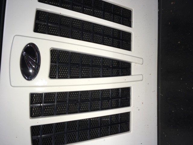

I have a problem with grasshoppers and seeds. My wife had a great Idea. I got gutter guard I had laying around and painted it with Rustoleum Hammered Black. Cut it for the slots and wire tied to the plastic. Does not restrict air flow, but does keep bugs and seeds out. I did have to enlarge the hole in radiator shroud just big enough to fit my arm in. Made a cover out of diamond plate aluminum for that.

When I first got the Roxor I went out to the field to check cattle. Grass was high. Didn't think anything about it until I got back to the barn and saw the radiator covered in grass seeds and grass. The air tunnel is very efficient at channeling air to the radiator. The inspection hole in the shroud was not quite big enough to get my arm in to brush off the radiator. A vacuum hose was out of the question as well. I got out my Air saw and enlarged the hole back to the rib in the metal on the shroud. I think that makes the hole about 3.5"x5". Made a plate to keep critters out. Makes for easy cleaning. If anything gets past the screen, I blow it out from the back side of the radiator and vacuum out the shroud.

I have a problem with grasshoppers and seeds. My wife had a great Idea. I got gutter guard I had laying around and painted it with Rustoleum Hammered Black. Cut it for the slots and wire tied to the plastic. Does not restrict air flow, but does keep bugs and seeds out. I did have to enlarge the hole in radiator shroud just big enough to fit my arm in. Made a cover out of diamond plate aluminum for that. View attachment 1806
Great idea... Just did the same thing, just on the outside of the existing grill so that it is easily cleaned and/or removed
