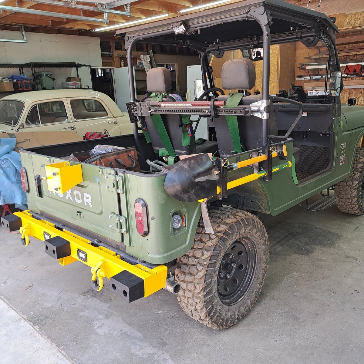

Hi everyone. Just joined and am finding a ton of good info so far. I have a 2024 HD that I bought from out of state. I'm 75 years old and a Vietnam Vet. I've worked as a turbine engine mechanic, carpenter, brick mason, welder, and mold maker. I work part time (I'm basically retired) at a custom car shop doing welding and sheet metal fabrication. So far I have installed new bumpers, a gas spring to help raise the hood ( that thing is heavy!! ), and a lot of lights as well as a winch. My next project will be twin stick conversion.

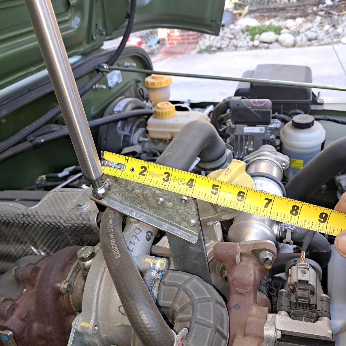

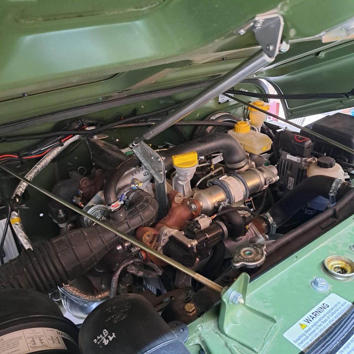

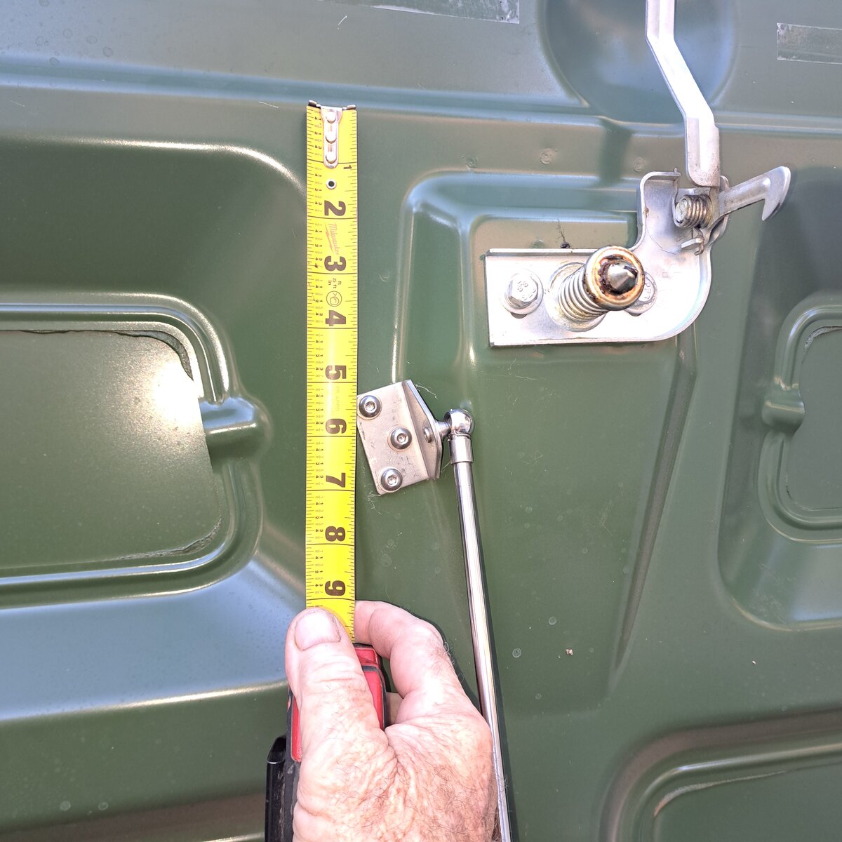

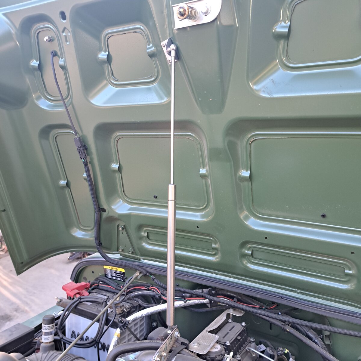

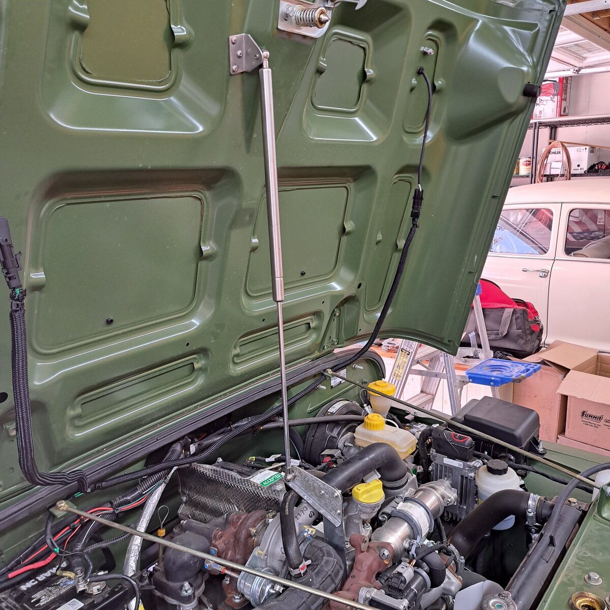

That hood gas shock is awesome, can you do some closeups? I'd like to mimic it.
OK, here are pics with measurements. For the bottom piece I used an old galvanized framing anchor I had lying around. The upper bracket is attached to the hood with 1/4" x 28 button head screws. I installed three nutserts in the sheet metal as I am very opposed to sheet metal screws in anything that rattles or vibrates. The gas spring is McMaster Carr part # 4155T901 (corrosion resistant gas spring, 80 lb. force, 26.2 extended length. The upper bracket is Mc Master Carr part # 9512K12 ( stainless steel ball stud mounting bracket). If I had this to do over again I would use a 100 lb. force gas shock. The hood opens easy enough but a stronger gas shock would have been better.
Of course, this was just my way of doing it. You could probably save some bucks by gettinga gas shock and bracket from a wrecking yard as there are a lot of vehicles that use them on hatch backs etc.
Hope this info. helps!!
