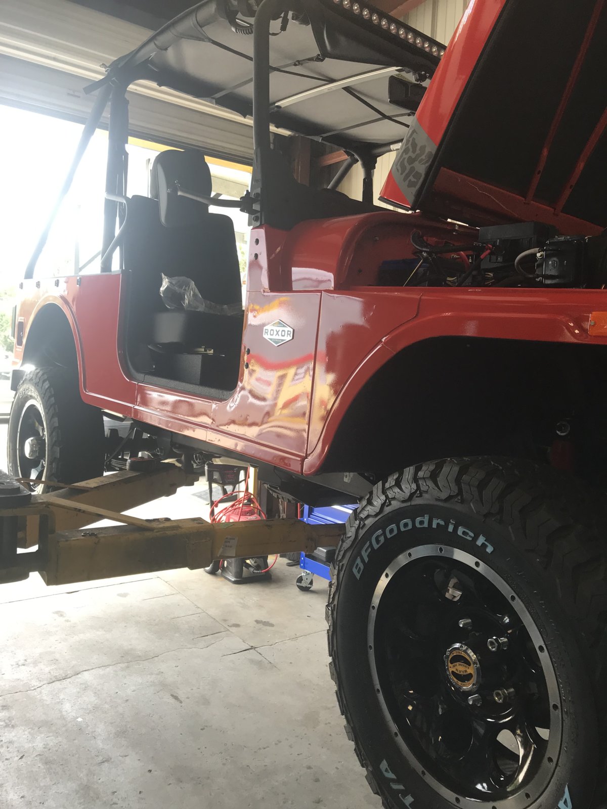

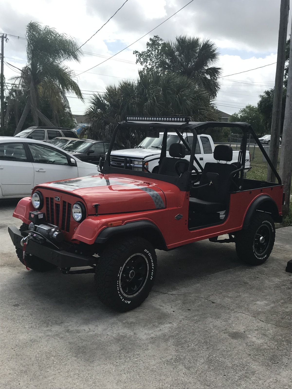

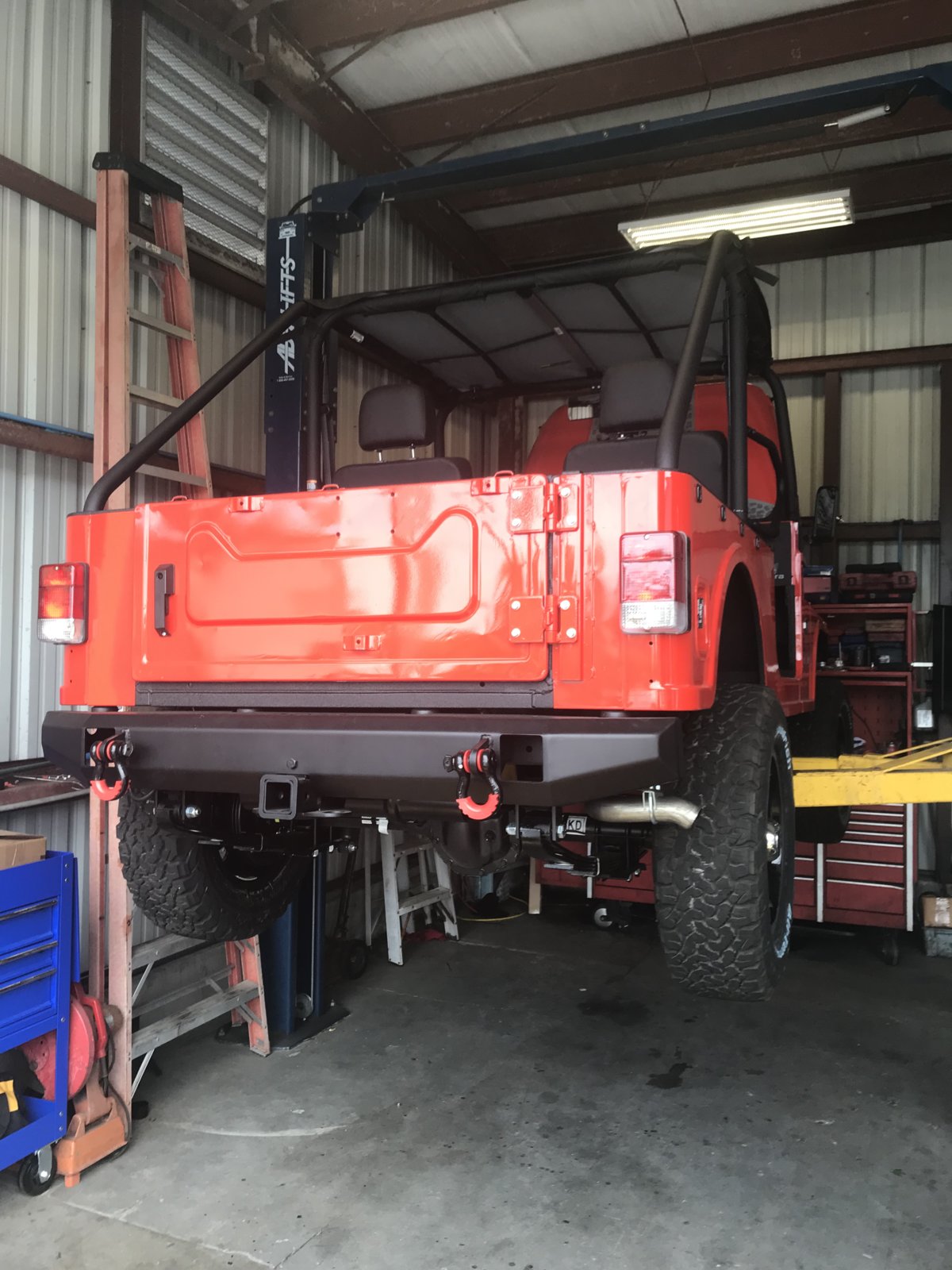

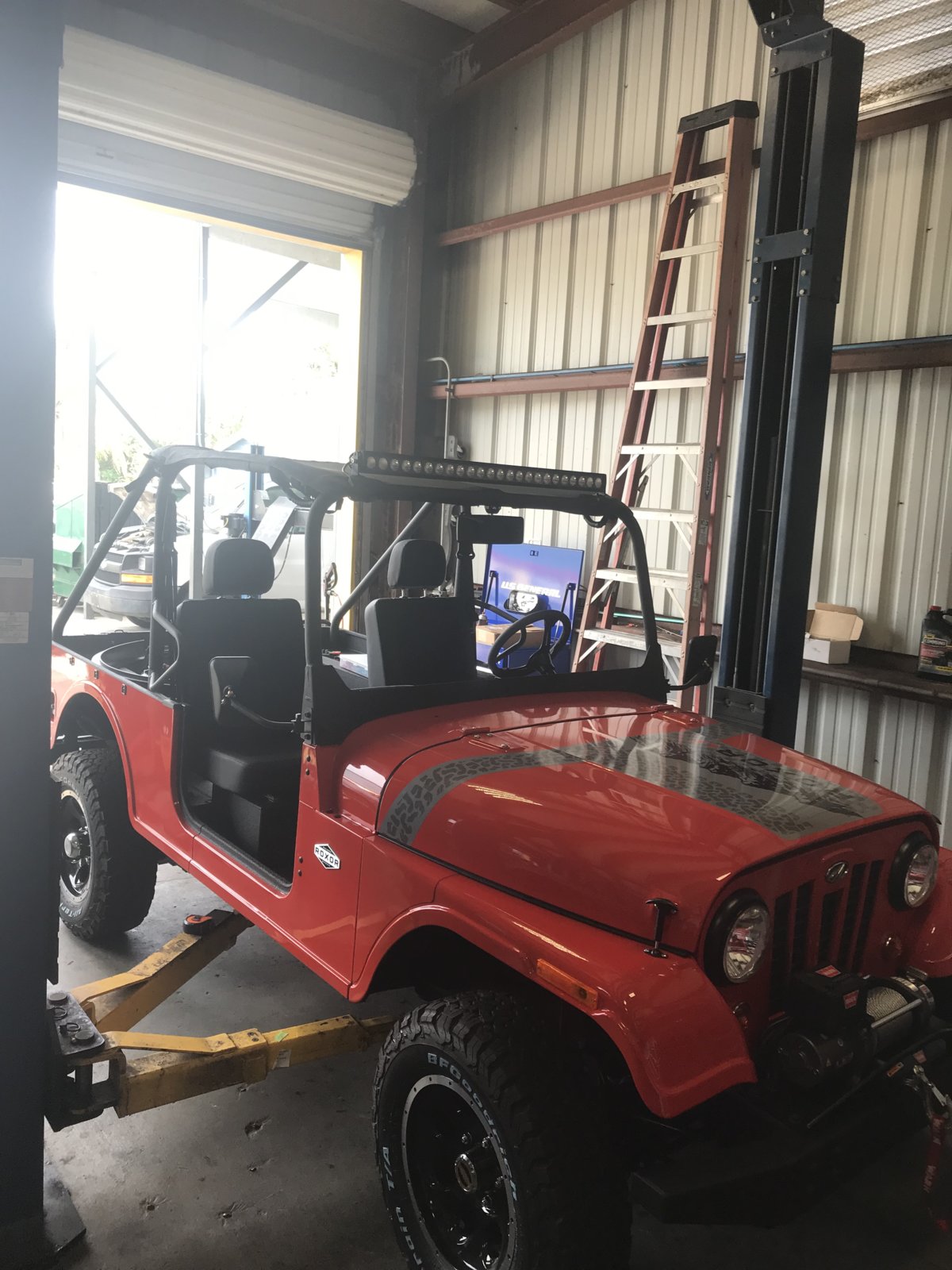

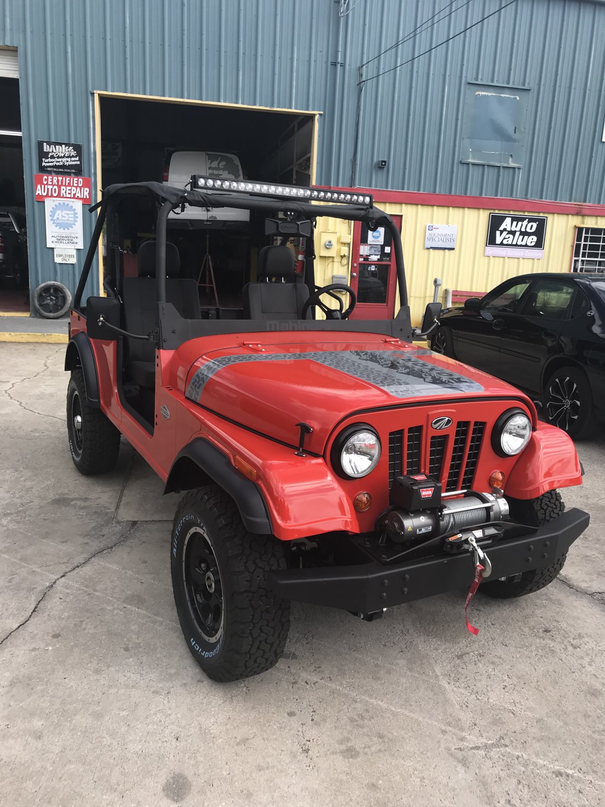

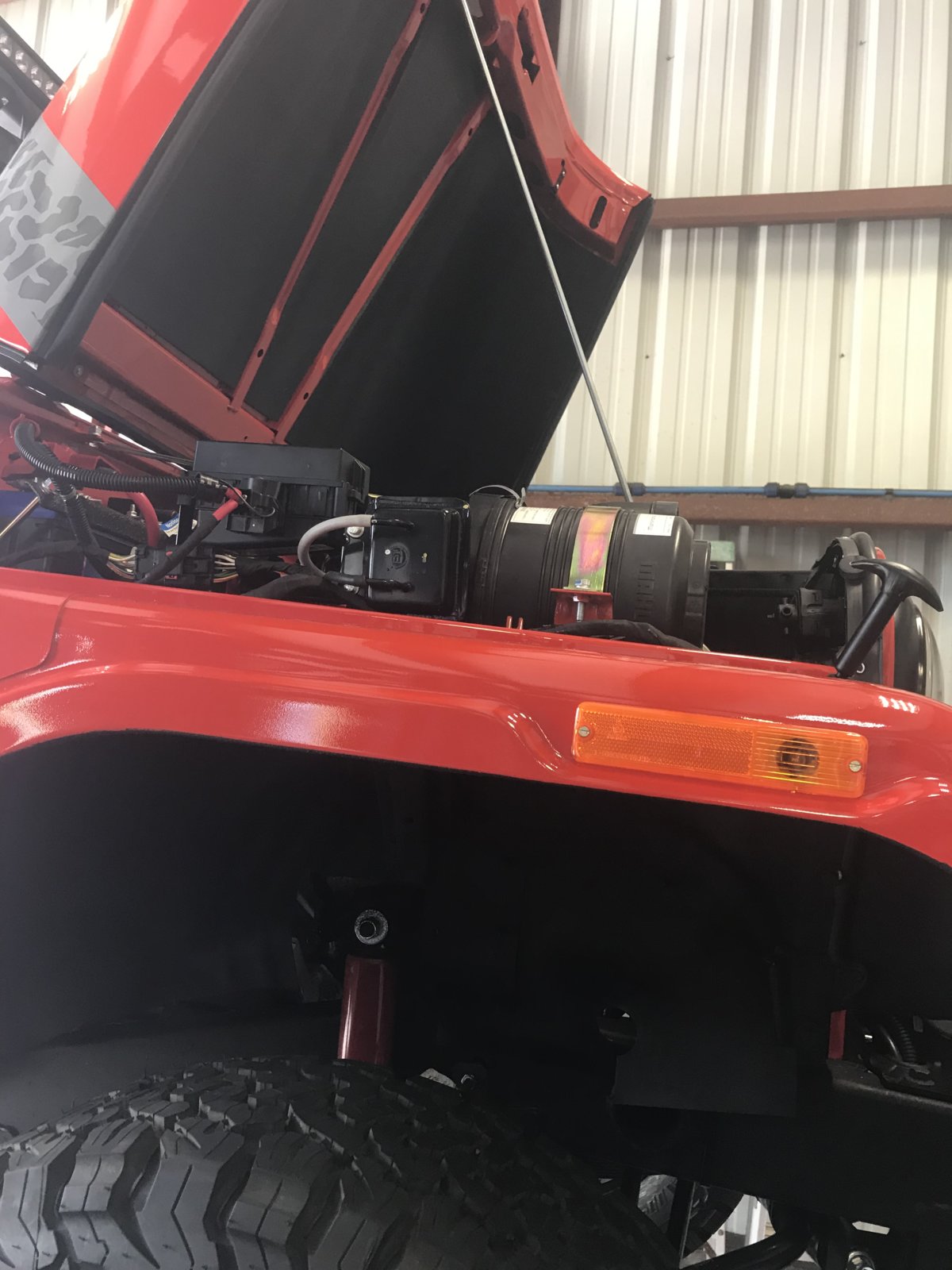

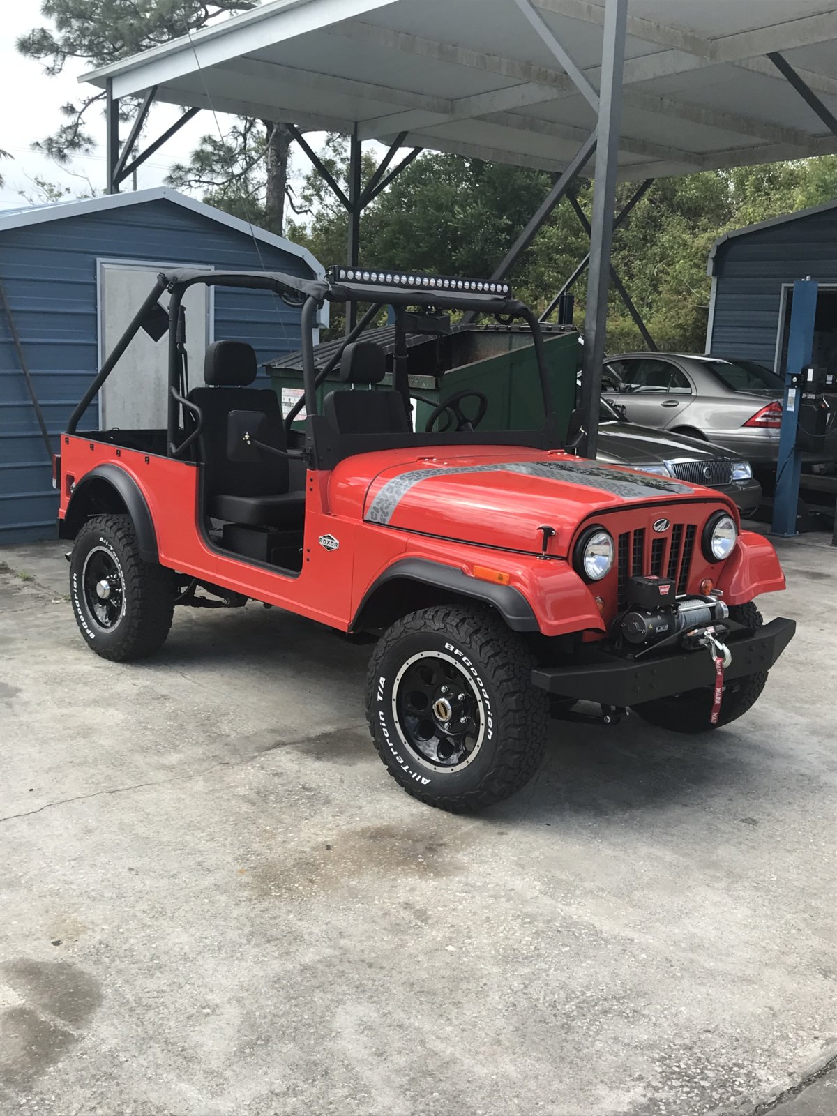

Installed turn signals, warn hubs, two inch wheel spacers,removed egr and cooler today hopefully will get chance to install fender flares tomorrow still waiting on fortress roof and windshield to get here
69E6250B-E98D-4623-9398-04B93433420C.jpeg 595E4421-8ECC-43C4-8365-32428CCDBA0A.jpeg 801CF486-7B46-4CF6-A3E7-D9FEFED7126D.jpeg A62CC319-AAEA-4148-9E9D-E86282E97DFF.jpeg A90A4691-B5E1-4870-ABD2-C3A8A6DDDCC6.jpeg
That's a sharp looking rig. I just did 1 1/2" spacers. Did you use anti-seize? I also went to chrome acorn nuts on the outside to protect the threads.
Anti seize yes and I got stainless acorn with the center caps on back I’ve ordered ones for front

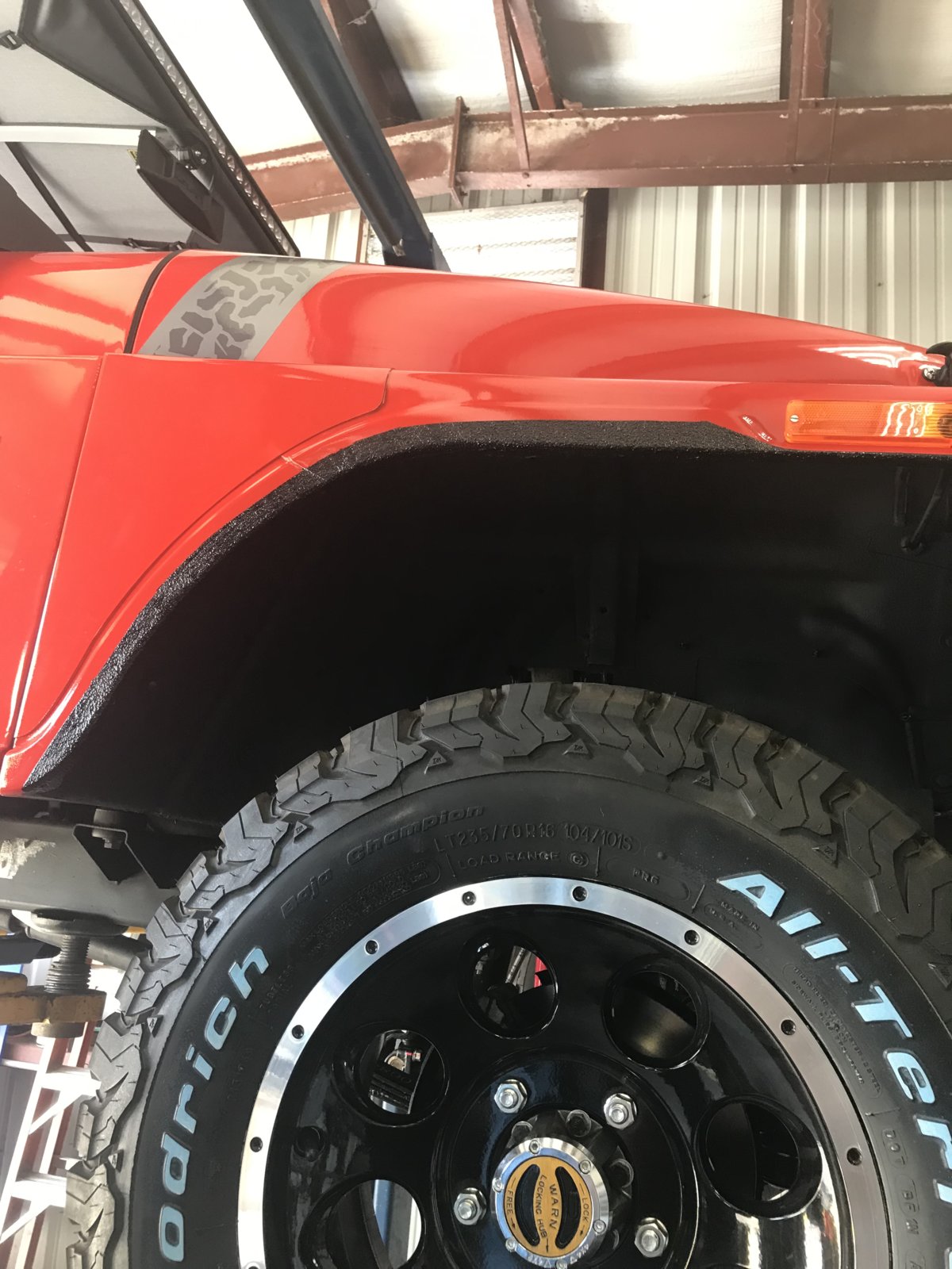

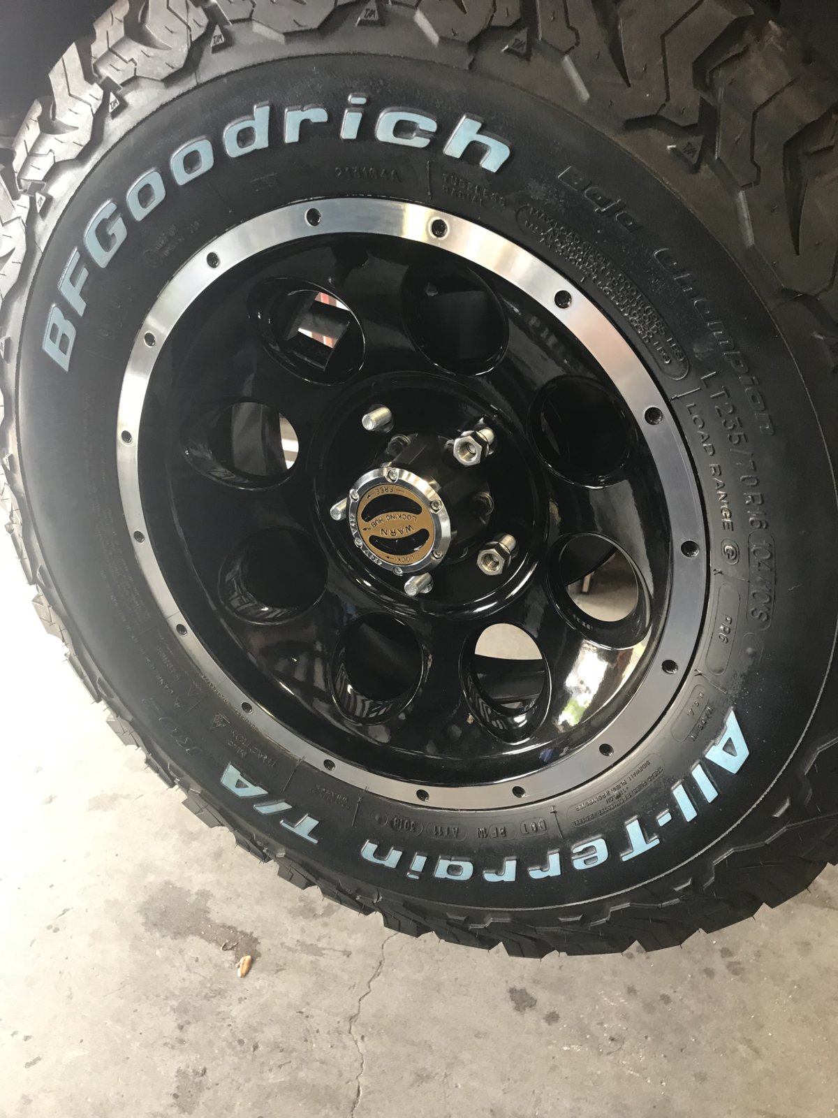

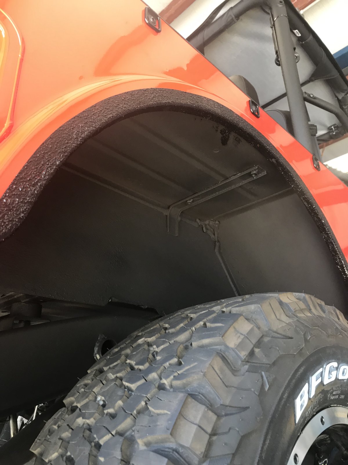

Today’s update ,intended to install fender flares today but had ideal to put Herculiner bed liner on sections that fender flares touch body so I’m waiting for paint to dry??
E545BA22-2BF8-4FC4-88D8-FBEEEA23D42C.jpeg D9B89DB8-593C-4199-9E8A-695E3D0208F5.jpeg
I got them off eBay they fit 1955 to 1986 cj cj5 cj7 part number 11601.01
