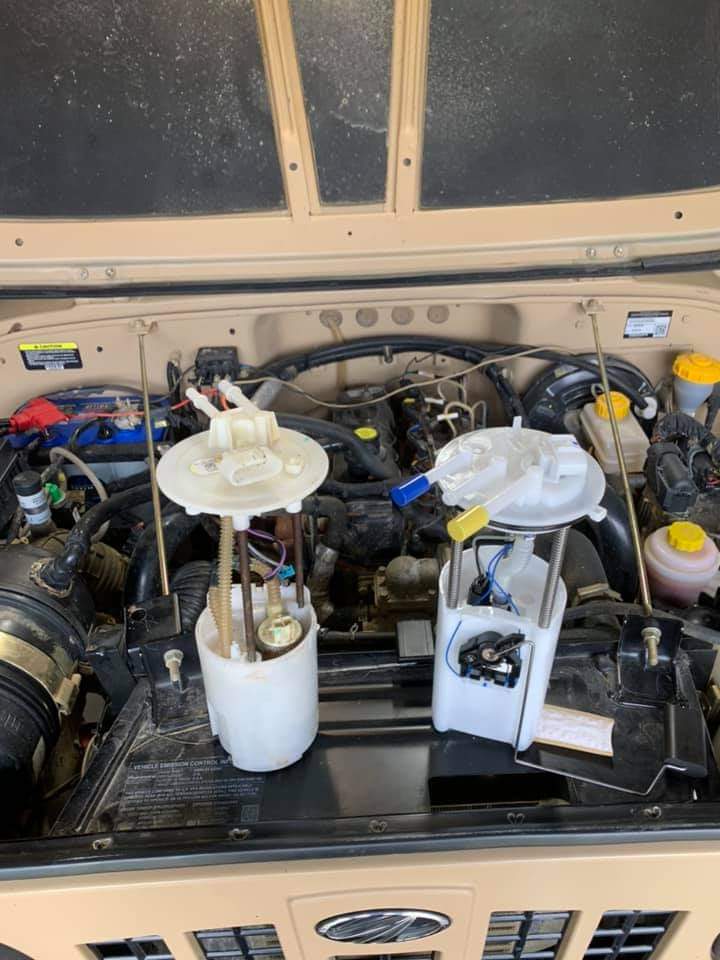

So does anyone know if the sender/fuel pump in the fuel tank has float on it that sends into back to the dash Gauge?

Left one is stock. The one on the right is from a 2000 Chevy Tahoe.
813
Will the chevy one work. I'm quite familiar with them?

So my gauge shows hollow bar when I still have 6 gallons left in tank. It's rather annoying. I've been waiting for my dealer to get the part but so far it's taken roxor 6 months and I'm ready to fix it on my own
It has been working well on mine. Have to take the old multi meater out and change a few wires around.
