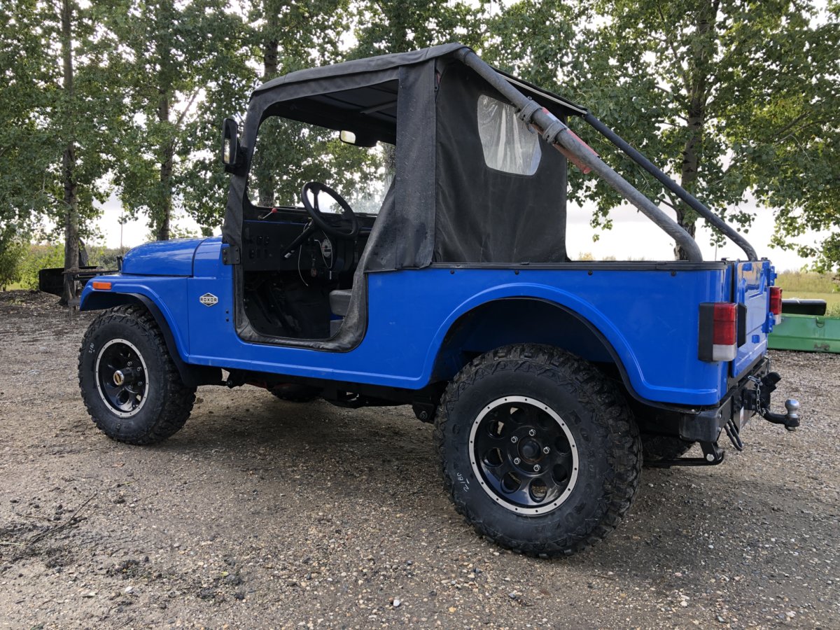

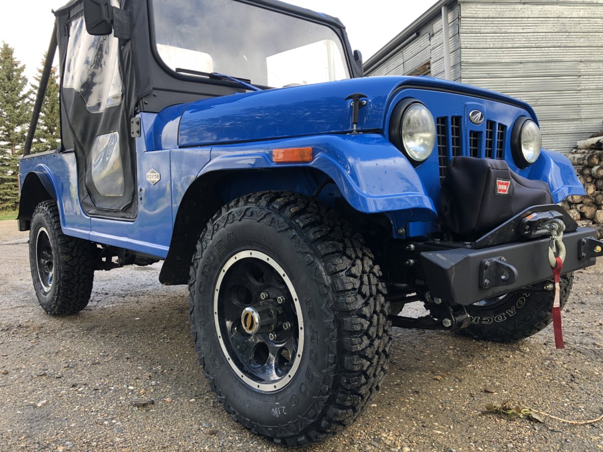

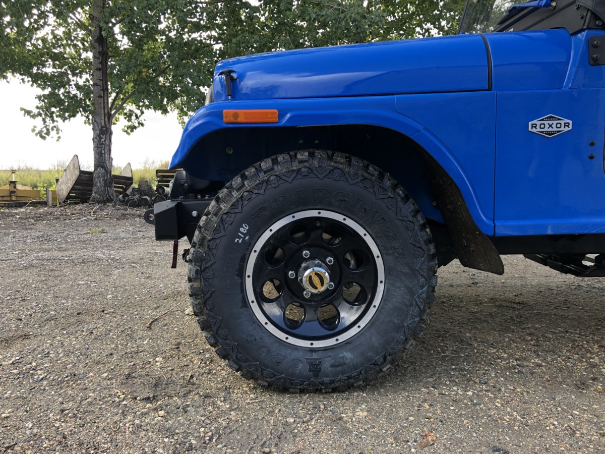

I basically drive mine like you will be. I didn't really need the locker up from but if I did do it again, I wouldn't do the Spartan LunchBox in the front, I would do a selectable in the front and I'm fine with the Spartan in the rear axle. I found the best upgrade was some better tires for the light mud. The Ko2's I had just turned into slicks in the mud. Do better tires before you do a front locker, but the back one you won't regret whether you change tires or not.
I kept the same width of tire just a bit taller and more aggressive, I went with a 235/85R16 in a 10 ply mud truck tire, cheapest I could find. A few on here have gone with this size and found them to be great. I like narrow tires to get to the bottom, I'm not looking for floatation. I can now get around places that I wouldn't even consider if it was wet out.
C64781CE-12C9-4561-9340-4E95951DD7E3.jpeg44D0FCE3-4062-4E35-9FE0-6DA6B0CAD05F.jpegD5A07EF3-AA30-43C9-AE77-4C02F8AC72C0.jpeg
