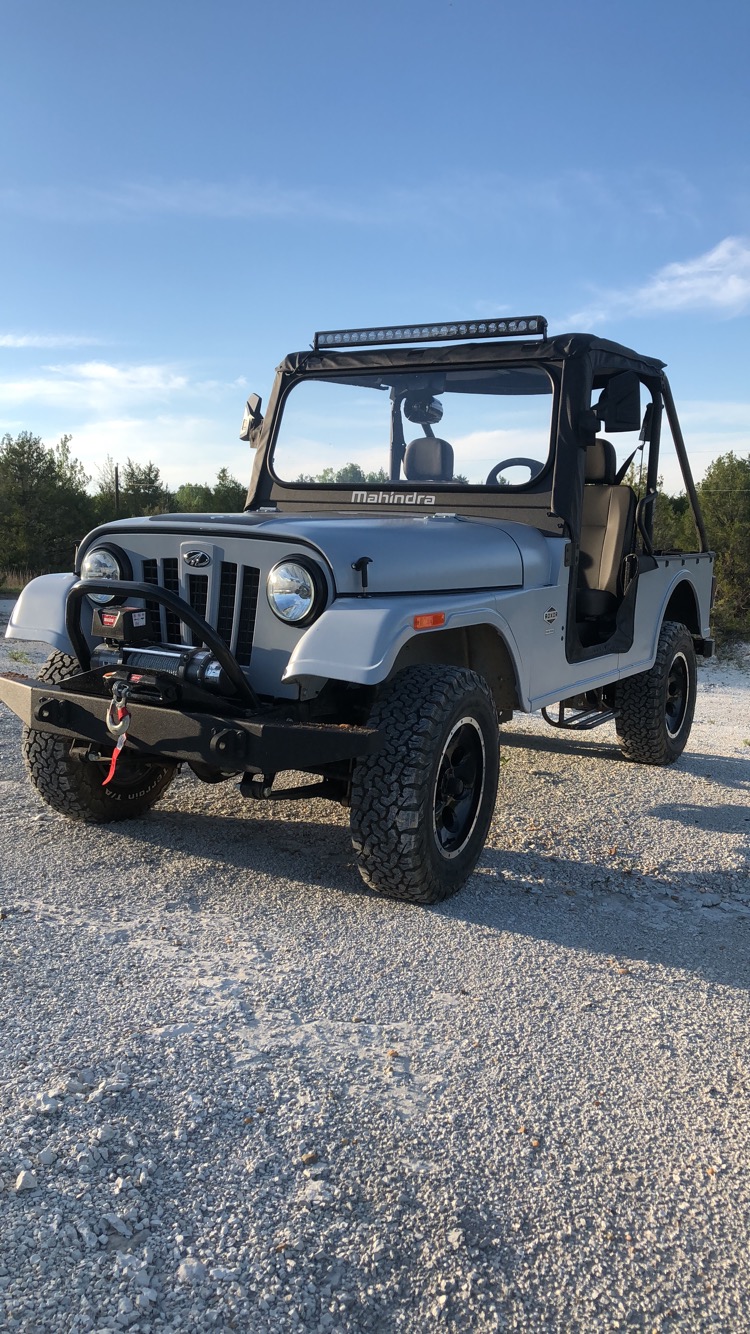

i added the front and rear Spartan lockers to my Roxor.. made a world off difference. It is a mean machine in 4low.
Roxor54
Mar 31, 2019
4
35470
I didn't add the manual locking hubs. Rides completely normal going down the highway. The only downside I have found is when in 4 low it is a littler harder to steer due to all 4 tires digging. I think i could have just added the rear lockers only and that would have been all I needed. But, it is like night and day from how it was when I bought it from dealership. Here is a photo of my rig..

Nice bumper you've got there too. Would that happen to be the EAG?
bordercollie
Mar 12, 2019
206
MS
Thank you for the quick reply Roxor54. That's a nice looking machine you have there.
