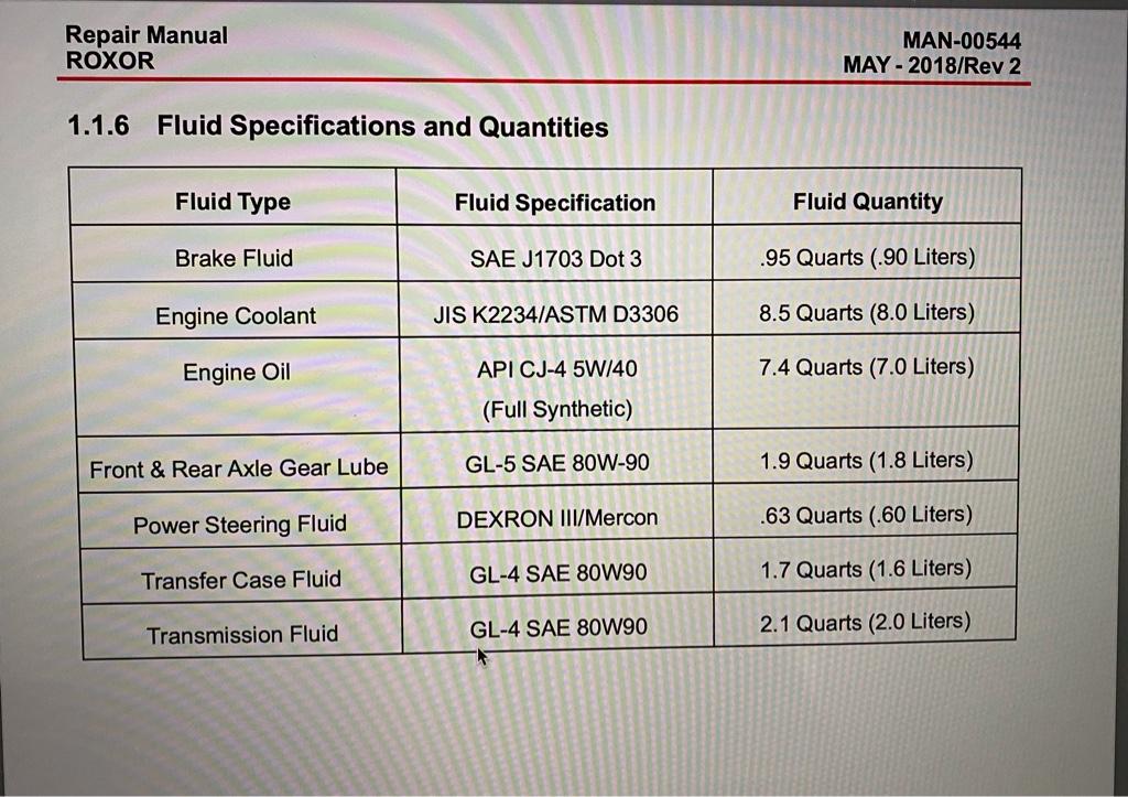

Anyone know if Roxor uses Rotella red coolant from factory?
1,208
back when j did my heater I couldn’t get anyone to tell me a brand and only got the specs it needed to meet. Problem was those specs covered a variety of coolant types some of which weren’t compatible. So I ended up flushing the system then going back with a red extended life heavy duty truck coolant.
Sidewaysxr
Dec 22, 2020
16
Alta, WY, USA
Peak Asian Red/pink meets the listed specs.
813
U can use any make and model and color. I've changed out the fluid to Amsoils Yellow
