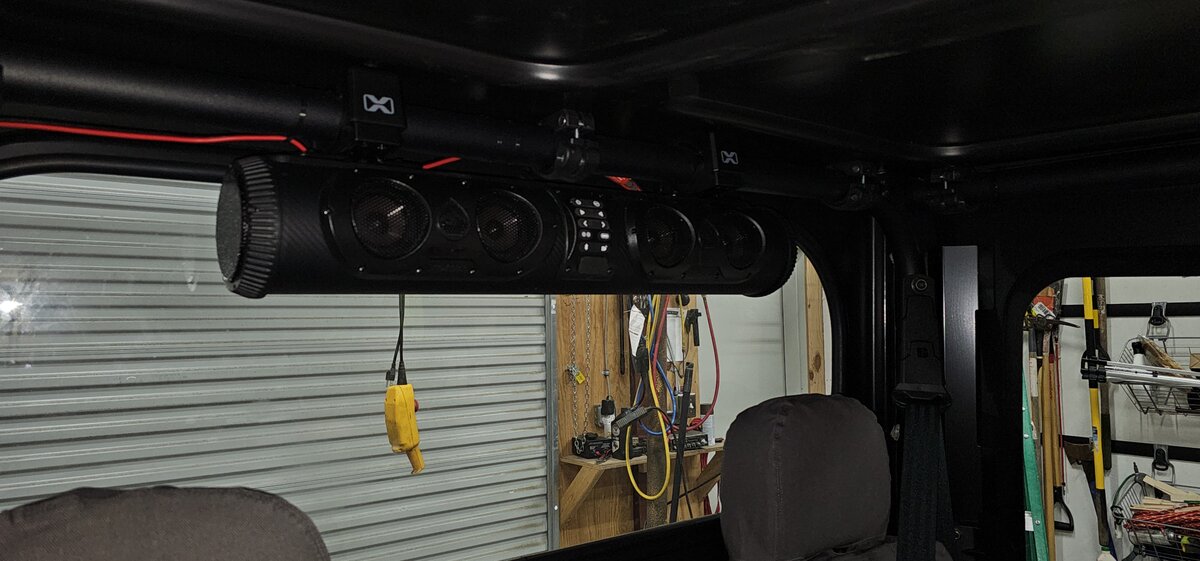

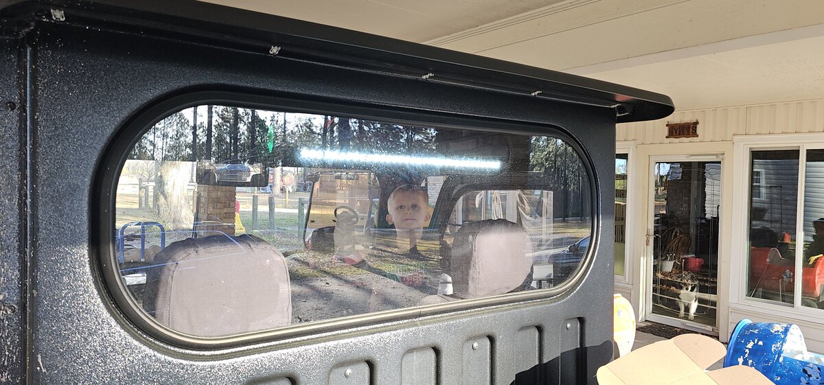

I took the roof off today to install my Ecoxgear soundbar. It worked out pretty good. It didn't take but 30 minutes or so. I can still see out the rearview mirror. The light on the rear of the soundbar aims directly at the cargo area.

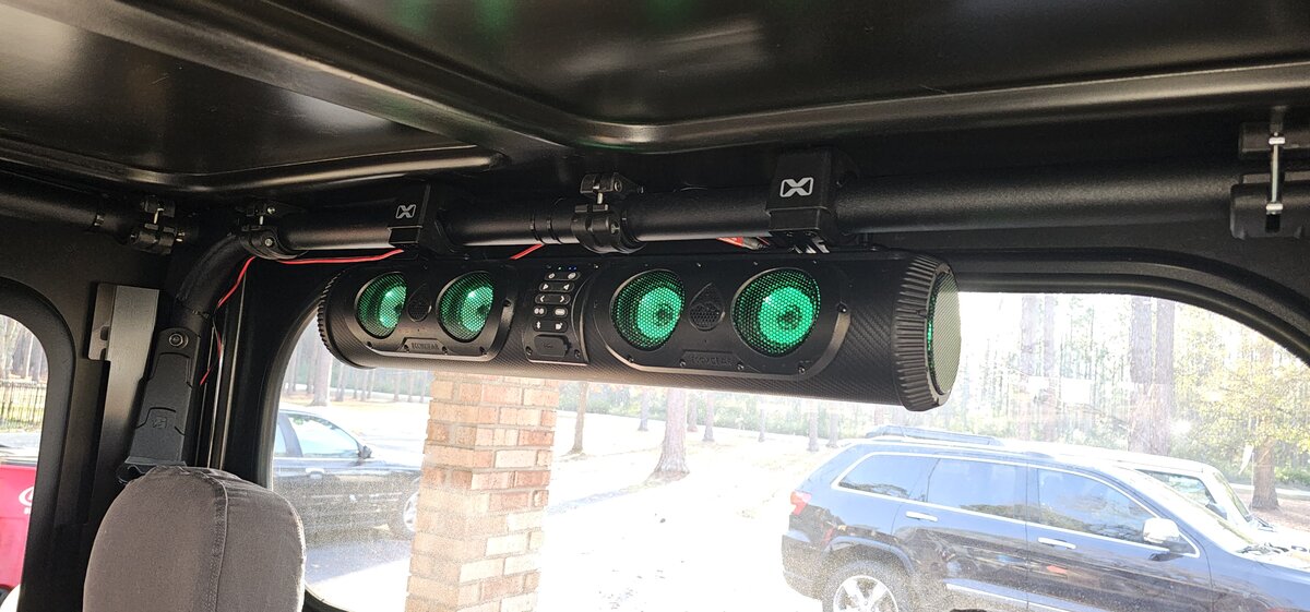

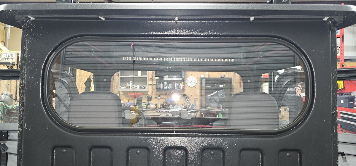

Nice, I have a soundbar in mine as well, they are great, easy to install, and take up no room.
I used the 6 pin plug on the right. I used the ground at the firewall and the 12v accessory pin. The only issue that I ran into was the harness that came with the Ecoxgear had insulated wires that do not fit in the Molex connector. I had to run a lead out and splice it in. I pre-wired the rest of that plug for lights that are coming soon. I will hook up my turn signal kit to one of the 4 wire plugs at the power center this weekend.
