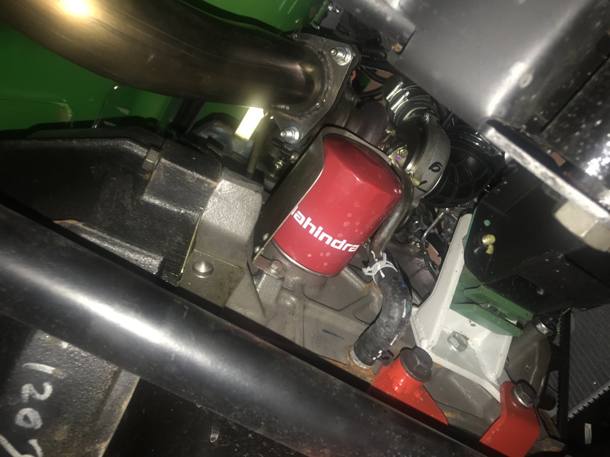

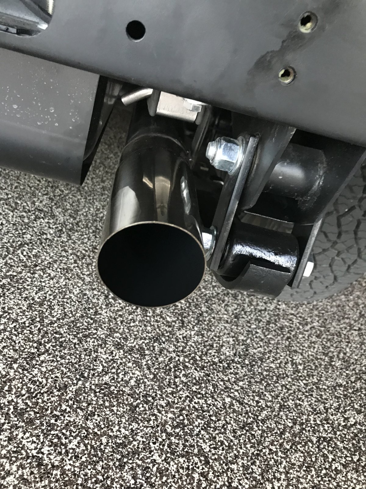

Diesel Freak Turbo Back 2.5” Exhaust rear exit. Awesome exhaust system, the inline muffler is perfect to hear the turbo sing but the harmonics are not obnoxious. Install was fairly straight forward, the three holes on the flange that mounts to turbo exit did not line up very good. Ended up having to bore the three flange mounts to 7/16”. Other than that it is flawless! Also, got the Intake Hold Down installed super straight forward install.
