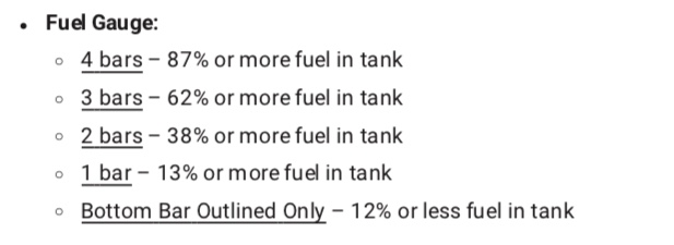

mopar93
Sep 17, 2018
Lansing, MI, USA
1440
I filled up the Roxor when I first got it and today it just barely got down to 1 bar on the fuel gauge. Not knowing how far I could go once it gets down to 1 bar, I took it to the gas station for its first refueling. I noticed on the way, the fuel would slosh around and it would show 2 bars and then go back to 1 bar. So, that confirms that it just got down to 1 bar.
It took 7.88 gallons to fill it up which means I still had over 4 gallons remaining. I had 237.3 miles on the odometer which translates to 30.11 mpg.
I've got some of those miles running at 20-25 mpg, but most of it has been 10-15 mph on the trails here in Roscommon County, Michigan. The hour meter shows 19 hours, so I've been averaging 12.48 mph during this stretch.
So, when it gets down to 1 bar, I should be able to go another 120 miles if I drive the same way. That means I should be able to get about 360 miles of a tank of fuel.
I think that last bar goes to a flashing outline when your real low, so its kinda like having 5 bars to work with. lol. I think I read that in the owners manual.
Edit: I found some stuff in the manual.
