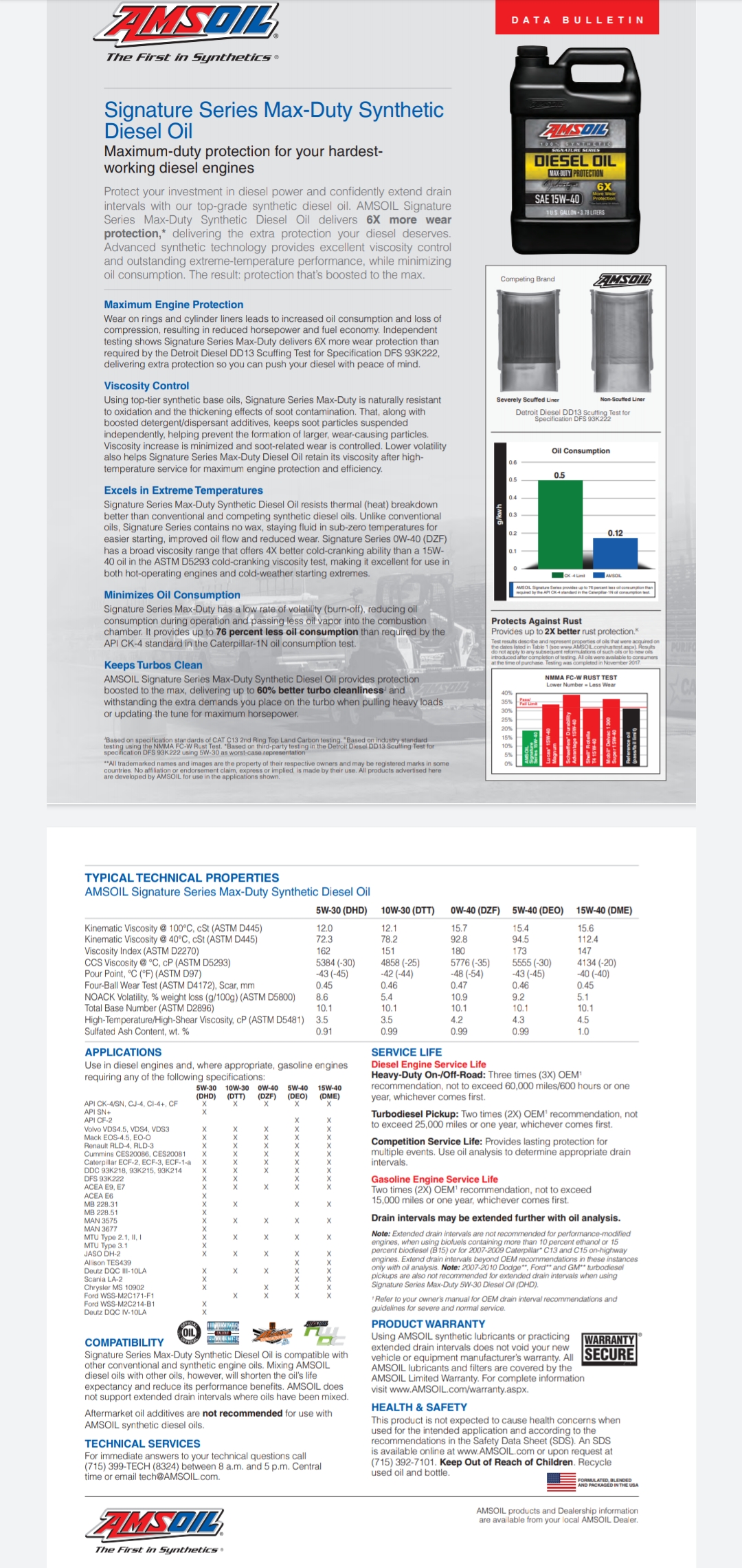

Which oil filter are you going to use?
Also how do you know which amsoil product is api ck-4?
822
Napa gold 1324 filter or wix 51626
API CK-4 is the minimum standard for oil, Amsoil products exceed that standard. Amsoil is still looking into seeing if they have a filter that fits

After reading through the manual, that 1500mi recommendation for oil change. Was surprised at that. I guess that would work for mostly off-road in lower gears.
822
I plan on changing engine oil once a year unless I pull an oil sample off to be analyzed. Amsoil sig series is a 1 year or 25k oil. Oil still collects contaminates sitting

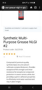

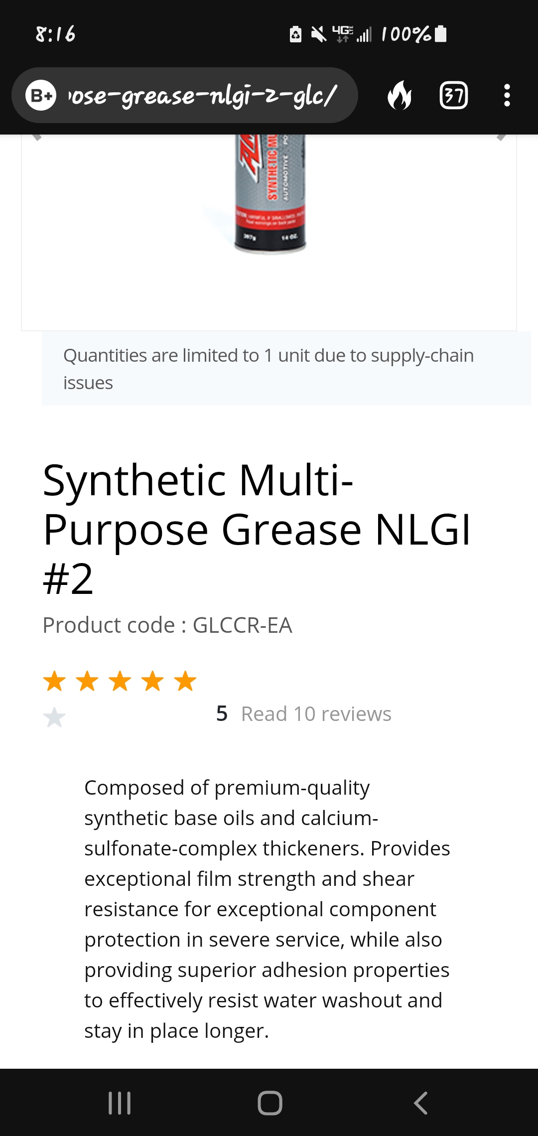

I am thinking seriously about this. Amsoil warranties? Do they also make grease compatible with Roxor grease and fittings.
822
Absolutely, I've already pushed all the whatever grease out. Amsoil grease last twice as long as traditional and won't pound out. Roxor grease isn't anything special. out.https://www.amsoil.com/p/synthetic-multi-purpose-grease-nlgi-2-glc/
