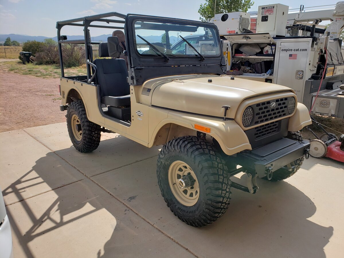

33x10.50x15 KM3's
792
just got my new wheels and tires on.
792
What backspacing? Any rubbing?
0 offset. 7" wheel. So it's a 3.5" backspacing. Rubbing at full flex without the swaybar. No rubbing while turning lock to lock. Drove it 6 miles to the hardware store for my next project. Rides good.

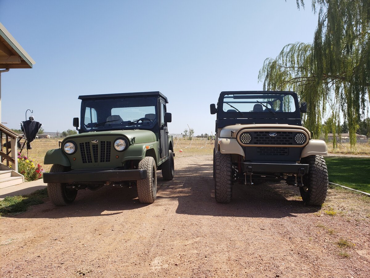

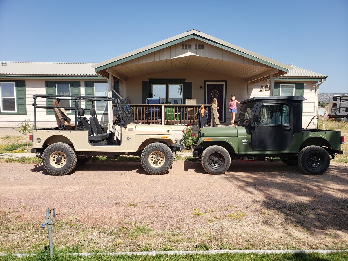

Here's mine and my parents. Theirs is stock. They just took delivery of it today

I disagree. They barely fit. Any articulation and they rub.
Yj springs, and associated hardware, are in your future. I can see it now!
Is it a lift issue or a spacing issue? I'm considering 33x10s with a negative offset to push away from the engine bay more. I guess a better question is where are you rubbing?
792
Both. I'm rubbing on the fender support brackets at the top of the fender. Once the springs are in, I'll adjust fire on spacing if needed

It's the diameter of the tire that is causing the rubbing.
