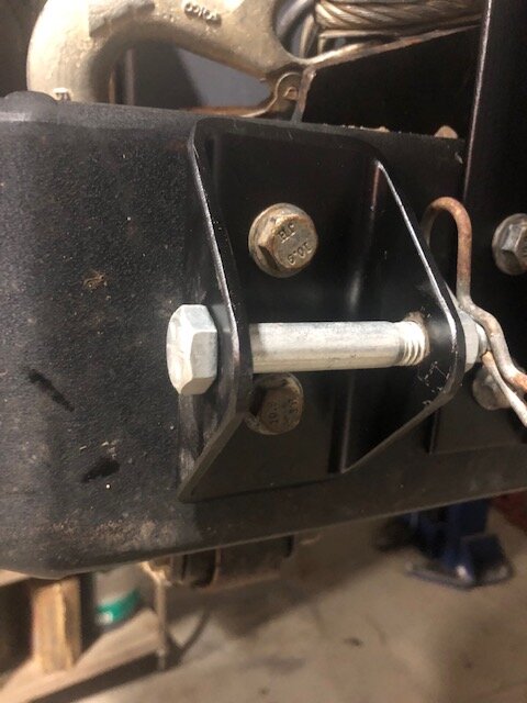

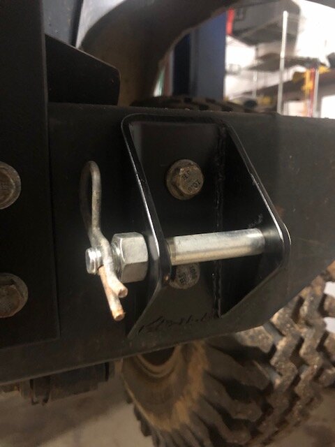

These were quickly made from 2 1/2", 1/4" wall square tubing cut at a 45 degree angle. They work well to attach a tow bar to the front of the Roxor and, I think, they will make good recovery points for a tow strap if I need a little assistance off road.

When I did that to my stock bumper, the tow bar really bent the (junk) bumper. Replaced with 4inch channel iron. Rc
