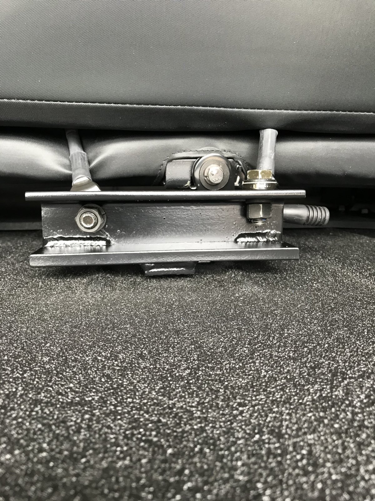

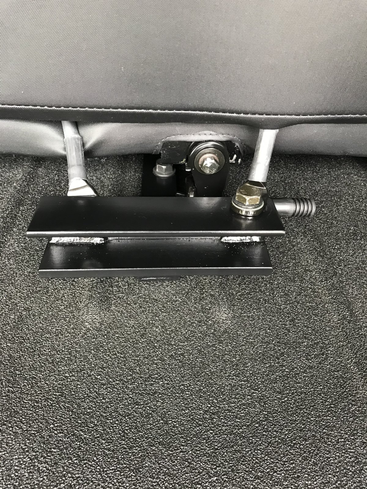

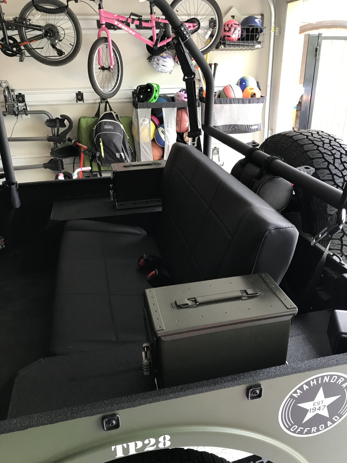

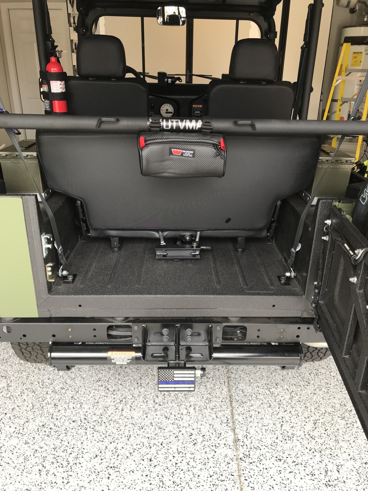

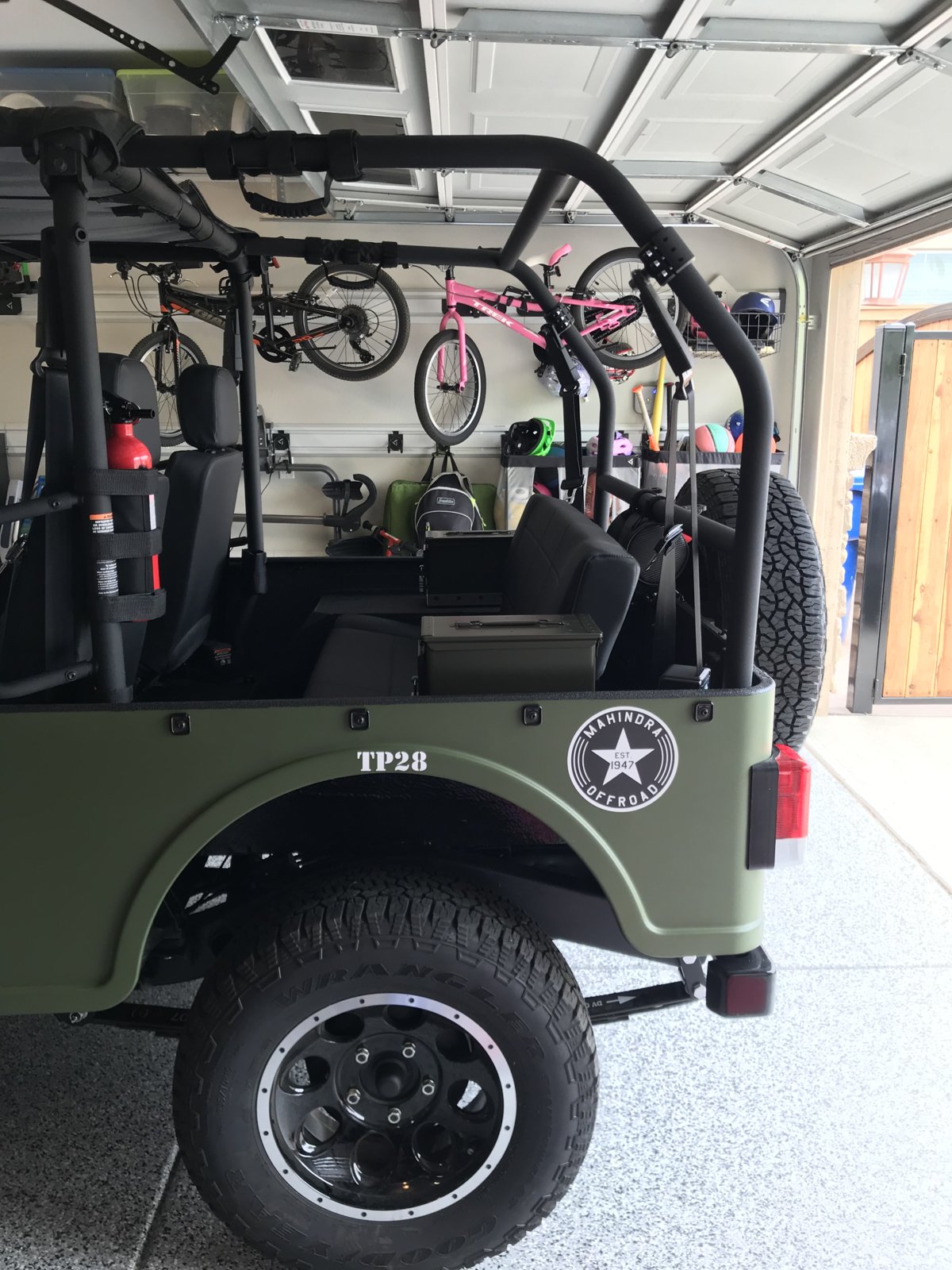

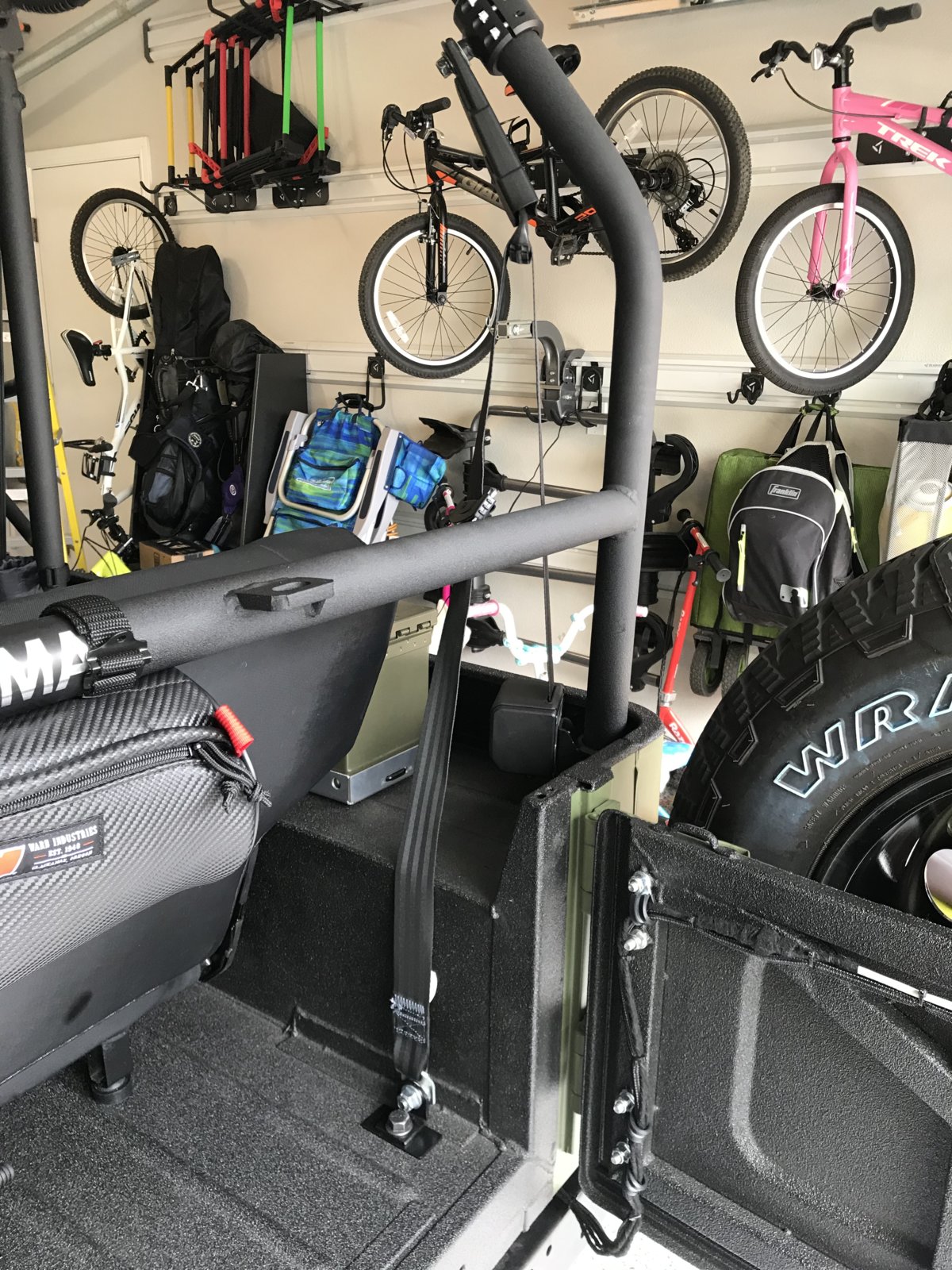

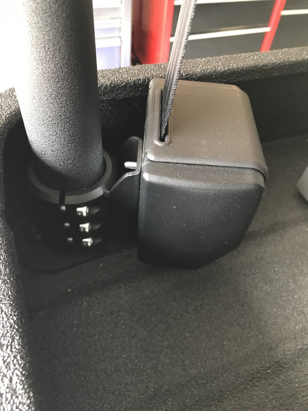

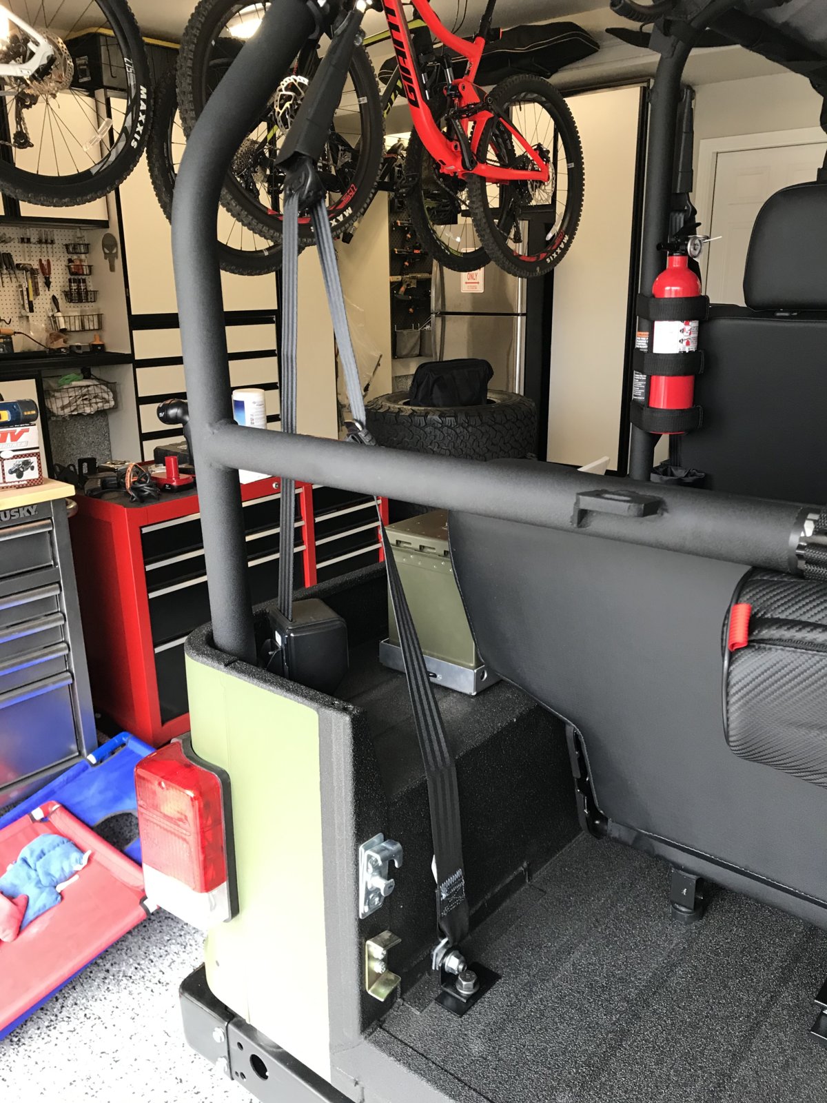

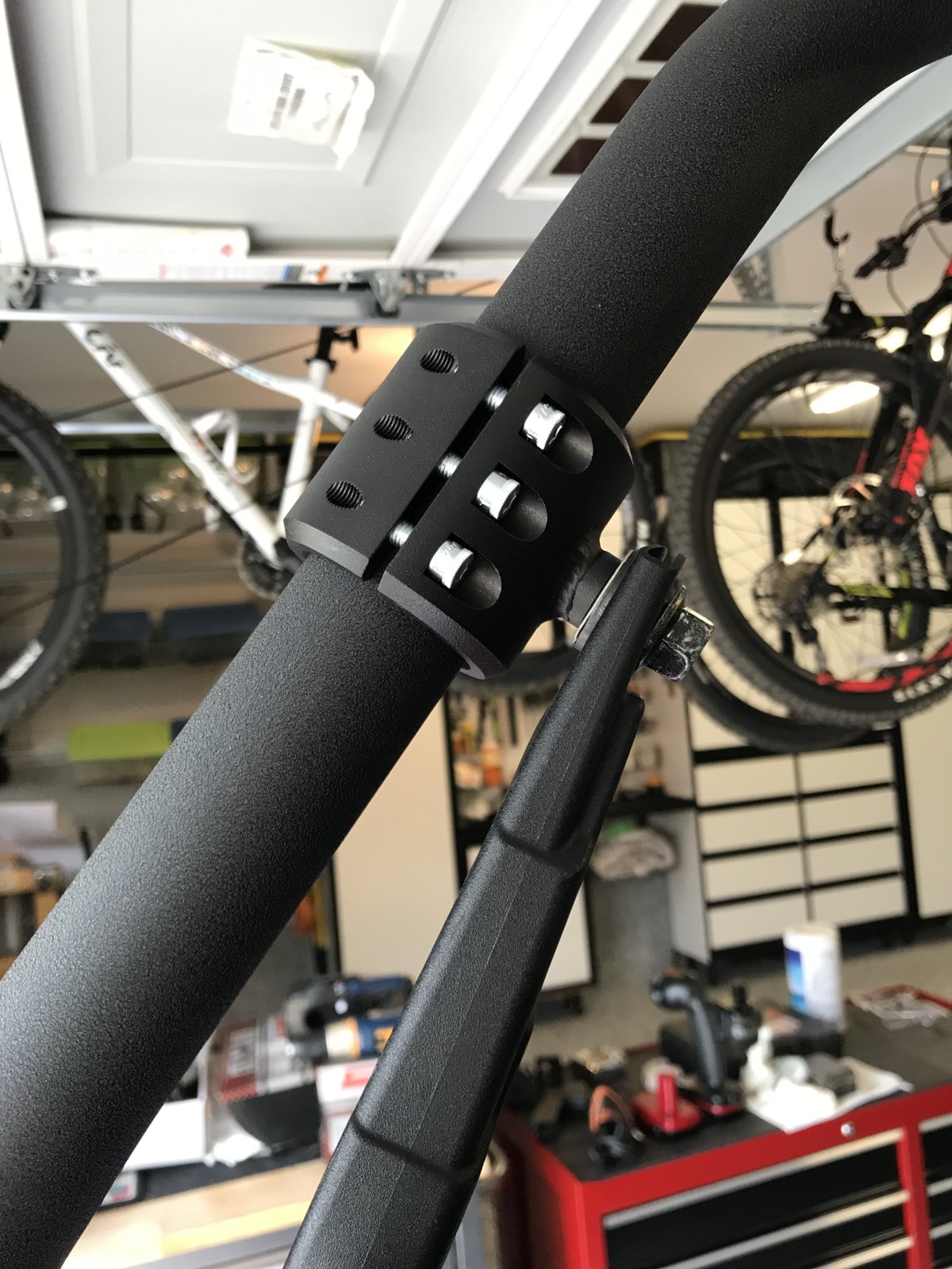

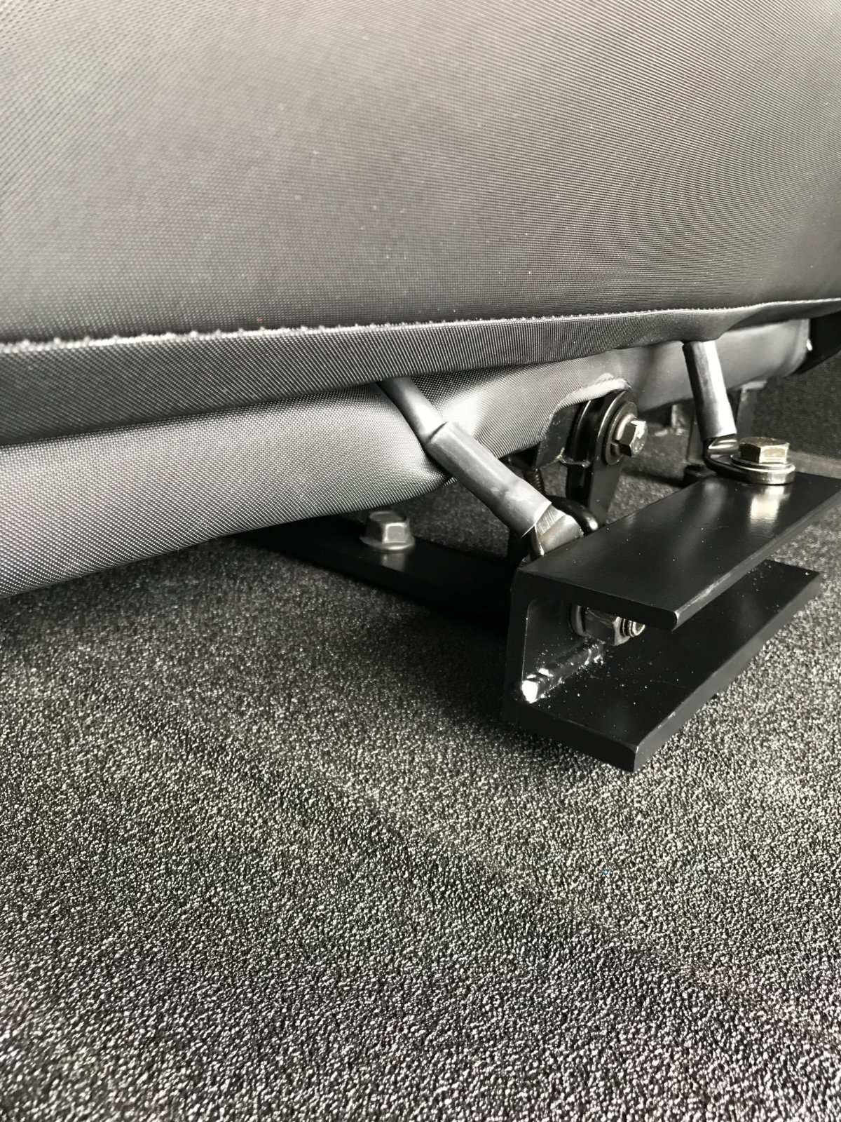

I bought these rear seatbelt brackets made specifically for the Roxor. I also bought two of the factory seat belts from Sherwood Tractor for the passenger side and mounted those in the back. They look and fit great. I've gotten a lot from these forums and wanted to post this incase someone else was looking at doing the same.

I purchased the brackets that bolt to the cage from Rick at Cecco Racing (465Stroker on here). The bracket that bolts to the floor I had made since I bought two of the factory passenger seat belts. I didn’t realize that they would bolt weird since they are made for a passenger side. If I had to do it over I wouldn’t purchase the factory seatbelts, I would just go for good aftermarket seatbelts.
