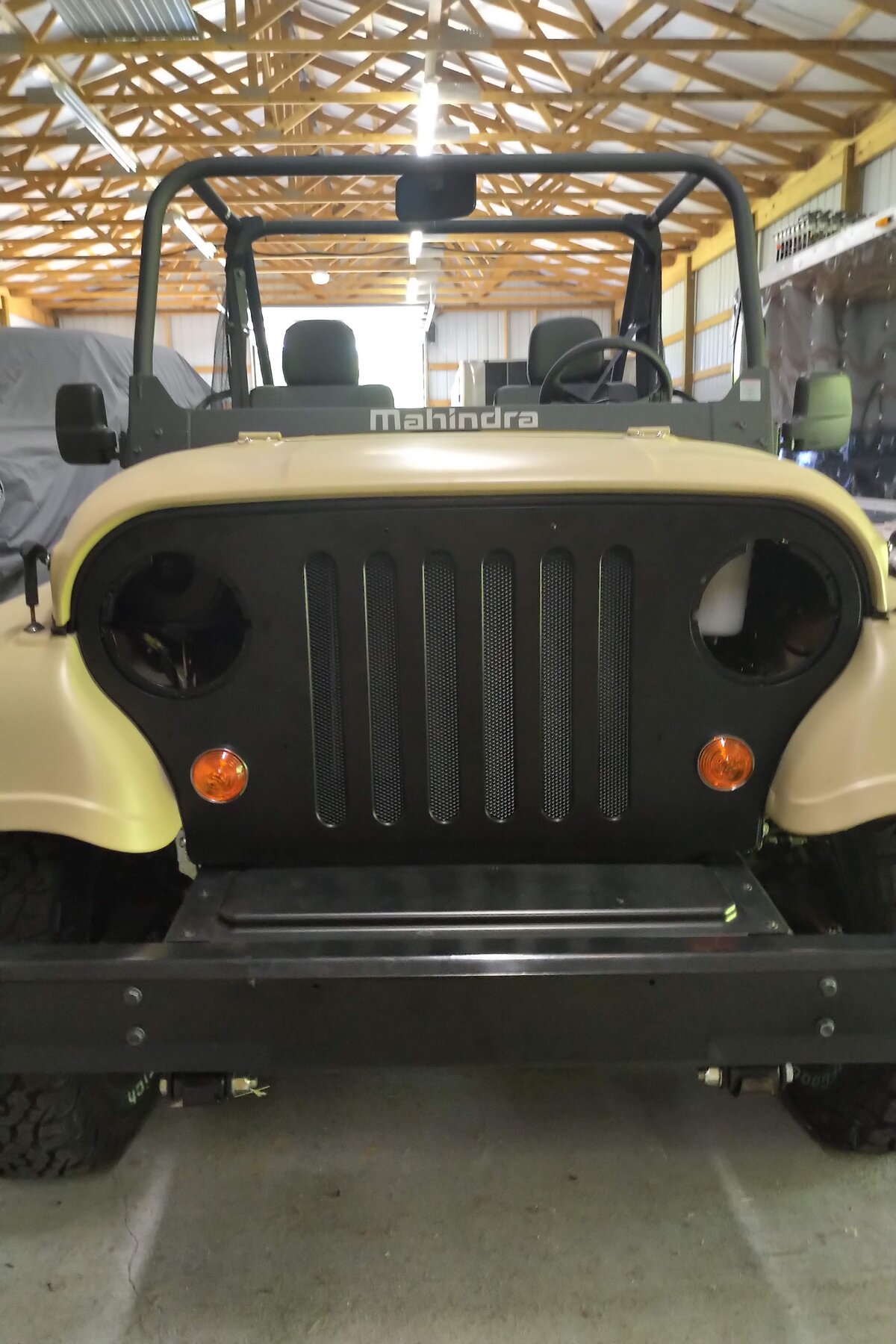

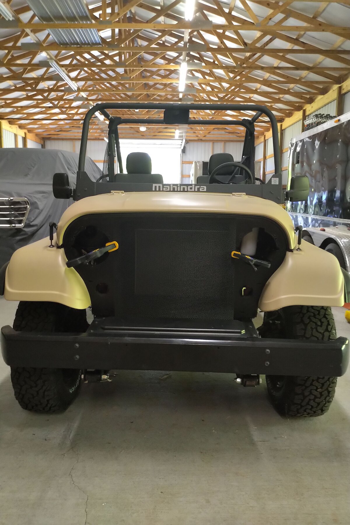

I installed a strong metal grid behind the grill which not only protects the radiator but enhances the appearance. See pics. The first pic has the grid clamped in place before fastening it. Second pic shows it with the grill on over top of the mesh.

How did you attach it to the back of the grill?
meyerld
Nov 8, 2018
122
Georgia
Just a few nuts and bolts on the two sides. Use bolts with flatter heads so they don"t contact the inside of the grill when it is attached. This is a very simple mod and it improves the appearance also. I use mine in the bush for work a lot and have had branches jam into the grill since installing this and the mesh is very strong - easily withstands the force. Also, the order from Amazon is enough to make several so worst case is just cut another if it gets damaged.

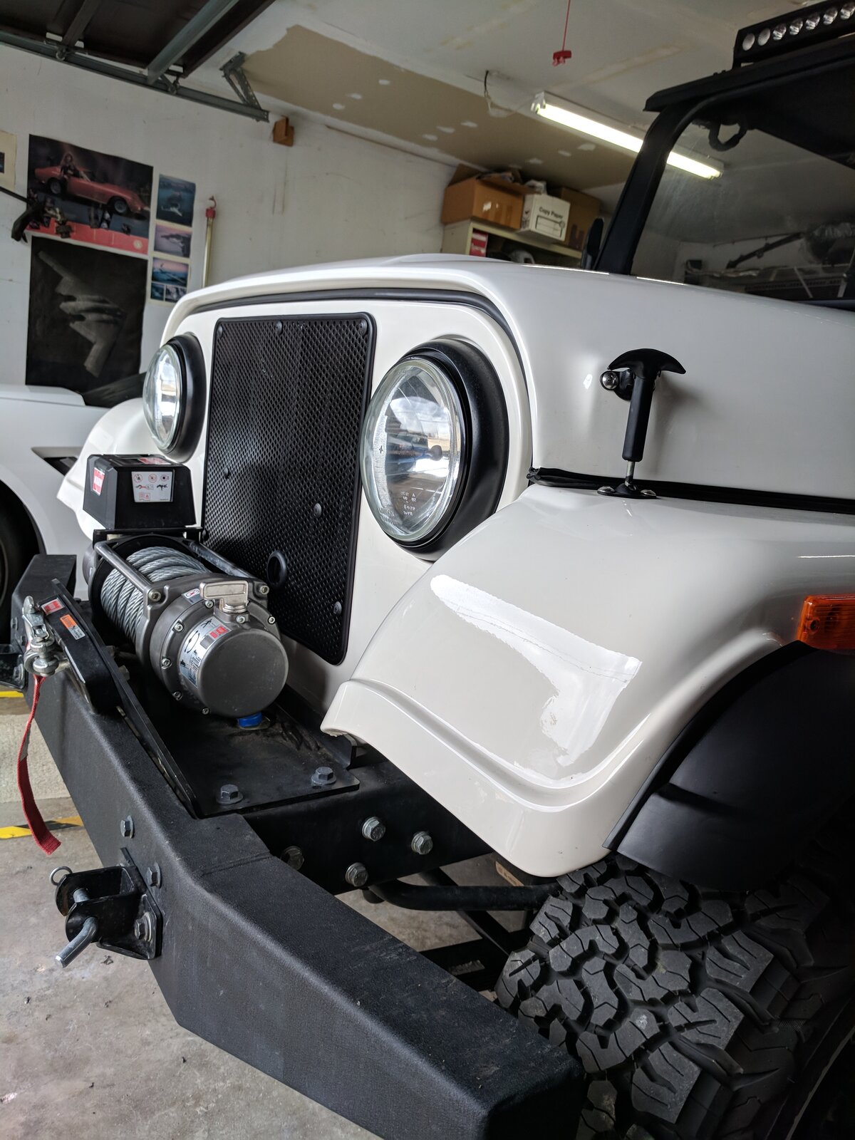

I did this. Ordered on line. Did a thread here someplace. I used the plastic hole plug things from the door hinge hole plugs to attach it.

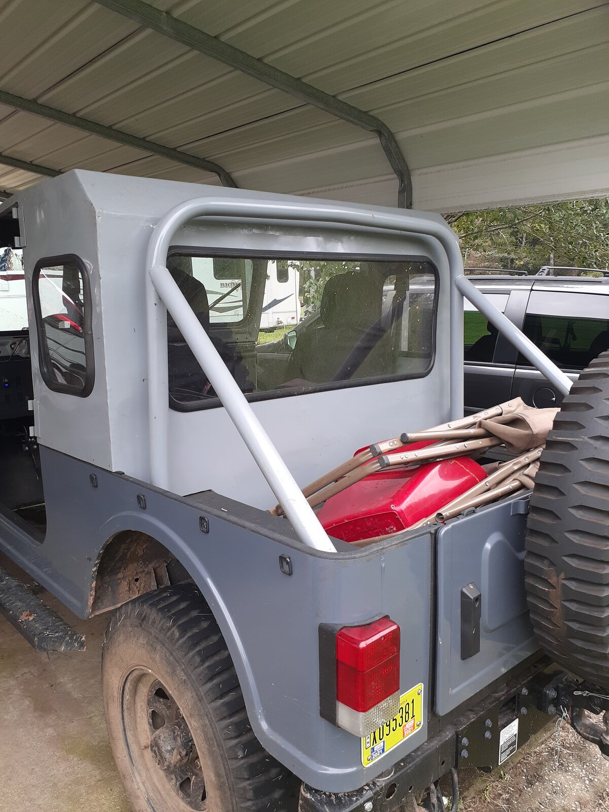

3171
Here is the use of the cj rollbar. I took all the cage, windshield and roxor top off. Like this so much better.
