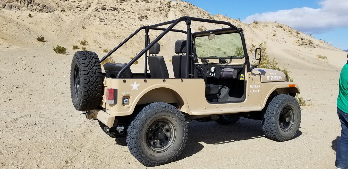

Can anyone help me to obtain the front drive shaft spec's for Climax Offroad Max Anthony kit so that I can order a shorter one from Tom Woods? Ryan at Tom Woods informed me they had system crash and lost all previous spec's. It would save me some time and re-assure me on any dimensions I take. I have a 2020 Roxor w/factory 3" lift. I purchased Max Anthony kit, 4-RE1430 Rubicon Express 2.5" YJ springs, Bilstein shocks 33-104645 and 33-230443 and RE2790 bushing kit. I have stock driveline. I am hoping someone has done Max Anthony kit with stock driveline and can share the driveshaft specification that they used. e.g. flange types with length) I look forward to a softer ride as the factory 3" lift in 2020 is VERY STIFF springs. Note: I am guessing the factory lift 2020 drive shaft is same length as non lift.
