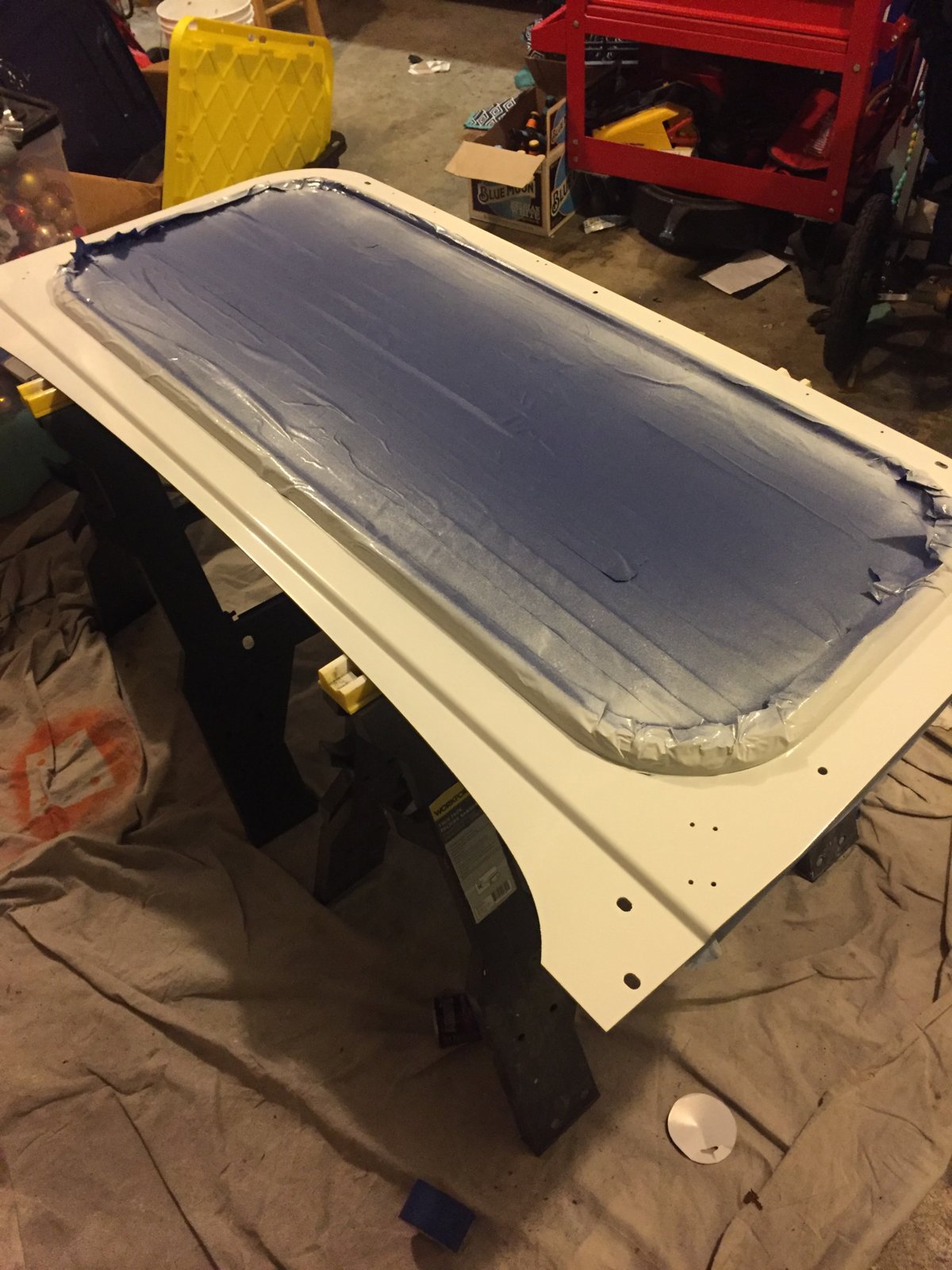

I saw that a few other members have painted their windscreen to match the body and I really liked the result.
A lot of you know I like to save money when I can on roxor modifications so I painted this myself. My father owns his own shop in California and I got a lot of useful advice. Here's some tips I can pass on.

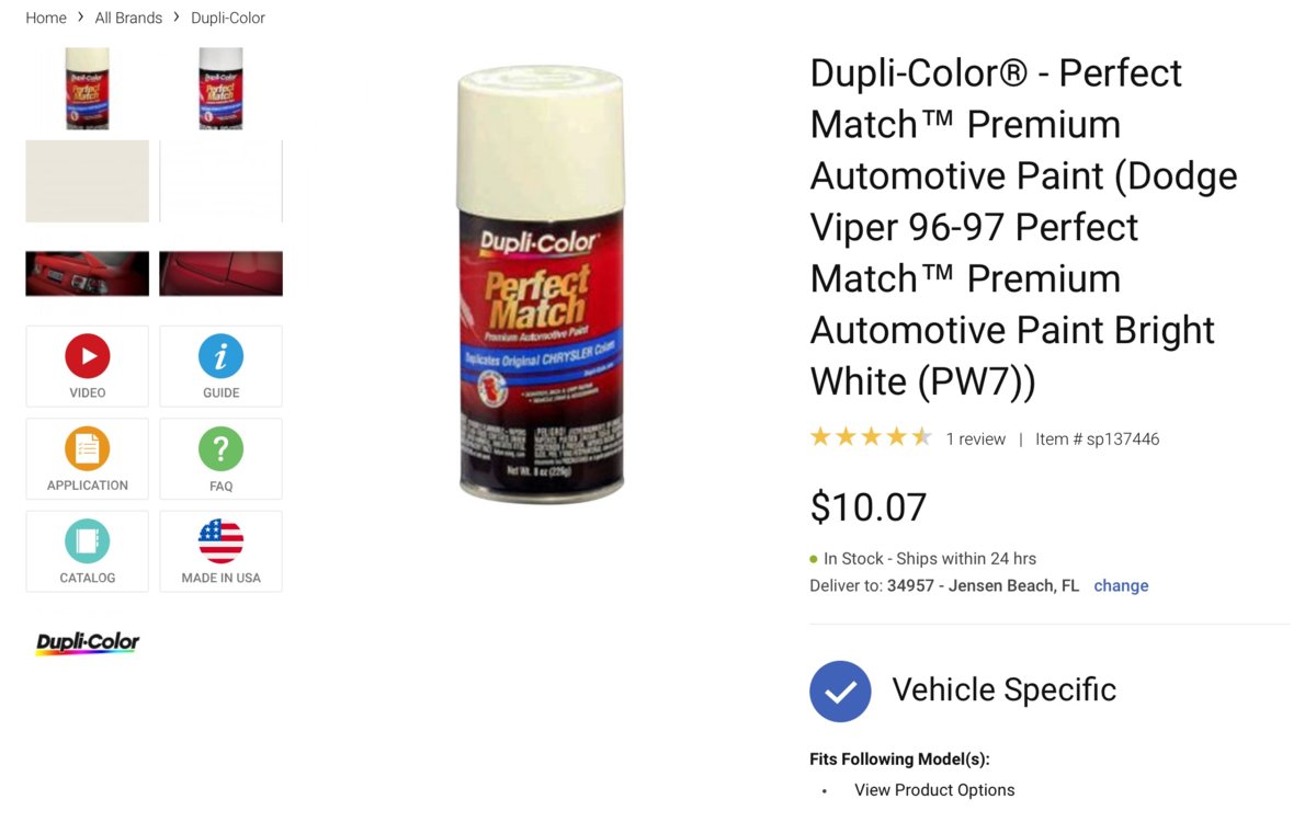

1) contacted my dealer about the white paint code and he confirmed the Roxor white color is very close to the Chrysler Viper White. I picked up a rattle can of Dupli-Color for 13 bucks off eBay. I had to spray 5 coats to get a good solid coverage.
2) after my color was dry I used Spraymax Clear Coat. I'm really happy they came out with this stuff because there's a button on the bottom and when you press it the hardener will mix with the paint giving you a professional automotive clear coat. The can costs 18 bucks but it's well worth it. Keep in mind once you activate it the can will expire in 24 hours. Here's a link to ebay for it.

At the end of the day I'm into this job about 2.5 hours and $30 bucks.
