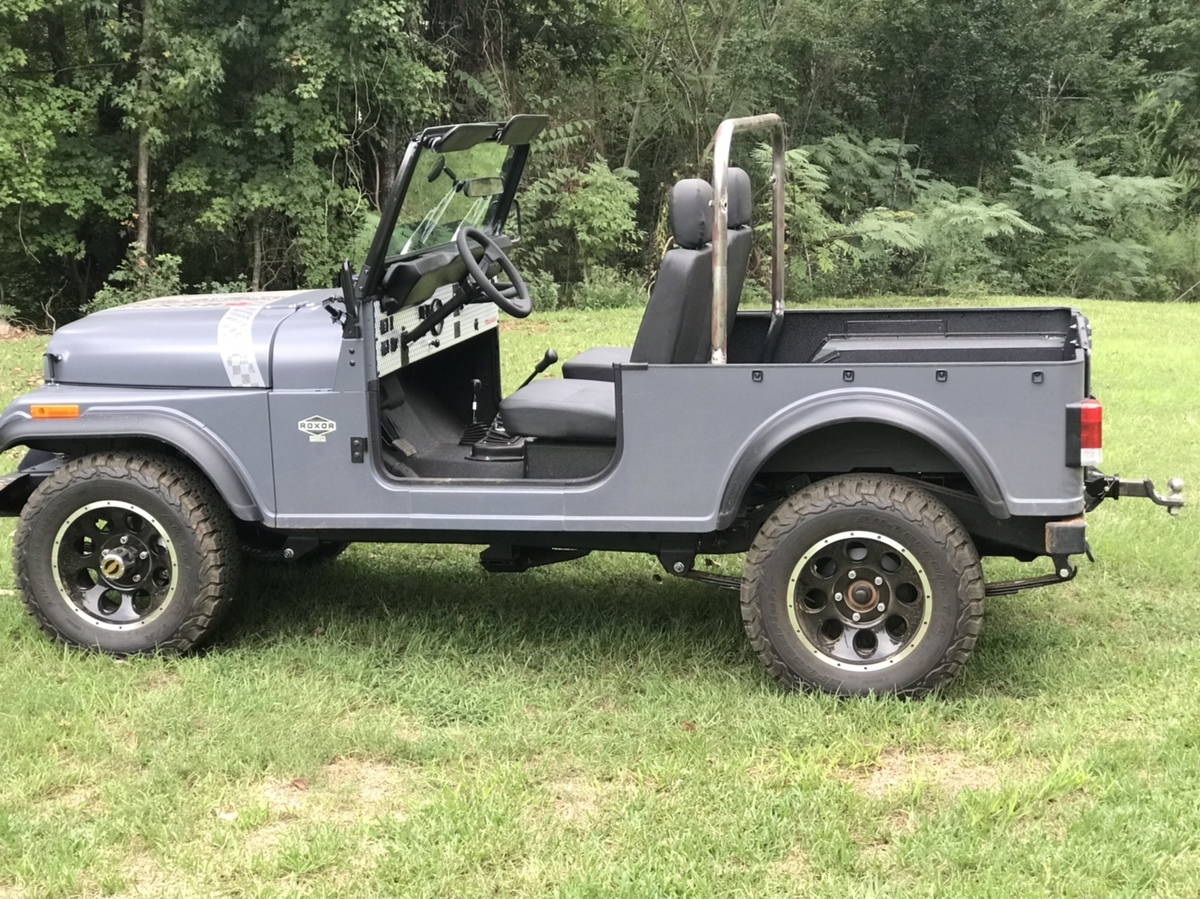

Steve243
Aug 18, 2018
77
Nacogdoches, TX, USA

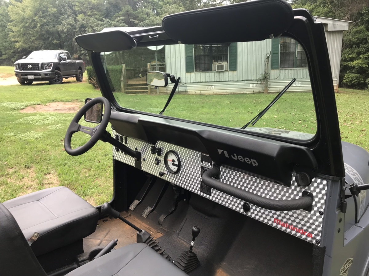

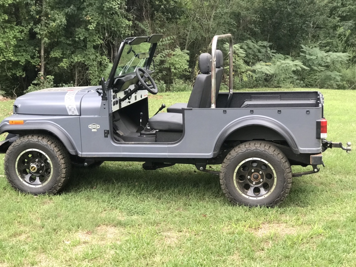

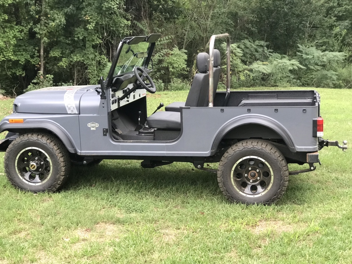

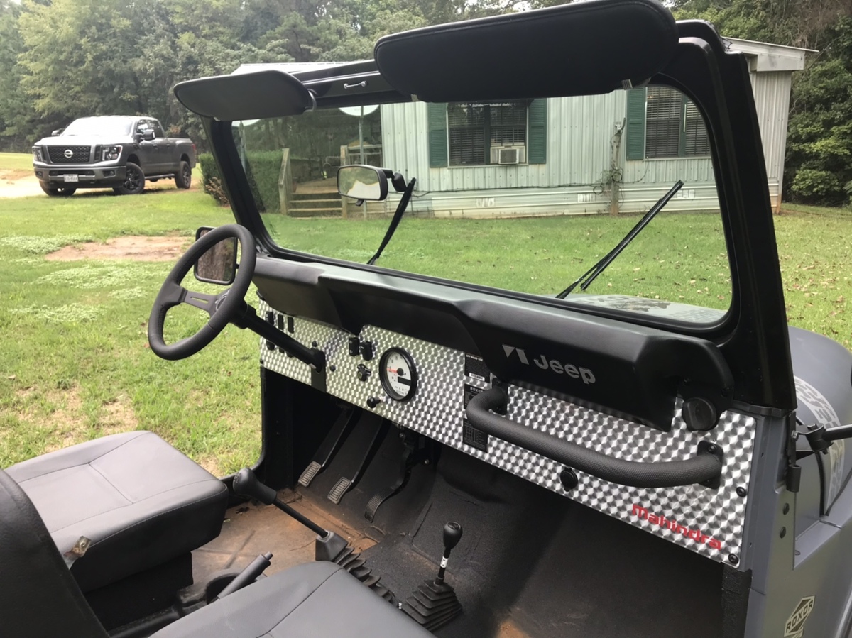

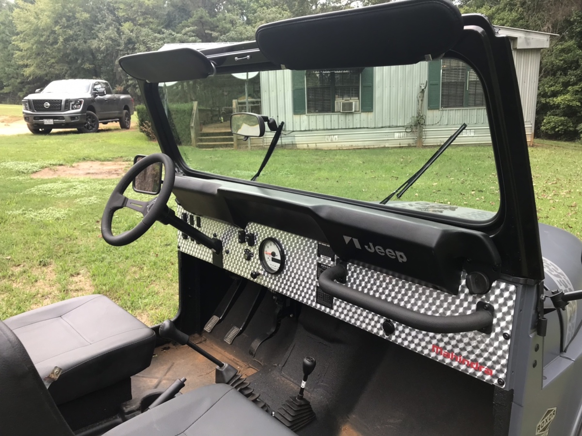

76 to 86 CJ windshield will fit. I also installed wipers from a CJ and dash pad in mine. Building a roll bar like a CJ. I’ve seen some use a CJ of YJ roll bar also.
Bfree
Sep 18, 2018
86
Shreveport, LA, USA
Great Pix! Thanks for sharing. Thats what I want to do to mine! Which fender flares are those off of?

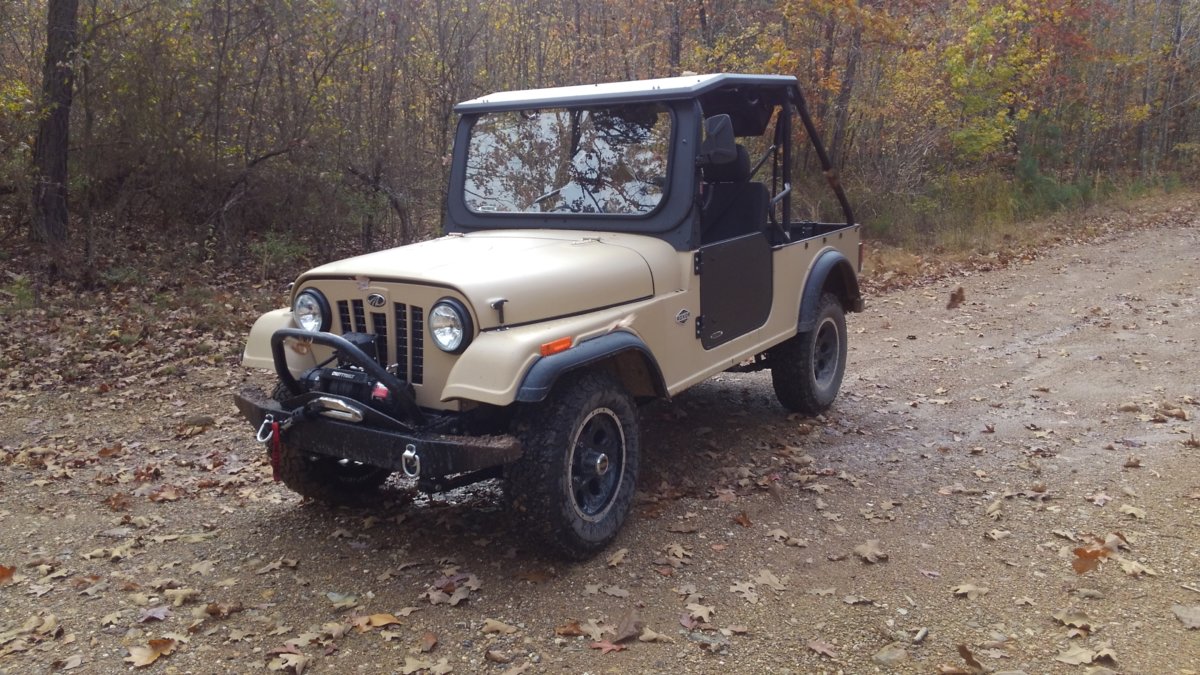

838
I’m really hoping a place makes a full soft top setup for the Roxor with late CJ windshield.

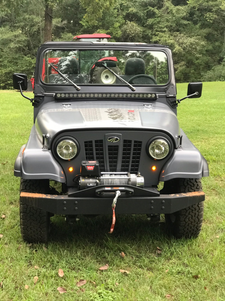

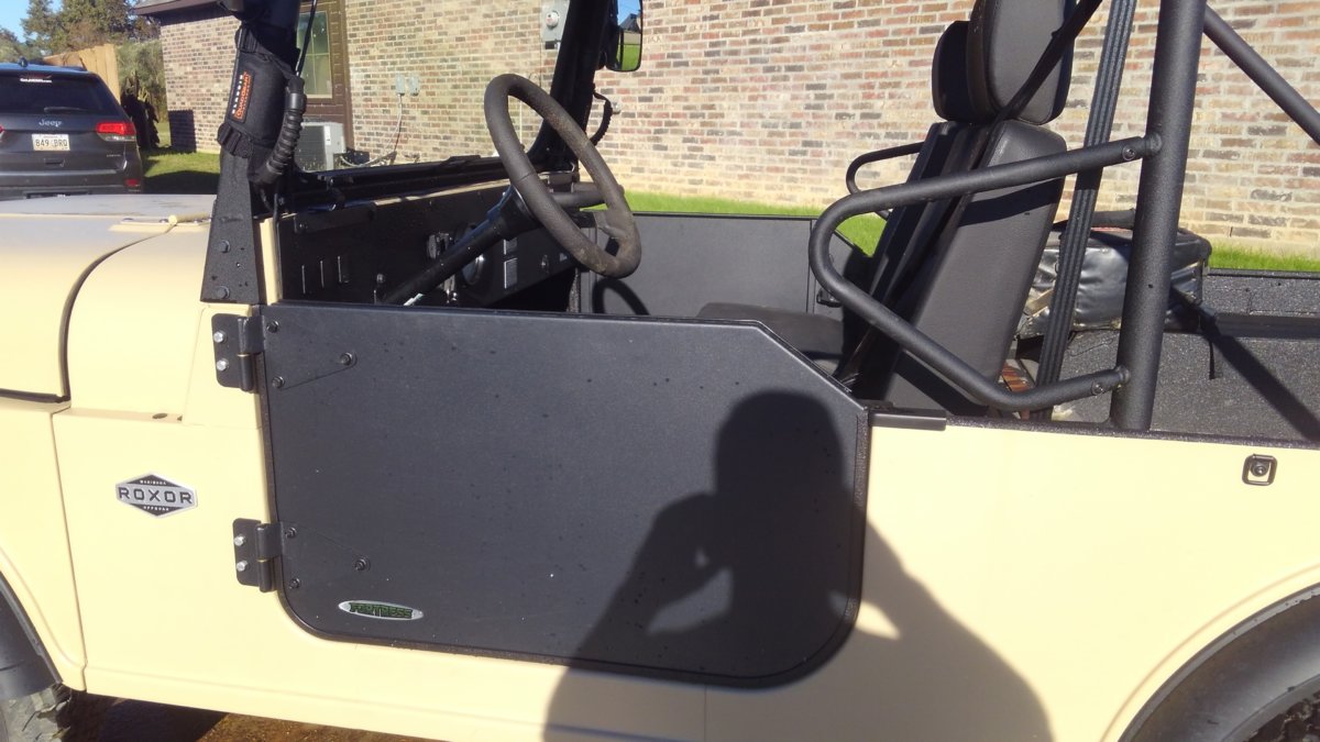

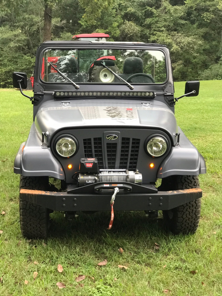

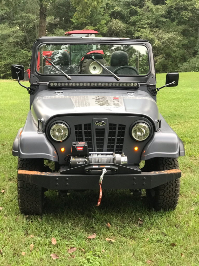

Well I have installed most of my MOST WANTED list of items and then some:
1. Vivid ECU re-flash -
2. WARN front locking hubs
3. Spartan front and rear lockers (ordered through on the rox) Sitting in my garage but not installed yet
4. Fortress Top, Windshield, and Doors
5. Smitty Bilt #9500 Synthetic Rope Winch
6. On the Rox - Oil Pan and Slave Cylinder Skid Plates
7. Pyle Radio with 6x9 speakers
8. Rugged Ridge Fender Flares
9. 2 inch Pintle Hitch
10. (4) 1.5 inch D rings front and back
Still to be installed:
11. Fortress - Windshield Wiper Kit
12. XTC turn Signal Kit,
13. Spare Tire Kit
Jimmyb
Mar 13, 2018
189

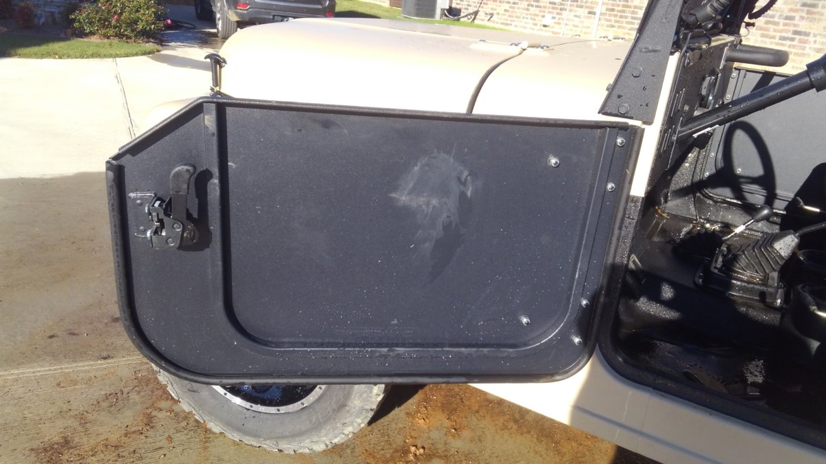

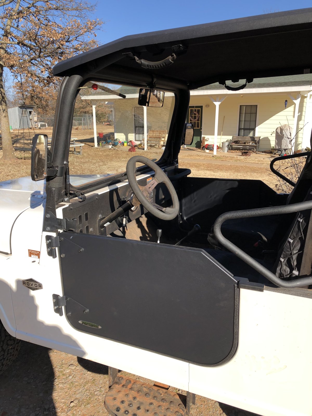

Looks great, I didn’t know fortress made doors already! More pics of them please! Also, I can help with checking the egr off of your list.

Thanks, yeah i'll get more pics of them and will be ordering that egr delete soon. What payments do you take? I don't have a paypal acct!
Jimmyb
Mar 13, 2018
189
I am looking forward to the door pictures, that was something that was on the must have list for me too. Message me when your ready for a kit but mailing a check would be fine if you don’t have a PayPal. That would be the first payment I received out of it since my wife so conveniently offered her PayPal account for me to use!
Bfree
Sep 18, 2018
86
Shreveport, LA, USA

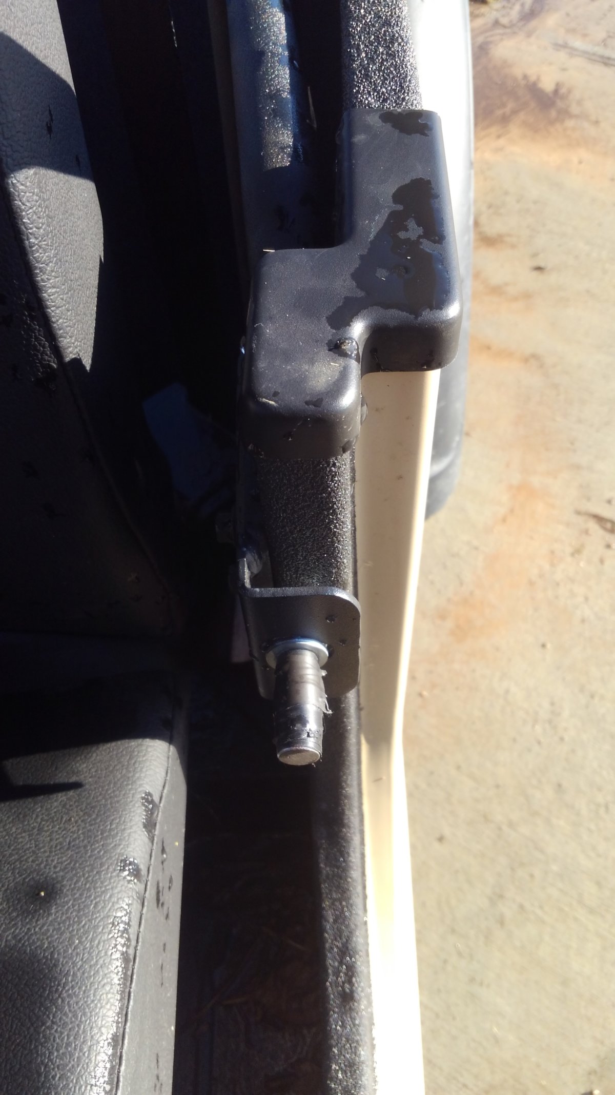

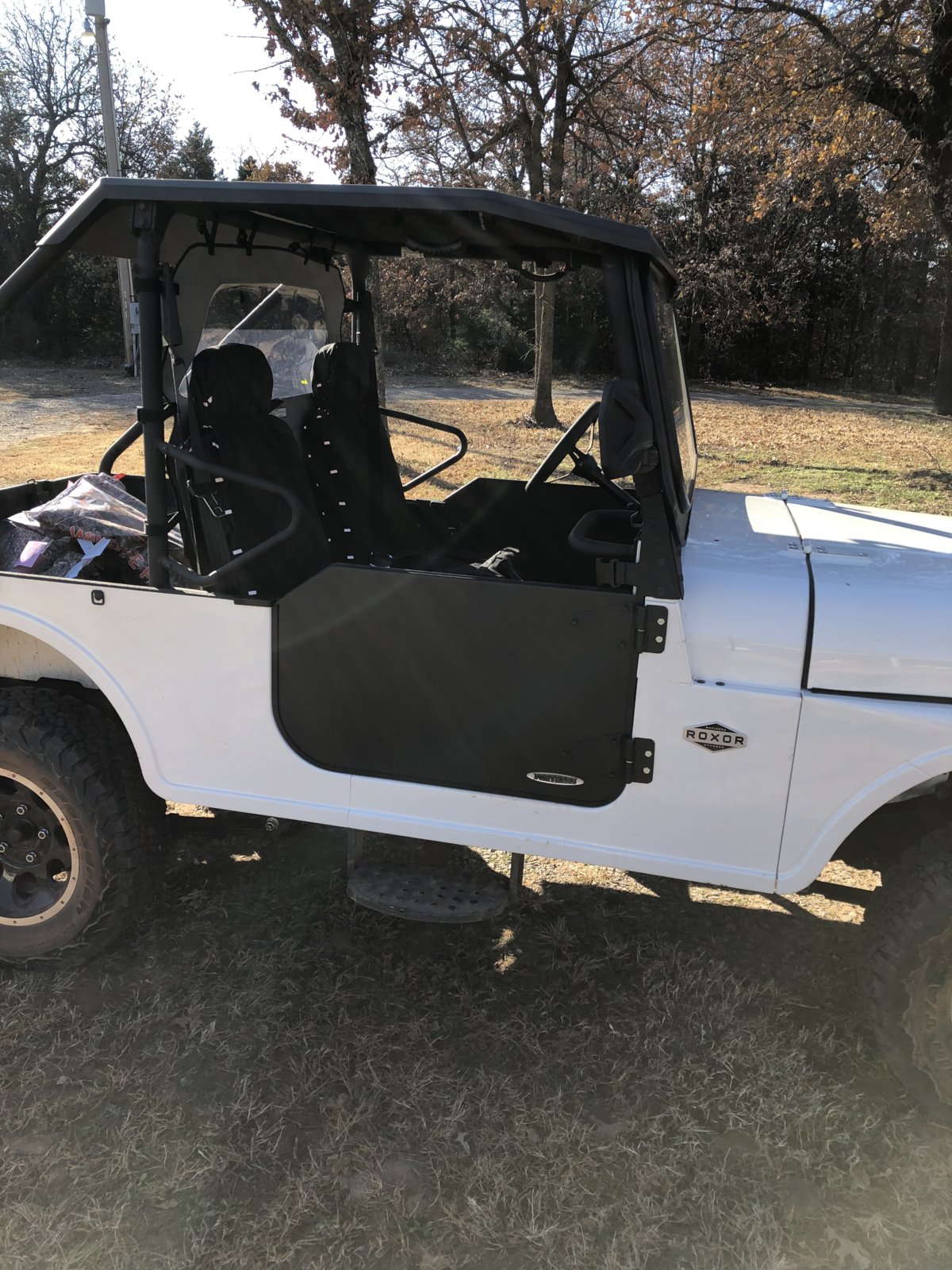

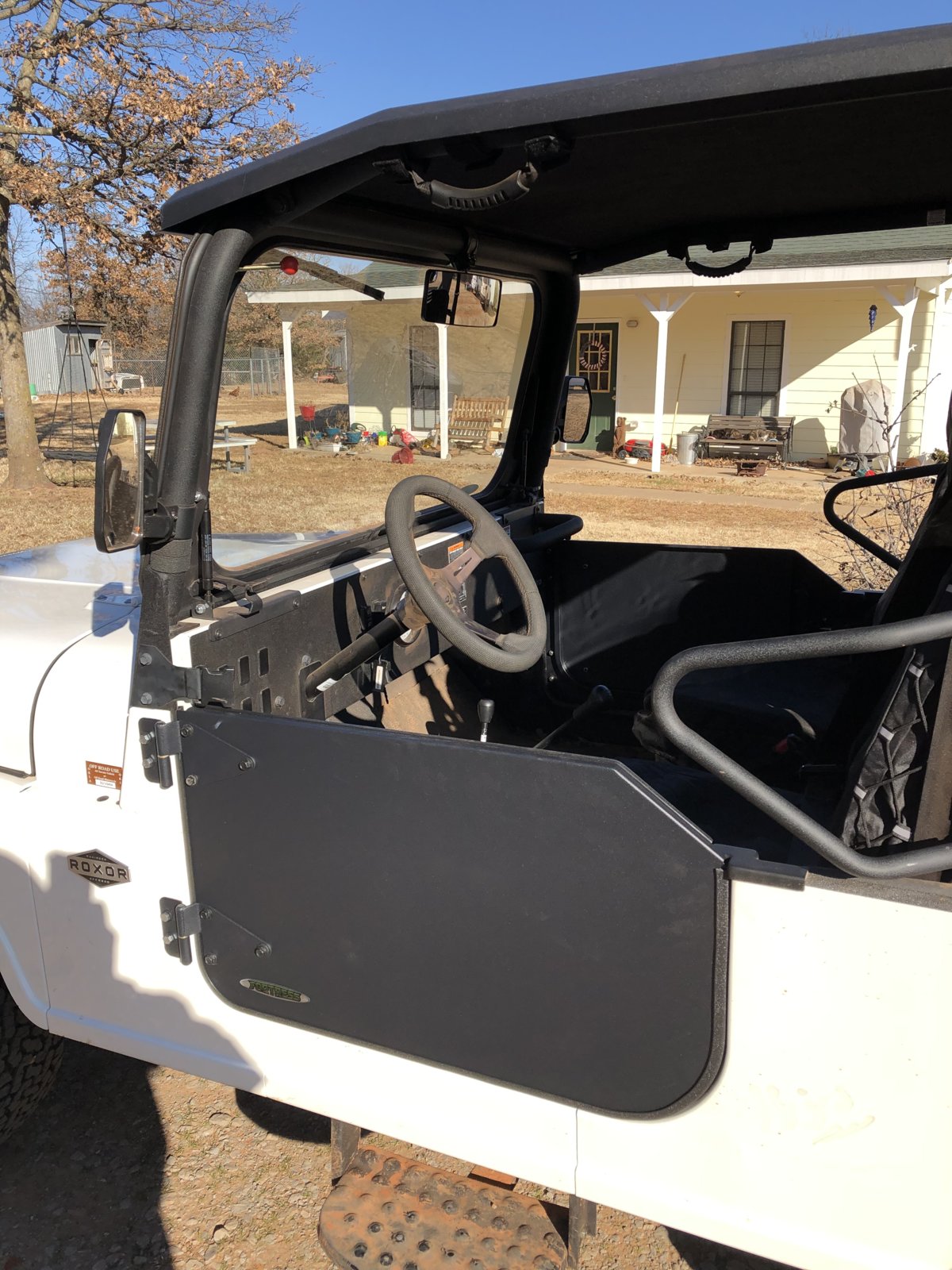

Sorry Im just now getting around to getting some pix, its been down right cold outside and snowy even for louisiana! Theres a reason I live in the south. Fairly simple install, but the instructions are dark and takes a few minutes to figure out where they are going with them, mainly how the striker works. The only issues I had after 120 miles of 4x4 rocky road riding was the strikers working loose. Had to put a little blue lock tite on them on no more problems. Also I put some black electrical tape on the strickers to get a really good latch without any rattles.

I just installed a 86 CJ7 windshield w wipers/ washers. reworked the front section of roll cage to move back 2.5" so the windshield can go in it's proper place. the Roxor full soft enclosure has been installed and looks appropriate.
Fastcat
Sep 27, 2018
26
Omak, WA, USA
Picts please would be great.

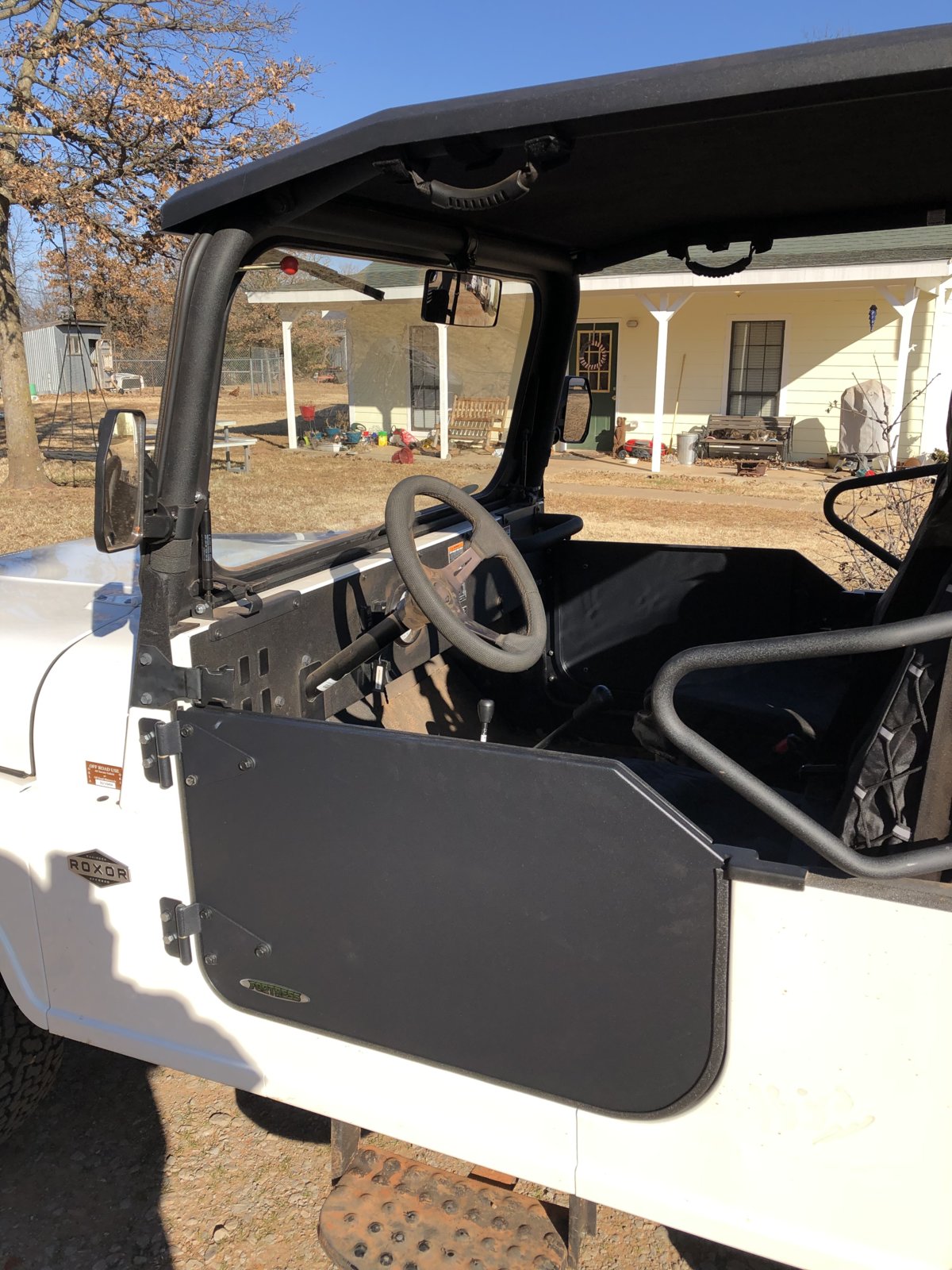

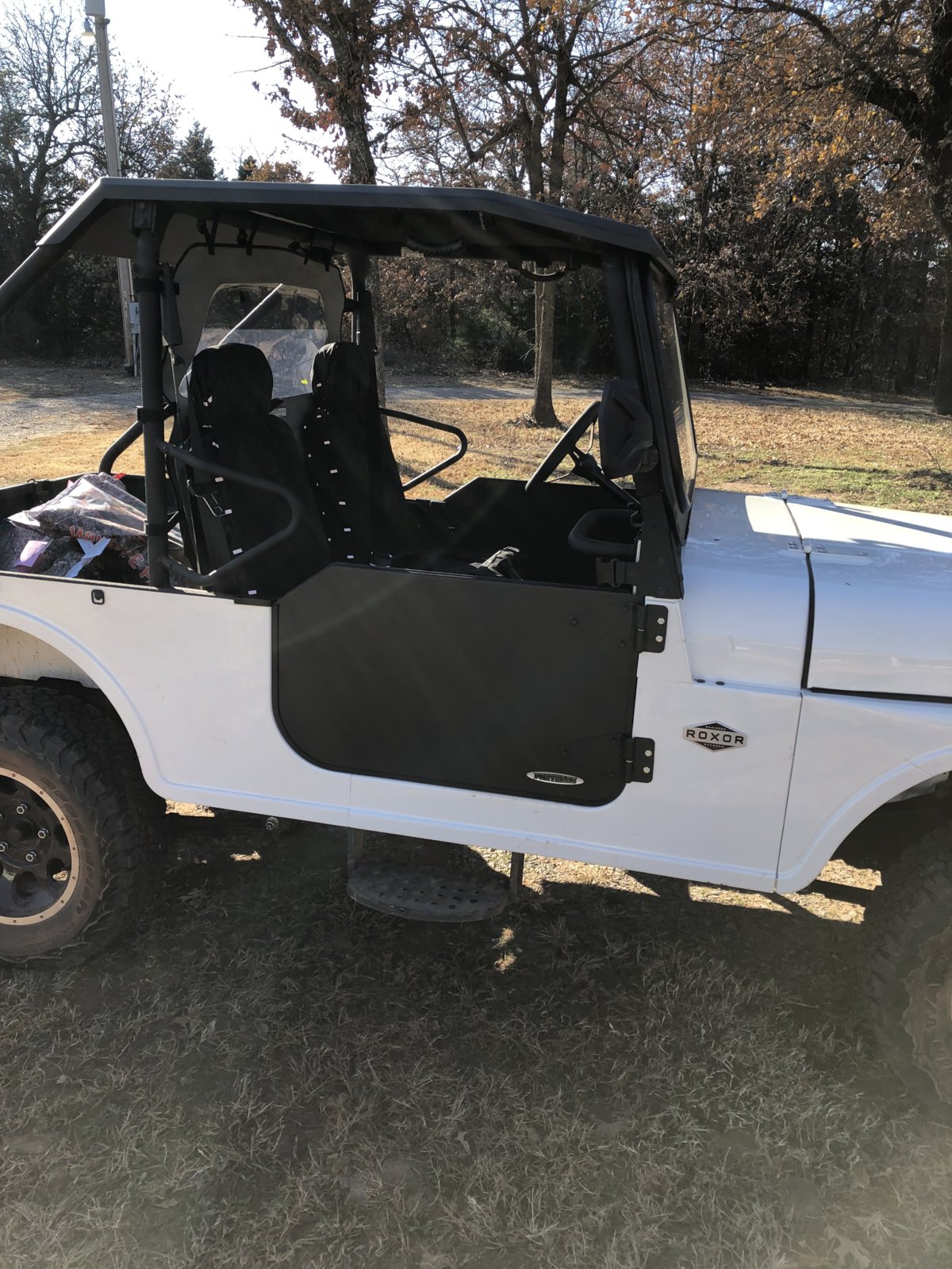

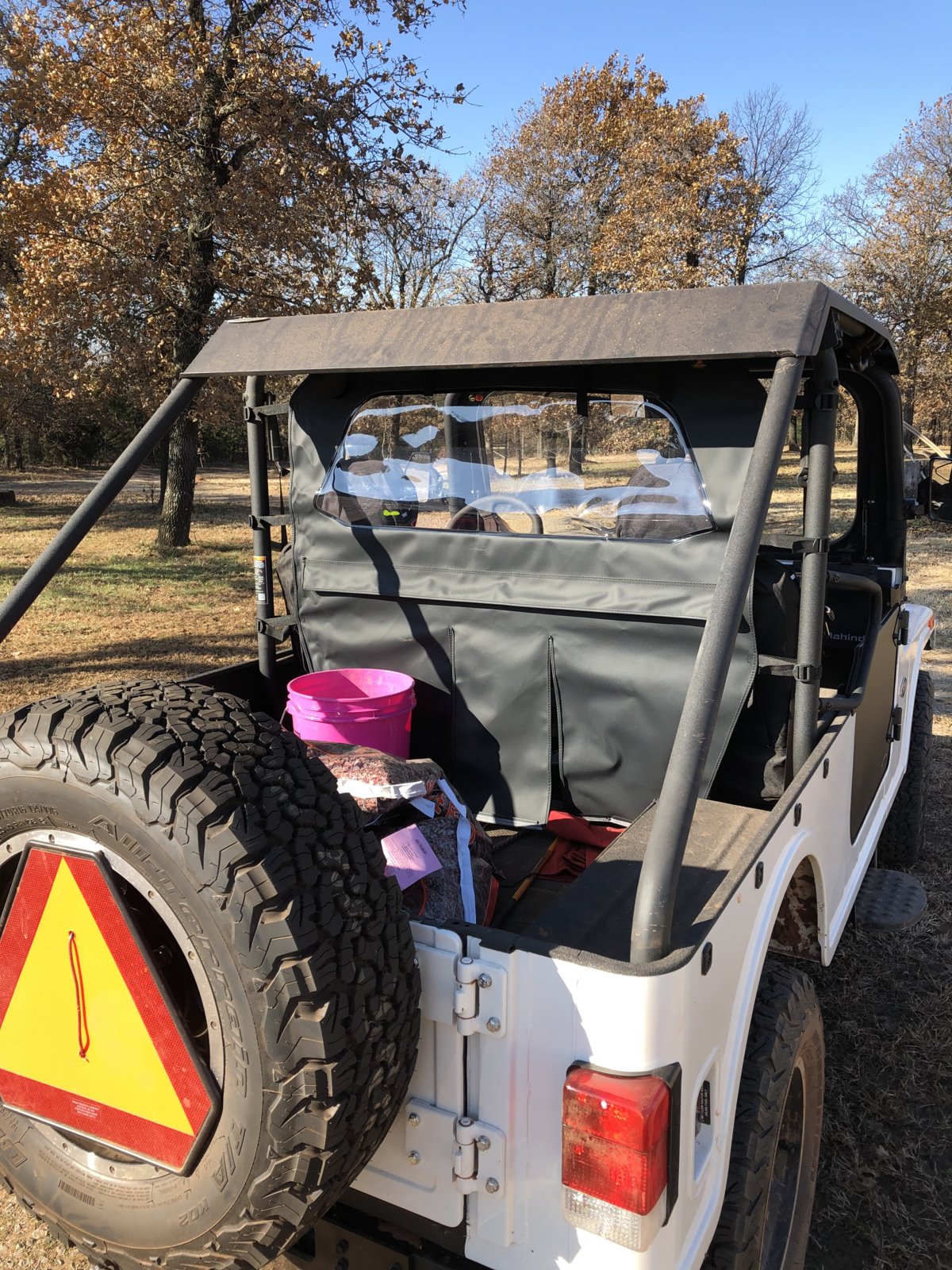

Woodsman74881
Sep 25, 2018
309
Wellston, OK, USA
000992

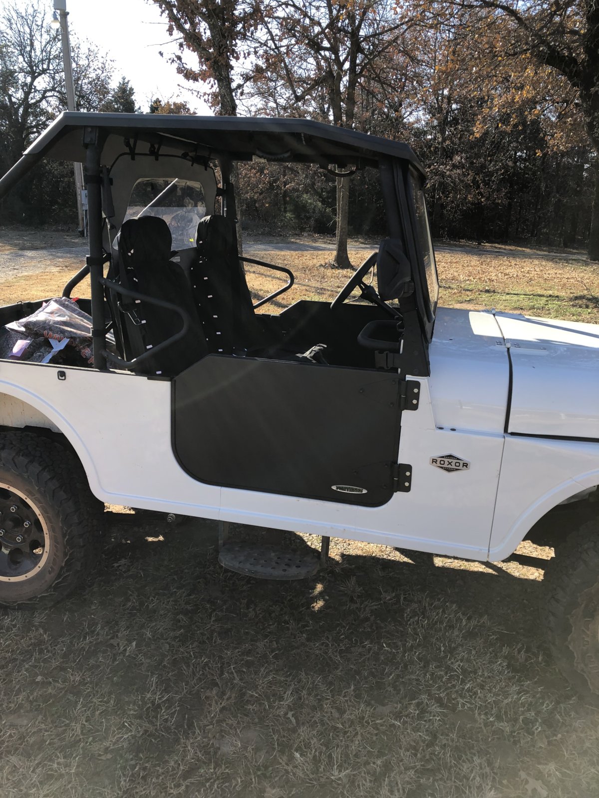

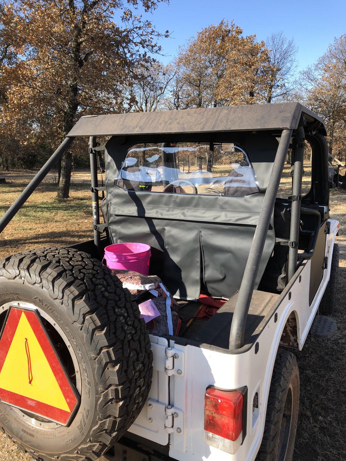

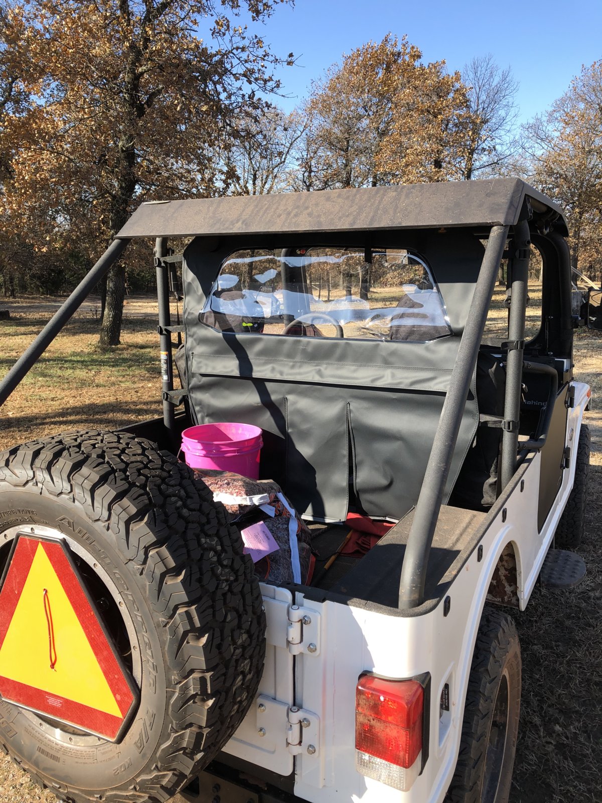

I just got my fortress doors installed. Also installed a bestop CJ rear windbreaker. Not a perfect fit but works pretty well on the farm. EFEC9FF8-82FE-4920-8D60-271666E328FC.jpeg620EEB15-FBF9-4357-B06D-A3DA2D7F88E3.jpeg2B55A6DD-35A6-45FE-B5E8-FF838389D368.jpeg
