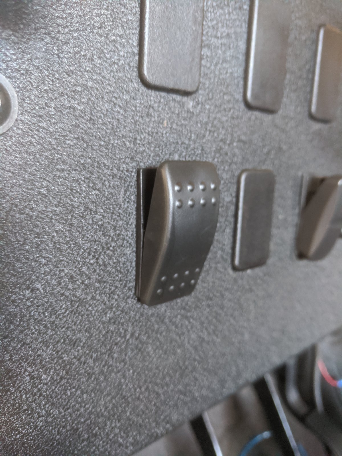

As an example, I wanted to add a cut off switch to my radio and any other add on like a GPS to eleminate battery drain. I got fed up with trying to manipulate a switch blank off out so I just drilled a 3/8 hole in the cover and pried the some da bish out with a pair of channel locks stuffed in the hole and badabing. Lol.

Bister made a video for the removal of the switch blanks. Really helped me. Thought the only way was hammer and chisel. Search switch blank removal.

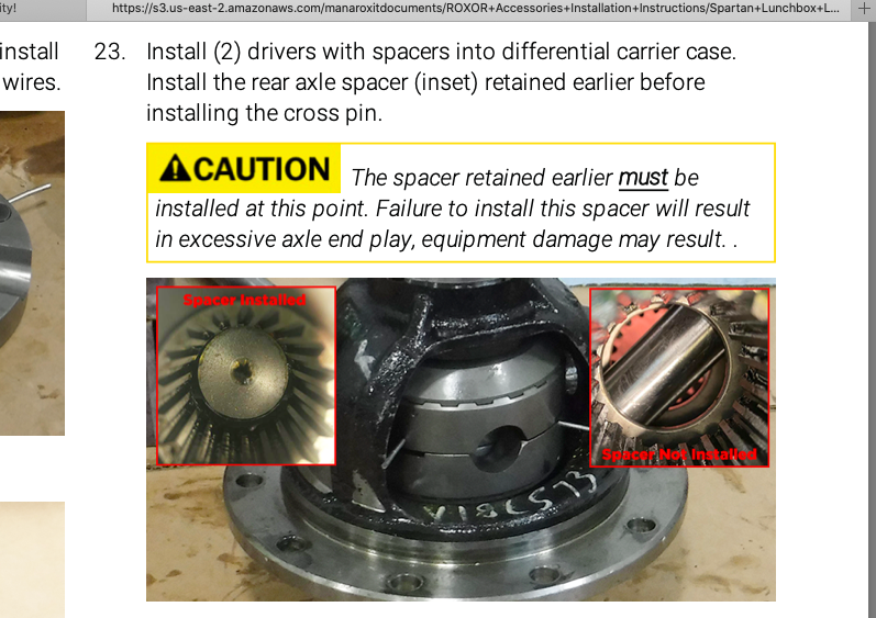

Make sure the spacer goes back in. Step 23.

You need that spacer in the carrier to set the preload on the axle bearings. What lock Right part number did you get?

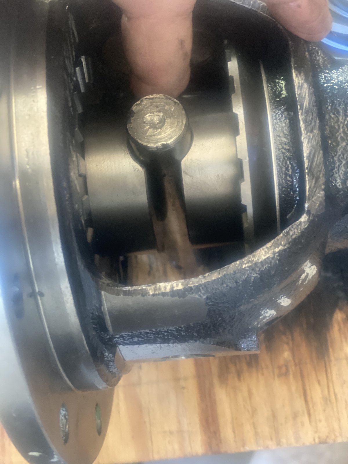

Lock right pt2413 Dana 44 19 spline. I understand we need to put the button back in between to hold the axles in place. The problem is the thrust washers are supposed to be left in on the lock right and they’re supposed to be discarded on the Spartans. If I put a thrust washers in I can’t get the pinion shaft I guess you would call it in and if I leave the thrust washers out the spacers that go inside the locker are really loose. I’m over 60 I don’t use Facebook or anything like that, I’m trying to learn how to do this forum. I’m gonna see if I can send a picture of the lock right directions

Doesn’t make sense. Does not show notch for pinion shaft. This pic shows one washer installed. If both are installed shaft pin will not fit. I need a shin kit? About the broken ring gear bolt. Broke another this morning turning in the proper direction. Warnings to others. Heat is your friend. Where do I get 2 bolts?
