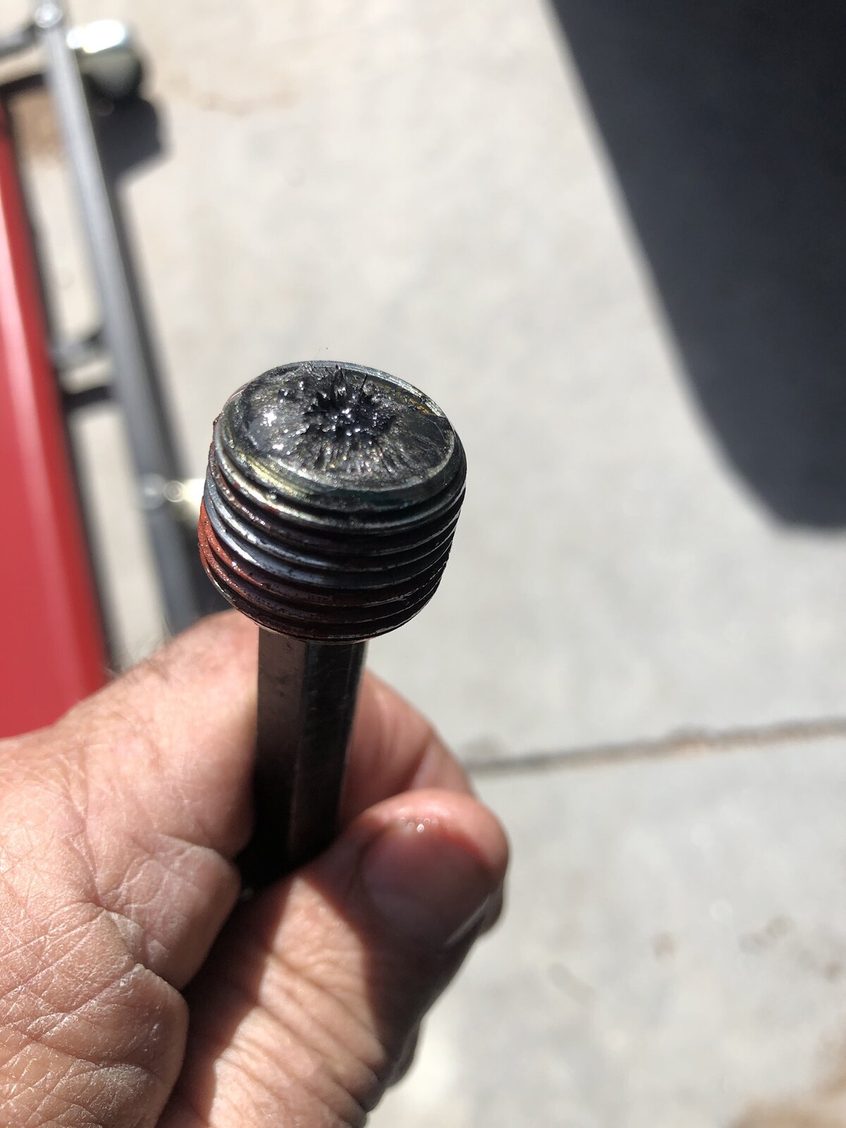

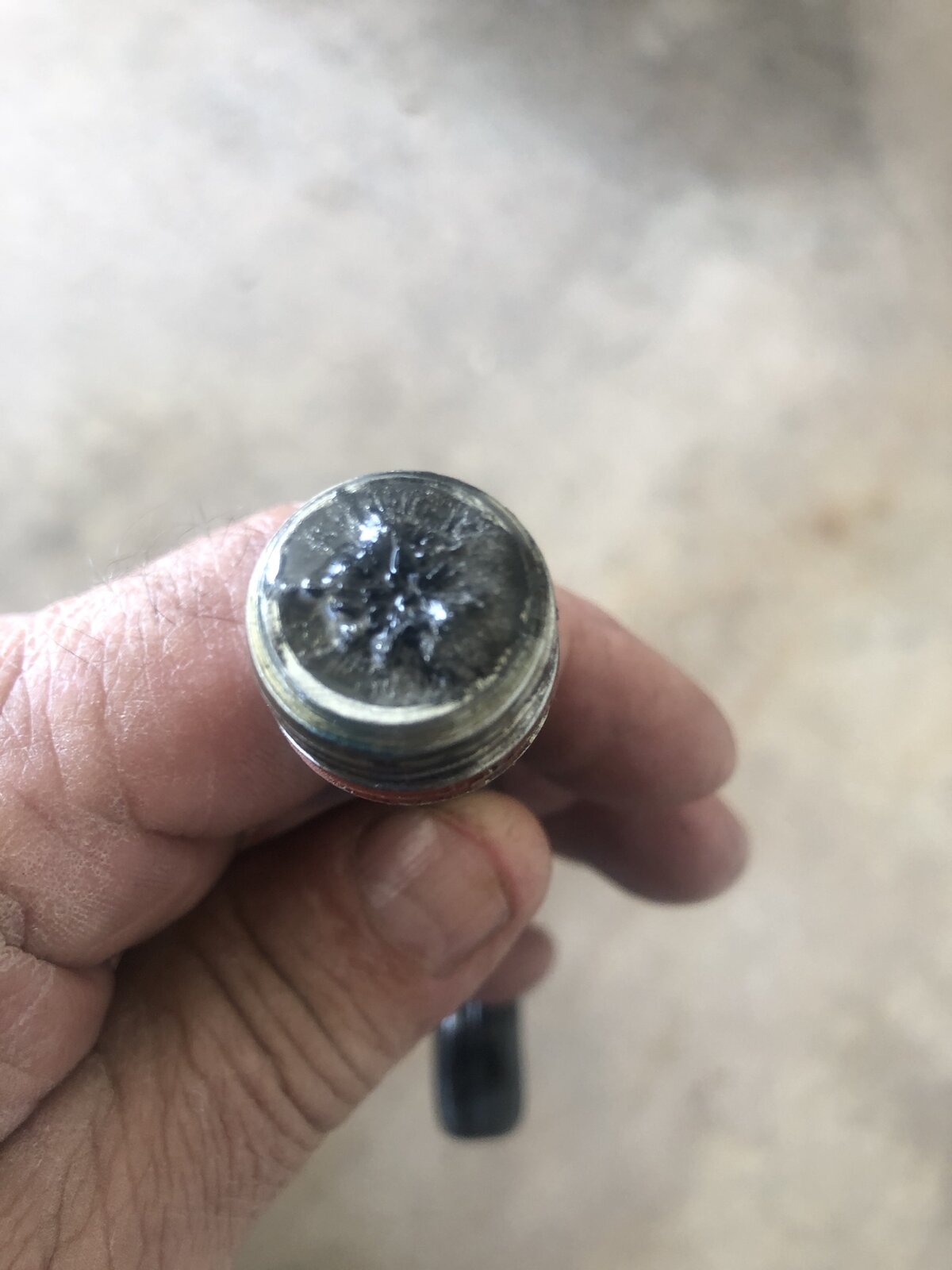

I bought my 2019 Roxor in January of 2020. I started driving it and with just 100 miles on it, I noticed that the transmission was growling/howling and it was getting louder the more I drove it.
Being an old wrench-twister myself, I started checking stuff. I discovered that the transmission was practically empty of gear oil. I topped it off, but over the next 1500 miles, it continued to worsen.
I took it back to the dealer, expecting to have the transmission replaced. Not so. They were very disinclined to do that. They did change the oil. The service manager said to drive it a couple hundred more miles to see what happens. OK. Now, a couple of hundred miles later, it is definitely quieter, but I’m really wondering if they just put a band-aid on it to get me over the warranty period.
Anybody else have this issue???
709
Was their any metal in the oil? It's on the dealer to do an inspection on all fluids. This is a known issue from a lot of Roxors. I would contact MANA themselves and see what they have to say. The dealer may be inclined to replace it at their dime due to negligence, that may be why they don't want to

Copy that! I’ve got pics!
B3537CE4-E5D7-4561-B710-F70788D4C18D.jpeg 70FC683E-3318-4474-95FF-A1999A38E9AB.jpeg
709
That looks pretty normal for a first change. If the gears got hot enough, the tempering is gone. They will come apart. Keep driving it, maybe it'll come apart and you will get a new one
