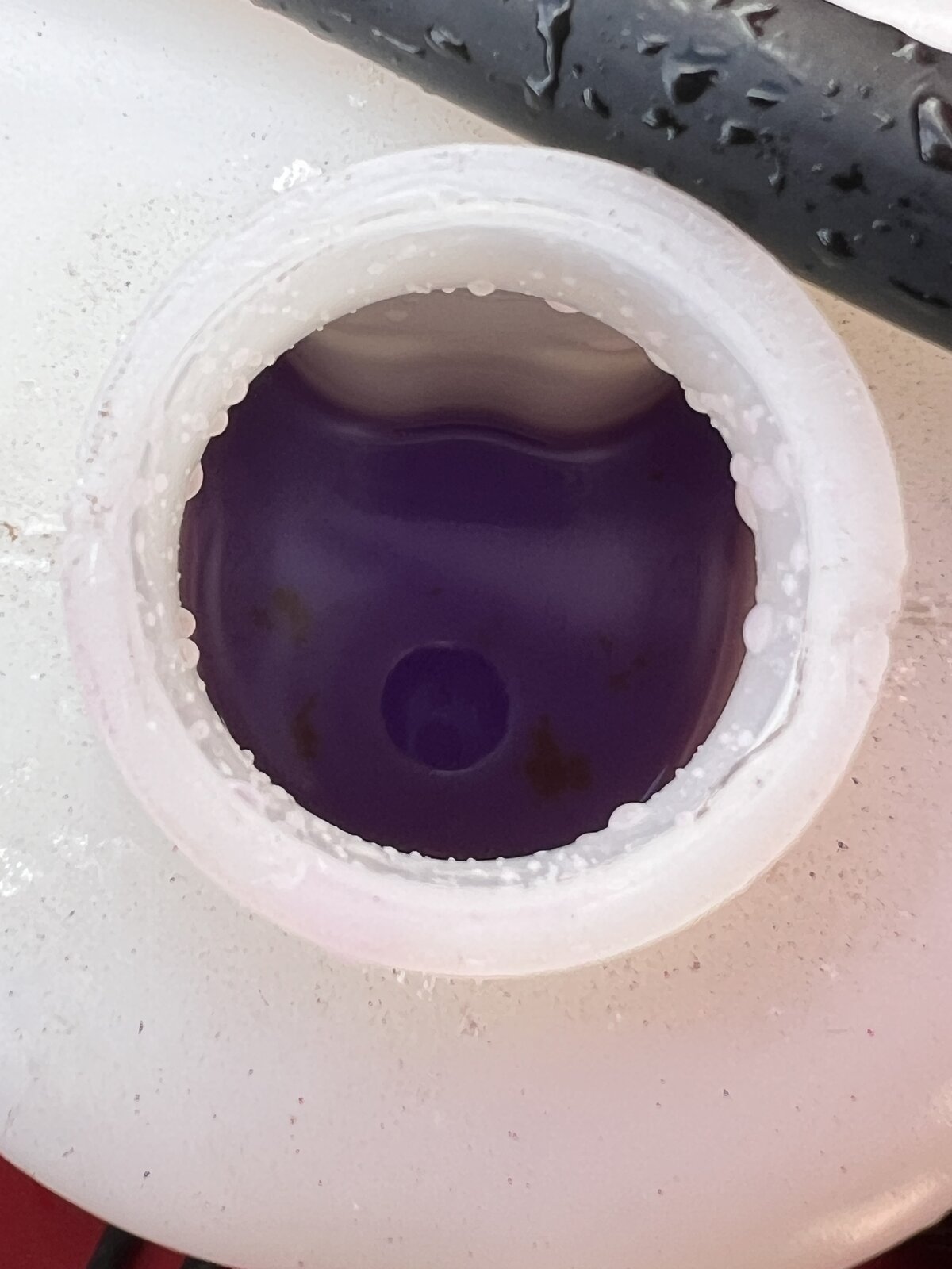

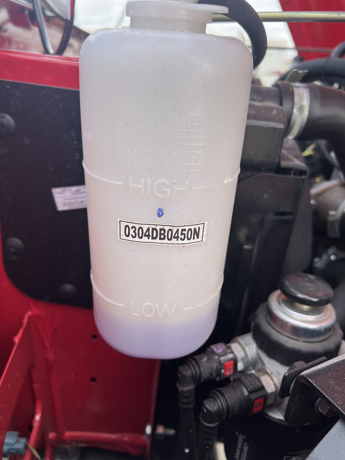

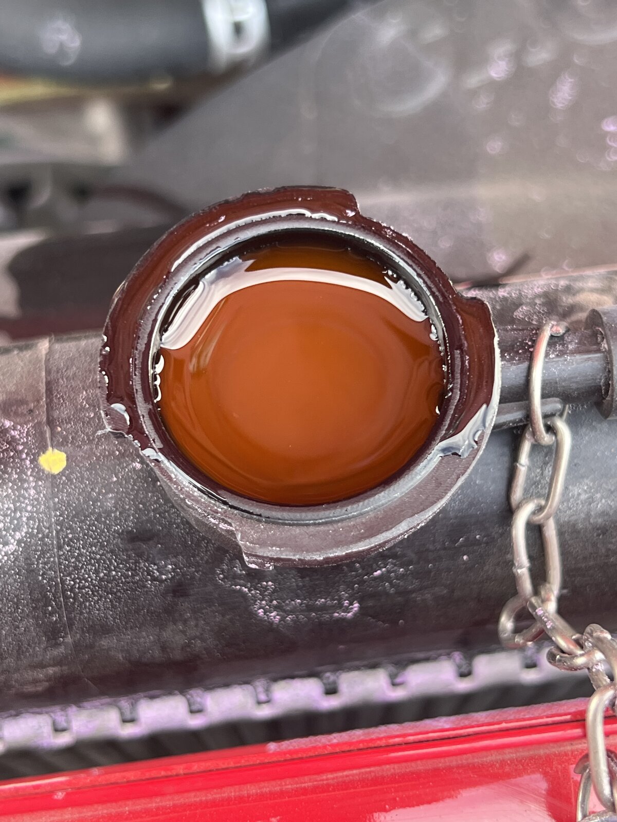

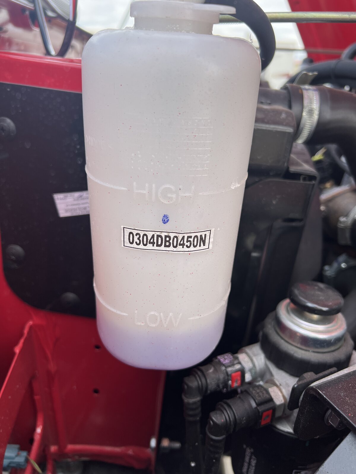

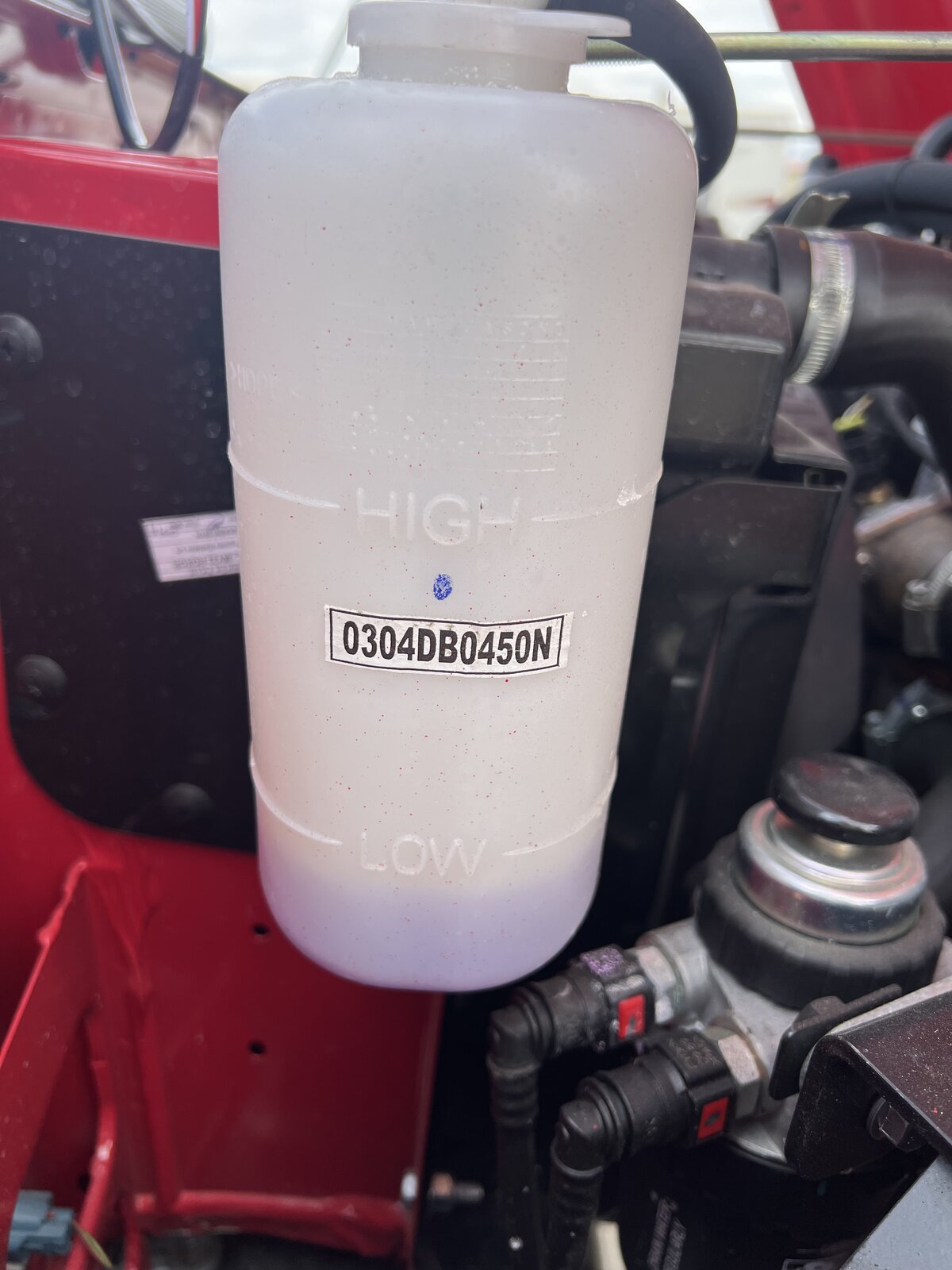

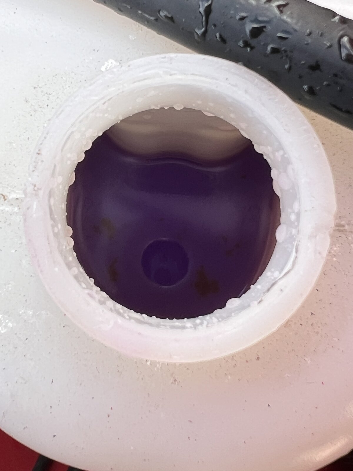

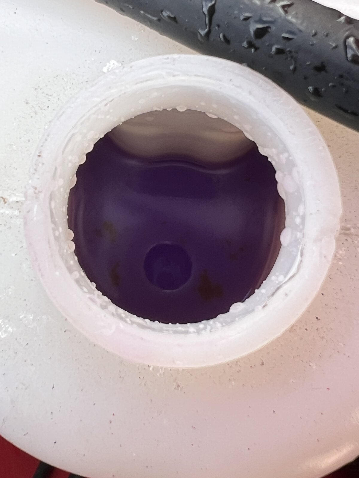

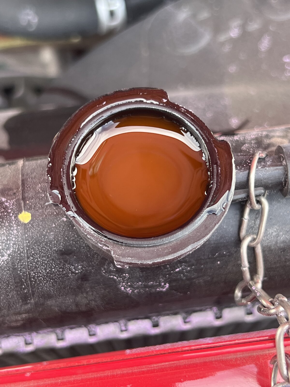

I have a 23’ 2.7 that I’ve added water to several times and it just keeps going down. Can’t find leaks anywhere and have no idea what purple coolant it has. Looks like coolant is brown/burnt in the rad. It has a whole 20hrs and 55 miles on it. All easy and never overheated.
Any ideas?

Im not an expert, but when I’ve seen the radiator look like that, it’s been rust in it. Get another opinion, but maybe flush your radiator

I would hope that is dexcool orange. Either way, if unknown I'd flush it out and add new correct coolant.

I just checked my 2023 I got on the 13th of last month, only driven once it’s the same way, purple in the overflow, burnt orange in the radiator. I’m just going to be safe and flush it out

I drained my radiator, and purple fluid came shooting out I think it’s was rust, I’d only driven it a few times and I took it very easy. It’s flushed with new antifreeze now.
709
Coolant is JISK2234. Typically pink/asain vehicle.
How's your oil look?
reedcharlie75
Aug 17, 2018
105
Indiana
627
Oil is great, coolant was purple. Everyone else with 2023 seems to have to same color. My 2018 is pink coolant, but it’s the 2.5, 2023 is 2.7 engine
lost1wing
Dec 29, 2023
80
Georgia
10480
D3306 is the Mahindra spec in the 2022 operators guide. The 2023 only say lo/ no silicate 50/50
Zerex has the D3306 rating. No idea what the orange coolant that is in the radiator. Mine was low when I got it. The dealer filled it up and I verified it was full when I left. After a bit of driving (100 miles) is was low again, ( only to the low mark). My guess is that the factory does not leak check the heater core. Now that I leave it open, my level has not gone down since.

Mine is doing the same thing I think, just bought it used (2023, 140 miles on it). The dealer said when they checked it over they had to add coolant. After 40 more miles, now at the low mark. My fluid in the radiator looked orange too but noticed the few drops on the cap were actually purple. Take a sample out of the radiator and I think it may actually be purple. I saw your post and knew about the orange look so I was somewhat aware of the color change. I did not take any coolant directly out of the radiator and am not around my Roxor for several days to re check. Also did not see any place obviously leaking.

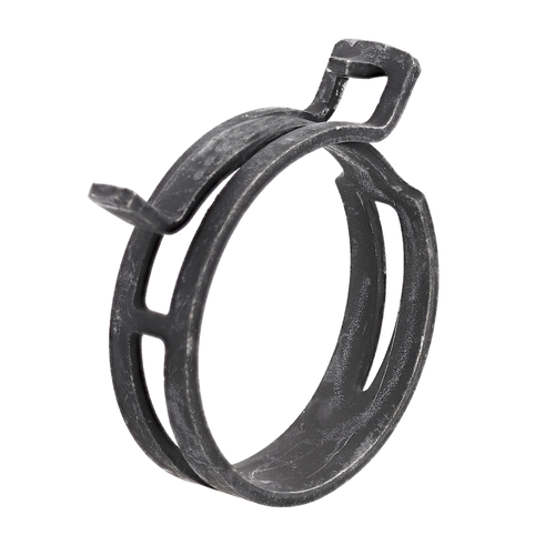

I have the heater, and mine is clearly leaking from that area, I see red coolant stained around the hose clamps and can see it on the side of the block. This summer I’ll be taking them all off and putting new clamps on all the hoses.
