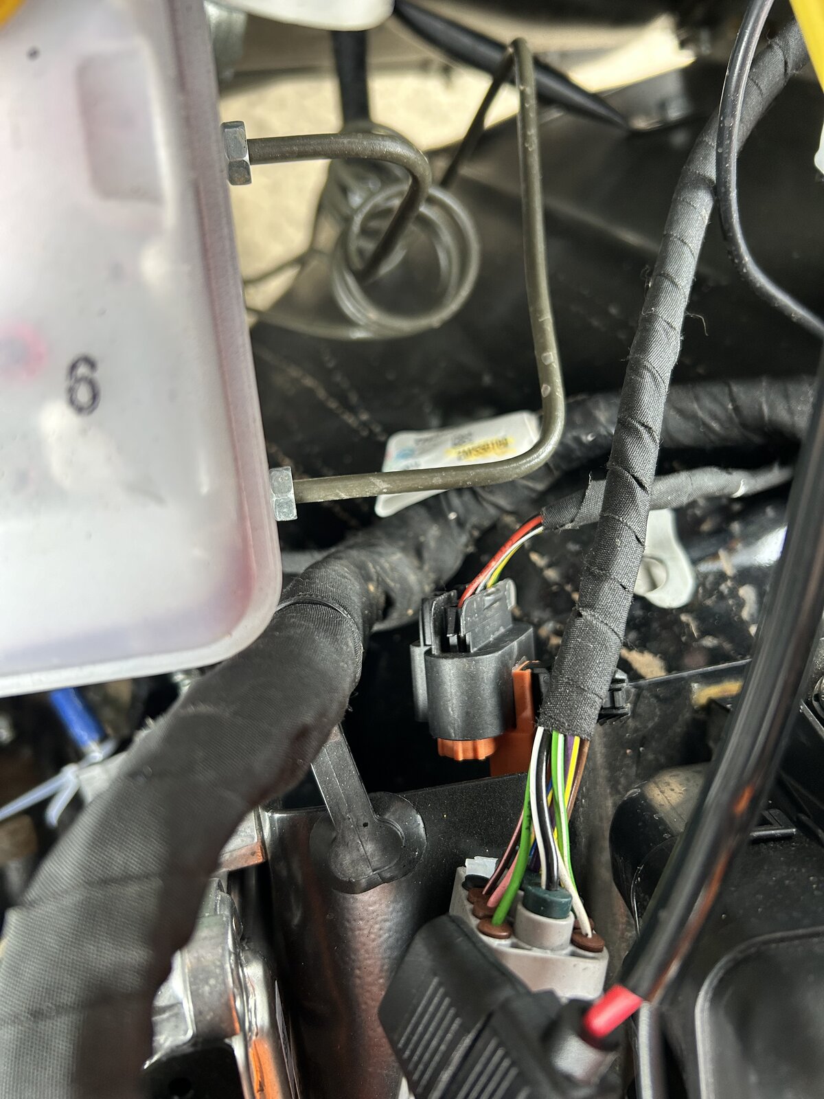

After an exhaustive search behind the dash looking for the OBD port, I finally located it in the engine bay next to the ECM.

That looks right. The issue is it's not compatible with regular OBDii readers.
Wade at DieselFreak sells the correct adapter for $15-20. Really good guy, great communication and awesome aftermarket Roxor store. I will caution you, once you see all DieselFreak has on their site, you'll probably end up with more Roxor goodies. Not a bad thing, just putting it out there.

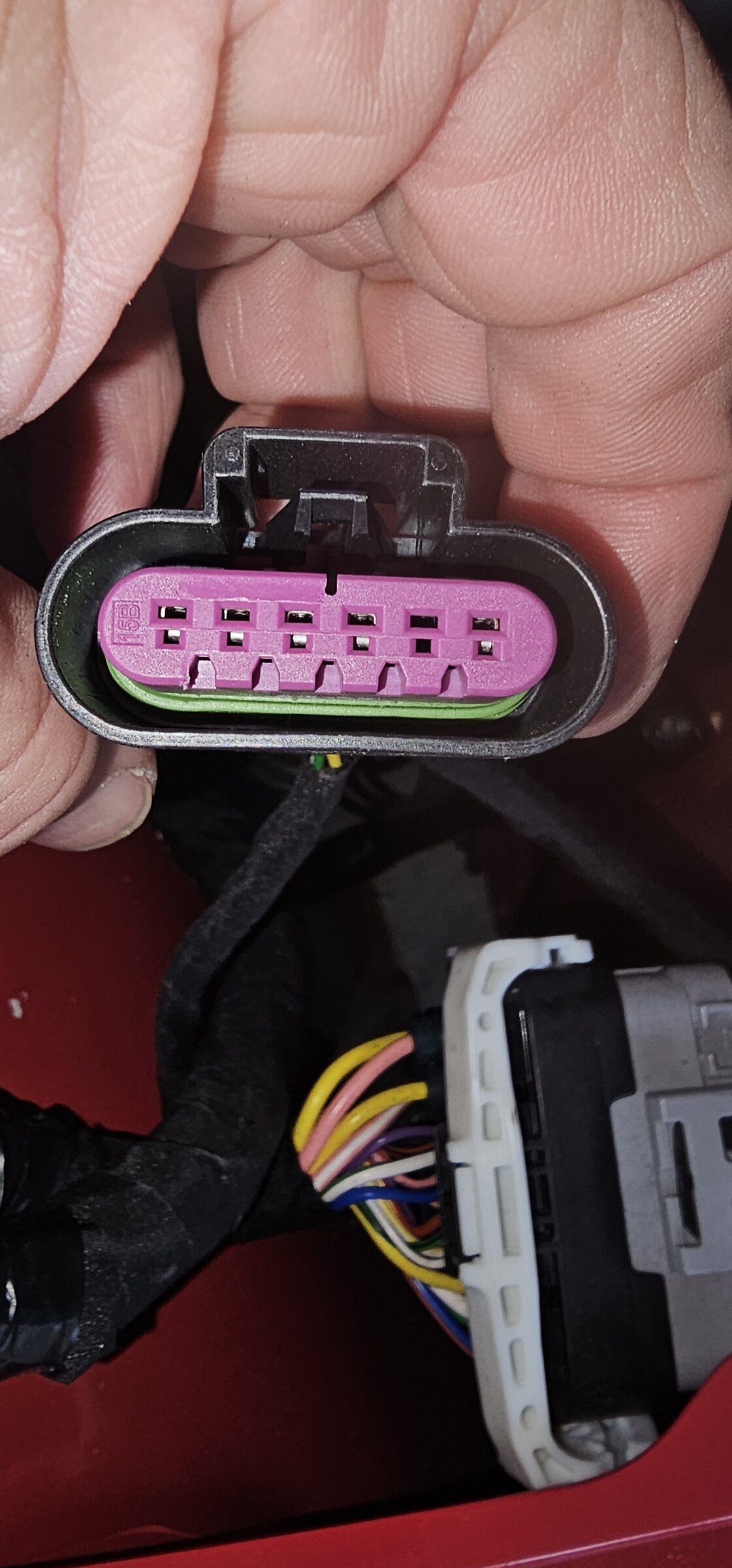

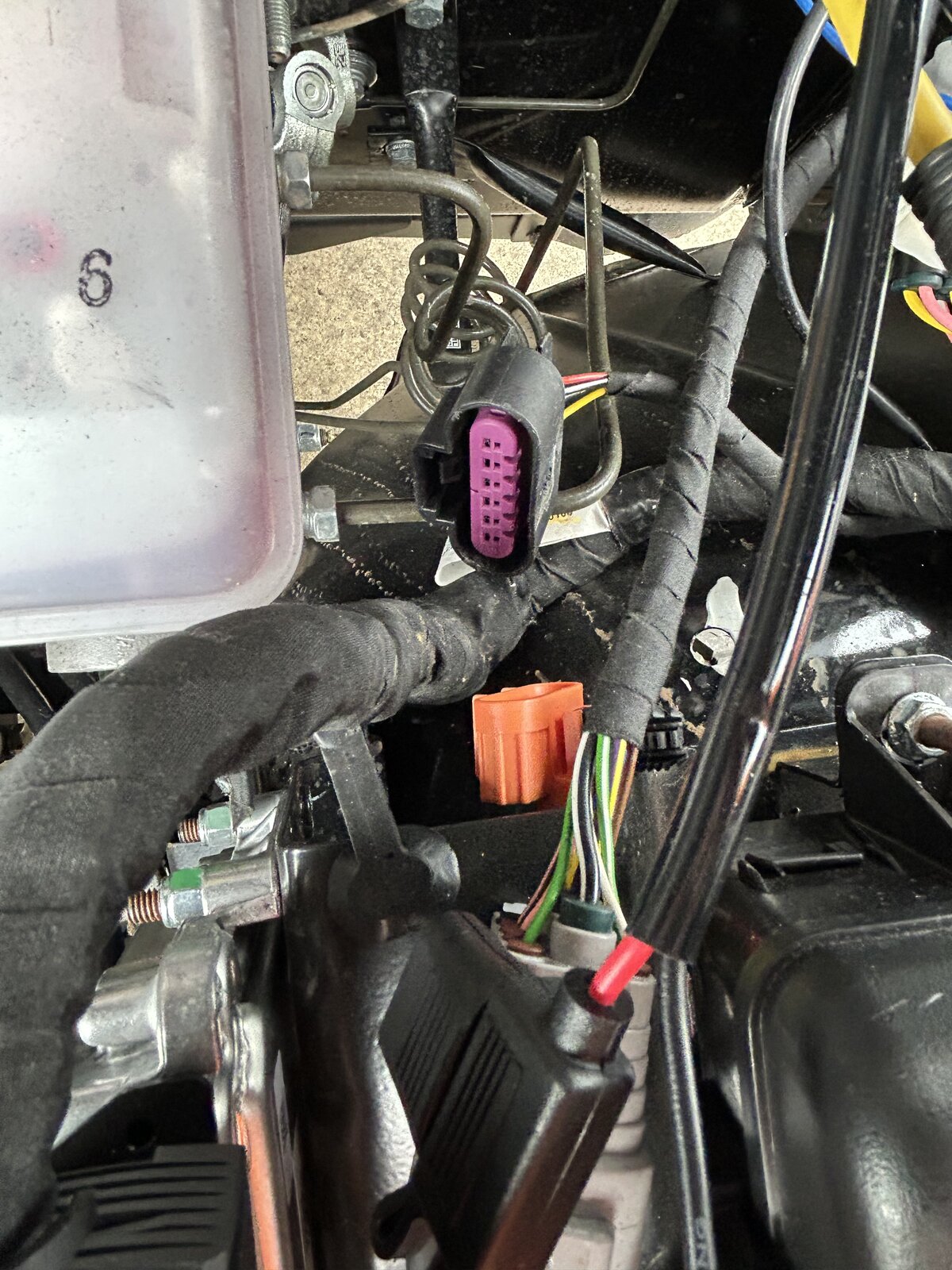

Can you please take a photo side-on so that it can be seen whether the HD harness carries with it the same pinout mistakes that the 2018-2022 harnesses had? Mahindra Roxor OBD2

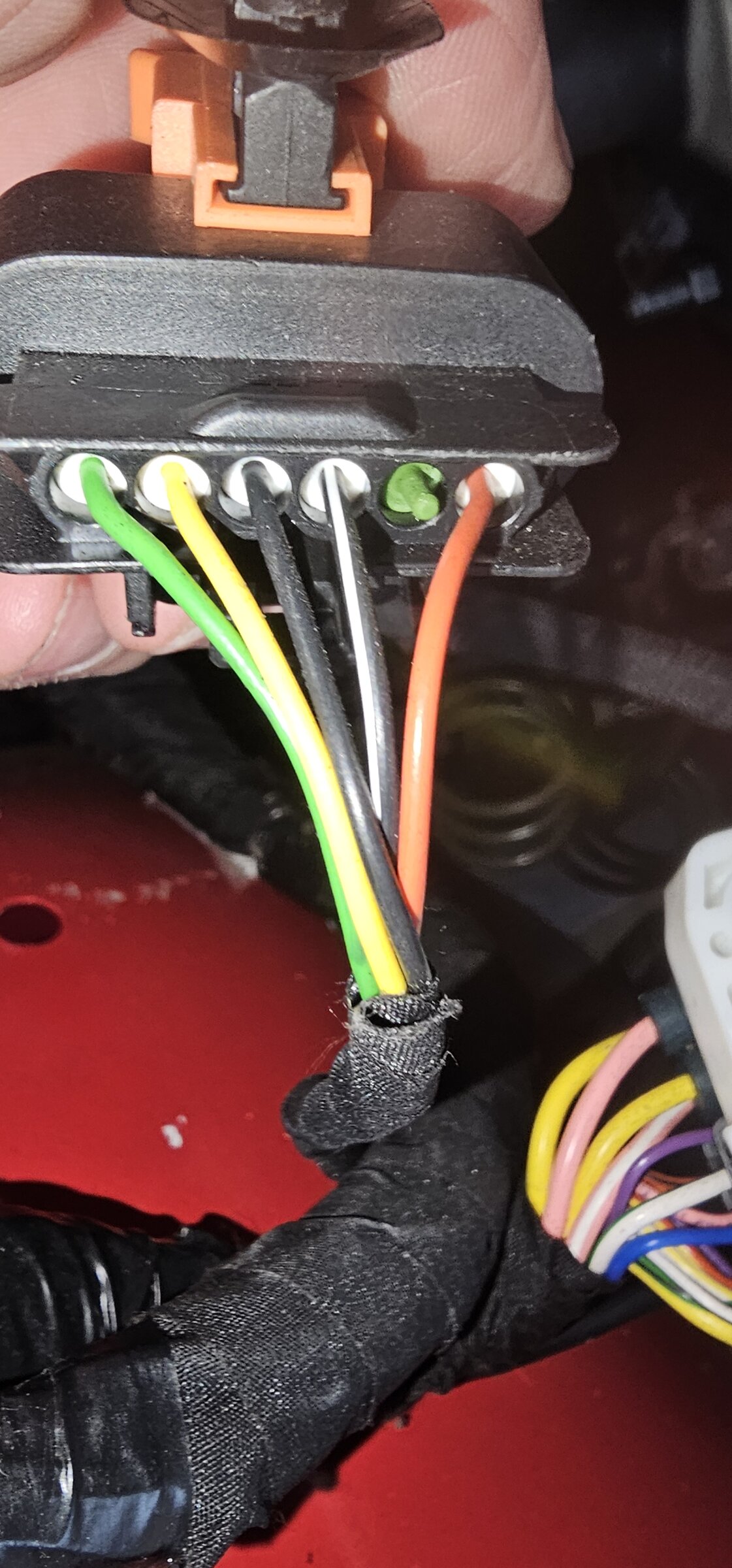

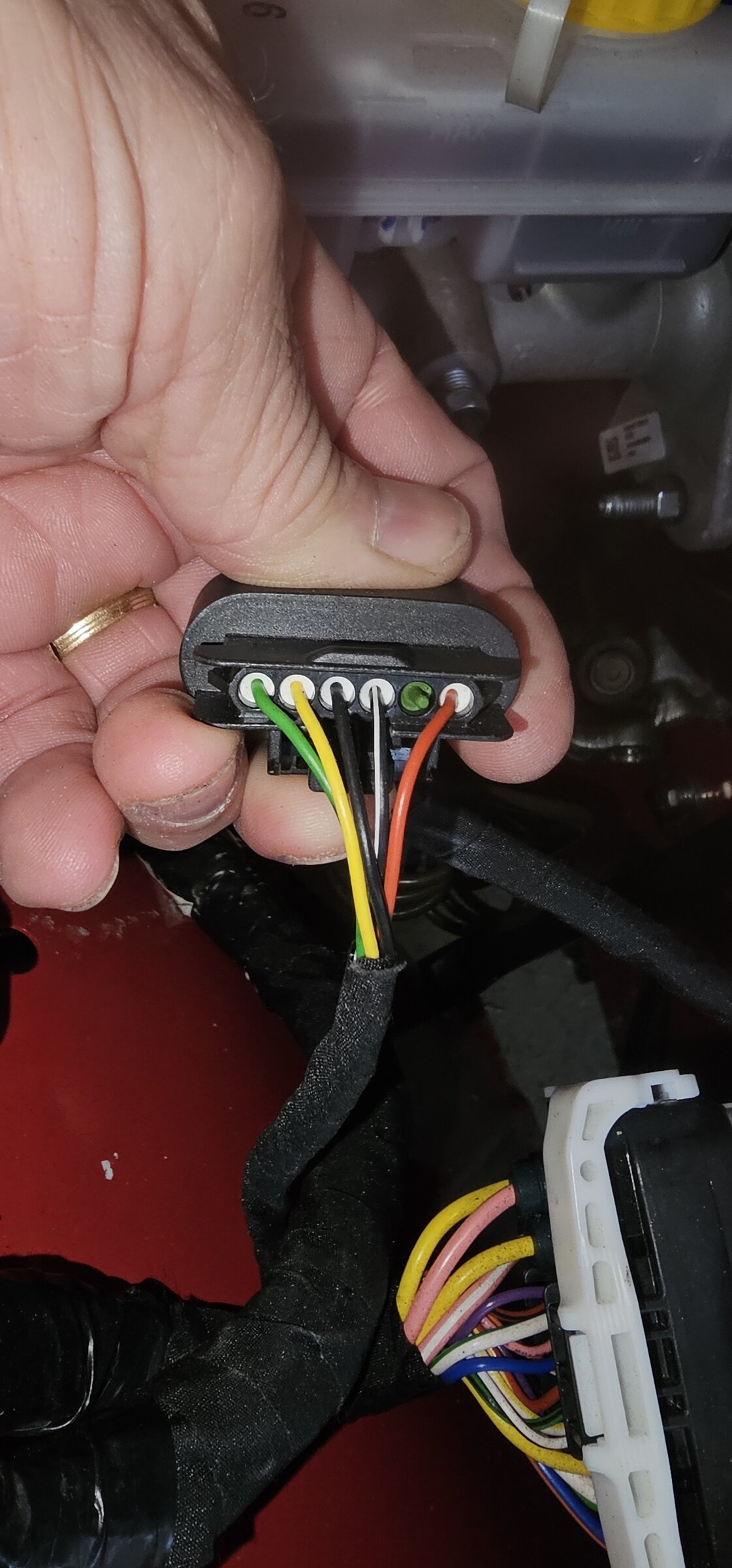

I am not at my ranch, so I cannot get you a photo right away, but there are now enough 2023 HDUV owners on this forum that someone should be able to get you the photo you need easily. Based on your comment, I checked the 2018 wiring diagram and confirmed that Mahindra is not pinning the OBD2M in the standard configuration, however, Wade's (Diesel Freak) adapter would have taken that into account and correctly pinned the OBD2 connector to the standard, as is evidenced by so many who have simply plugged in his adapter and plugged in their ScanGauge II with success on 2018 thru 2022 2.5L models. I am still looking for a solution for running a ScanGauge on the 2023 HDUV 2.7L engine. If the 2023 HDUV OBD2M is now pinned to the standard configuration, that might explain why my ScanGauge 3 will not work using Wade's adapter. If you are able to confirm the 2023 HDUV OBD2M is pinned to the standard configuration, I should be able to repin Wade's adapter and get the ScanGauge 3 to work if it is not a protocol issue.

Thanks for that. The pinout looks the same as my 2018. So that blows that theory. You should have 12 volts on the red and black wires (A and D pins).
That was an excellent theory that I had not considered until you mentioned it. I would not have thought anyone would pin a standard diagnostic connector to a non standard pattern. Should have figured it would not be that easy. For clarity for those trying to follow this thread. The 2018 thru 2023 HDUV have their OBD2M connectors all pinned the same, including using the same wire colors. However that pinout is not a standard OBD2M pattern. However, Wade's (Diesel Freak) adapter is aware of that non-standard pattern and pins the OBD2 automotive style connector to the standard pattern which is what allows the 2018 thru 2022 2.5L ECMs to work with automotive scanners. So It still appears that the 2.7L ECM is using a different communications protocol than those of automobiles. I suspect that it is using a tractor/heavy equipment protocol (being it is a tractor engine), which I am going to attempt to test the next time I am at my ranch, using my heavy duty equipment scanner. If I am correct the ScanGauge D should work using a ScanGauge 2 cable and Wade's adapter. More to come, but it will be a while. I had asked Wade to test this for us, as he has all of the equipment at his shop, but I guess he has been too busy.
