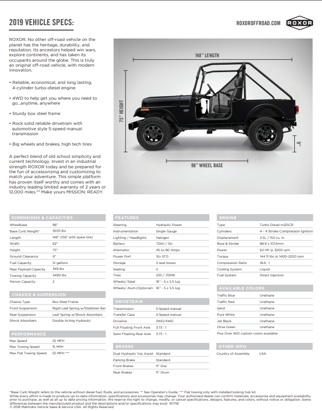

Attached is the 2019 Mahindra Roxor Spec Sheet.
Also in PDF document!
Changes noted in specs
Max speed from 45 to 55 MPH
Added Max Flat Towing Speed of 55 MPH
Front Brakes 9" Disk on 2018 base model to 11" Disk on 2019 model.

Awesome. I don't see any changes except increased price, increased top speed (from 45 mph to 55), increased color options, and notable absence of special/limited/launch editions. Am I missing anything?

One other thing I noticed was disk brakes went from 9" to 11". Is this correct or a typo?
It seems like the spec sheets say that, but I think it's more likely a typo from Mahindra. Given how slow Mahindra seems to evolve their product (over 50 years...), changing something significant like this is unlikely. I would love for someone to measure their 2019's brake rotors though!
