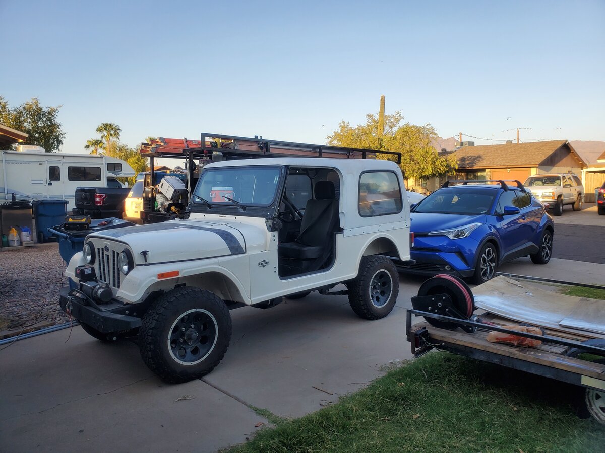

I was wondering if anyone tried any cj7 softop for Roxor?
Cj7 is 5 1/2 shorter it could be done if you have a upholstery guy I stretched a hard top

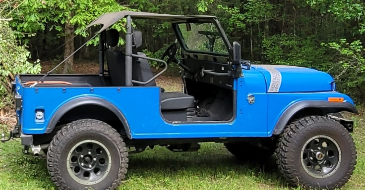

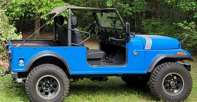

This is a CJ7 soft top; but the roll bars have been modified. It also has a CJ7 windshield

You cut the factory roll bar above the side protectors ? Correct? How many inches?
JoeMc
Jan 16, 2019
50
Shepherd, TX, USA
1760
I only have the center roll bar now, everything thing else has been removed. I think it was around 4"? I did it a few years ago. If you cut it, just make sure you keep the roll bar a few inches higher than the front windshield. I think I cut mine twice before I was happy with it. When I welded back together, I used a 1.5"x 6"piece of pipe in the center of the roll bar. This lines everything back up to center on the roll bar for welding. From the floor to the middle of the roll bar is 43.5". If your a taller person don't cut it too short, you may need the extra head room.

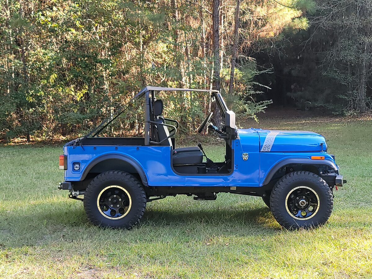

There is some info in this thread on how I modified mine to add a CJ bikini top along with input and pictures from others. Might be helpful.

That turned out good. I tried to tie the rear bars back in like you did, but it didn't look right. So I left them off. That looks good . Plus it gives you a lots more protection if you roll over. I just use mine around the house. I'm going have to improve mine if I decide to take it off road.

Thanks, I like it and it makes me feel like I didn't compromise the protection, like you said. At some point, I'll disassemble the ROPS on my 2023 and start working on it.

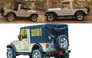

We have our own soft top production,Just in case someone needs one to be made custome let me know

Can you make one to fit a CJ windshield?
Yes we can make any soft top ,We have our own production Pls mail us pictures of what current set up you have on your roxor ,We Have Thar doors,Cabin pillar set ,Complete wiper kit & we also make full,Cabin & Bikini top for roxor

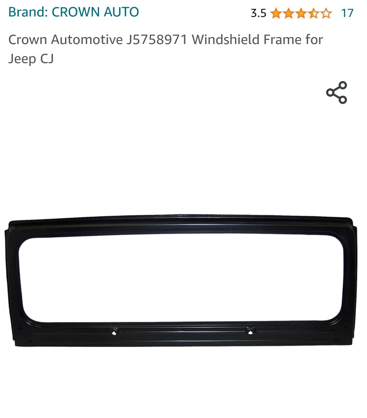

1760
I bought it off Amazon. Here is the information. It looks like all the windshield Cj5. Cj7 (cj5 pre 1975 was narrower body & wheelbase). Will work together? I think the only thing different are the CJ7 have a longer wheel base?
