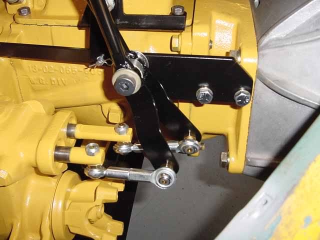

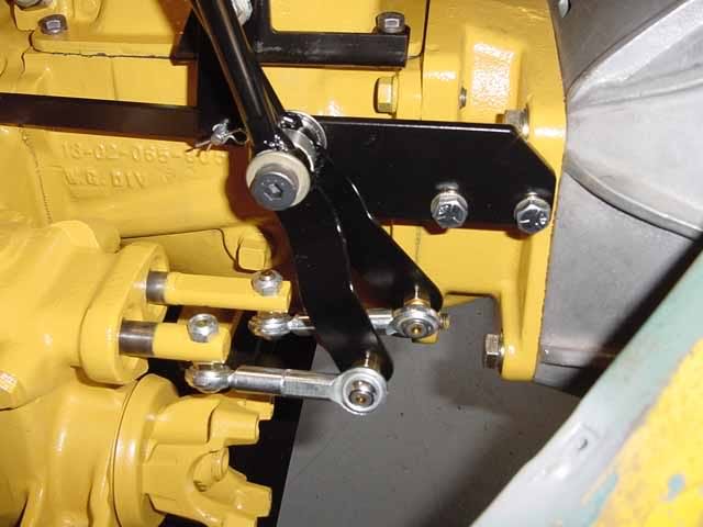

The rest of us home trained low budget engineers will have to rig something like this.
