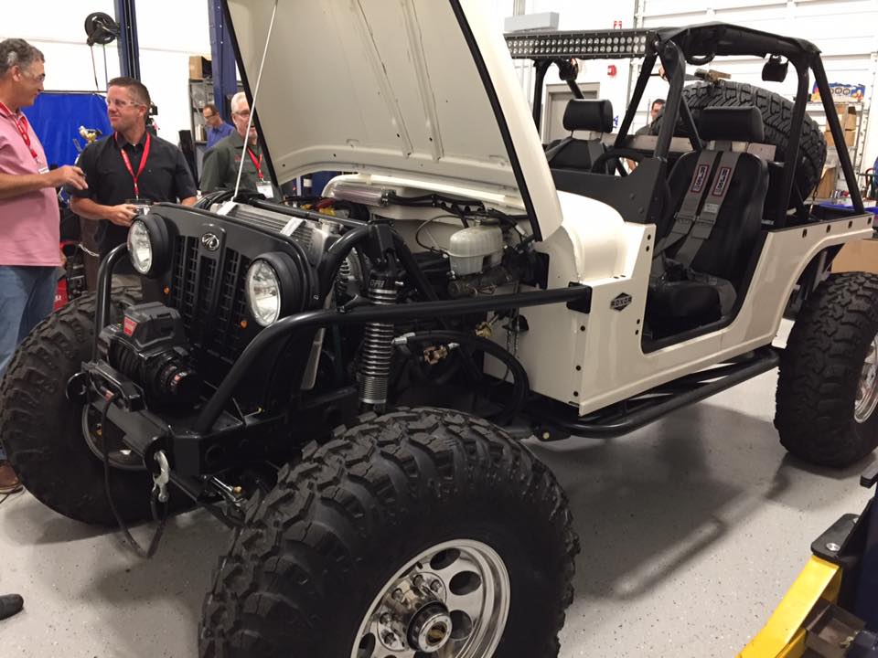

Have you seen these yet?

When the demo team was out at Sturgis MC Rally this year, I talked to them about doing a Spring over Axle flip. From everything I have seen so far, it should be easily doable.
838
It’s easy and cheap to spring over poorly. It’s not the easiest to do well. I would take a well designed, spring based, 2.5” under lift and level kit all day.

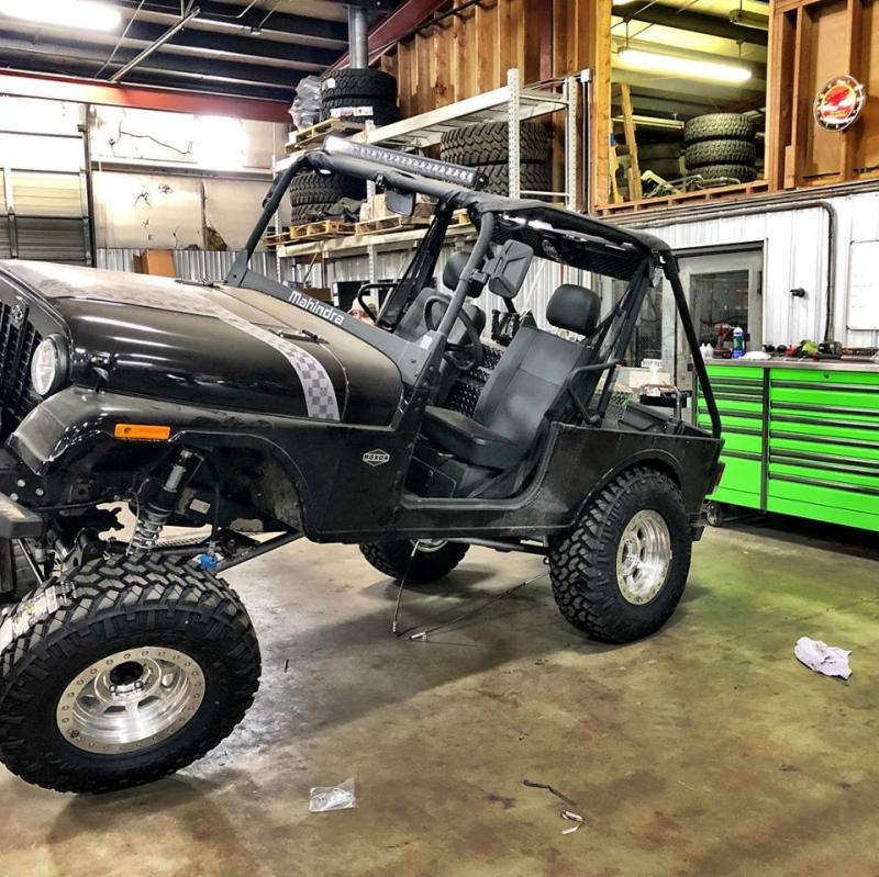

Where can I get that kit on the black machine?
I know it's neat to see "SEMA" projects like this, but I see no 'normal guy' aka 'buys a kit' reason to link a Roxor. I think any reason given will result in a unbalanced mess of a perpetual project rig that will eventually scope creep to hell and end up a "I should have started on something else" kinda problem. I don't mean to be Debby Downer here, but a scan of CL will bring up many butchered "SEMA" projects selling for a fraction of their invested value. Like I said before, you want a linked rig on 40s? Buy a $400 Dodge ram 2500 gasser and a sawzall. You'll be on 40s in a few weeks for a few grand, and have a rig you can absolutely thrash with abandon. Try that in a Roxor, and if you're asking for a 'kit', you will never drive that vehicle.
This is where experience (which is the same way as saying - it did too much dumb stuff and finally learned) says to imagine your end goal (use case first, then tire size required, then height, then width required - hint width will point you elsewhere), and work backwards. Does that approach lead you to start at a Roxor? I bet not. Don't start with a rig and then work forwards to make it something with no end goal in sight.
838
My comment is no dish on the Roxor, far from it. These are amazingly capable machines, but IMO KOH fodder, they are not. I see these becoming amazingly popular in stockish, 33", and 35" tire type setups, traction aids, and mild lifts/brakes/steering to match the desired tire sizes. Maybe this will change in 15 years when they are cheap, but I see no reason to buy a machine and immediately mangle 90% of it's moving parts. I suppose if $ is no object, but I don't know any humans where that definition fits lol.

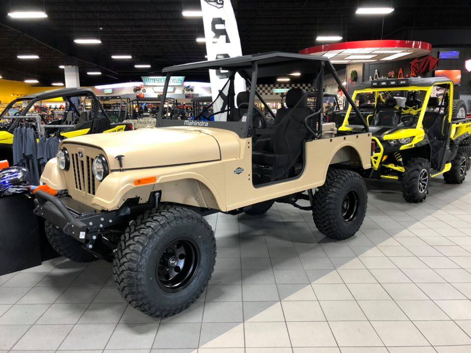

This one is on our new 6-4 kit. Works with all your factory bolts and hardware, and it includes brake lines, sway bar extensions, and extended length shocks.
