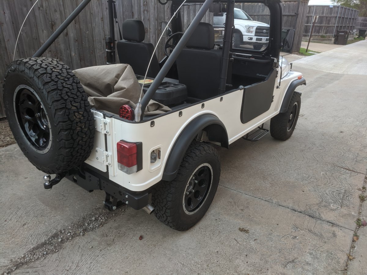

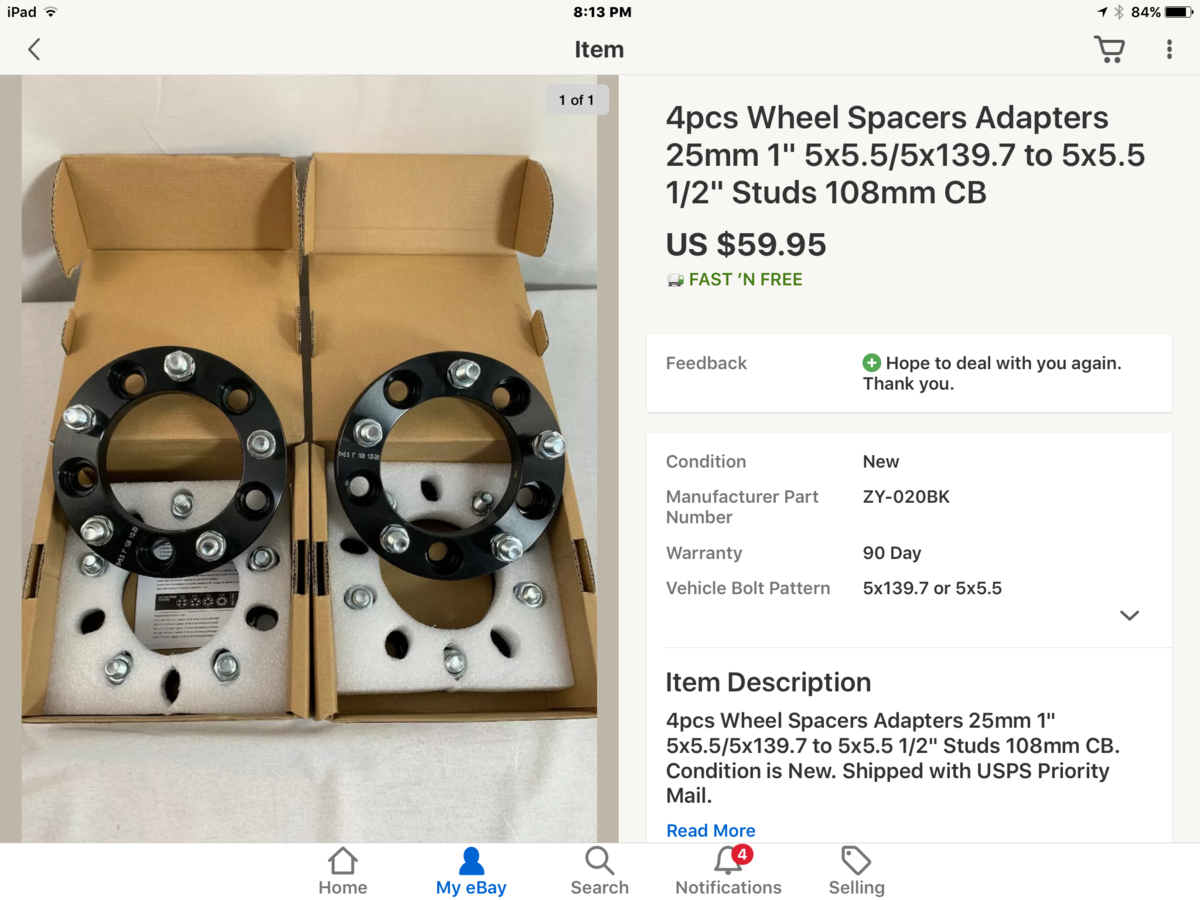

It depends on flare brand, flare width, tire size, wheel offset as to spacer thickness. I have factory aluminum wheels, stock tires currently (plan to go to 235 85 16 mud tires soon). Before the flares, tires were outside fenders, slung mud everywhere. After flares, it kinda' looked odd (tires too far under the flares). So I went with 1" spacers to get the look I wanted, and they should work with the future tires. I bought black spacers, pic is attached. Also a pic of my rig as described. Depends on what look you want for your rig, considering variables in first sentence. Hope this helps.

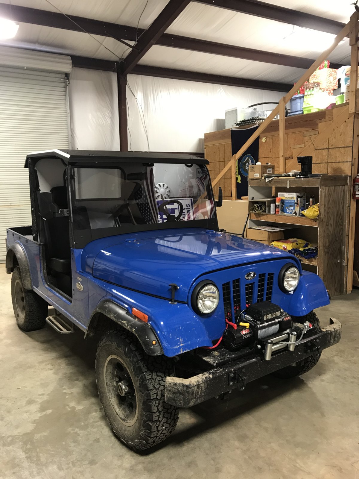

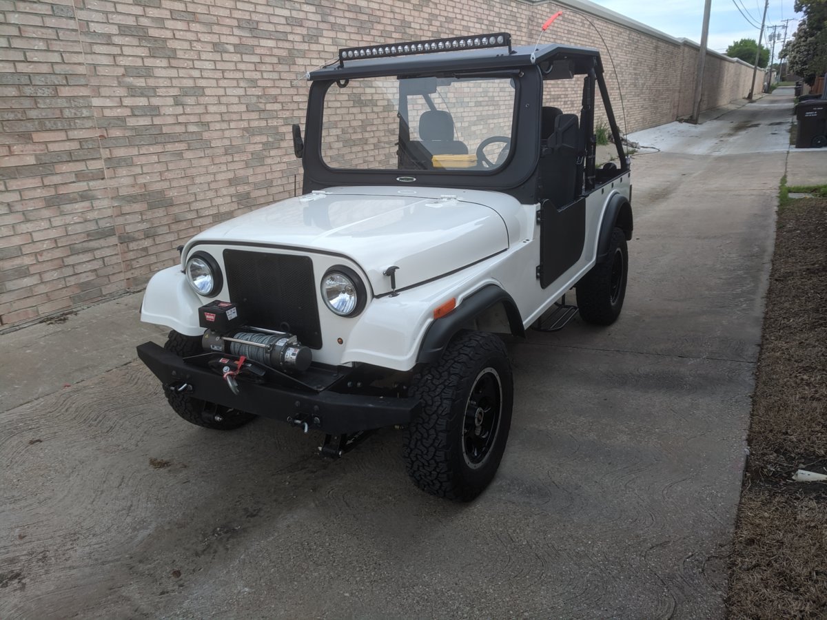

I have 2" wheel spacers on mine, and with 33" tires using OEM wheels it sits nearly perfect to the outside edge of the fender flares. I ordered everything off ebay. Make sure your spacers are hub centric to Roxor. Do a search under Roxor for wheel spacers and a bunch will pop up.

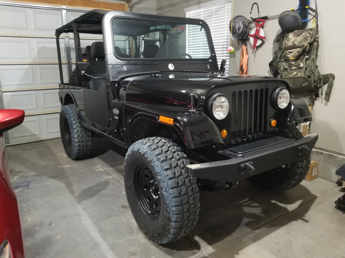

I am running 285/75/16 (just under 33in) on the stock wheels with 2in spacers. Plan on getting flares because it throws mud like you wouldn't believe

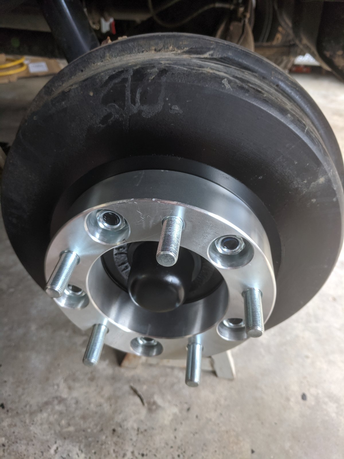

I saw this post last week but waited to respond until I actually had a chance to install the ones I got and make sure they worked correctly. These are the ones I got. https://www.amazon.com/gp/product/B01EMZQ44E/ref=ppx_yo_dt_b_asin_title_o02_s01?ie=UTF8&psc=1
I have not installed my CJ fender flares but I did "Mock" them up and they cover the tread very well. I can confirm that a 1-1/2" spacer with stock wheels and CJ flares is a good matchup.

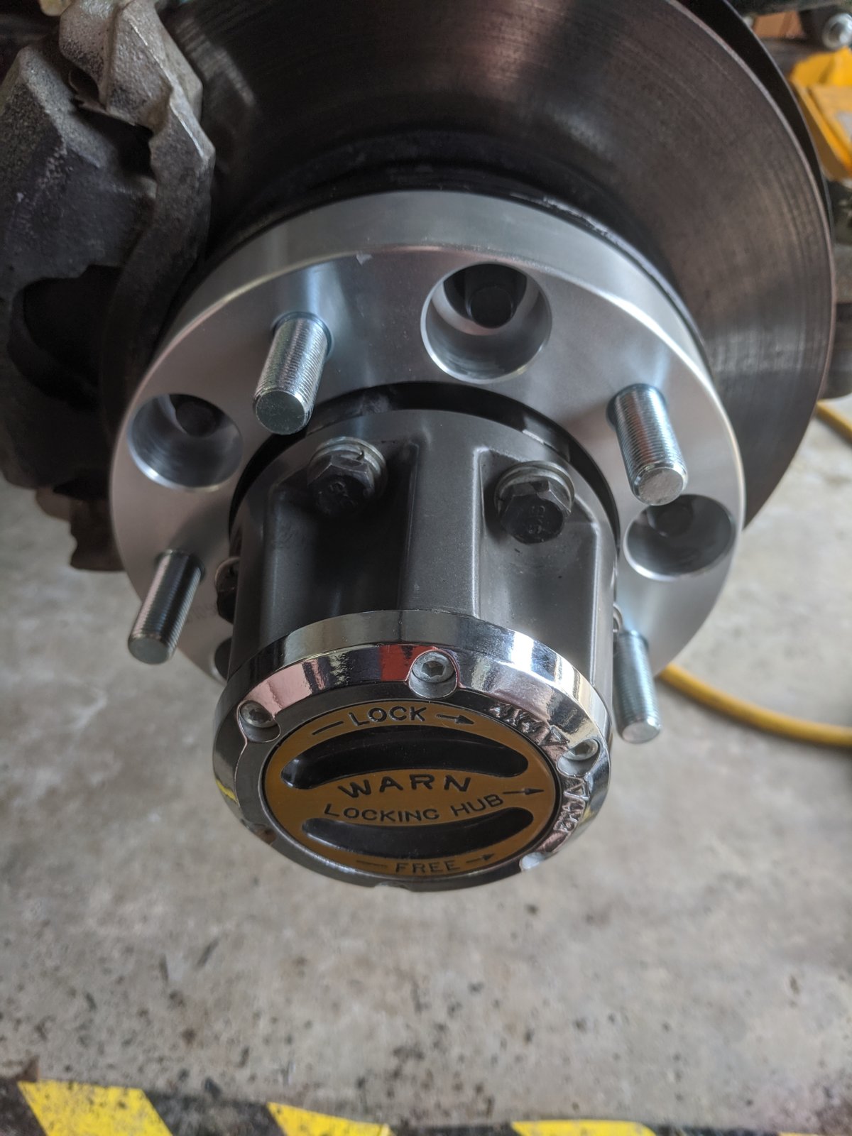

Got my 1-1/2 spacers on. Mine have 106.5mm bore, most may have 108mm. The 106.5mm work, just had to remove 3 bolts in a row that hold on the Warren hubs, the washers stick out past the hub diameter. After that they went right on.
I had to scrape off paint from back side of the OEM alum wheels and scraped, wire brushed and repainted the front hubs.
I went ahead and used blue locktite Tite in the spacer nuts.
