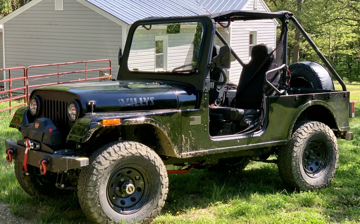

i did the Rough Country leveling kit.
Pretty easy. Rides nice.

After the lift it feels pretty level to me.
mom not planning on rear shackles.

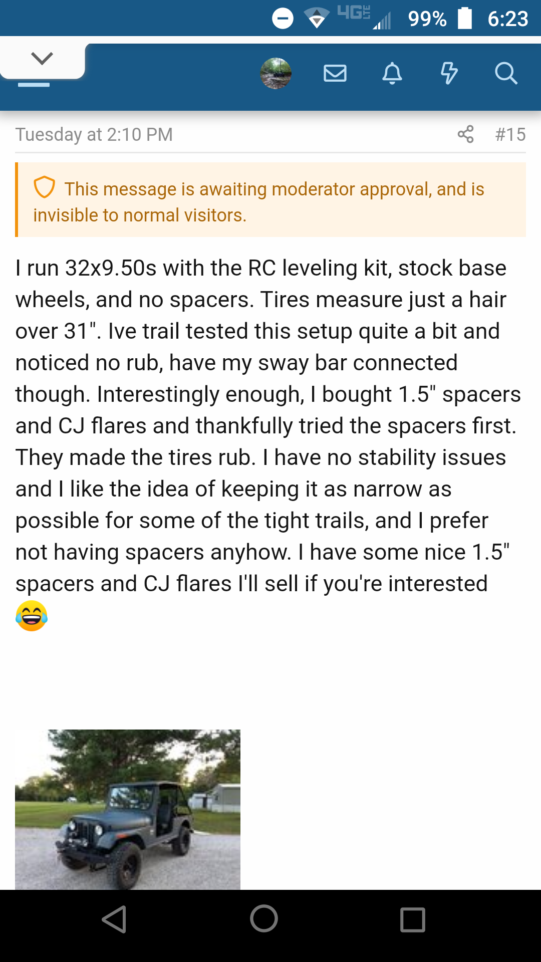

BoxofRox
Jul 25, 2020
53
West Virginia
2825
I run 32x9.50s with the RC leveling kit, stock base wheels, and no spacers. Tires measure just a hair over 31". Ive trail tested this setup quite a bit and noticed no rub, have my sway bar connected though. Interestingly enough, I bought 1.5" spacers and CJ flares and thankfully tried the spacers first. They made the tires rub. I have no stability issues and I like the idea of keeping it as narrow as possible for some of the tight trails, and I prefer not having spacers anyhow. I have some nice 1.5" spacers and CJ flares I'll sell if you're interested ?
