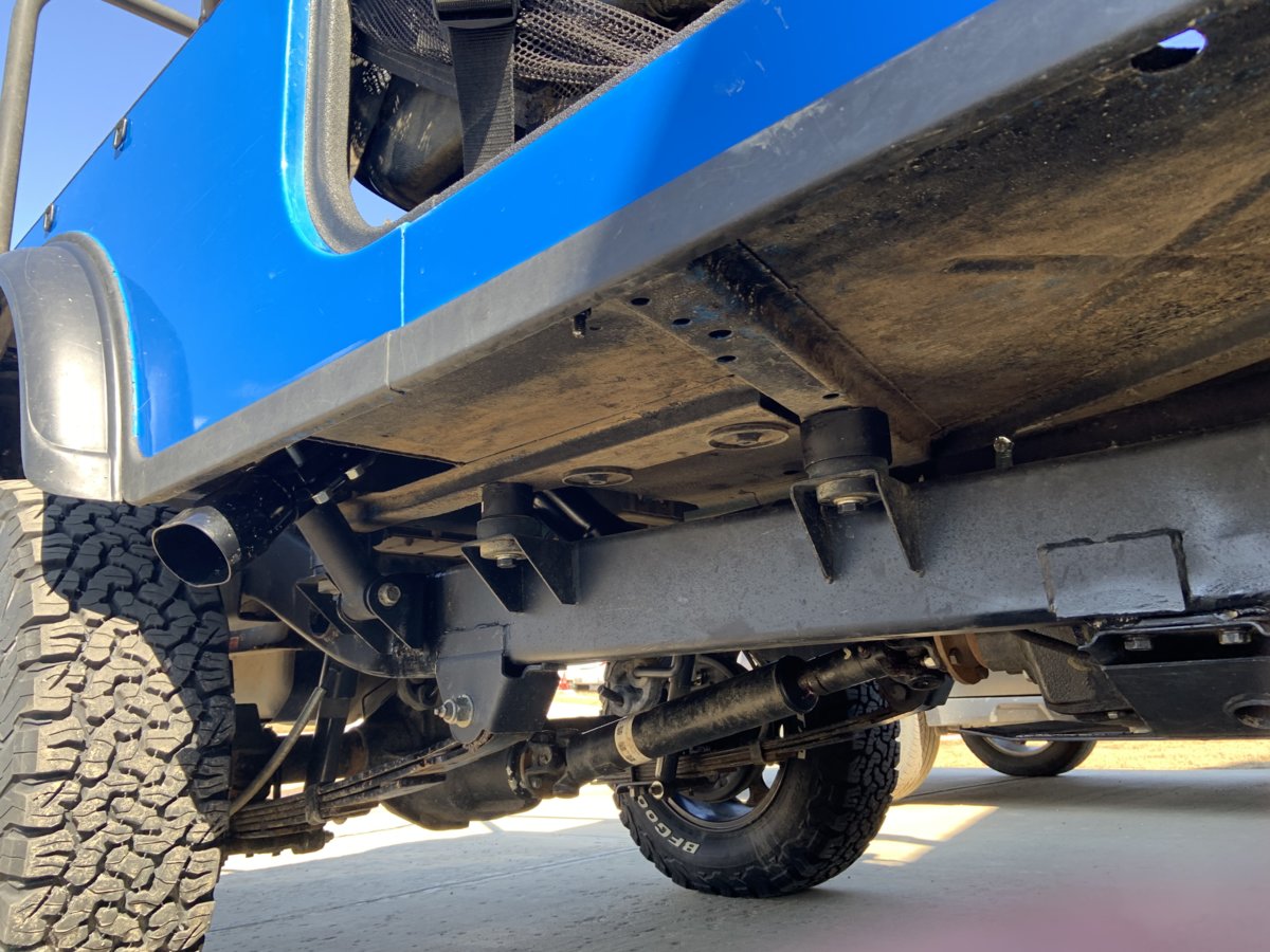

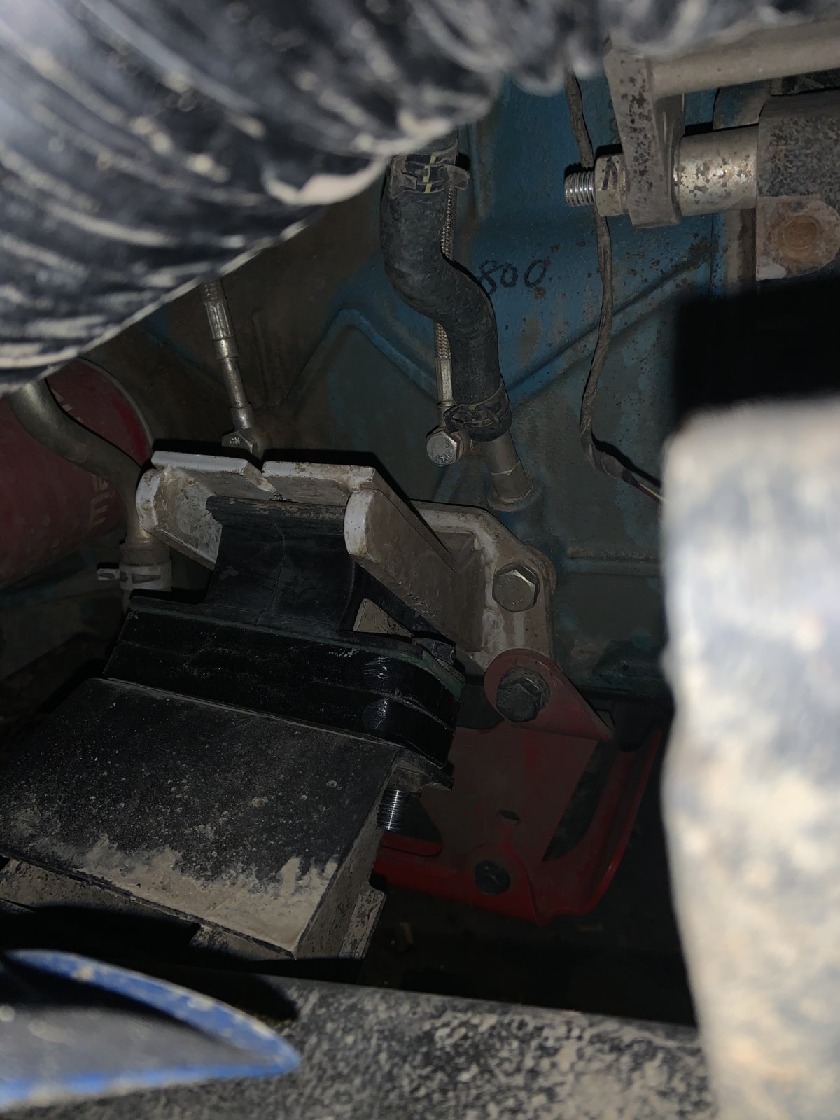

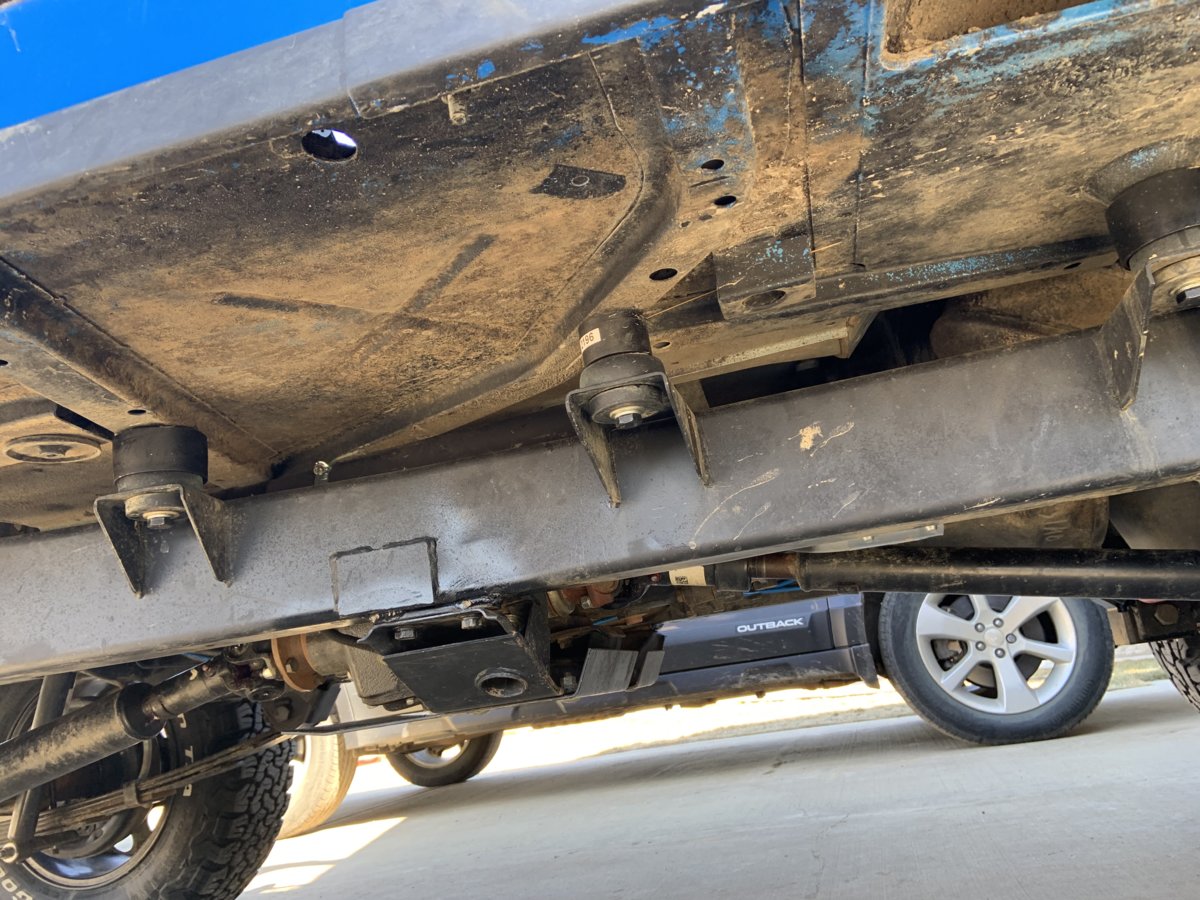

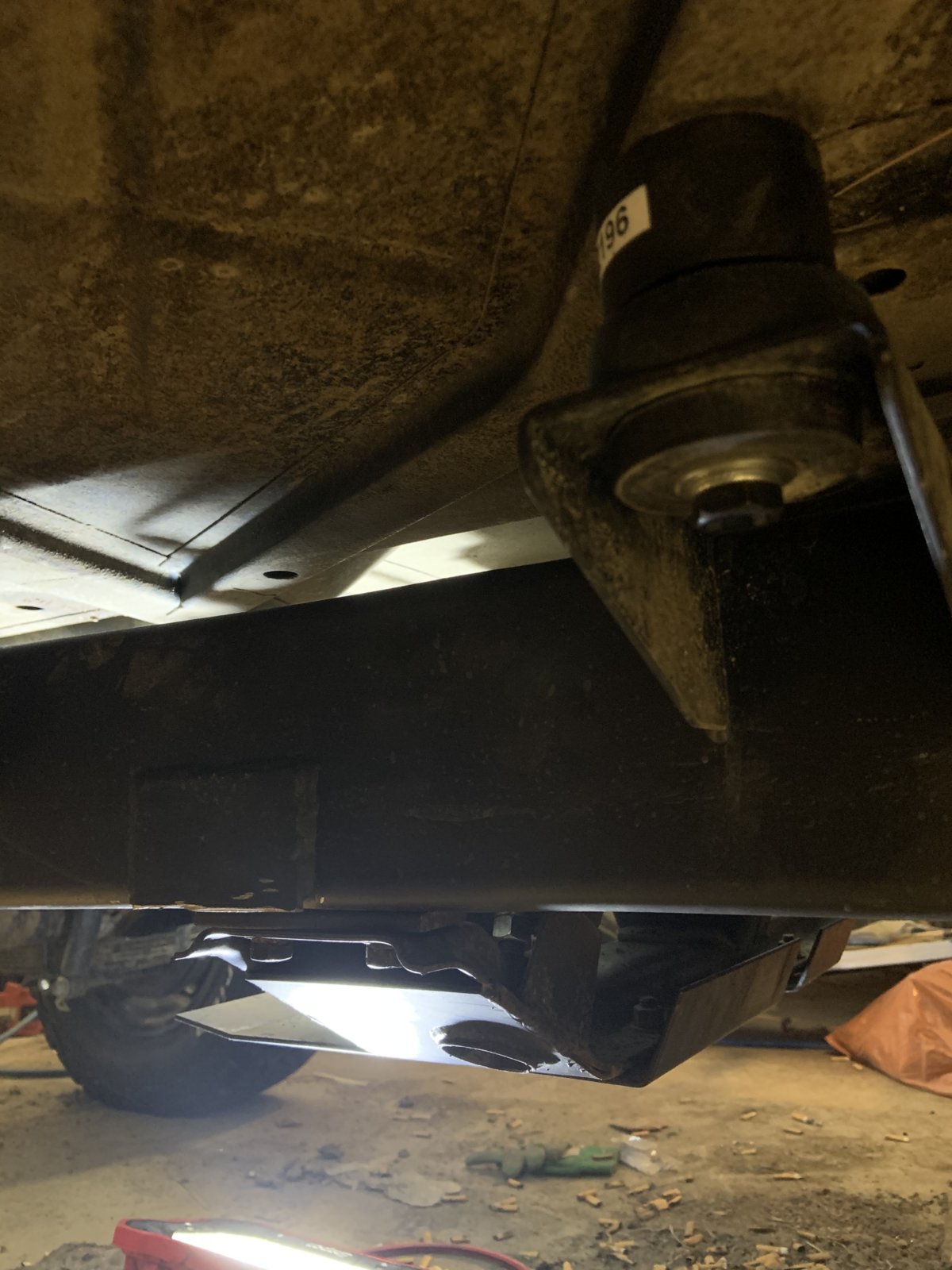

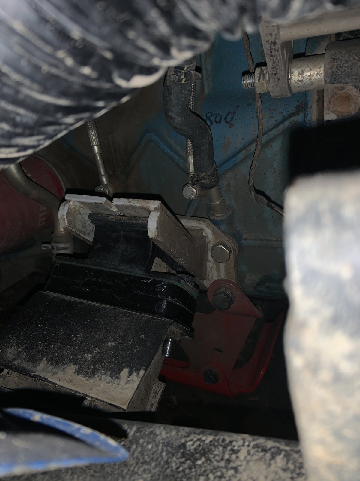

With an 1 1/4” body lift I was able to raise the transfer case up 2” and the motor 1”. I just cut off the drop brackets off the frame and used the original cross member bolted directly to the frame. If ur not shy about cutting up the floor, one can get it higher.

I went with a jks 1 1/4” body lift and made 1” lift blocks for the motor. Exhaust has to be reworked to fit as it is tight between the frame/ t case.

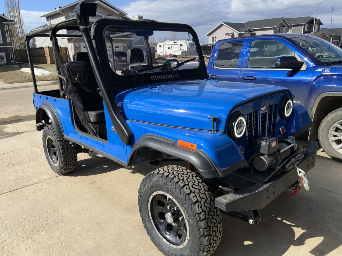

Thanks Breevers, I’ve installed the Rough Country lift and 6.5” boomerang shackles with the 1.25” body lift. Gave me 3.25” of lift on the front and 1.75” on the rear. The t case is 13.75” off the floor with the stock 29” tires. With the planned 35” tires the t case will be 16.75”. rstan45 s woodrat build has about 16” of clearance under the t case with a 4” suspension lift and 35” tires and harsher u joint angles.

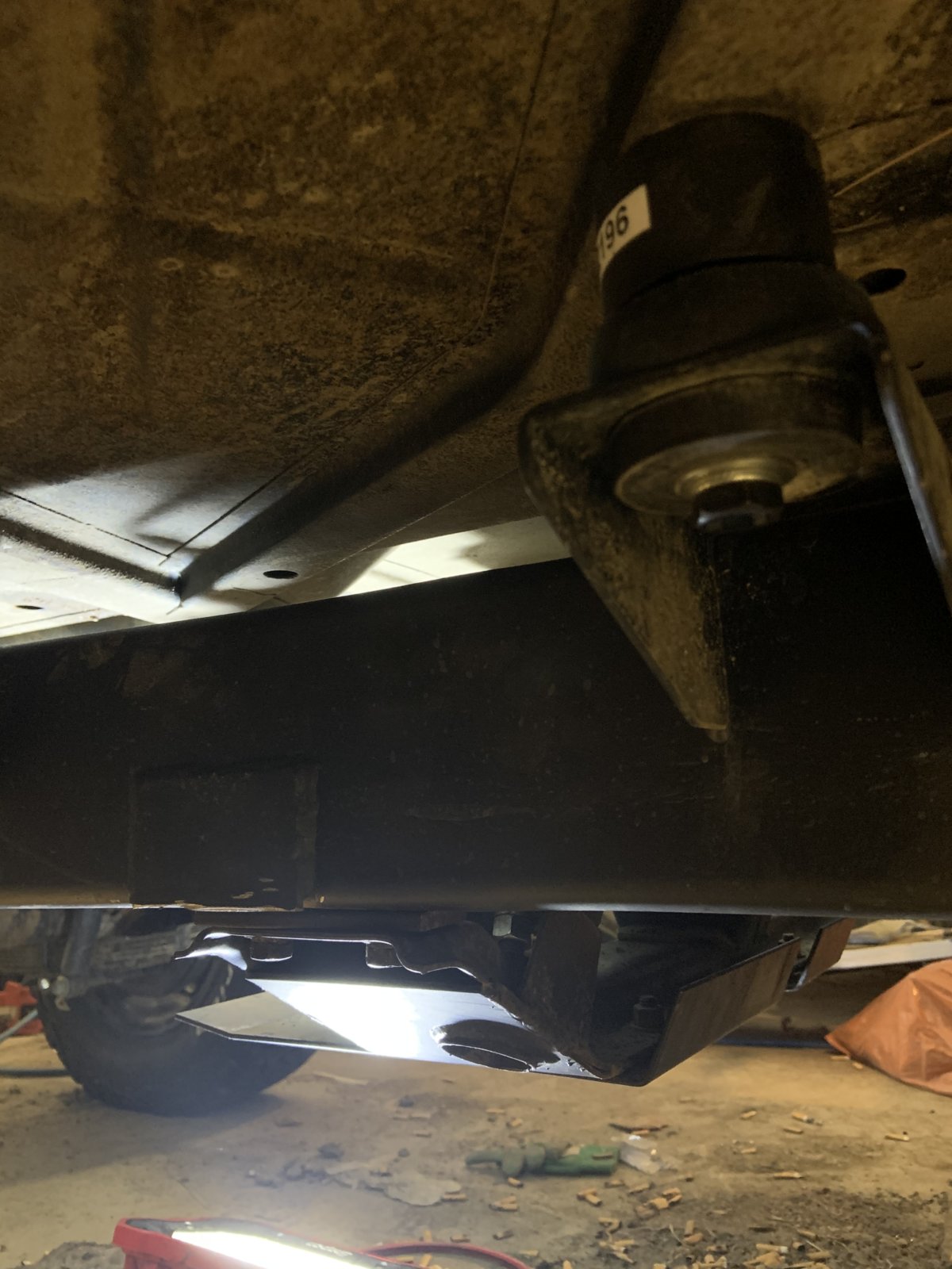

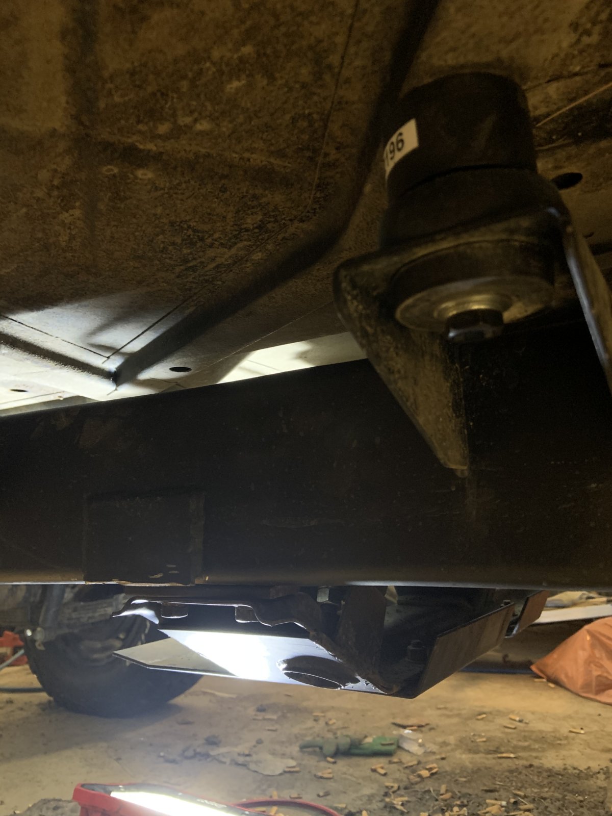

The Cecco Skid does fit much tighter that stock. Ground clearnace is the same however we designed it to not be a "shovel" and slide / glide over obstacles much better which it does.

Cecco mounts right under the transfer case cross member. It sits tights and uses the 4 factory bolts. and extends sideways to the frames, then up the welded on cross member supports. If you raise the transfer case you could still use it. I think it will just conform to the new position. May have a little off the ends.
