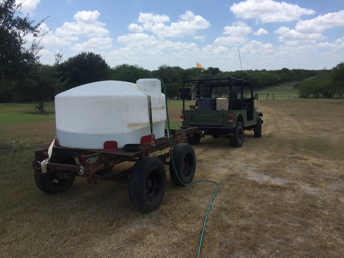

Distance and weight? Also speed. All play huge variables in what can be done safely. I pull this tank on a trailer setup but only do it off-road In the pasture. 425 gallons of water. It pulls it just fine. Of course I never get out of first gear empty and usually tow it in 4 low due to weight and water slosh. More controlled that way. We’ve all beaten that dead horse that is the rear crossmember and towing setup. So have that done right before you tow. I wouldn’t hesitate to tow up to 2500 lbs The braking and trailer sway will be what you need to watch for.

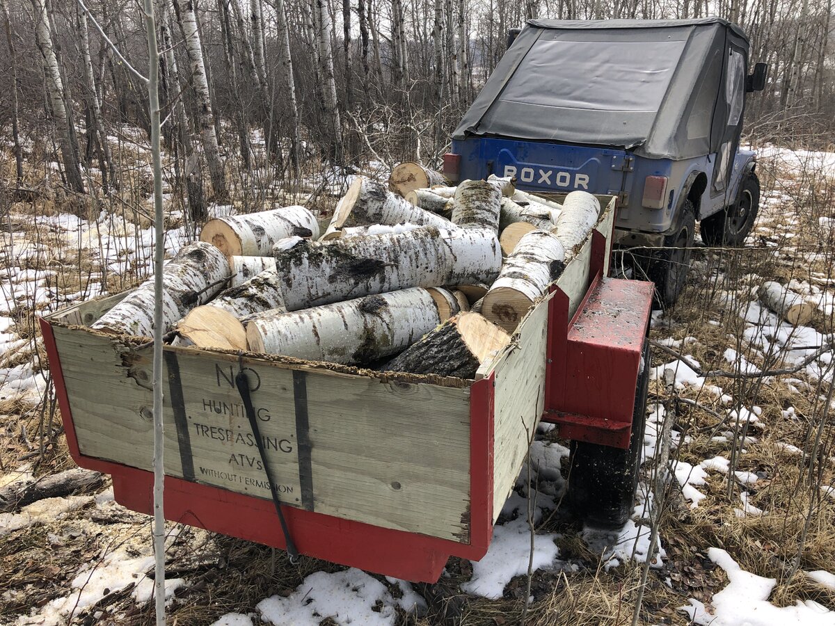

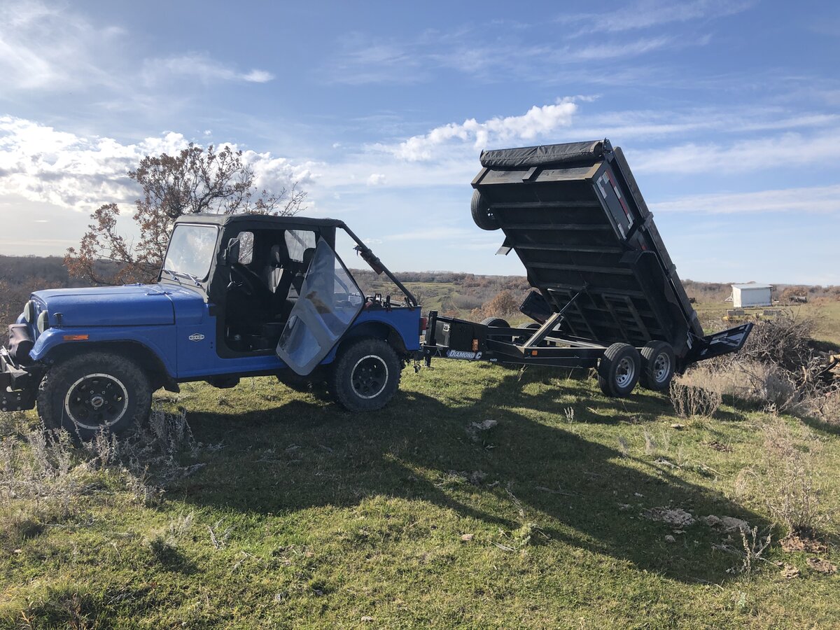

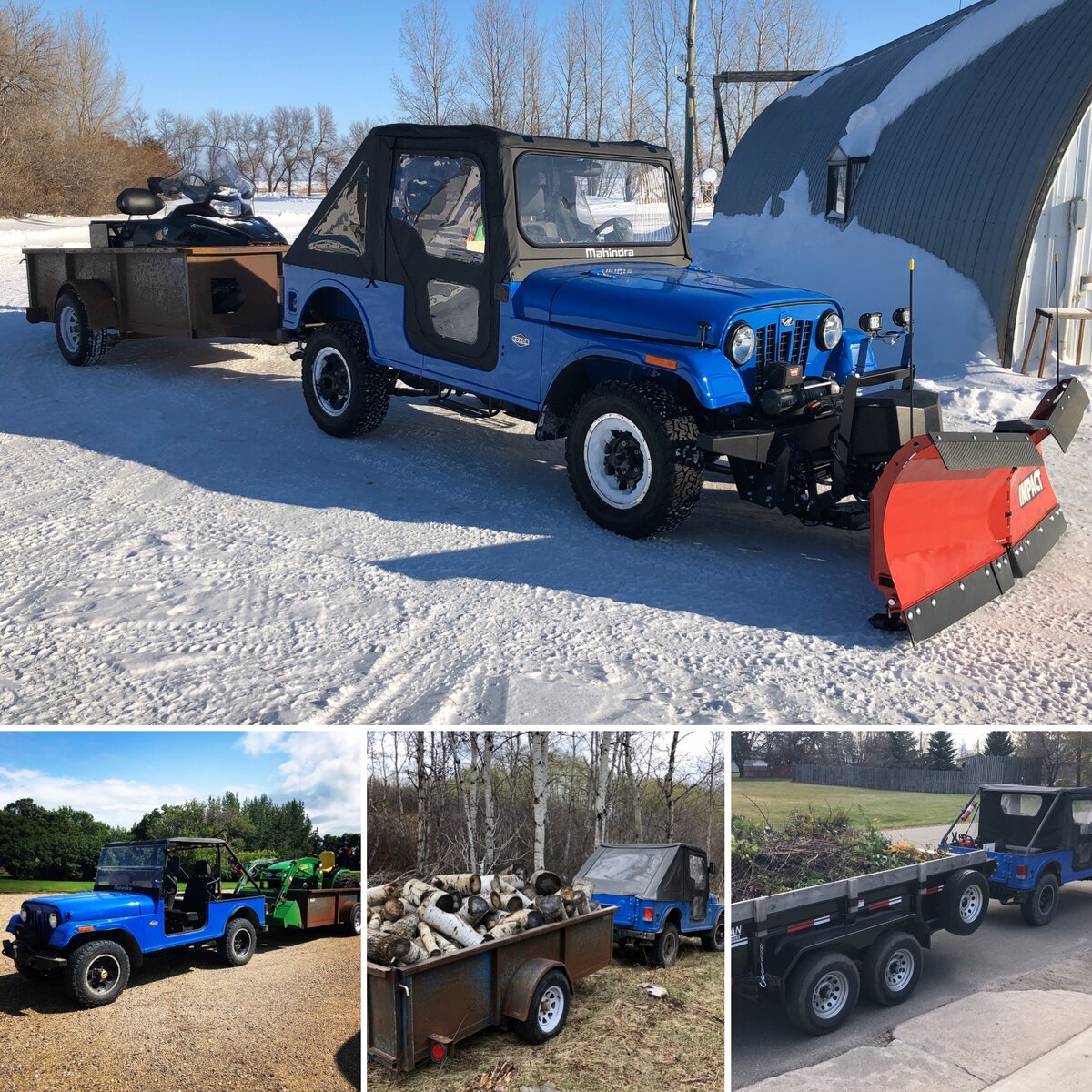

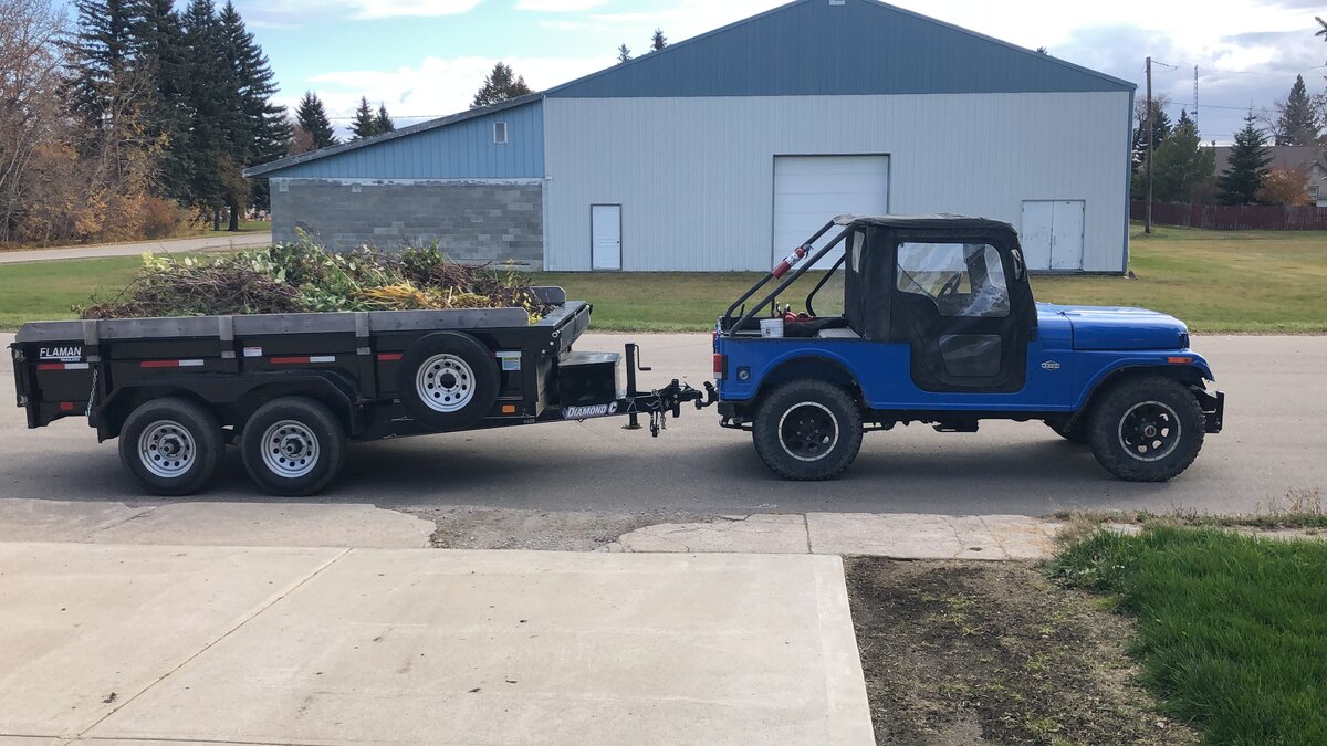

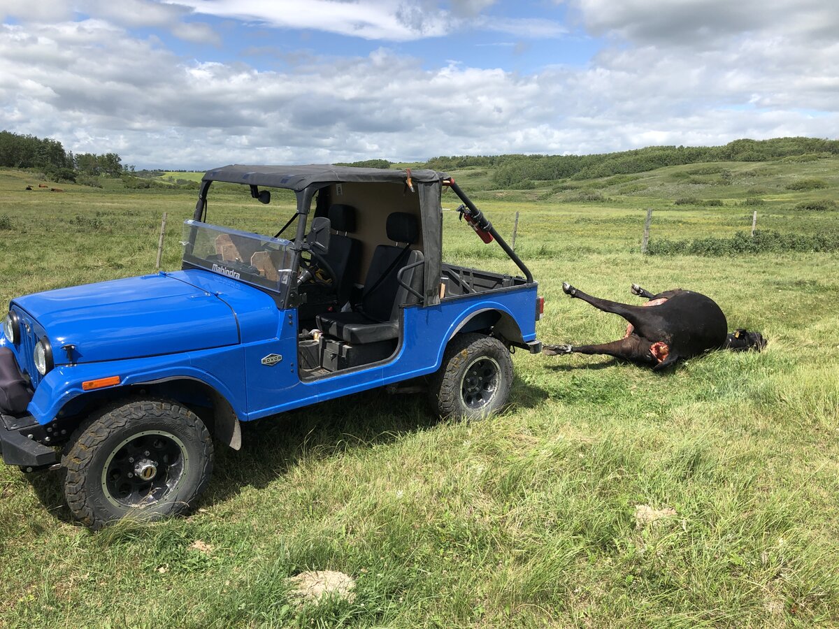

I drag everything around, including dead cows. lol. I have the factory pintle/ball combo. It indestructible.
FYI: that dump trailer is light duty and just has garden waste in it.

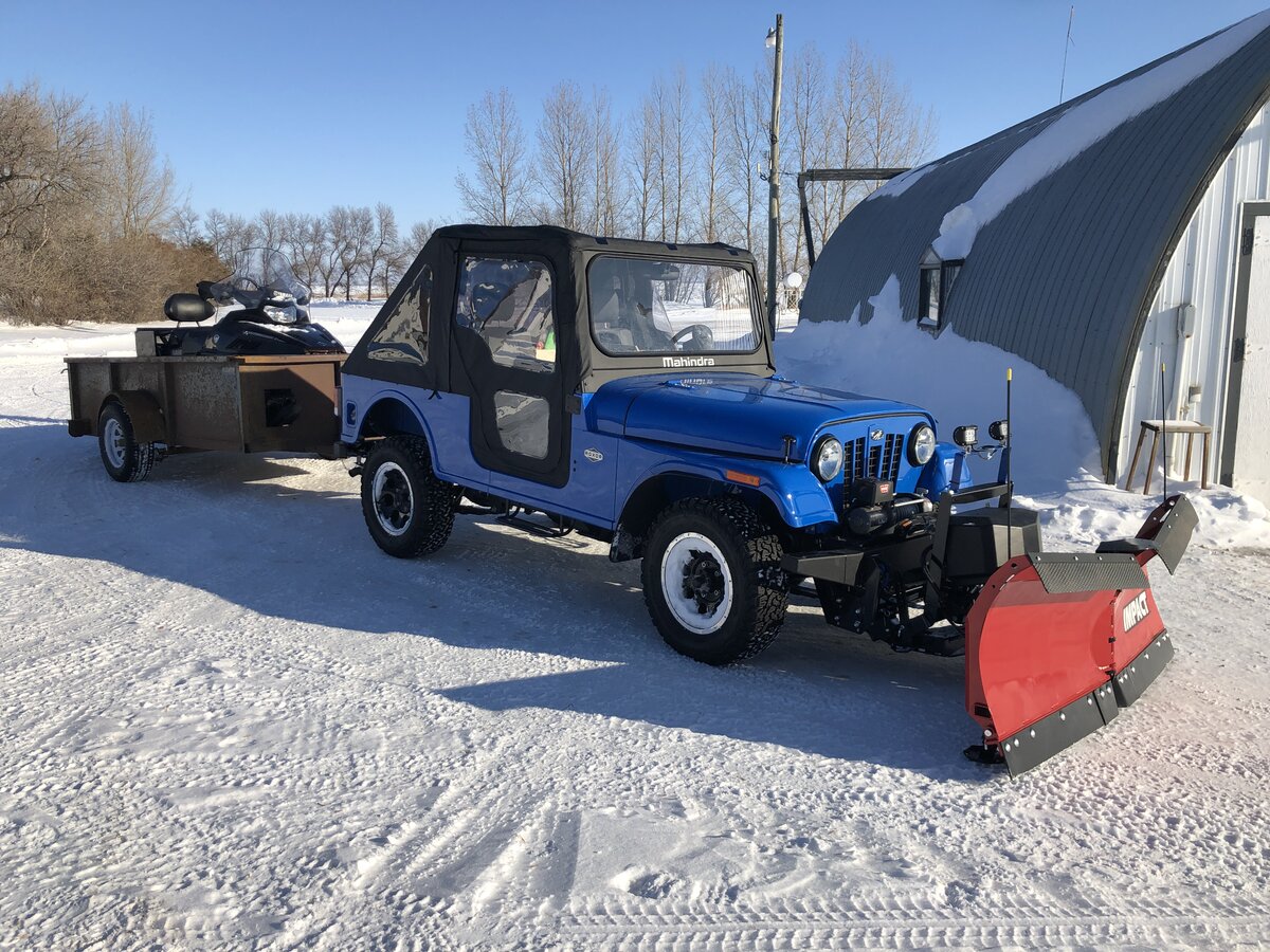

4F20F699-BE7A-4314-BEB3-60E3B565C42A.jpeg DB4FF652-132C-4ACC-839F-71B12E04A728.jpeg B769F41B-C8FC-4D92-AF19-87E62405DB50.jpeg D22787A6-DBB7-4FB1-AA9C-381055A26458.jpeg 958DF2BF-E4B5-4E93-BB84-A3EC0B3F239C.jpeg 1A2D88FD-685E-46C8-9224-86EADB6021E1.jpeg
